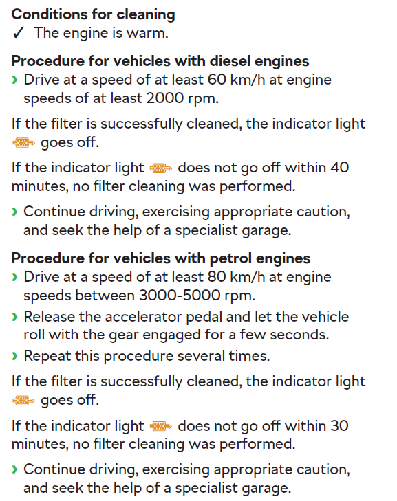

Had the dpf light come on on my son's Monte carlo. I took it for an Italian tune up, down the motorway left it in 4th Gear get the revs between 2000 and 2500. Drove for about 1/2 he and get presto light went off. Simples.
This might be even on a new car. Because regeneration was interrupted multiple times before.

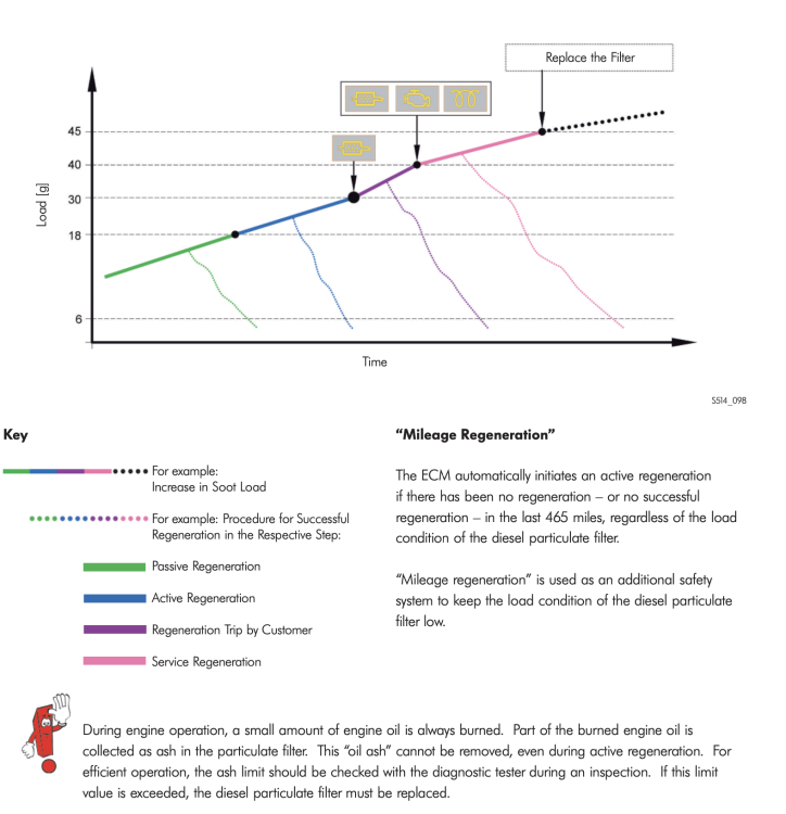

Would expect DPF on a Superb 2.0 diesel to last at least 150k miles.  Mine is just over half full at near 120k miles.  Others on here report getting near 200k before the DPF nears capacity.
Older generation DPFs predating the Superb mk3 were more problematic.
