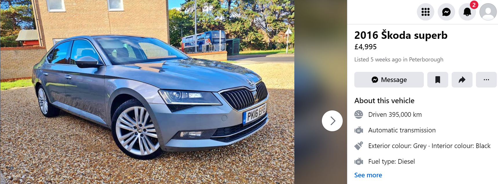

If this forums allows... Check out the mileage on this UK DSG Superb 3.😲
Incredible machine.

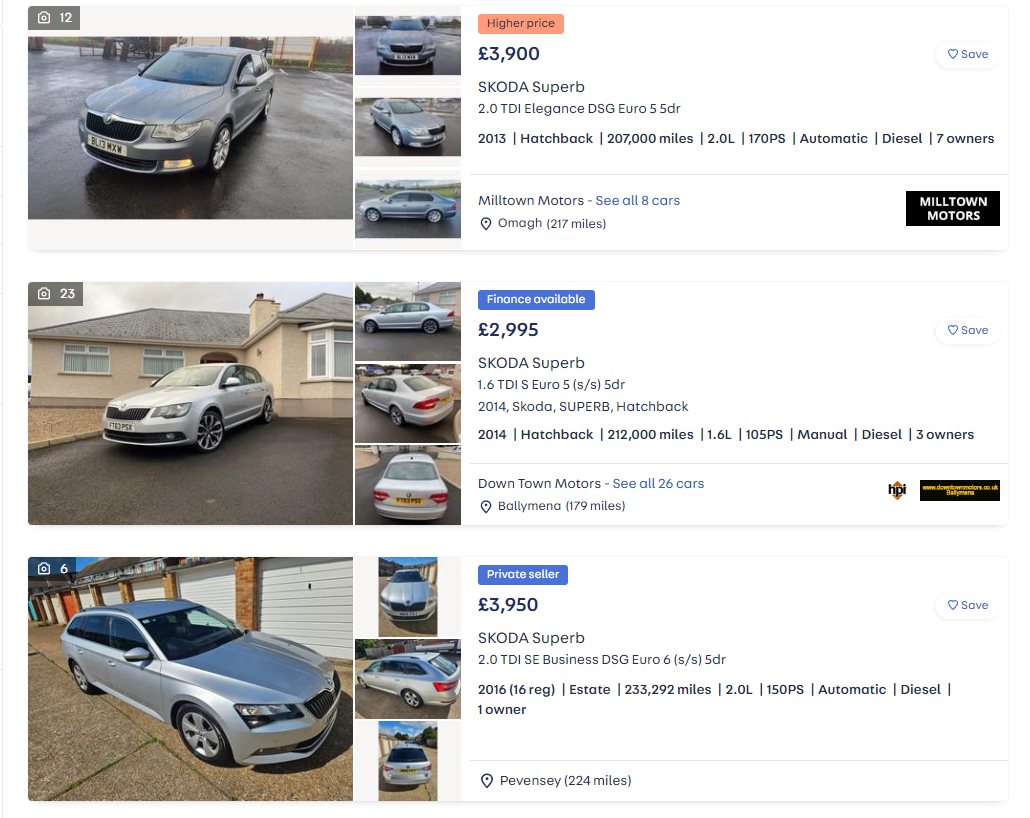

If that's a UK spec car and not an import why does the mileage show in km??
NB these are the 3 highest mileage cars I see currently on autotrader rather than FB marketplace (oh hang on is that FB being a twot? Ive noticed on the desktop it shows km fopr everything in marketplace but miles on my phone. So that could potentially be 395k miles!!!!)
Facebook always displays is Km, not miles.  A truly bizarre decision from Facebook.
I'm inclined to agree that those FB Marketplace Mileages are actual Miles and not KM, as shown,
which makes you smile all the more in the knowledge that VAG Diesels, (and Petrol Engines, of course), can be, and usually are with good maintenance/treatment, pretty damn robust, and capable of Galactic Mileages! 🤩
