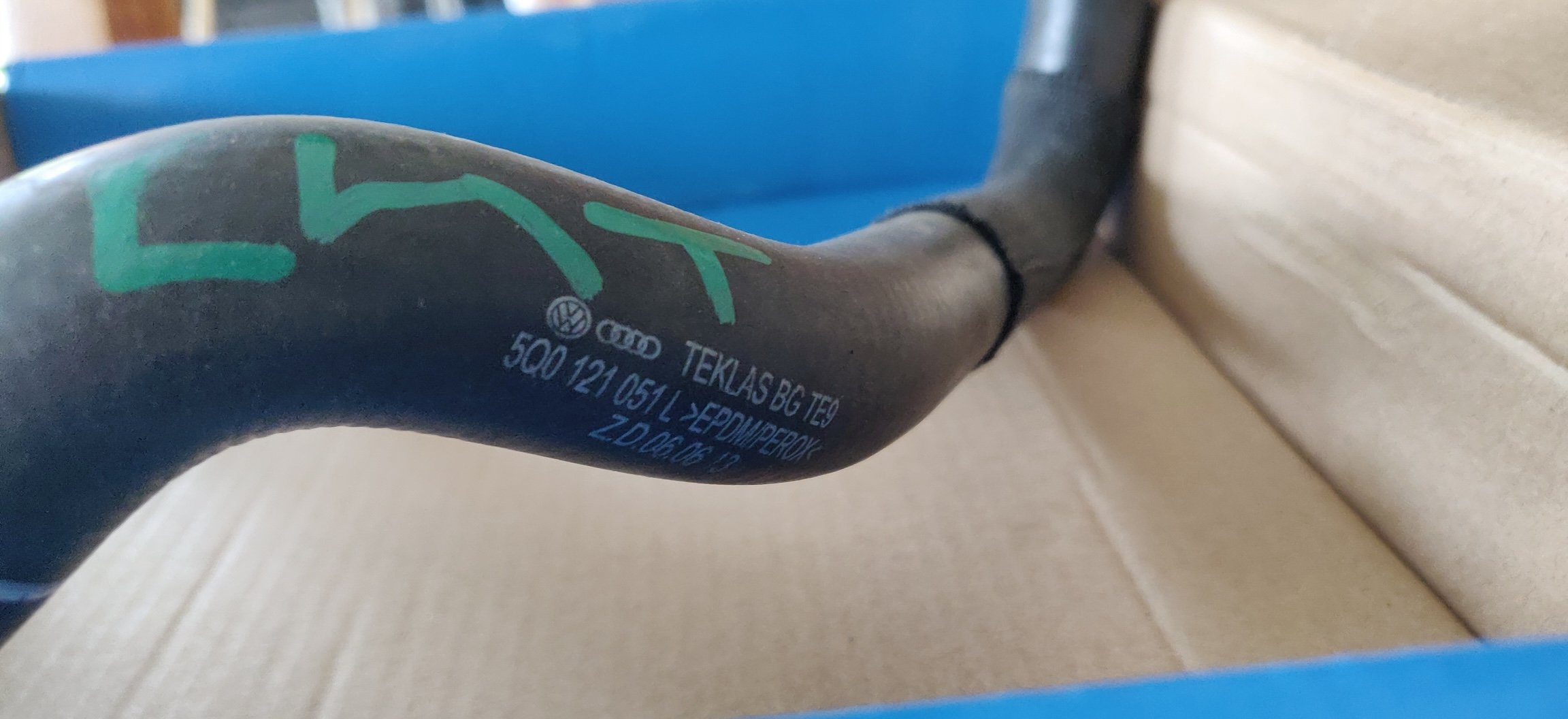

So labelled that up and tucked it together with the right side sensor. £28.49 from eBay, so on the back burner.

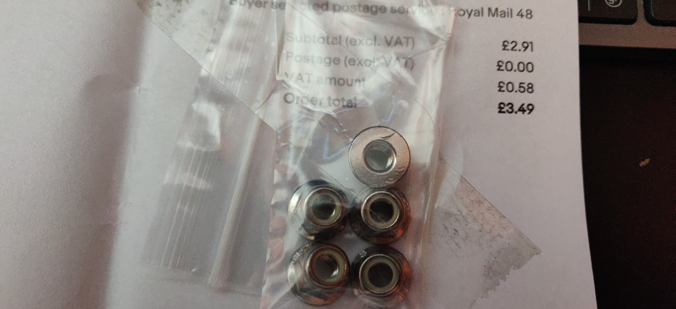

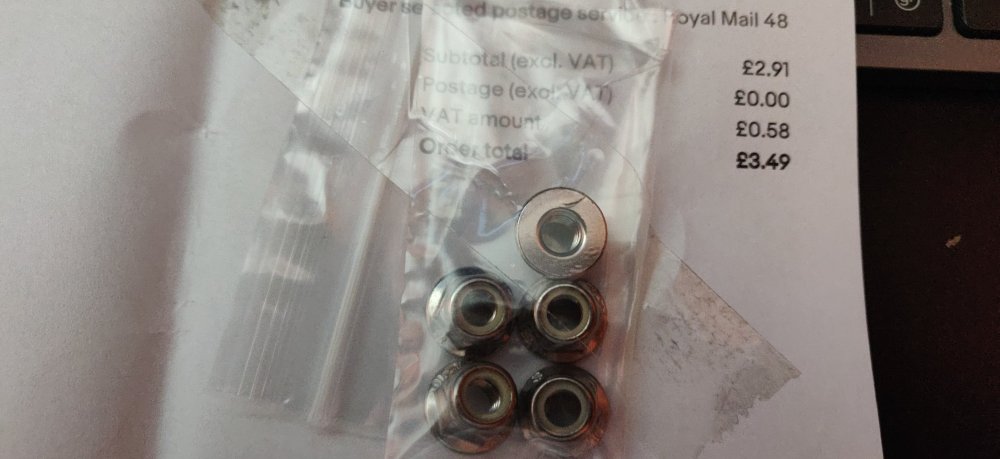

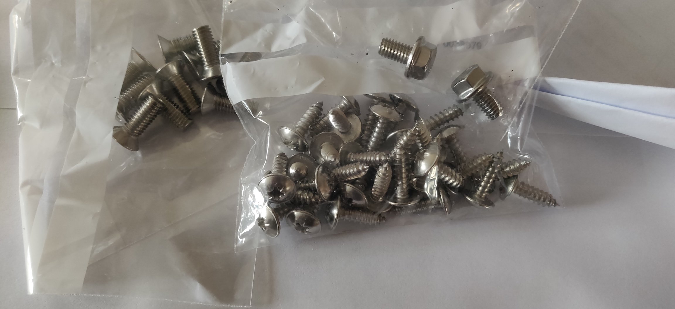

Decided to get these ready:

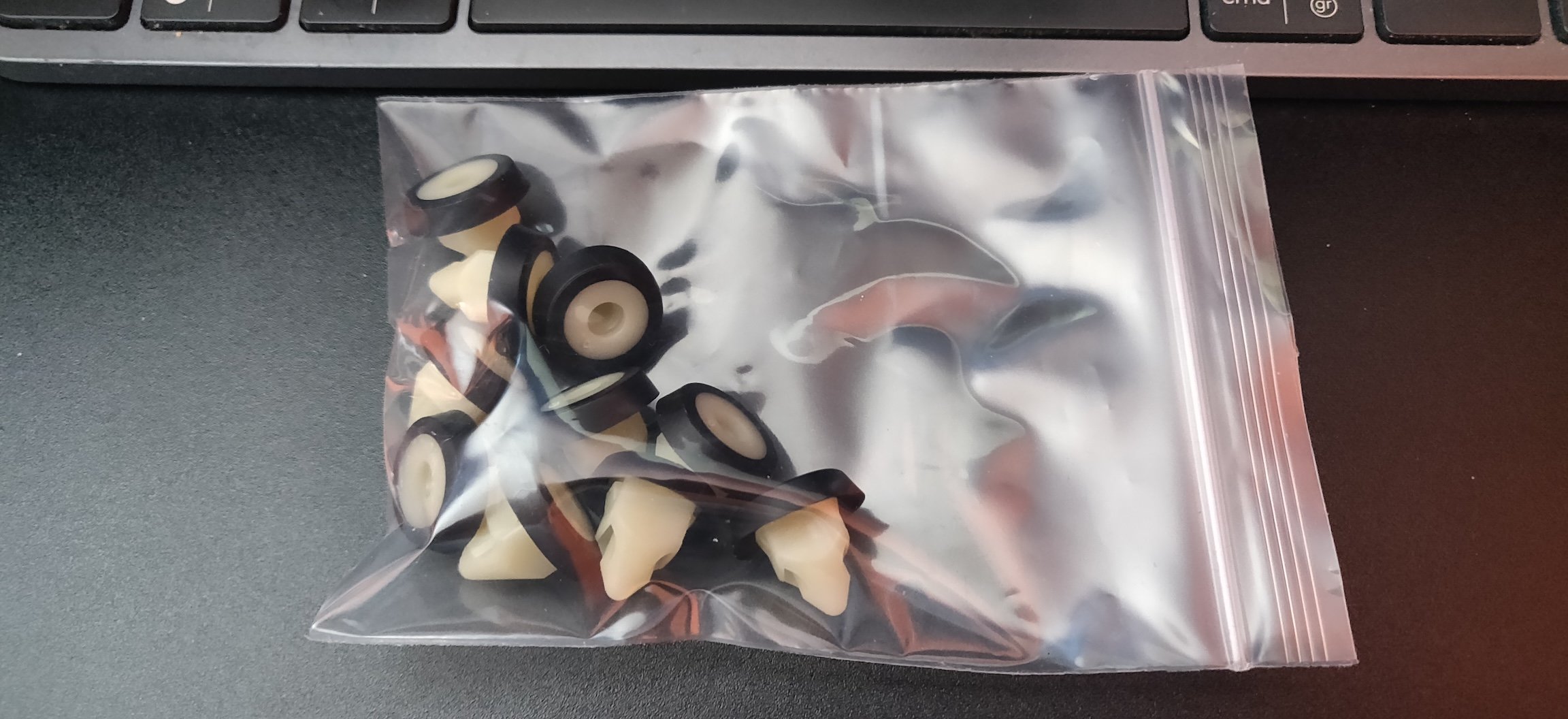

Got these again from eBay for £3.49 a while ago, ready to replace the ones that were mangled.
Just a case of pushing them in really:

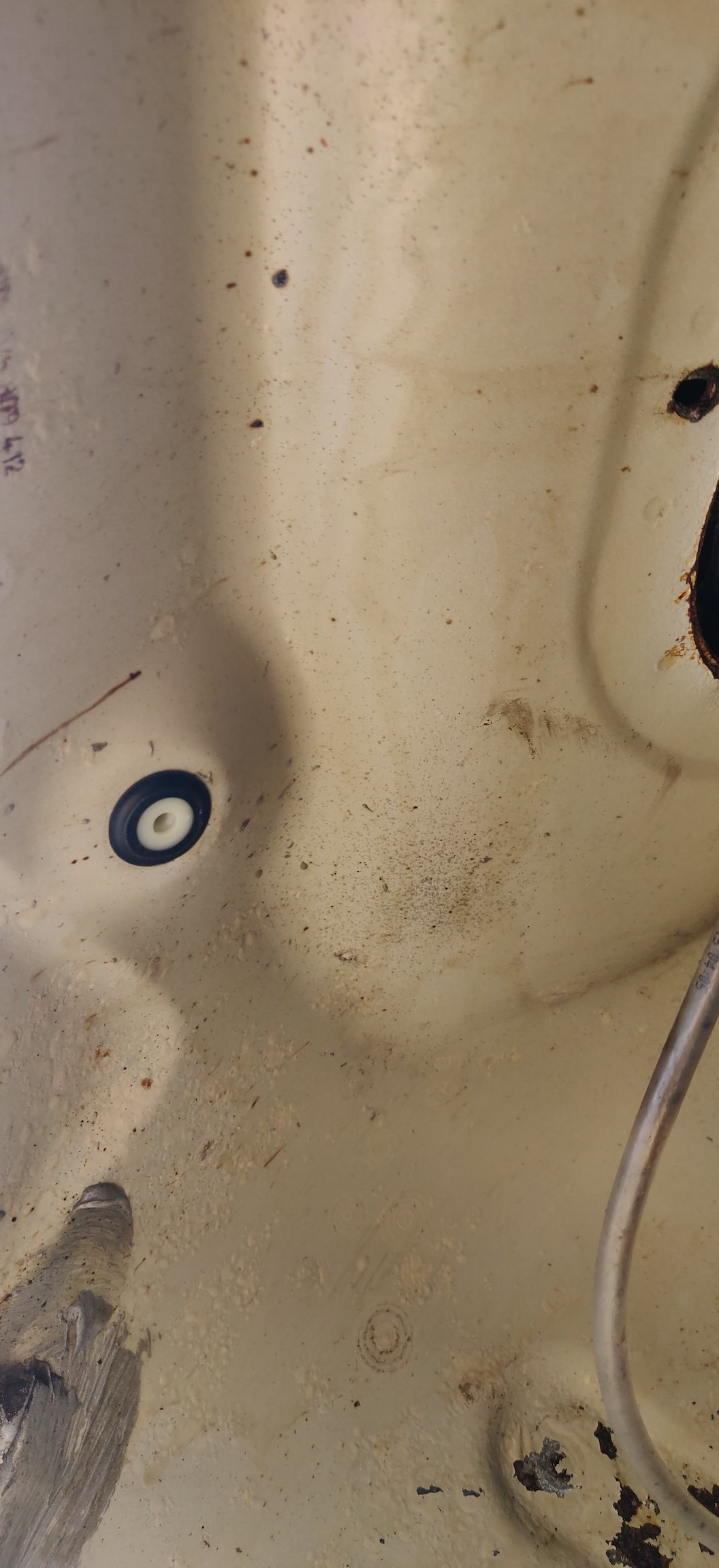

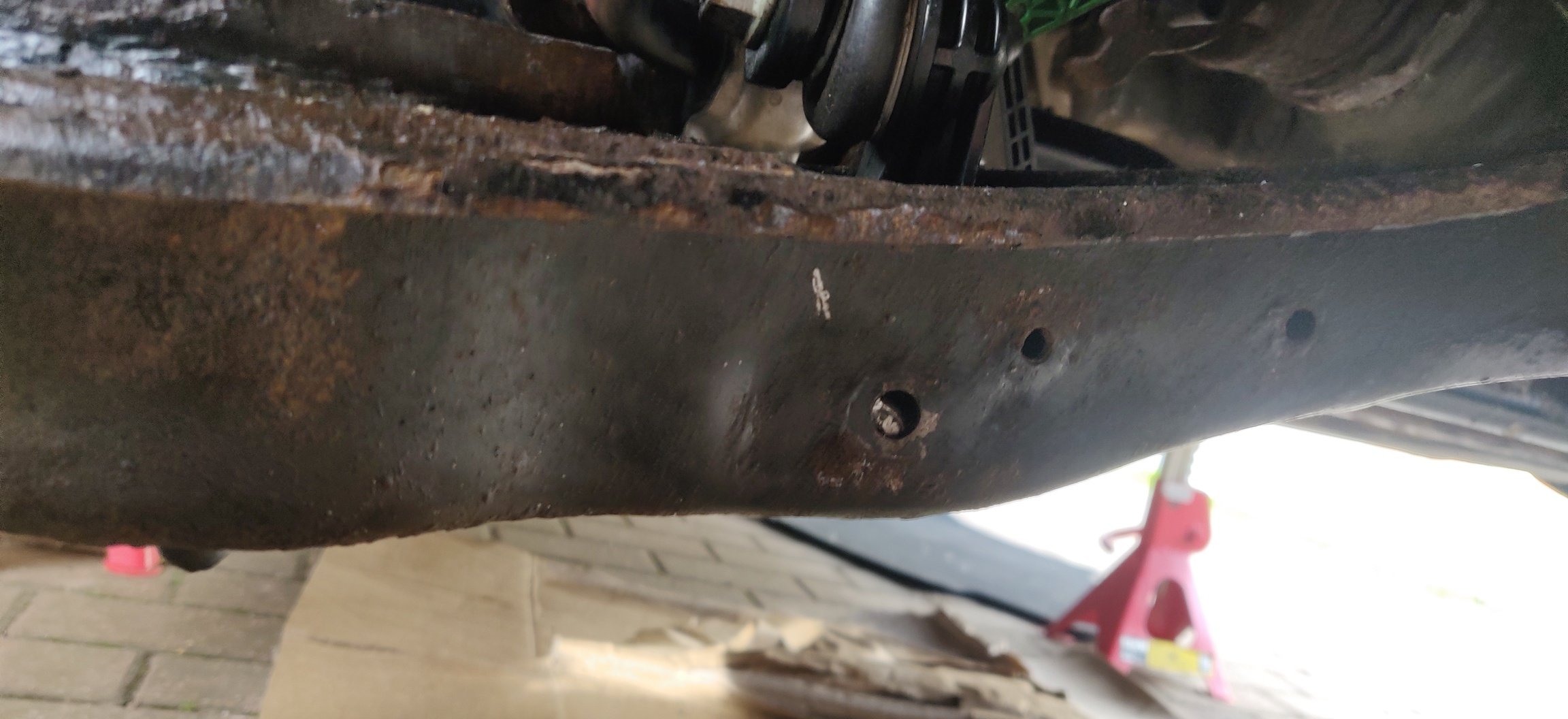

So it was two on the right side:
Then one on the left. Assuming I reach the point where the underside of this is genuinely sorted out, I'll probably end up replacing all the clips as a matter of course. The wheel arch lip though...
So try and keep some of that stuff out of sight:

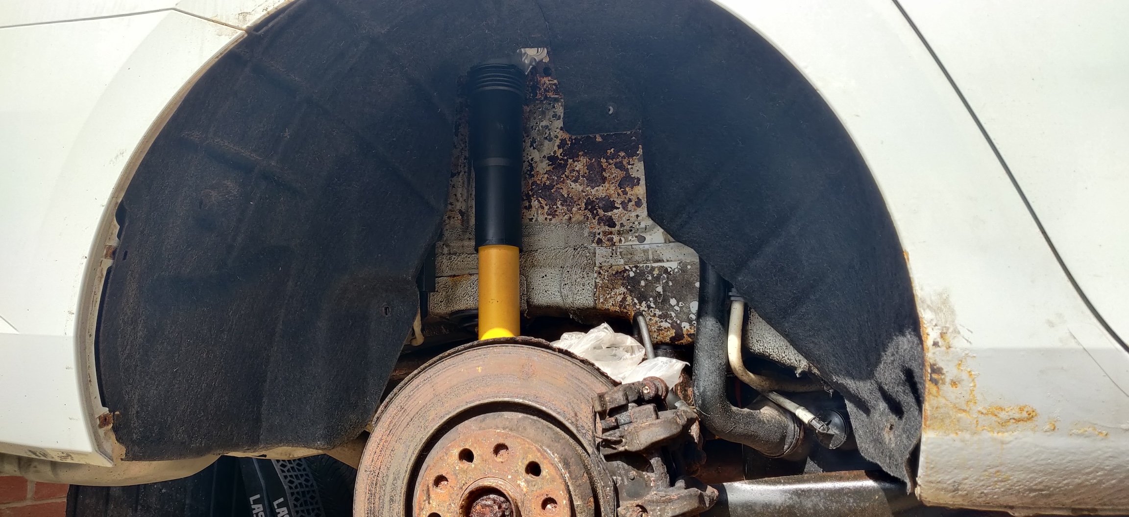

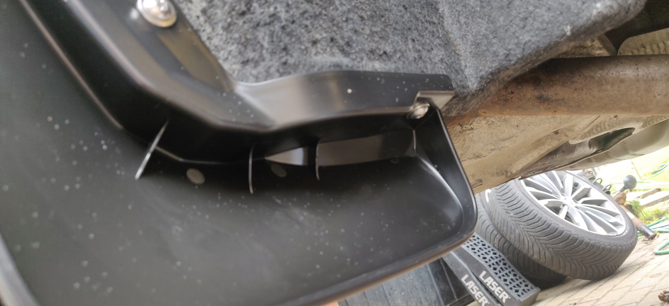

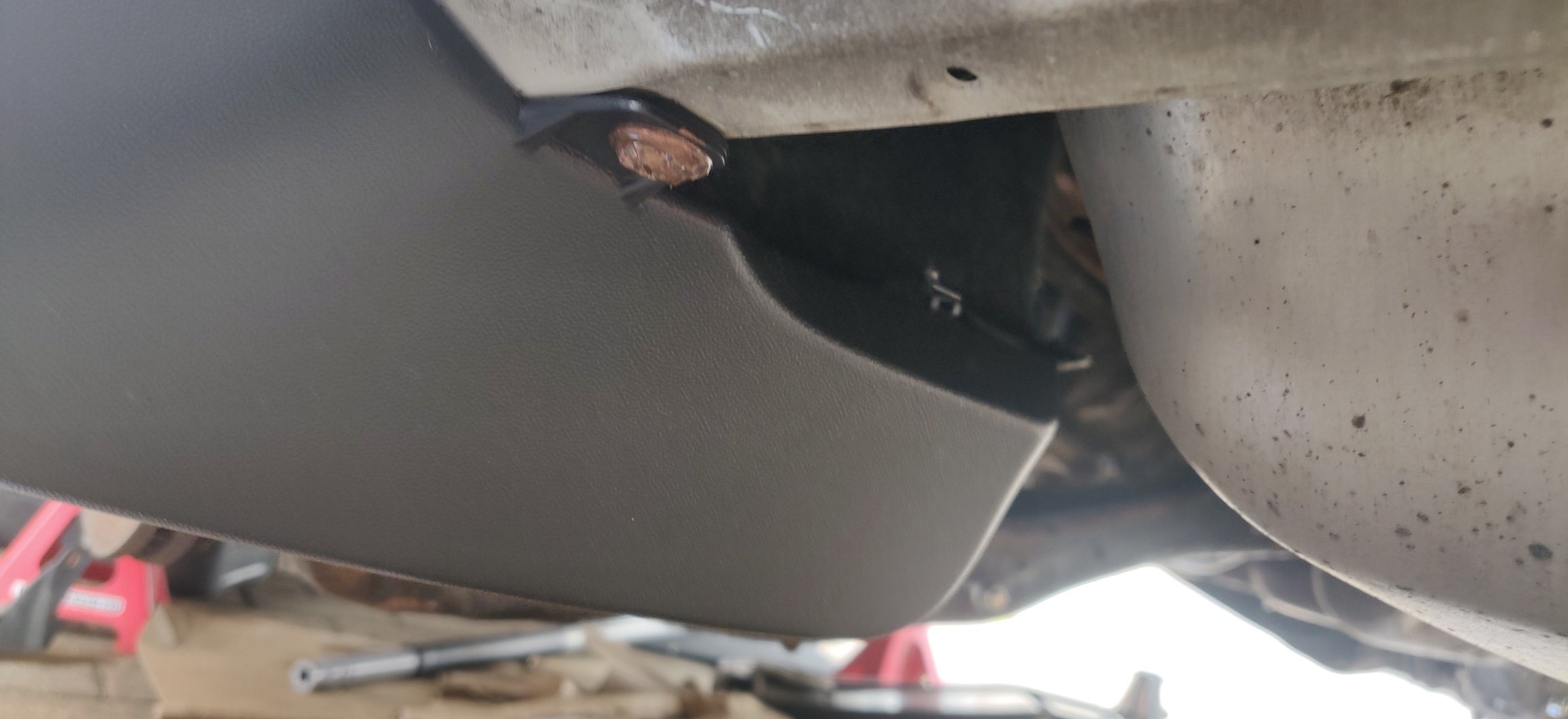

Dry fitted the wheel arch just mainly to check if it was ok to attach it:
It sorta gets in the way of the suspension here, so I guess this should be tightened up appropriately before attaching the wheel arch. This should be ok, the rest along the bottom are the ones with the bushes.

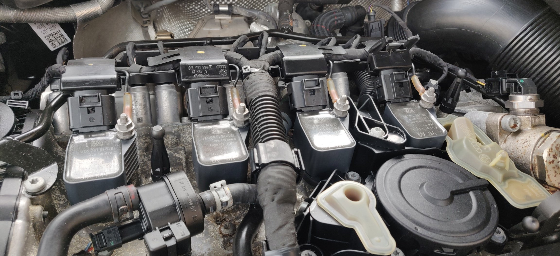

Then took the wheel arch, and took them into the house and gave them a hoover to grab up a bit more of the loose grass and crud as it was dry now.

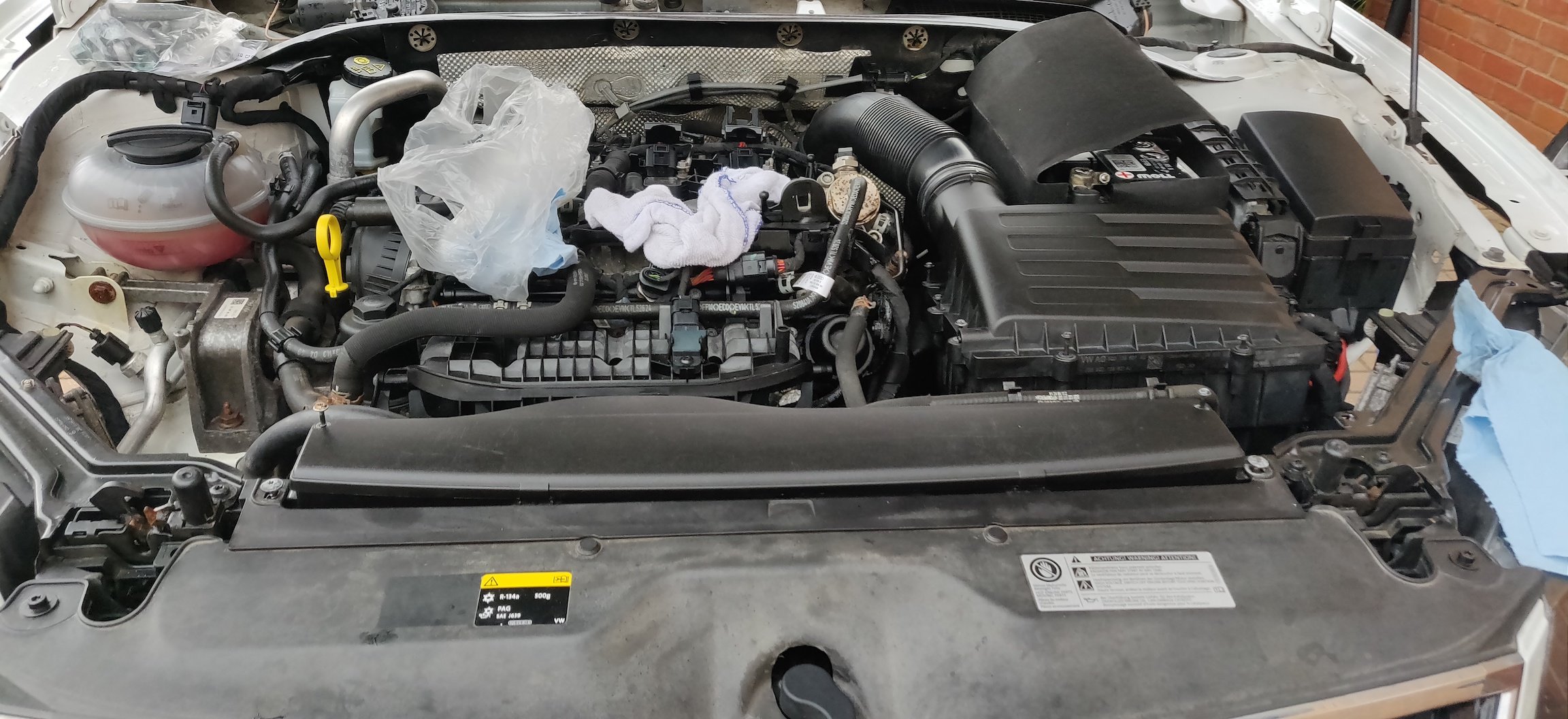

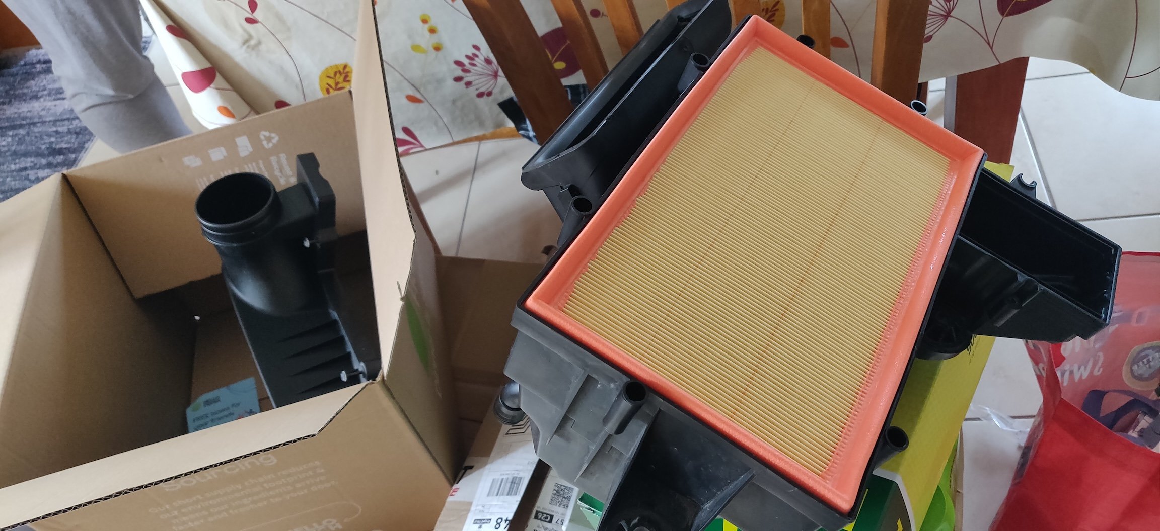

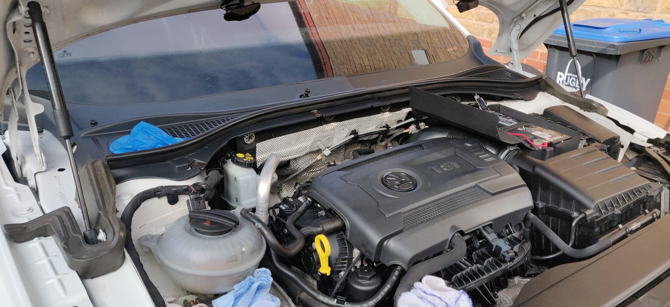

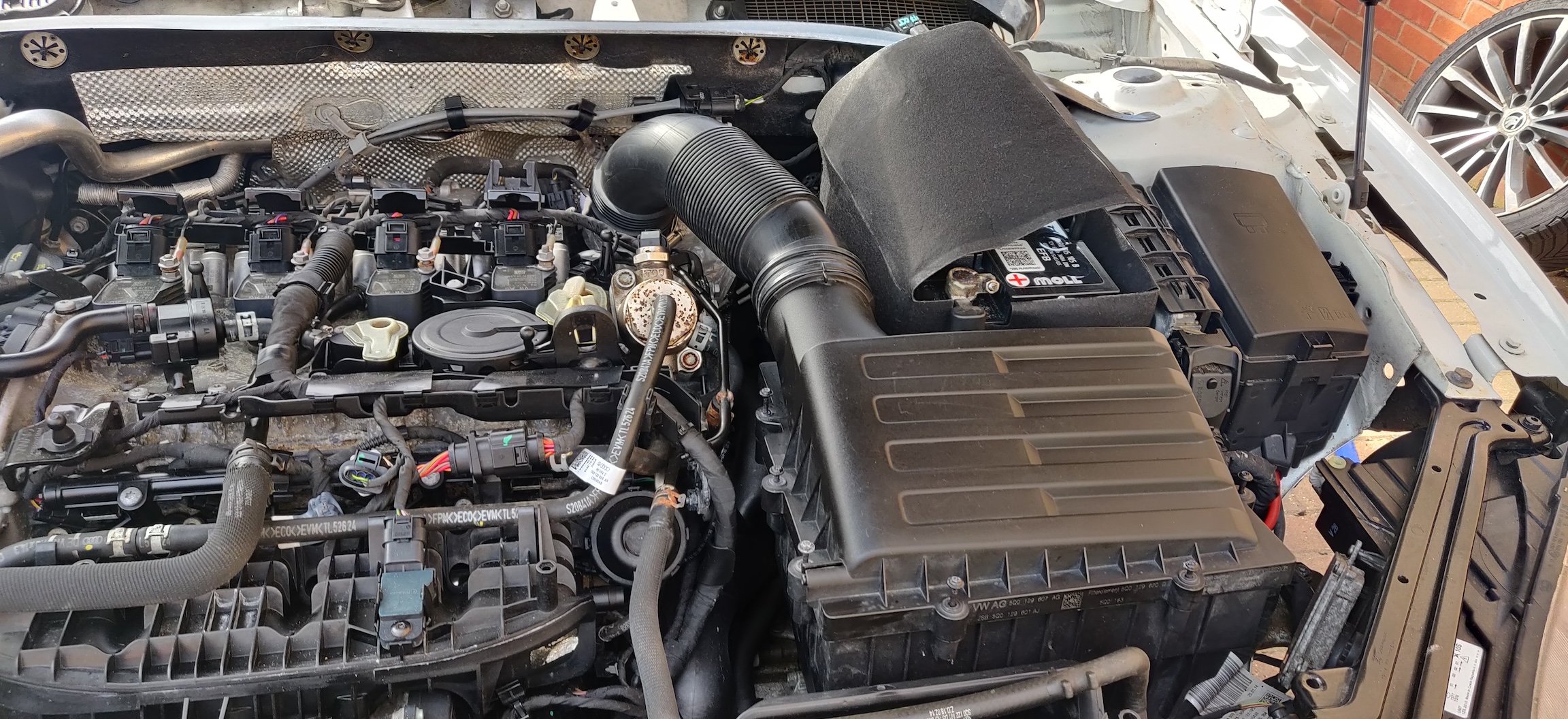

Then took the air filter and inserted it:
Then dry fitted that to the engine bay:
Will need to get the plastic front air intake bit in alongside the filter housing as I'm sure there's a specific order for it all.
That's probably it until the weekend for now unless there's some other small easy wins I can do in the meantime.

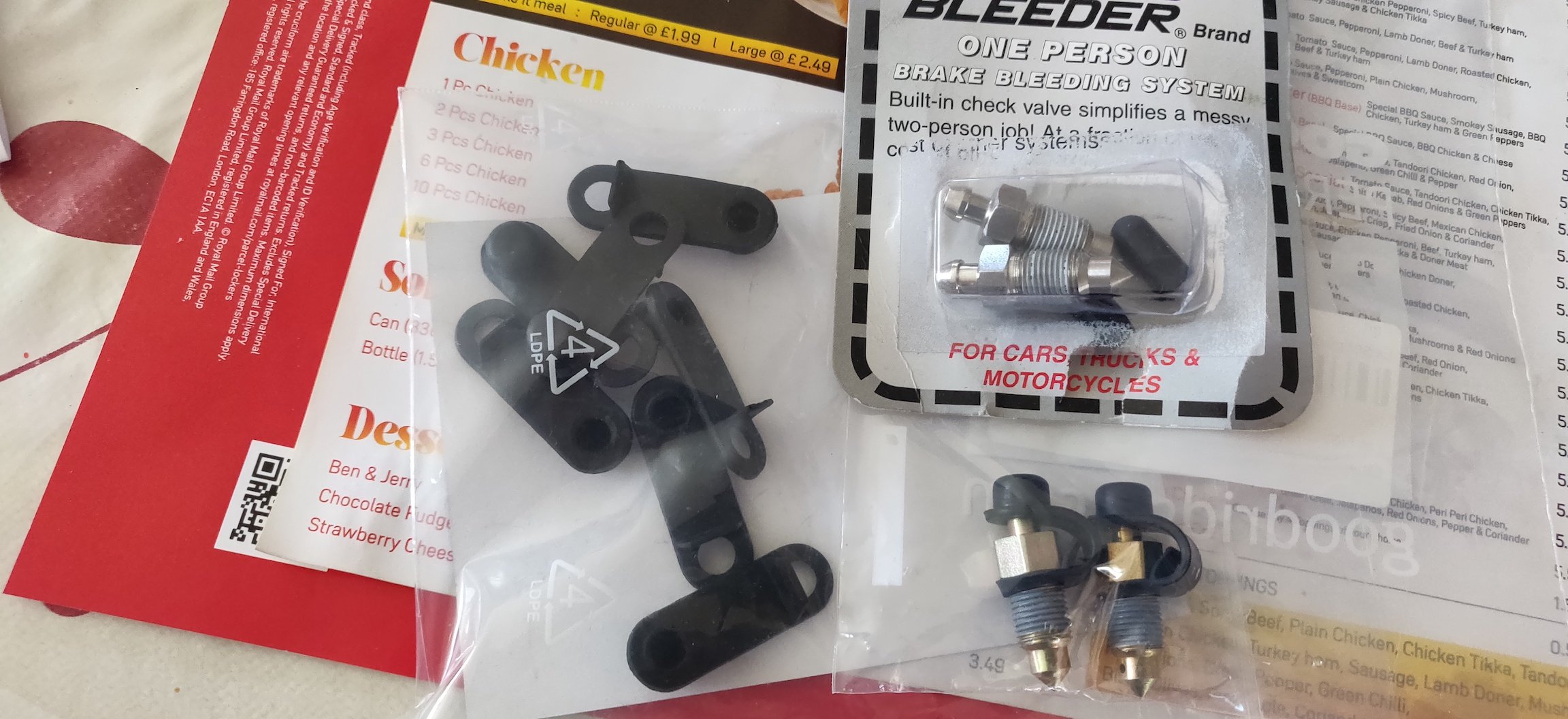

Also got these:
There was a pair of stainless speed bleeders on eBay which I jumped on, only to find that I wasn't able to source another pair of stainless ones. Previously, I've always been able to get them from the US, but upon ordering from their website, I got a refund due to them not having sorted out UK VAT stuff apparently. Most interesting.
So got some normal ones from eBay instead. So the stainless ones were £14.50 and the other pair were £25.04. The former being cheaper was probably due to being something lying around and the seller just wanted rid. Don't think it matters at this stage, one day the calipers will probably get refurbed and then I'll revisit whether I go fancy or consistent with these bleeders or whatever.

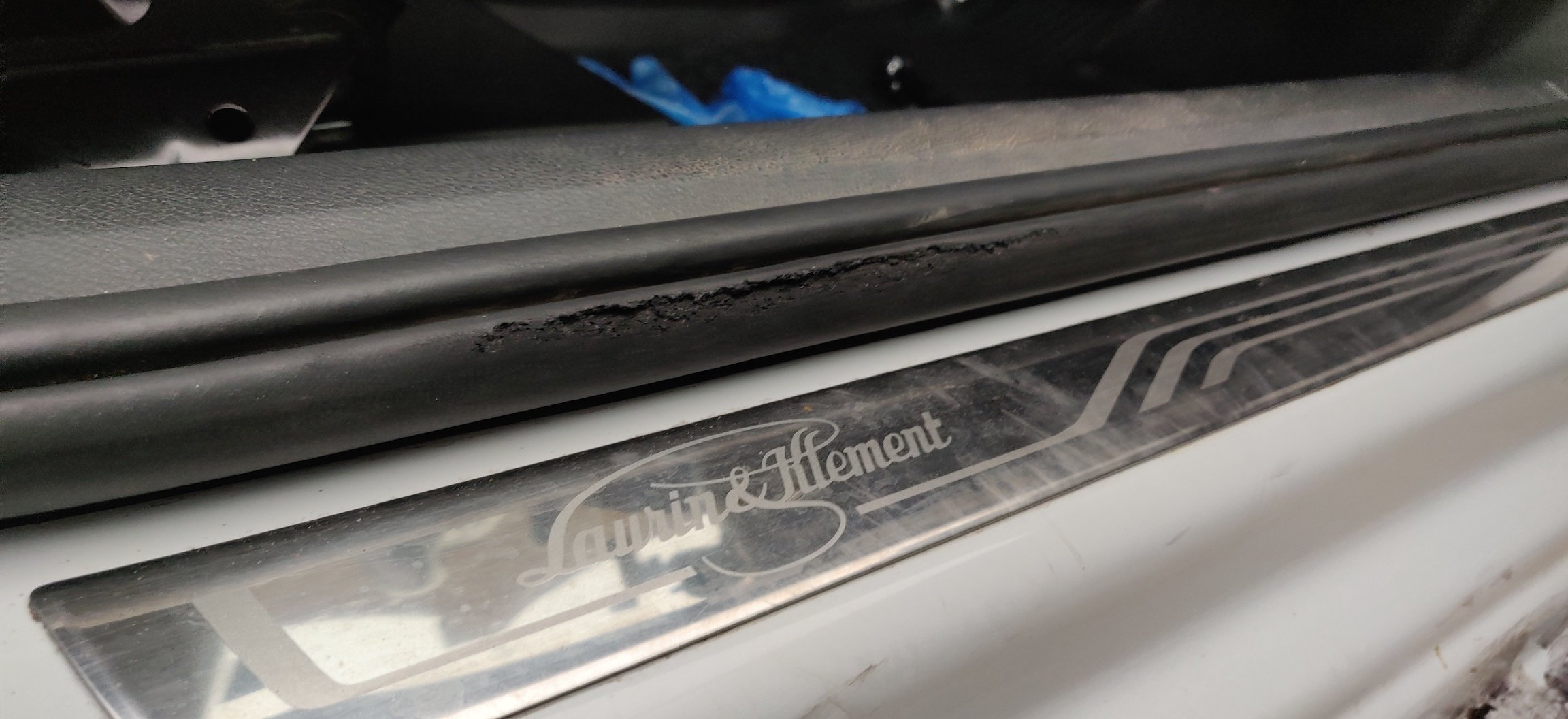

A pair of door seals. These were £94.05 for the pair from eBay, which to be honest, probably could have been cheaper via Skoda Parts or lllparts, so don't know why I thought to get them at this price.

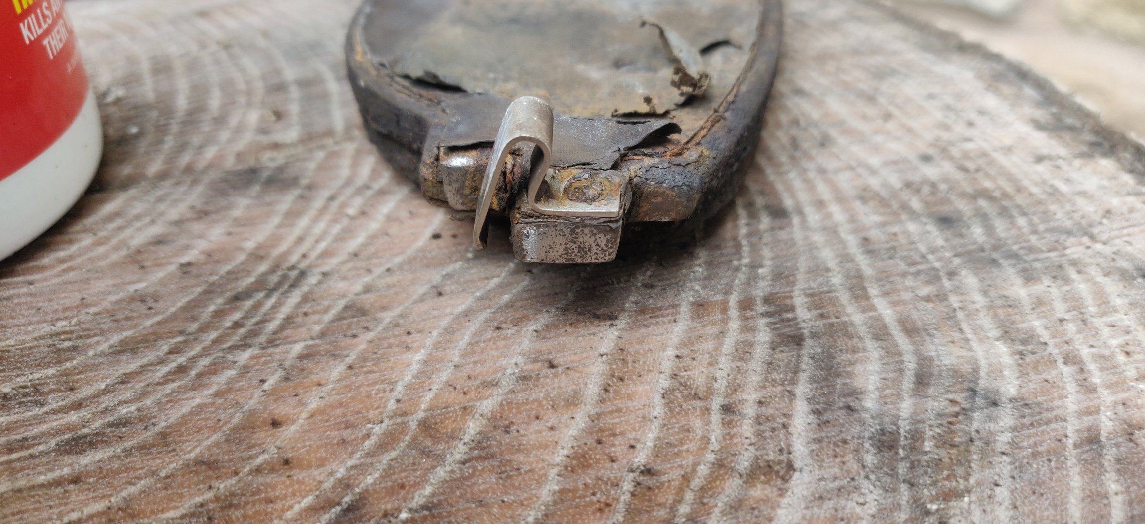

This is mainly to address this:
Just some weird chewing of the door seal on the drivers side, so figured swap both out as a pair. Pedantics really.

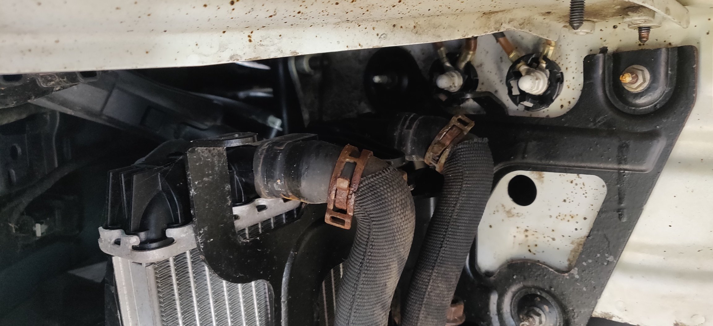

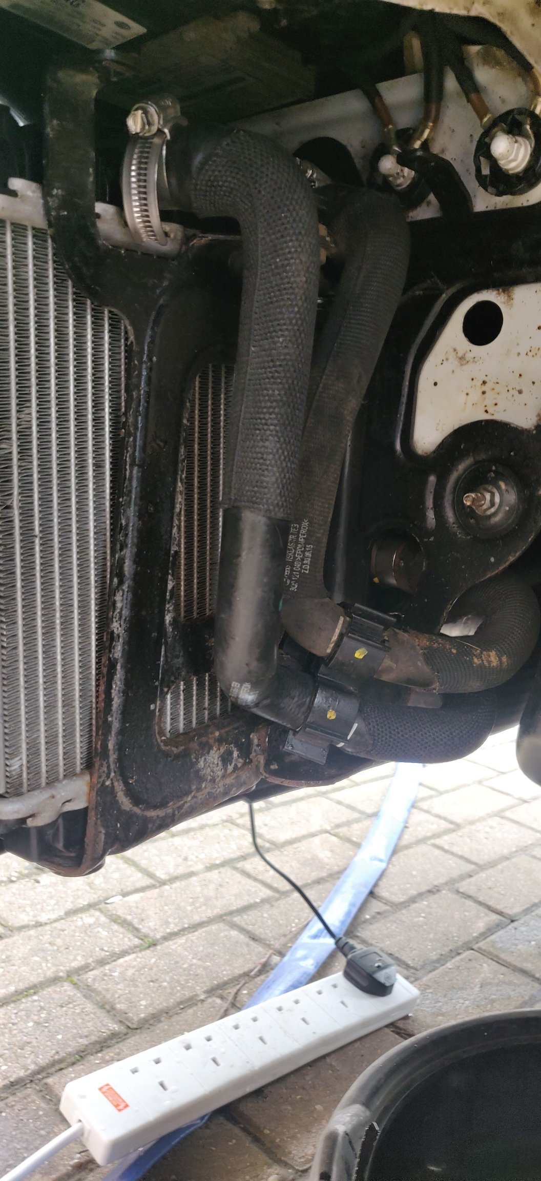

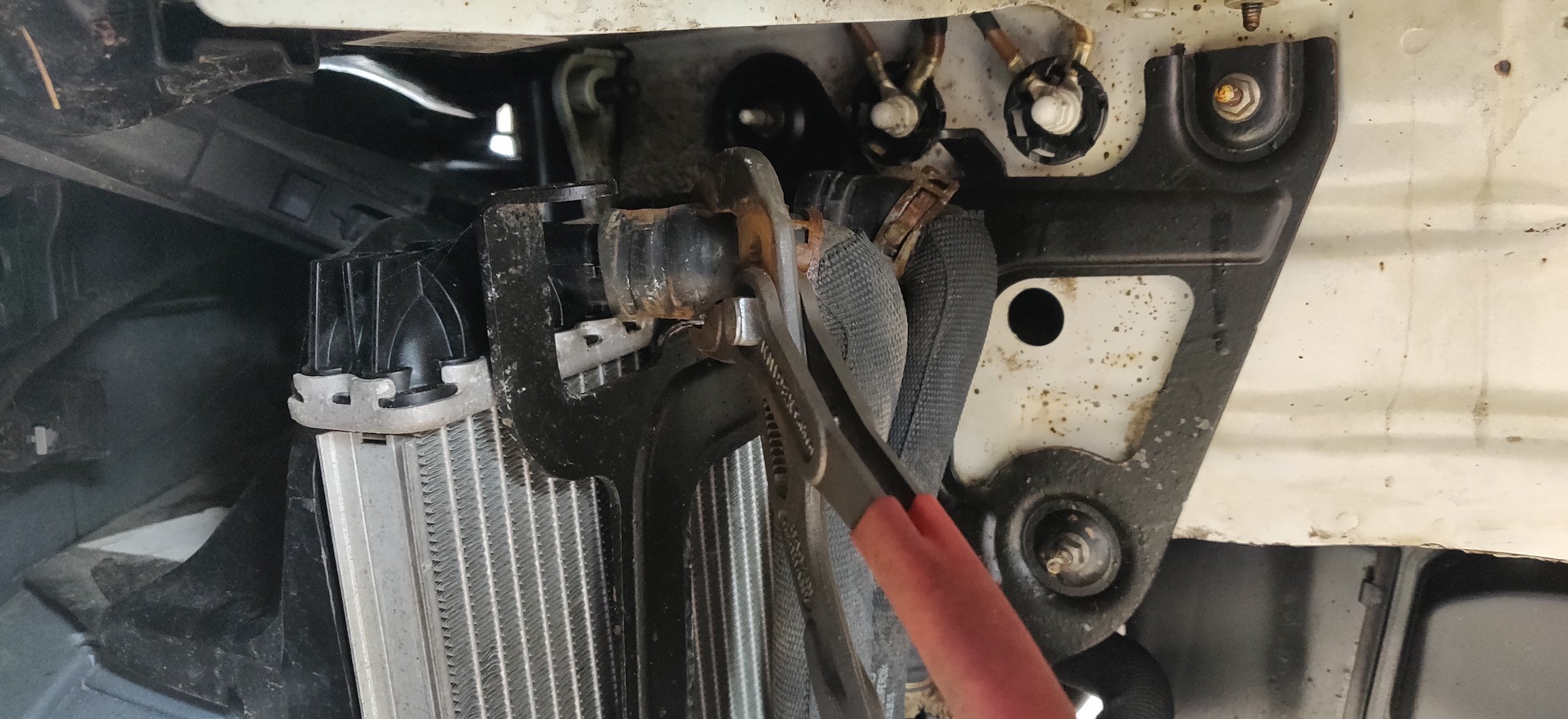

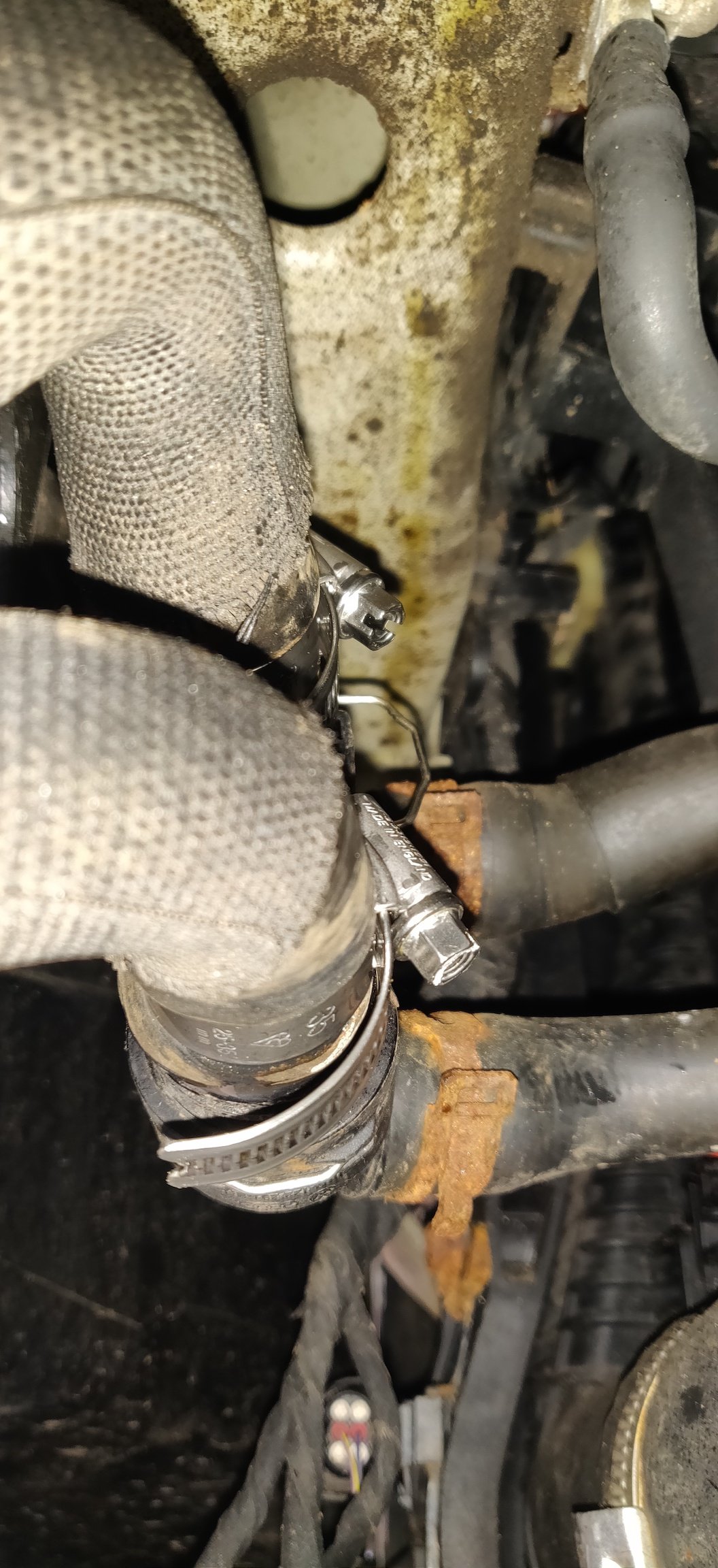

Anyways, after work, decided to tackle the coolant hoses which have been disconnected for a while. This is mainly so I can actually start filling it up and also hopefully allows me to start assembling the undertray and wheel arches (sort of).

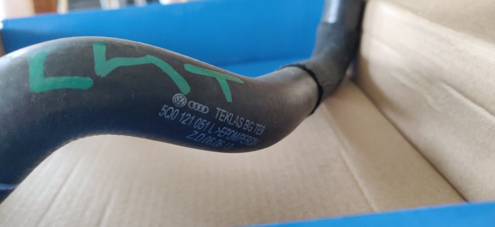

So on the left:
Got some pliers to take the spring clips off:
Then I used the pliers around the hose and very gently wiggled the hose and rotated to try and loosen it. If it starts squeaking, that's usually when it's starting to separate.
Then continued to wiggle and pull them free.
Once out, put the new clamps on and put the hoses back into place:

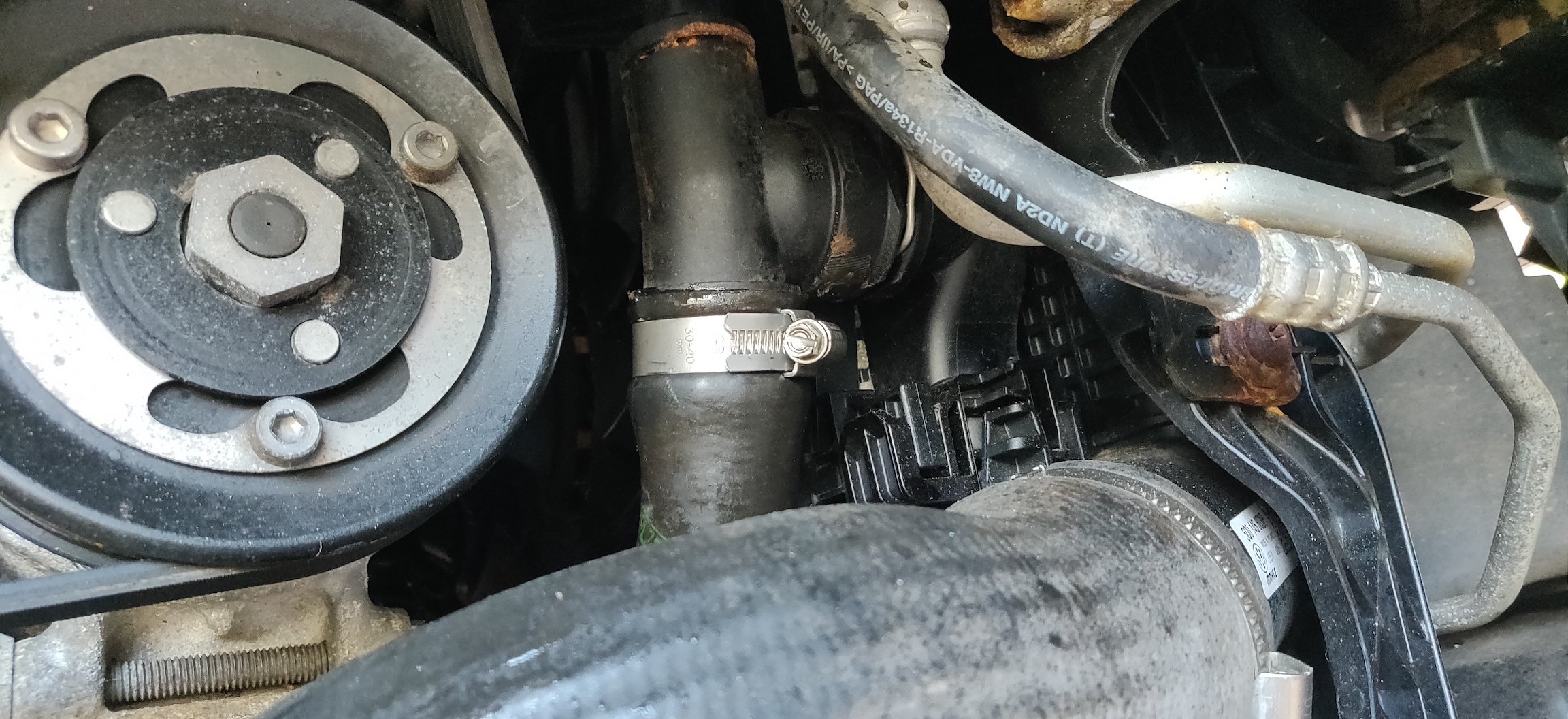

According to the JCS Hi Grip brochure https://www.jcshi-torque.co.uk/wp-content/uploads/2022/03/JCS_Hi-Grip_brochure-1.pdf it suggests that these sized hoses are tightened to 5Nm, so went and did that.
You can see from the pic above that the 25-35 sized hoses, whilst tightened fine, does seem to have quite a large bit of excess, so it may well be possible that a size or even two lower could be possible. Something for the future to be honest (all things going well, it'll be 4 years before these are revisited).
So the two above were only changed because they're easily accessed, rather than the main ones, which are on the other end of those hoses:
So the other side is shown here. I've tried my best to position the hose clamps so they're easy to get to in the future. The pic amusingly shows the other side of this quick connector with the OEM and rusty spring clamps, but would it start being overkill to fit clamps there as well?

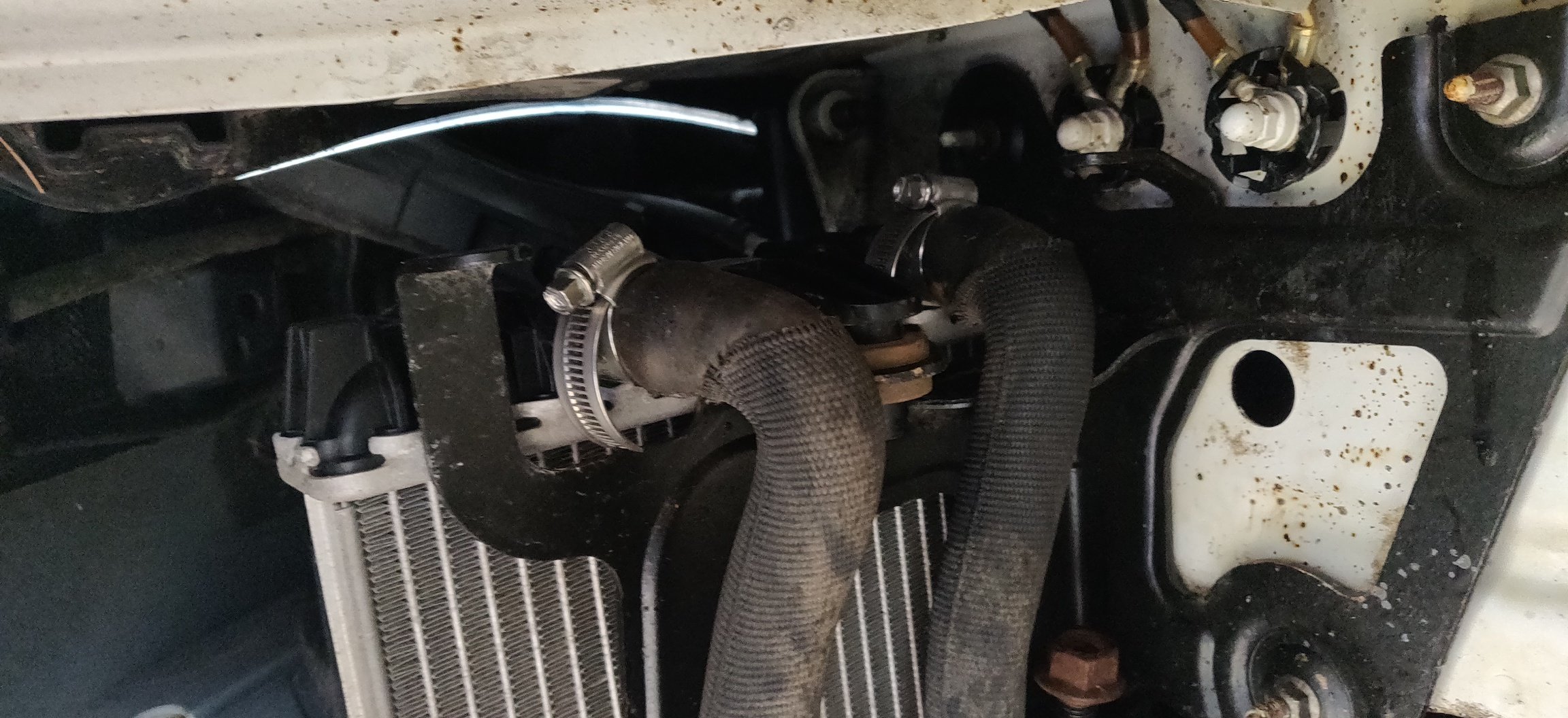

Anyways, went to the other side for the radiator hose:
So detached the hose, put the clamp on, and then put it back to the quick release part near the radiator:
Hopefully positioned so it's much less stressful to undo in the future.

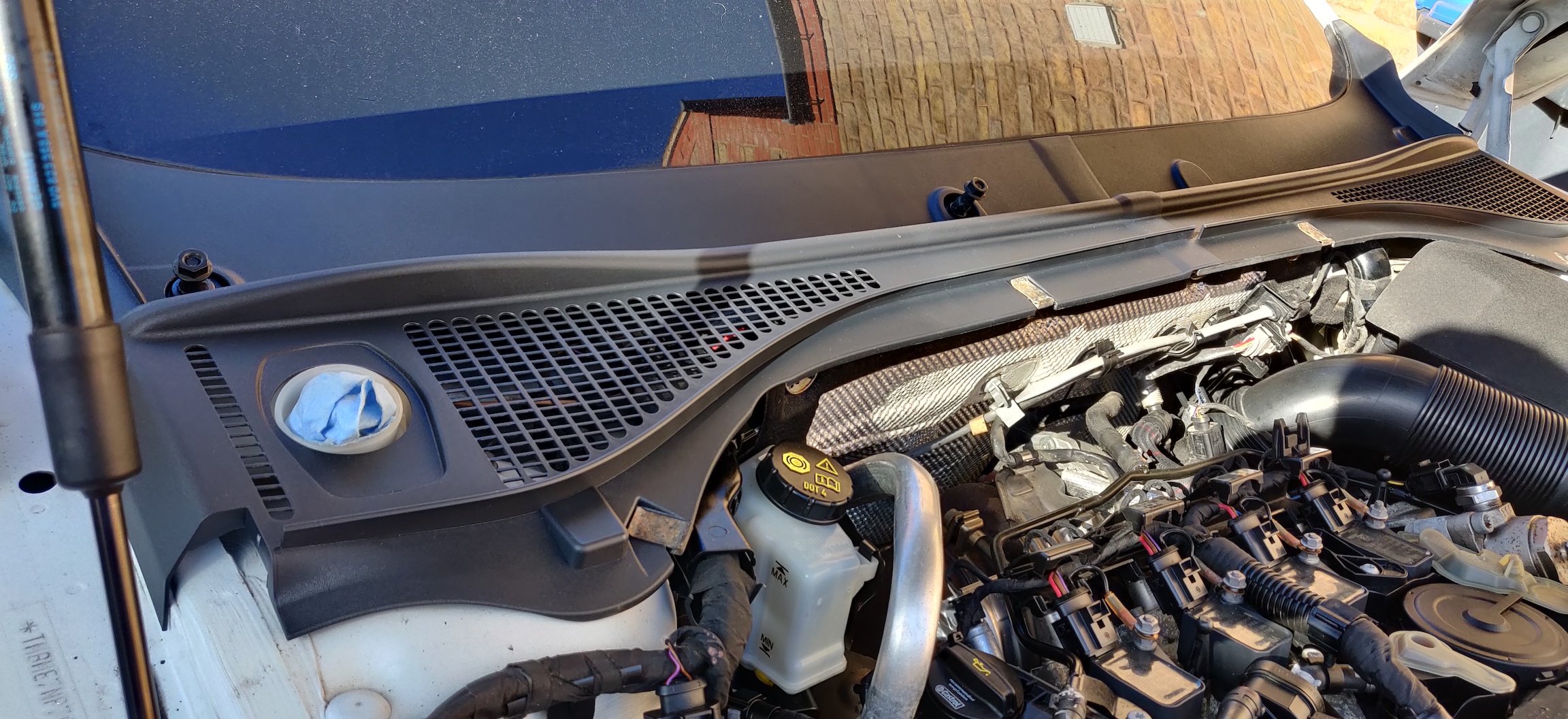

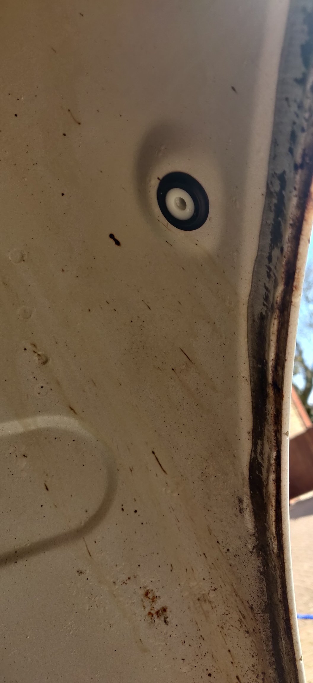

Technically, I don't think there's anything stopping the passenger side wheel arch from going back on the car. I think for now though I'll wait until the engine is fired up in order to just be sure the coolant isn't leaking around these newly clamped hoses.
Not much to do for the coolant now, I'll leave it until tomorrow, so went back to the top of the engine:

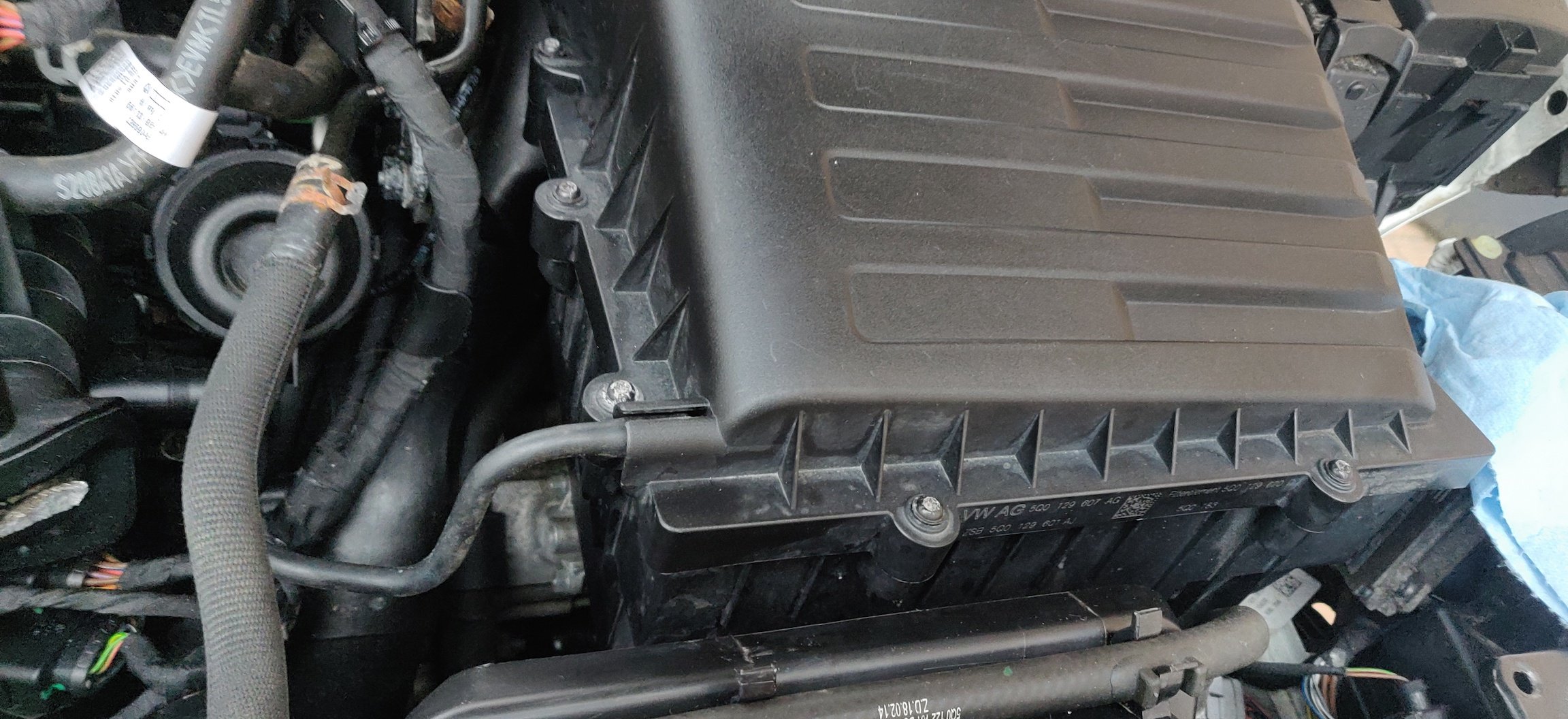

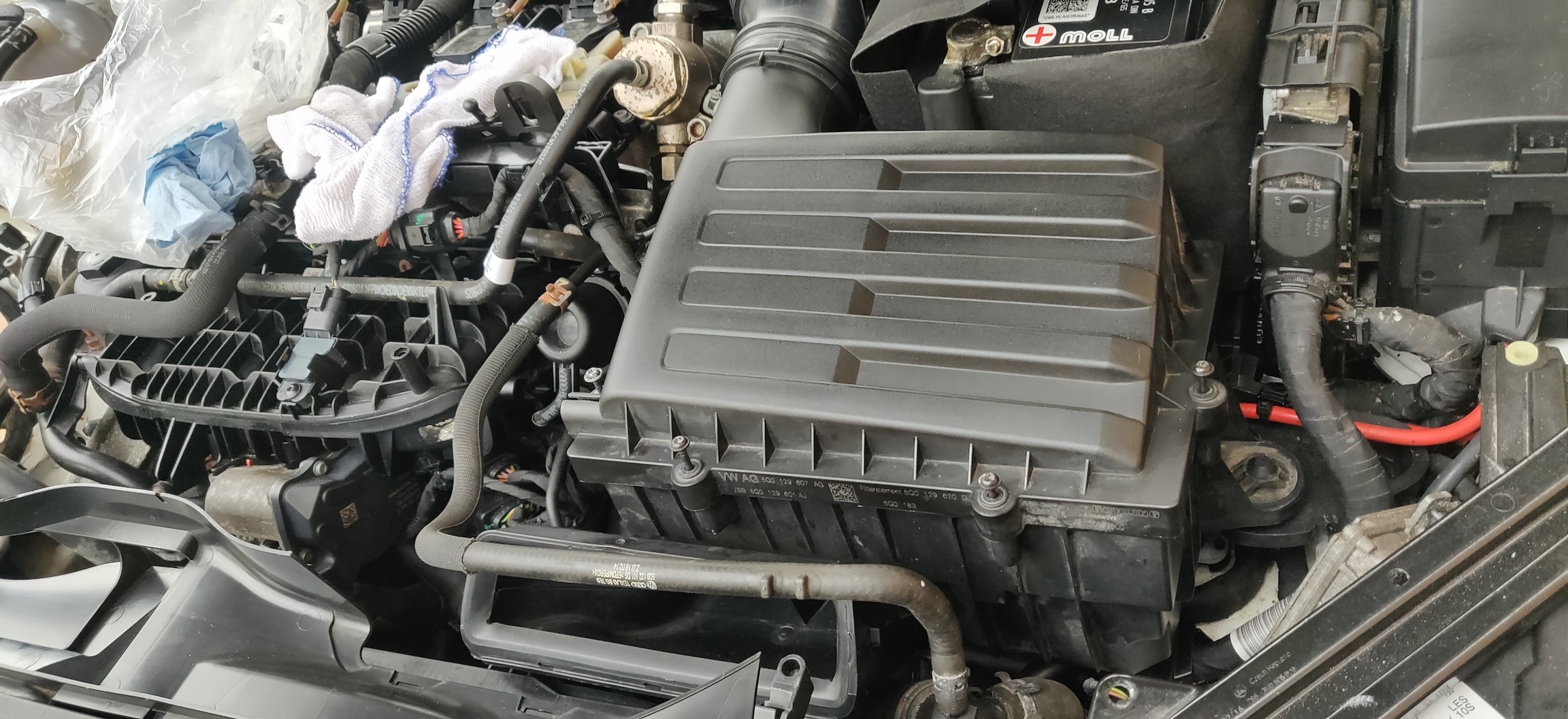

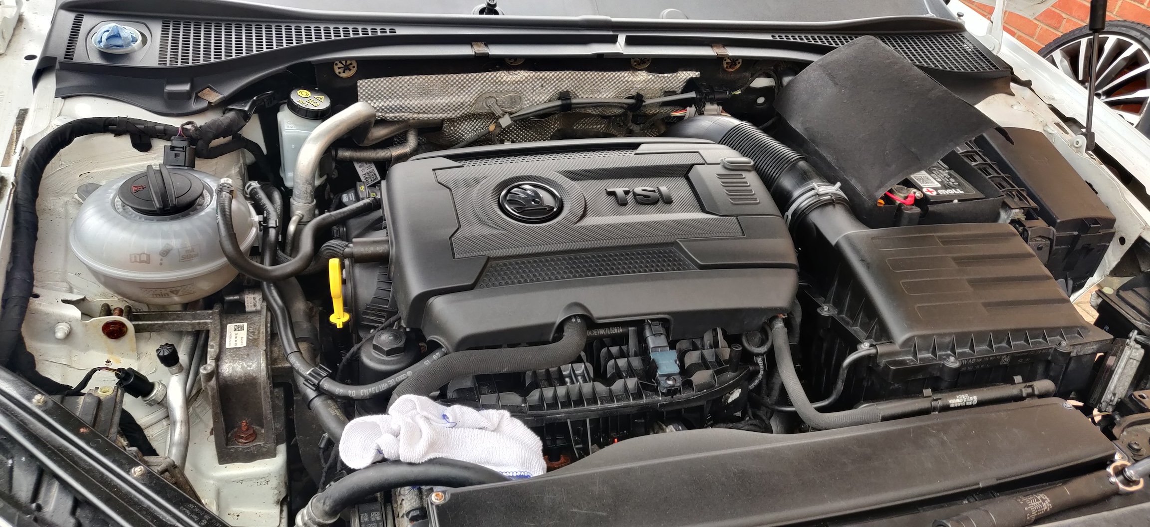

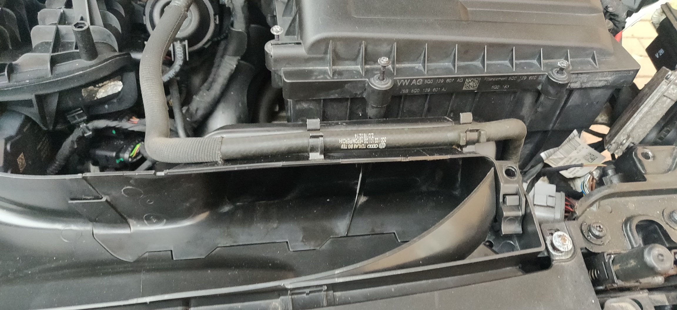

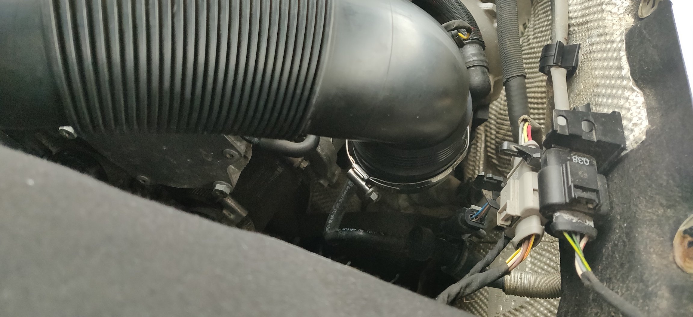

Fitted the air hose from the housing to the rear of the engine, and tightened up the hose clamp, this time facing the opposite way so I can actually do it up without it being a pain.
I then pushed the air filter housing in:

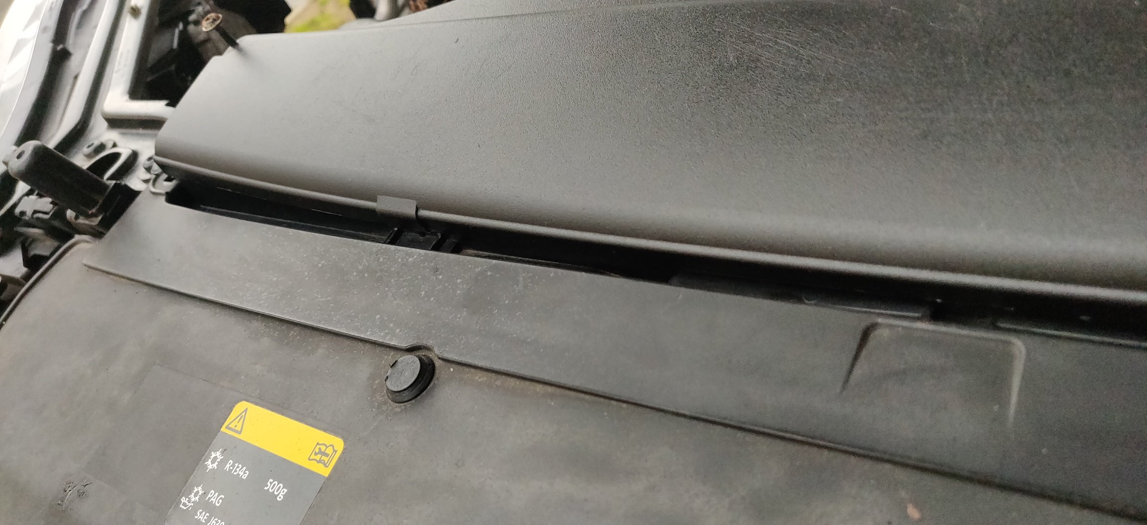

I then immediately lifted it back out again, because:
This part of the front air guide kinda needs to go in at the same time as the air filter housing, it'll clip into the bottom part of the air guide after some faff.
Once done though, the upper part can then go in, starting with the two tabs at the front:
Then pushing the rear tab into the bottom latch:
That should be it:

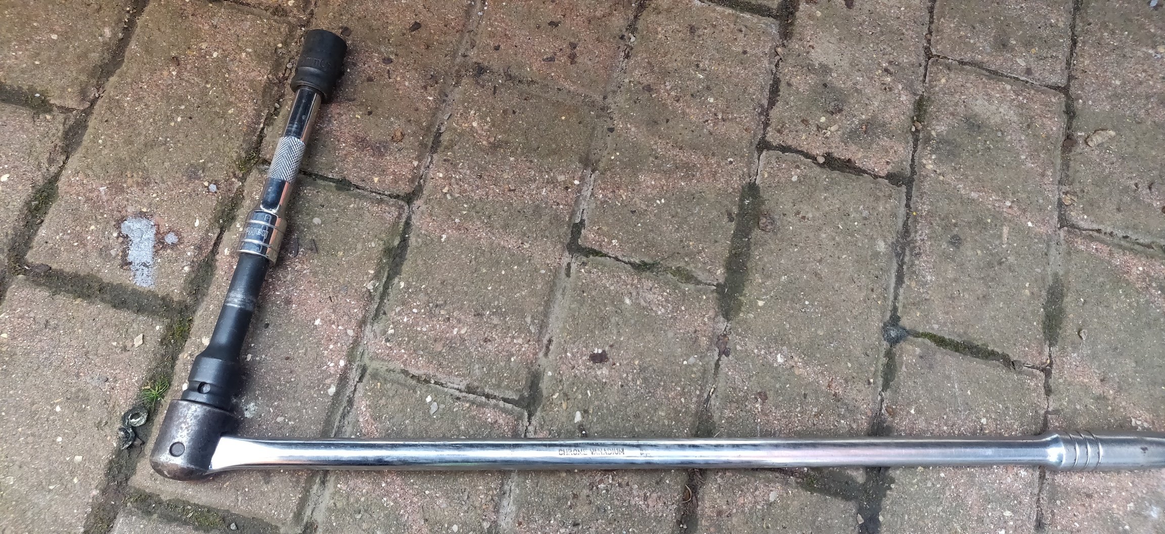

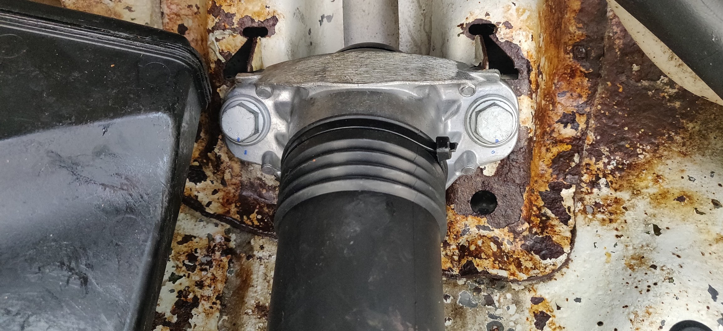

So then it's a case of tightening up all the bolts. They are all T20 torx screws.
The workshop manual specifies 2Nm, which is to be honest, feels less than hand tight. So a delicate torque wrench is needed and care so as to not inadvertently overtighten, although it doesn't really matter for the air filter housing I imagine. You'd have to be tightening it up something special to break the air filter housing.

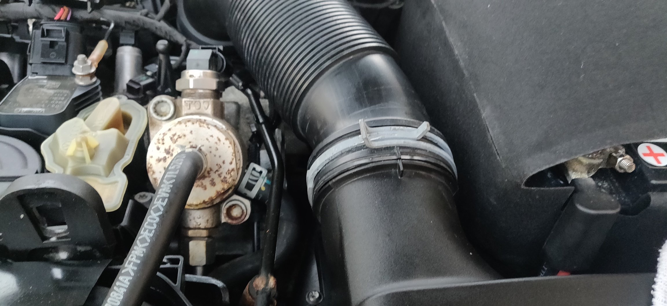

I then had to figure this:
This particular spring clamp was quite awkward. I had to eventually involve two Knipex pliers, one set with a wider jaw, to essentially start compressing, then with some faffing around, transfer that to other plier to compress it further in order to get it large enough to get back onto the hose. Not safe in the slightest.
It'll be much more easier to just get a normal hose clamp in the future I reckon, so that'll be on the back burner.
So other than fitting the vacuum hose back into the housing:
That was that. Most of the servicing is pretty much done now!

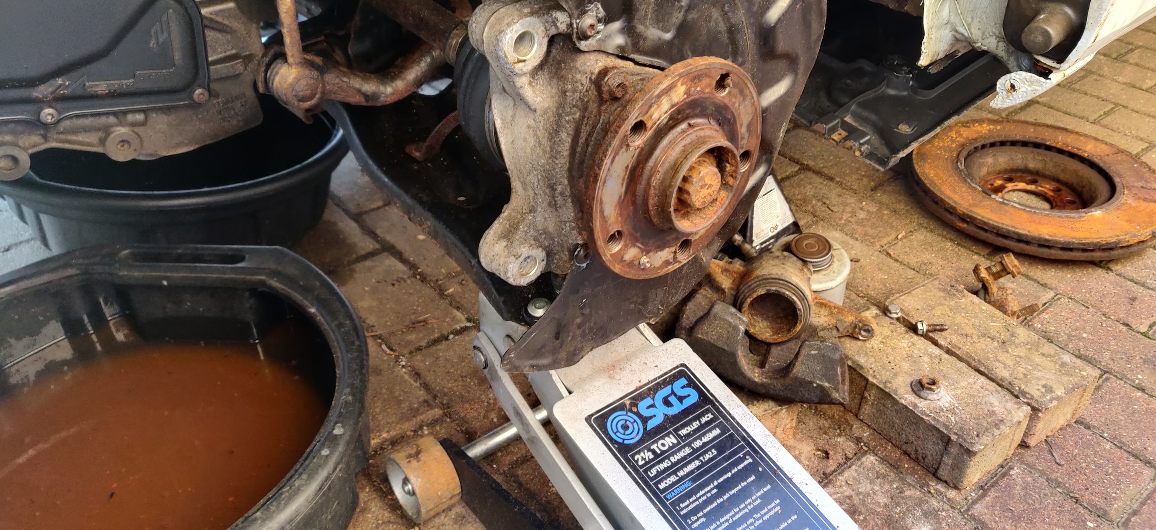

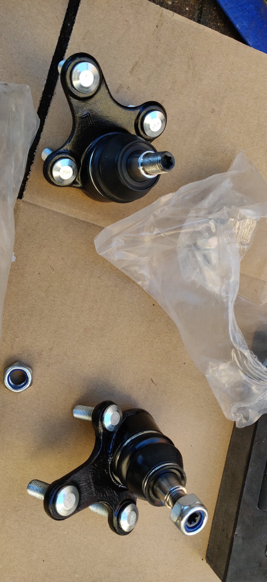

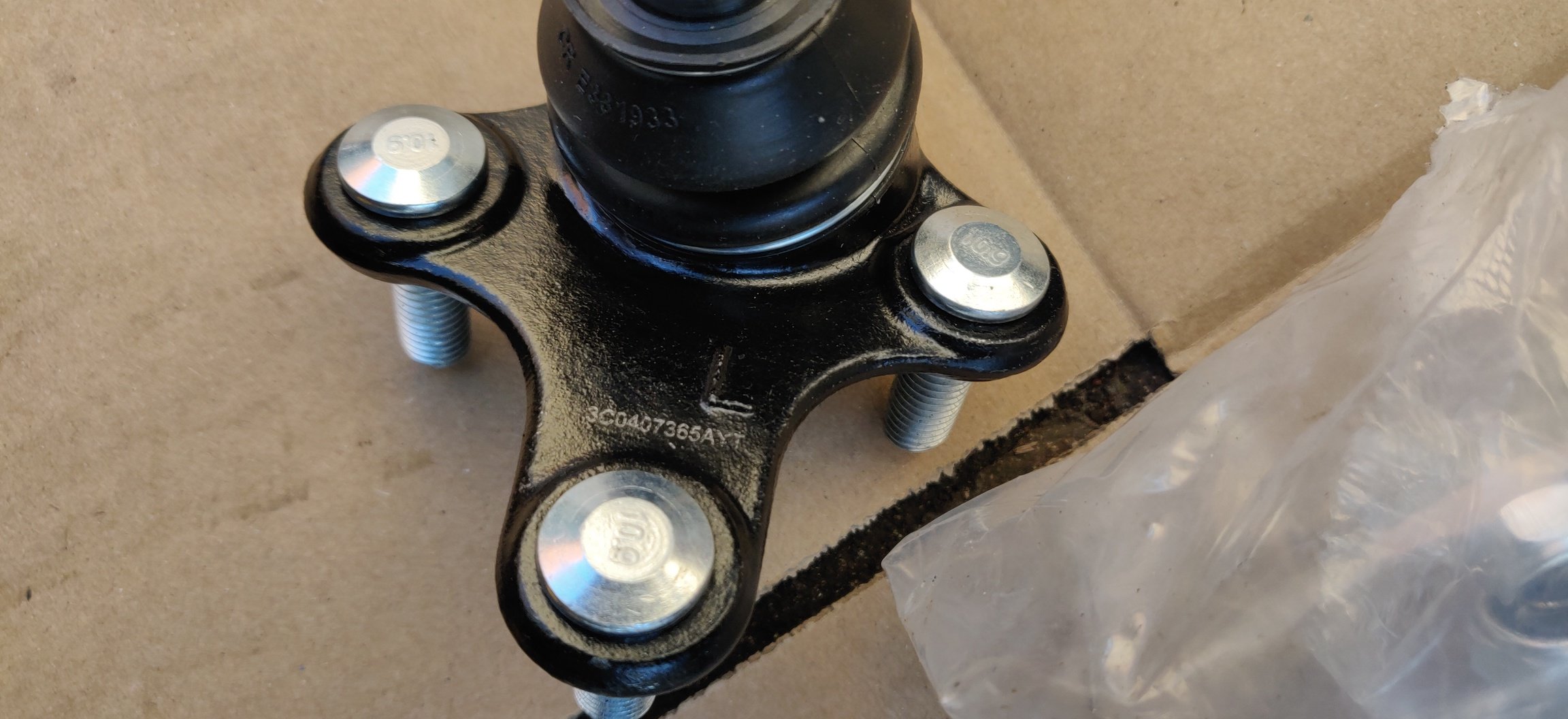

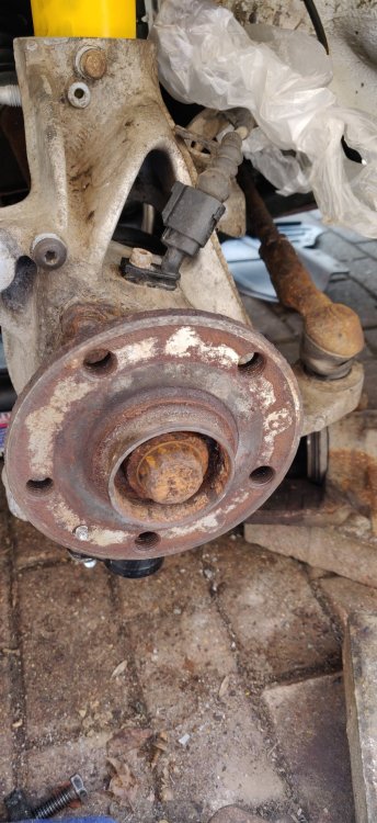

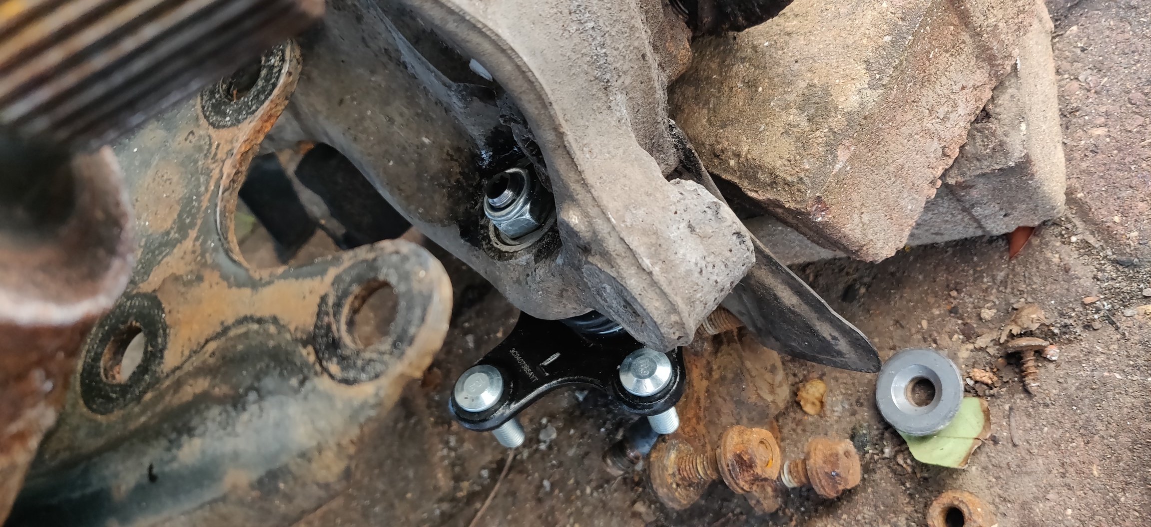

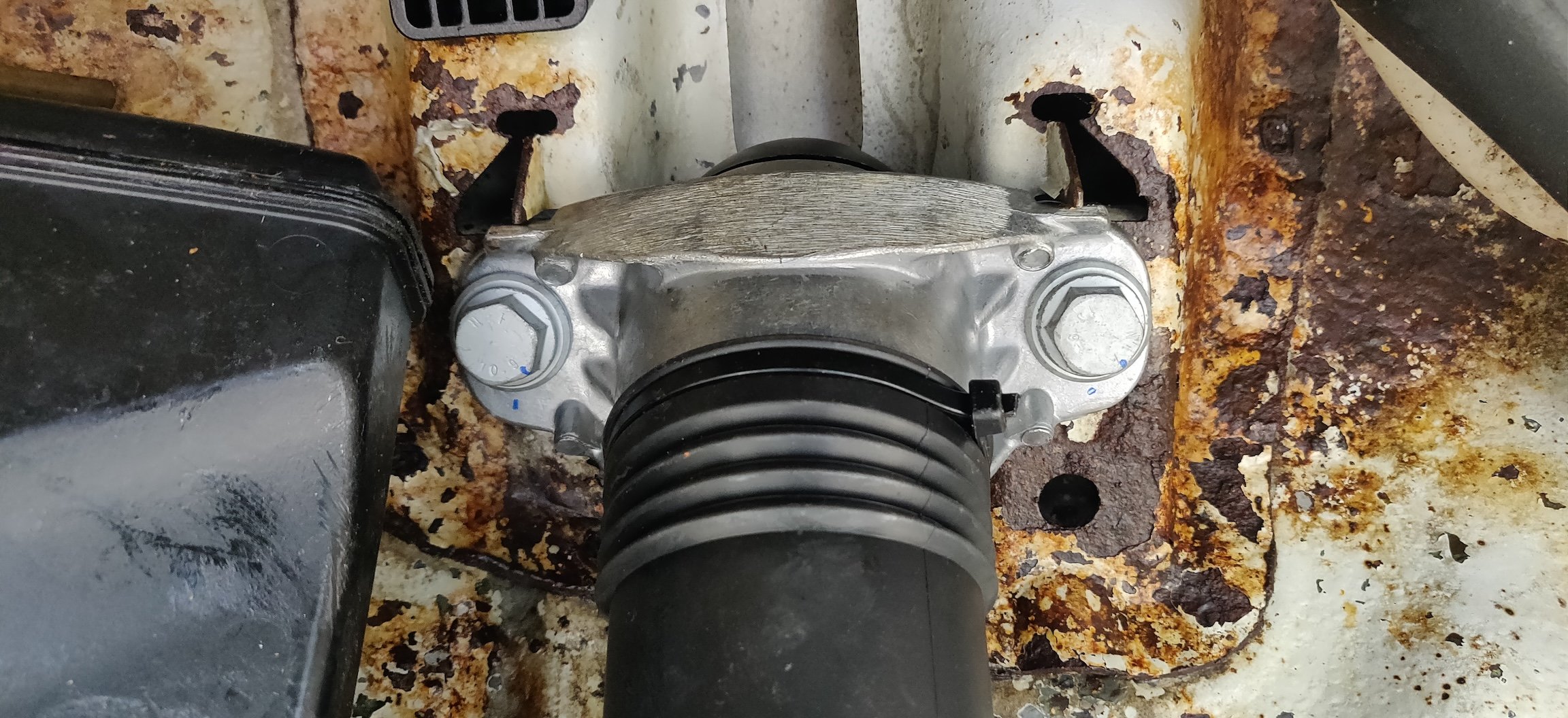

Got the balljoints purchased earlier out and ready:
Workshop manual mentions they should be labelled:
Just the one had a "L" labelled which presumably means the other is for the right, so went and started on the left side:
Just wiped some corrosion block grease on the hub where the balljoint goes through and started tightening the nut for the ball joint. It was 19mm for these aftermarket ones as opposed to 21mm for the OEM ones.

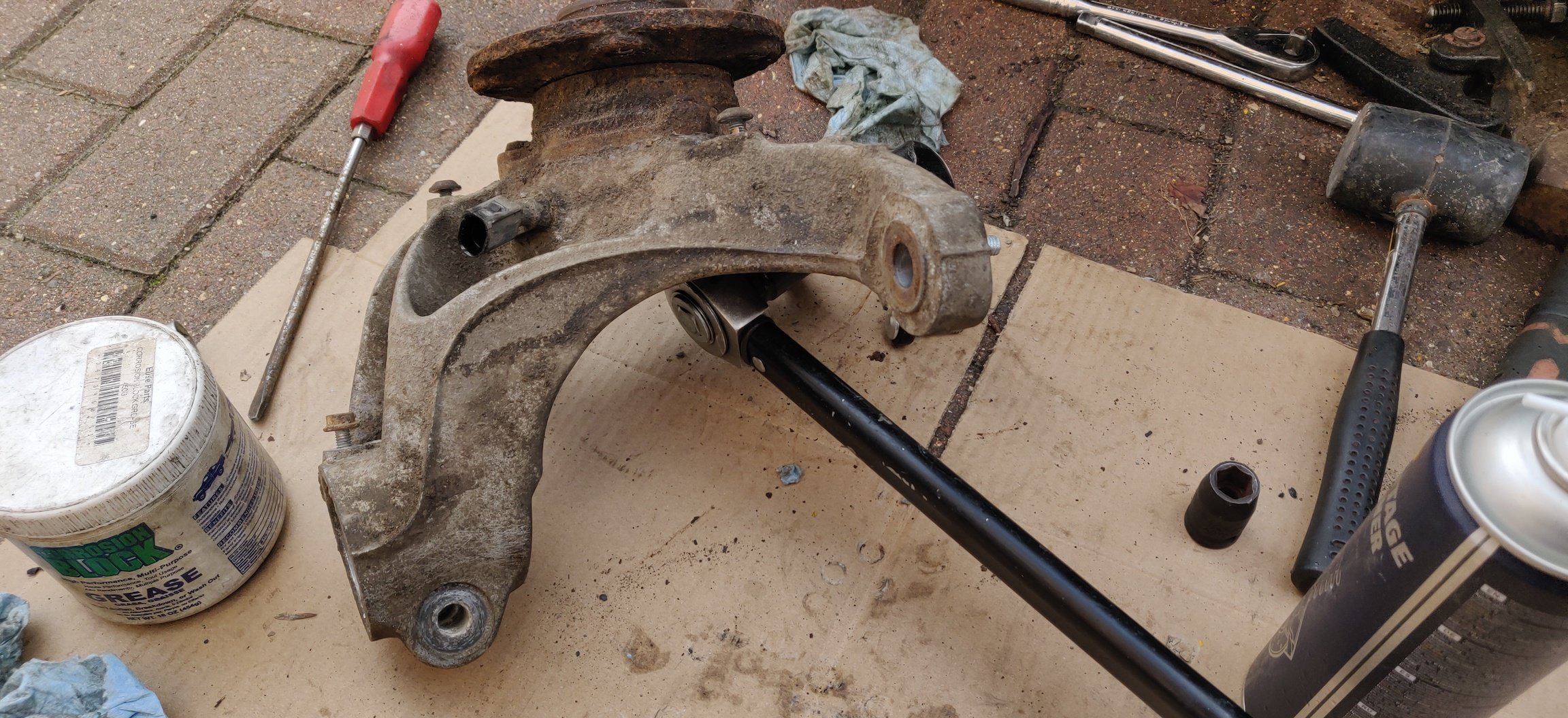

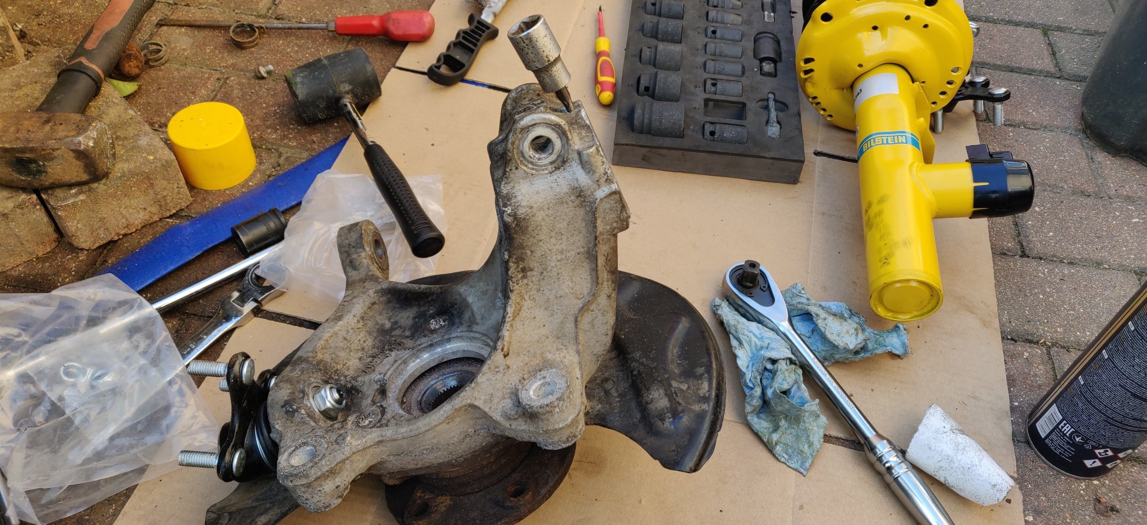

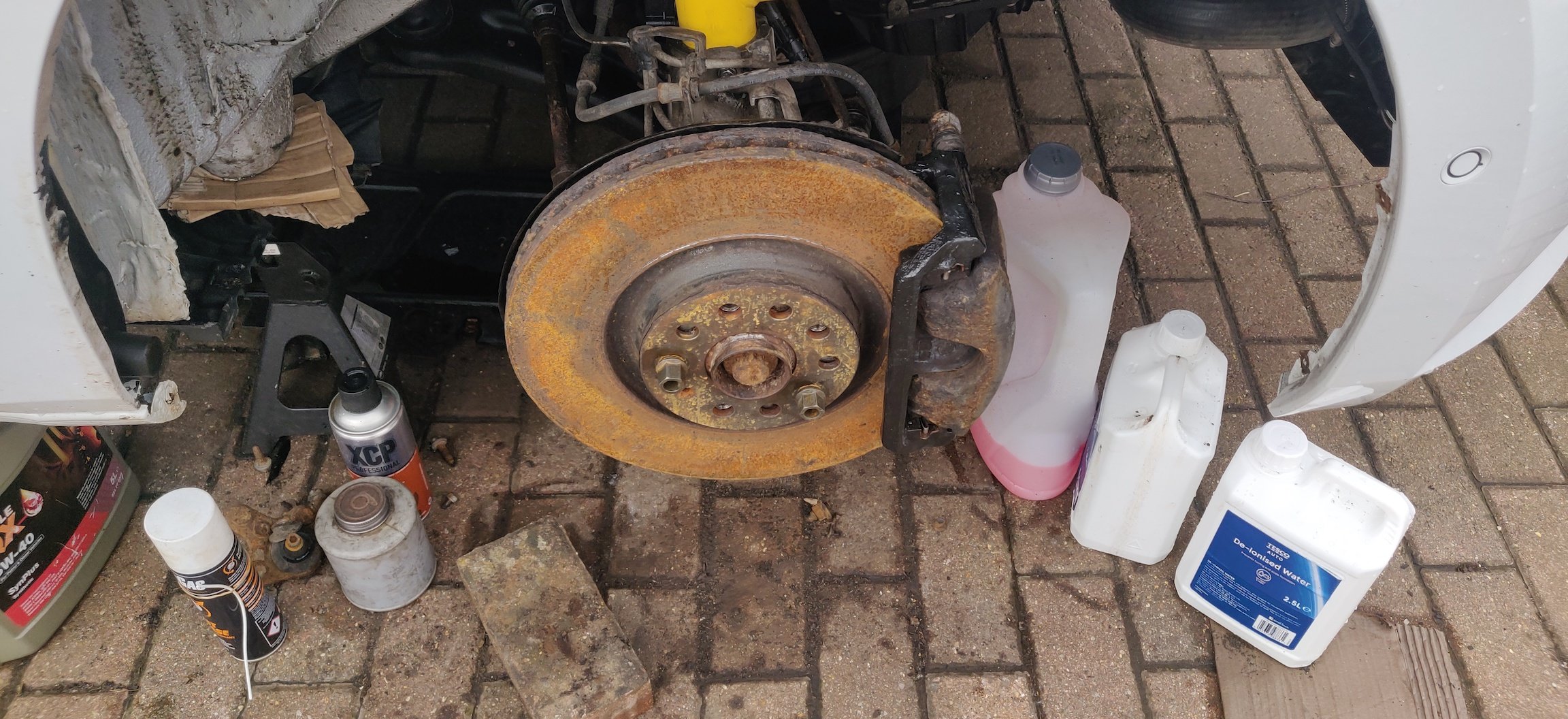

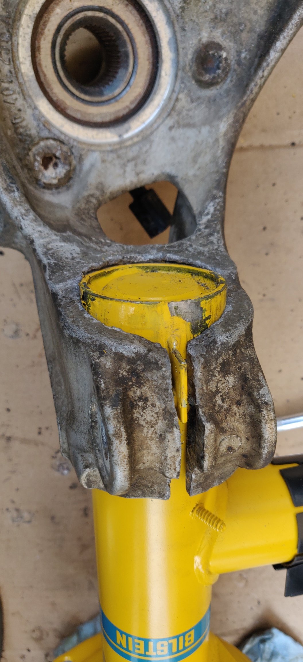

I then started to prep for the strut:

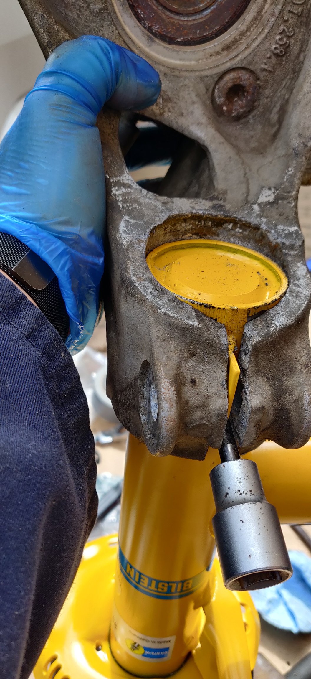

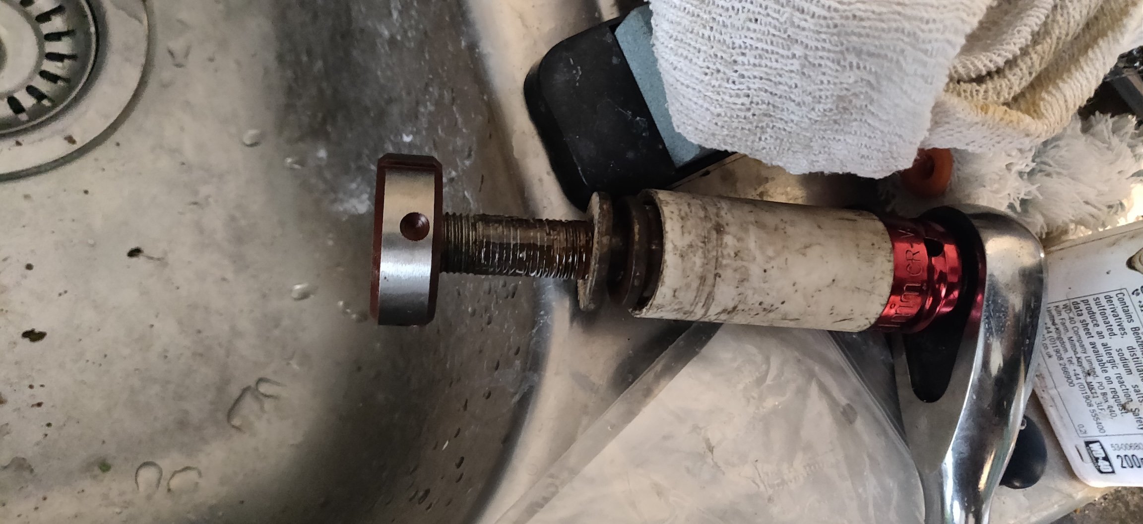

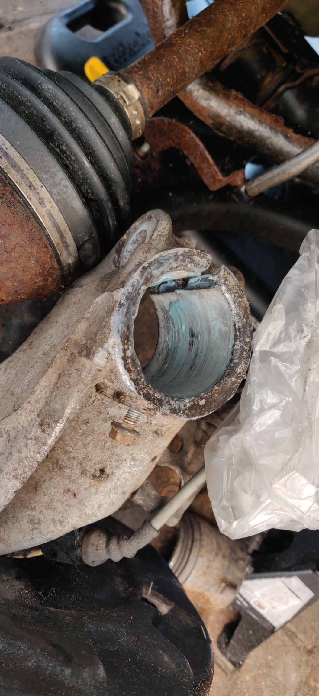

Gave the inside of the sleeve a quick sand down with some abrasive lying around (120 grit just because it was around), then gave it a quick clean and a wipe of corrosion block grease.

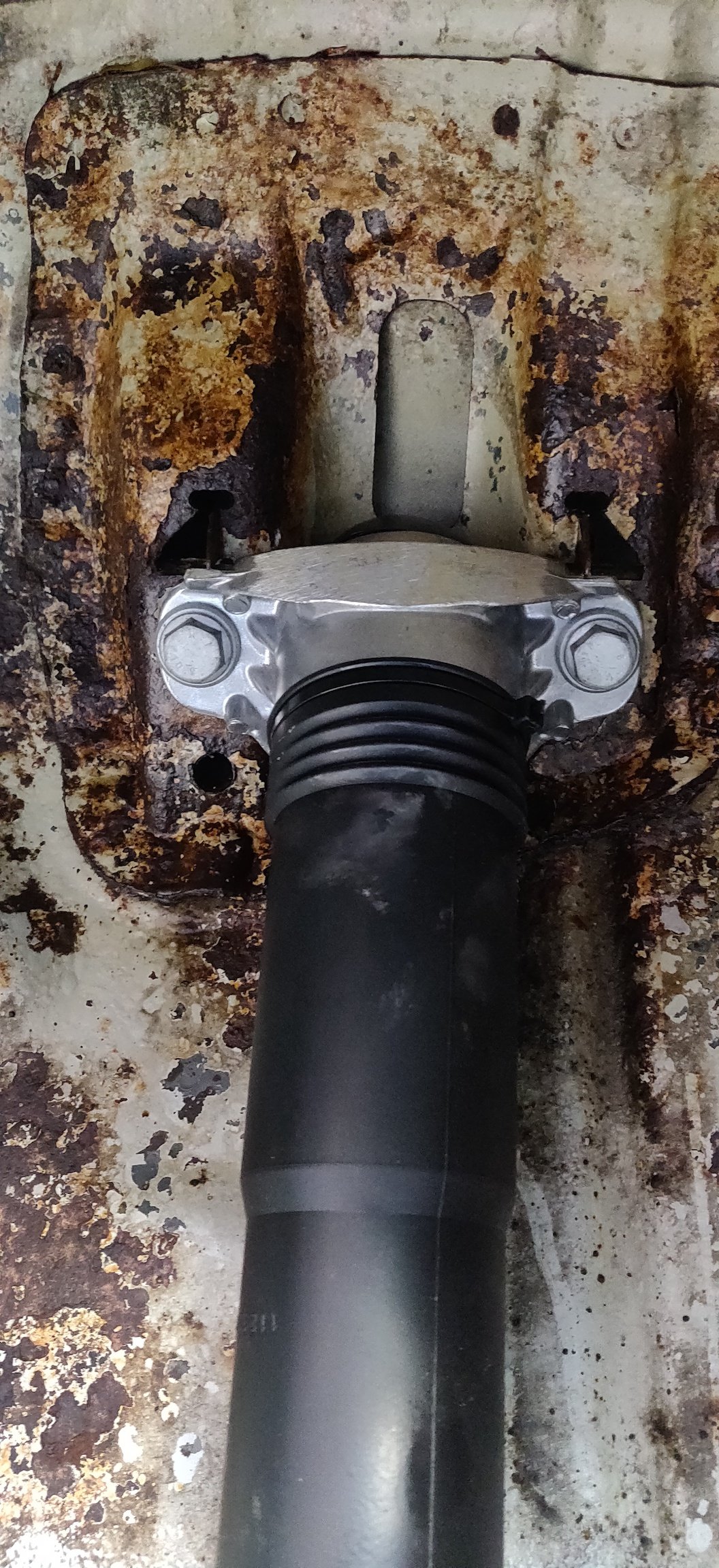

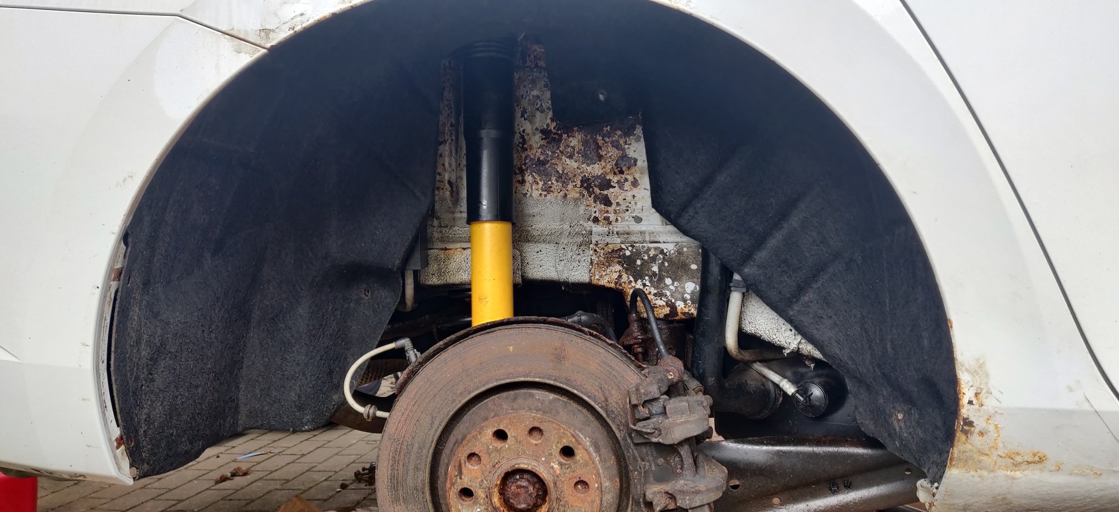

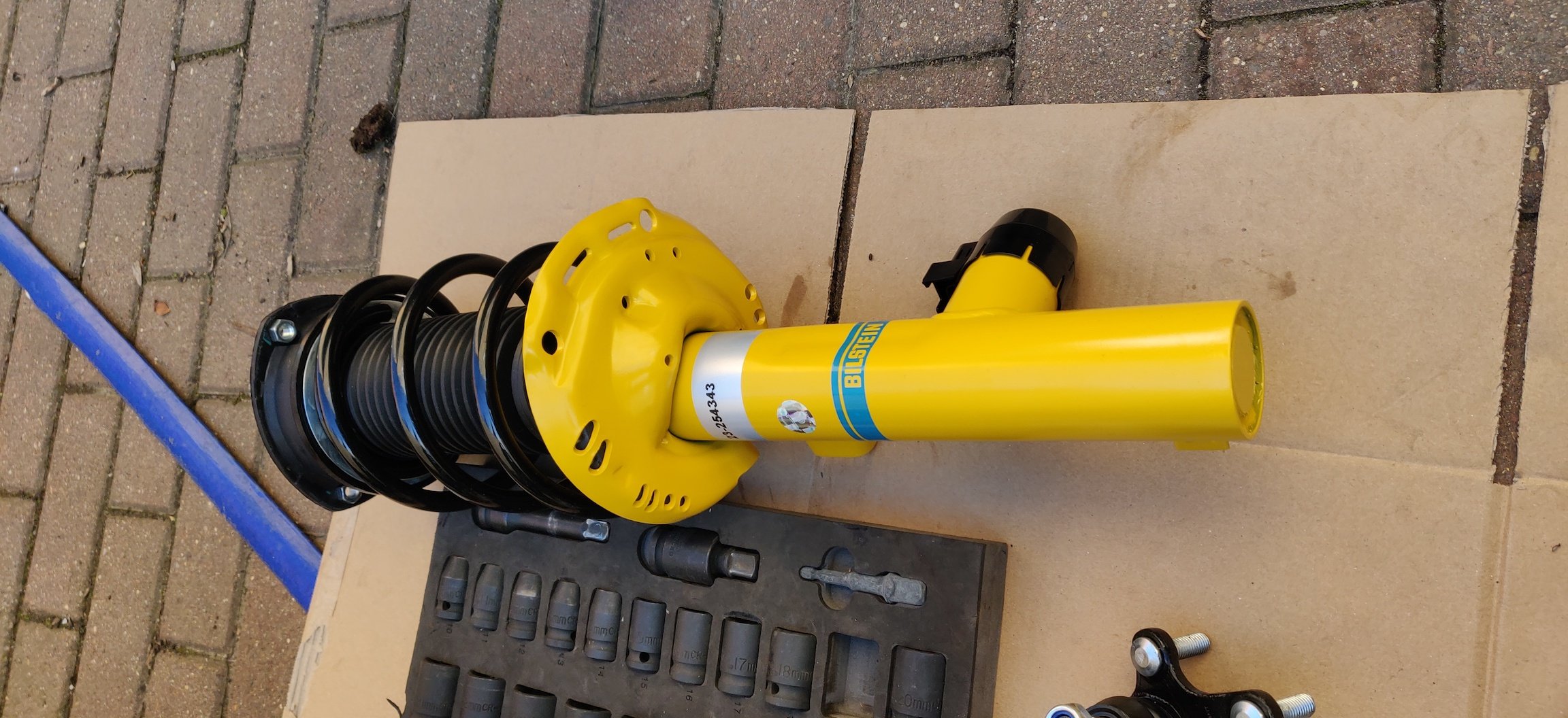

So time to get the struts out ready:
Normally, I'd expect that after using the spreader tool to stretch out the hub slightly, the strut should then wiggle into the hub, the reverse of removal:
No chance. Of course something was going to be more annoying than it needed to be. The strut would go in maybe a few millimetres but no more.
After a few attempt, I couldn't see any other way of doing this than to tap it into place with a mallet. This kinda meant I needed to remove the hub from the car.

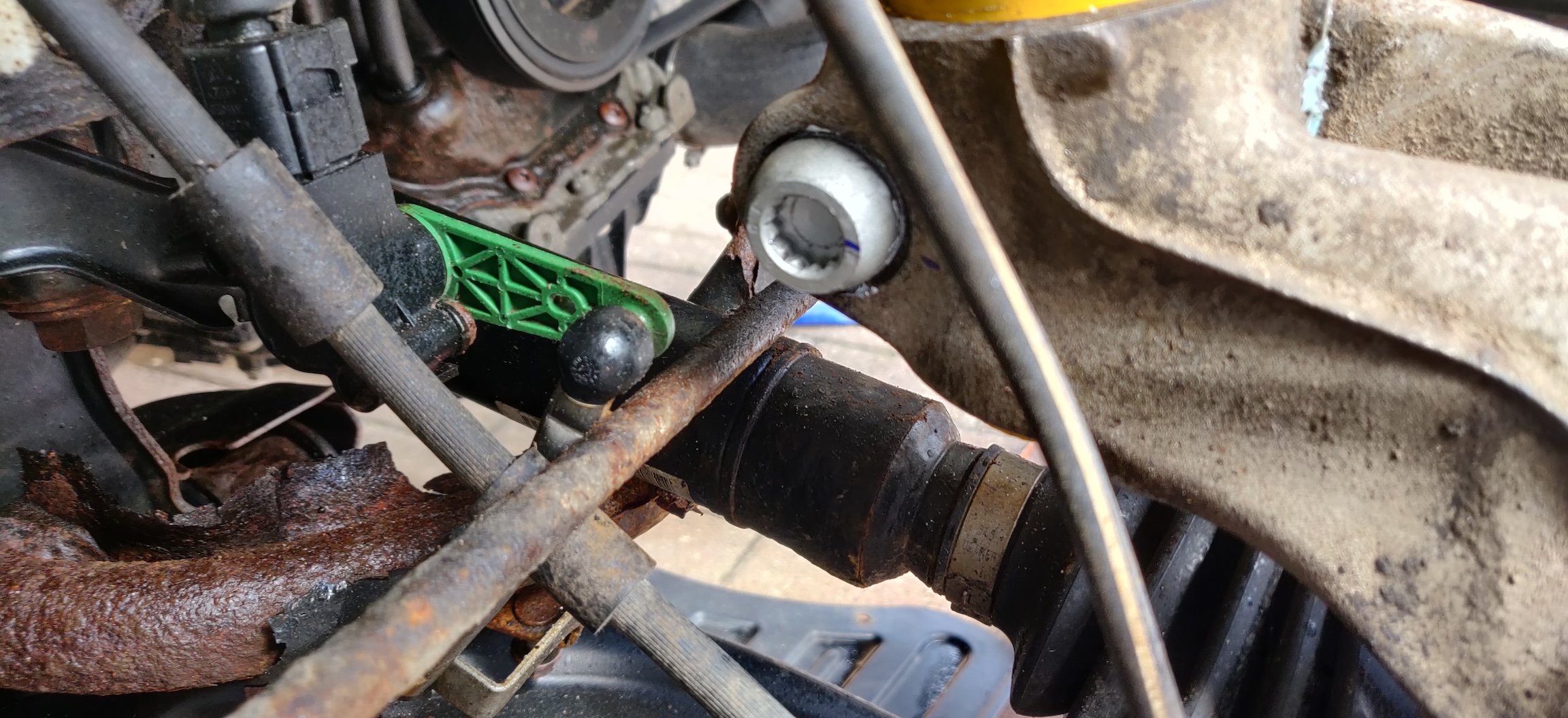

So there was an ABS sensor connector, just disconnected with a thin screwdriver, then buzzed out the track rod end nut:

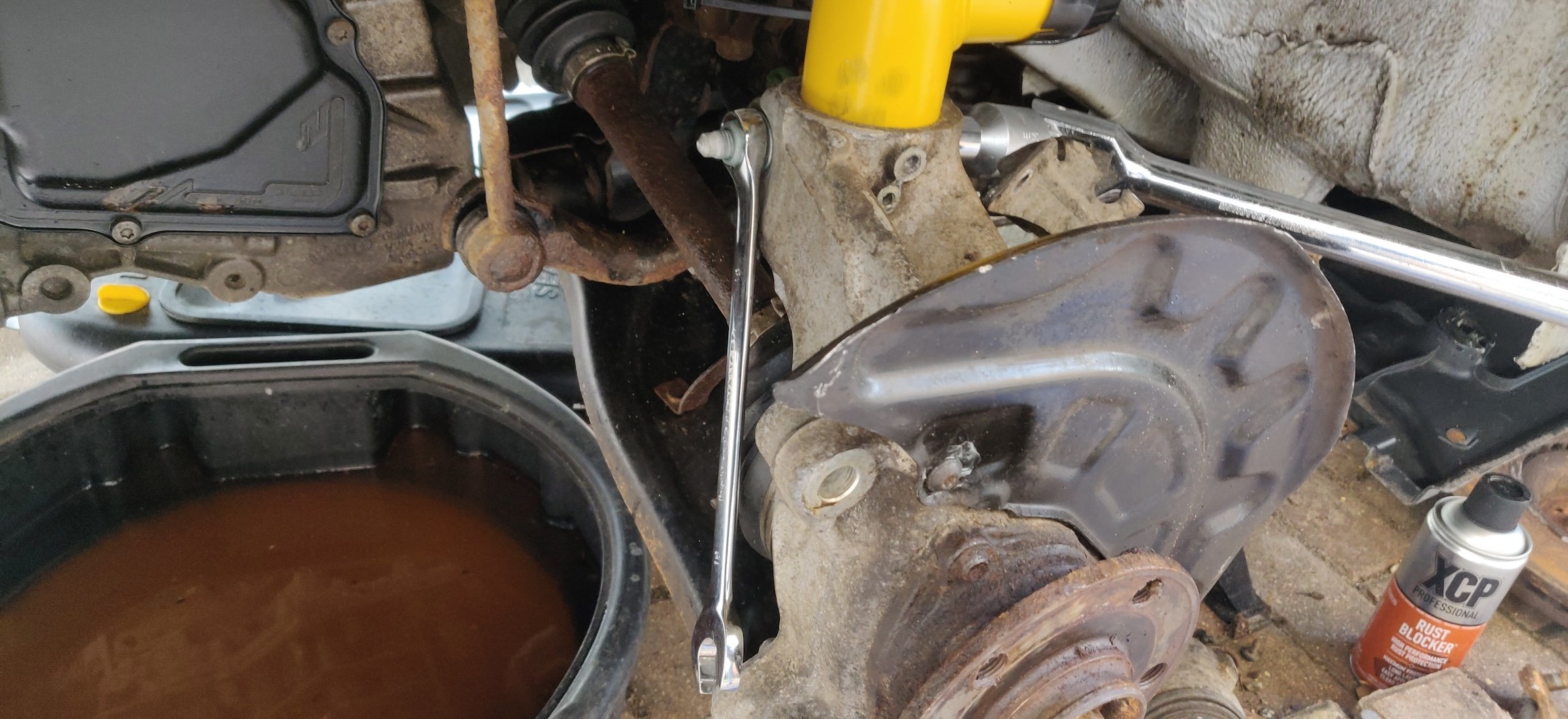

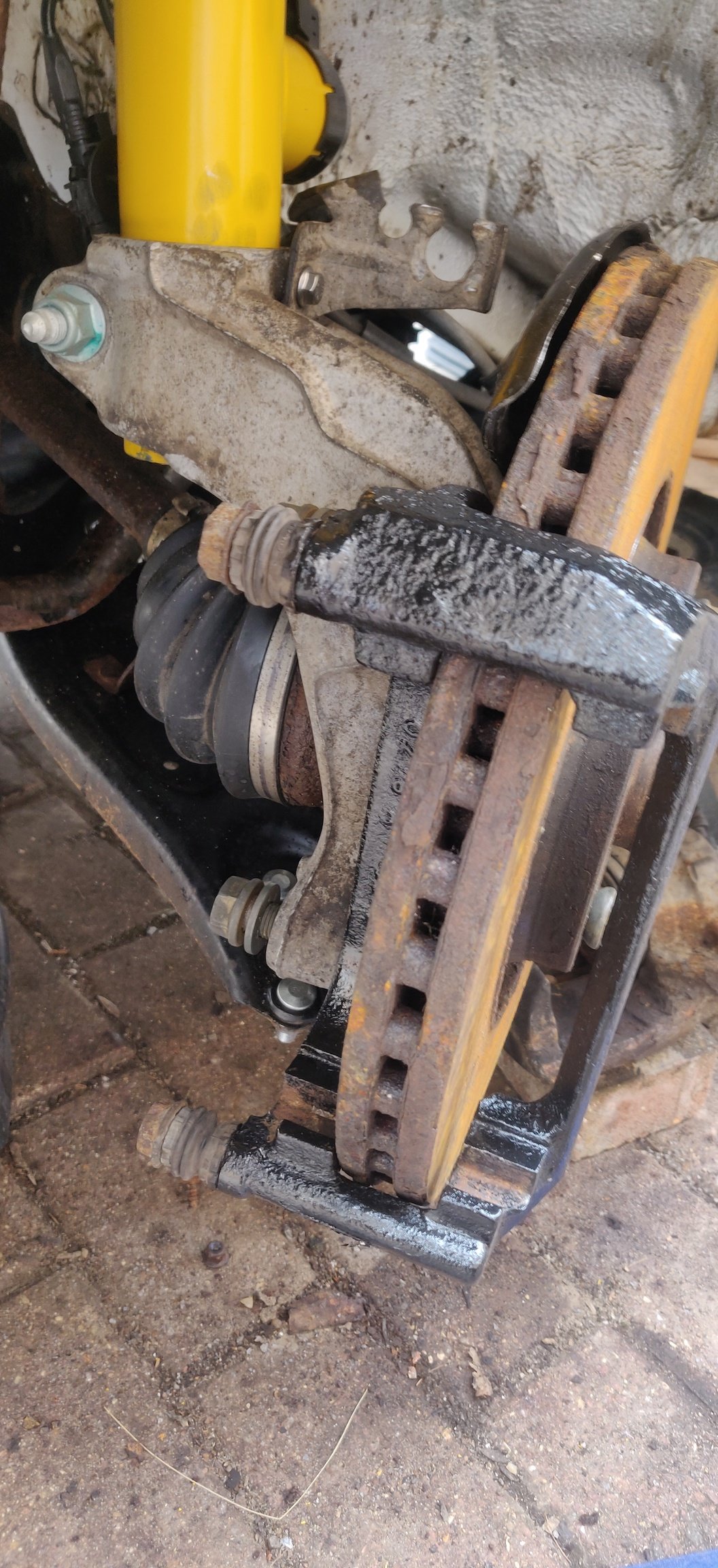

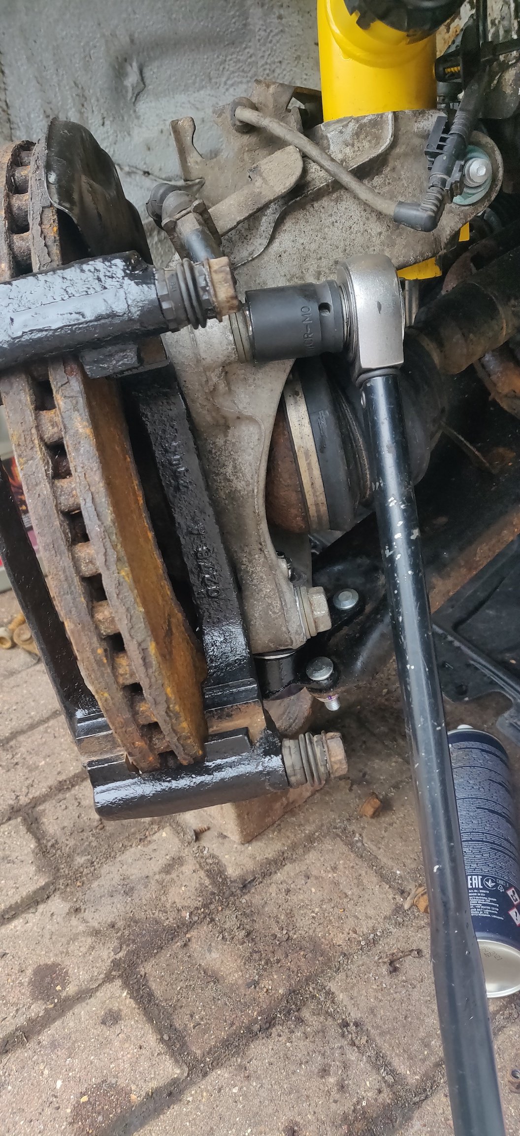

Again, the ball joint removal tool couldn't do the job here for whatever reason, so I resorted again to just hammering it out. I wound the nut back in and tried to get it as flat to the bolt threads as possible, to try and reduce any damage. Then a few sharp thwacks:

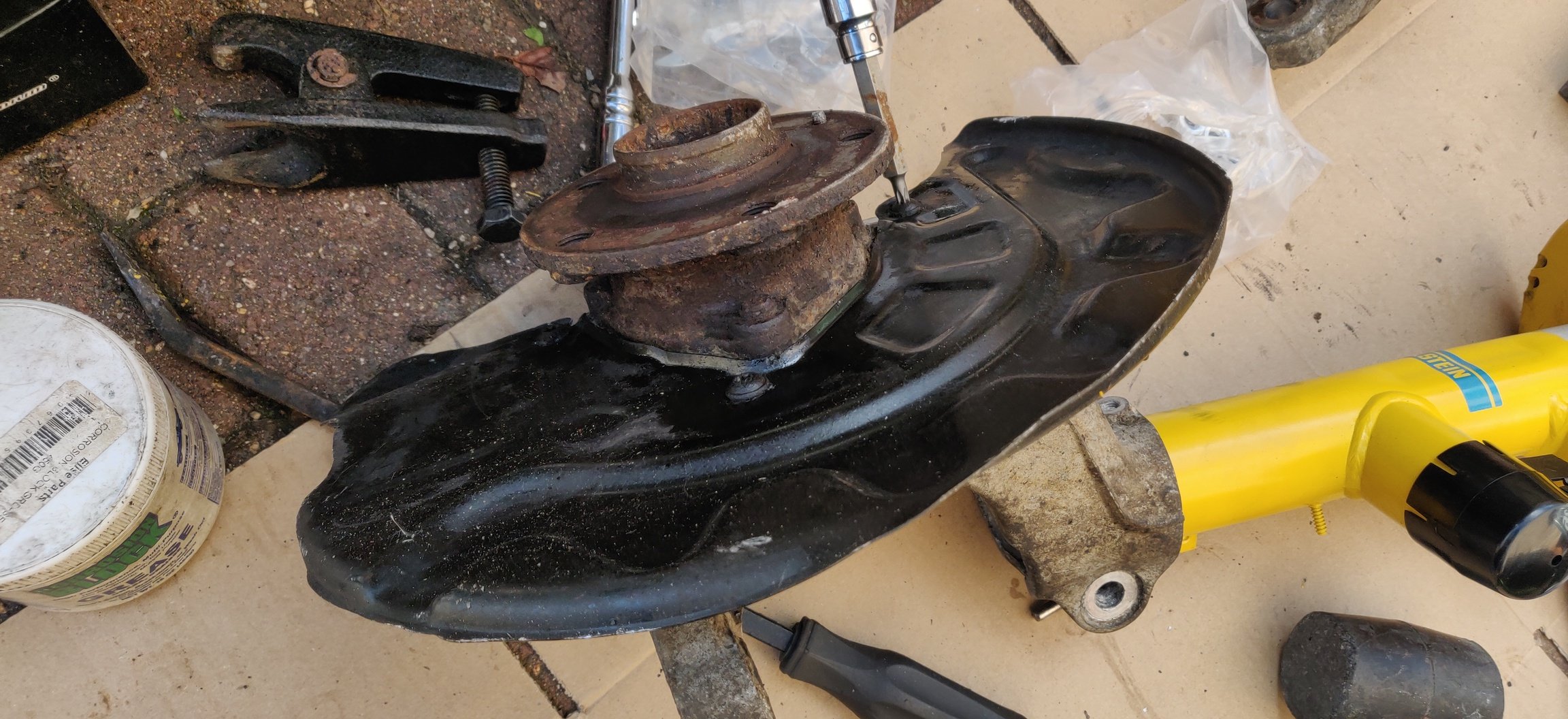

So the hub is freed, so the idea is to tap the hub into the strut from above, but first:

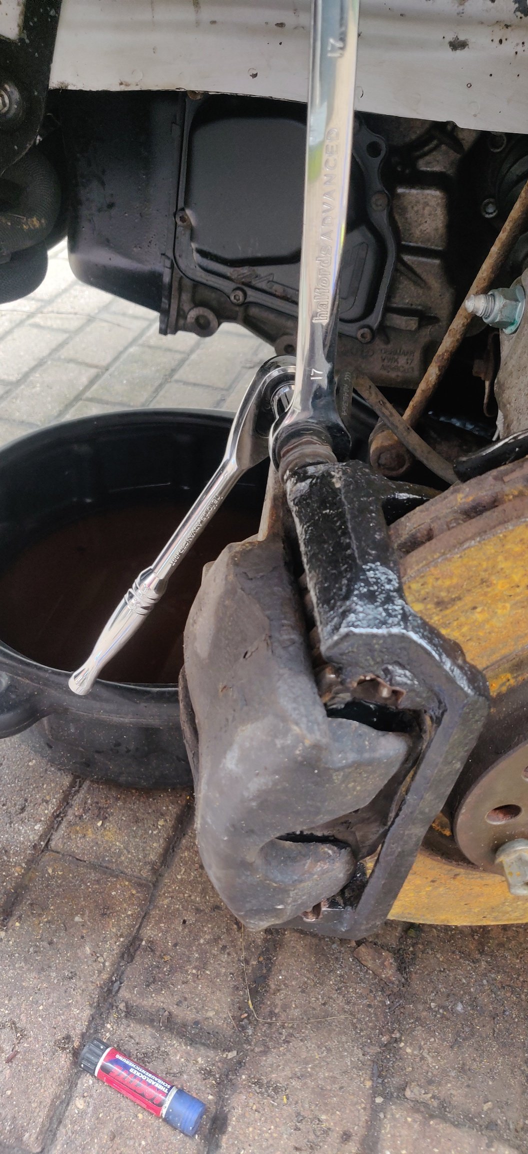

I think it was a T30 torx bolt that keeps the heatshield in place, so some PlusGas and a bit of care and the bolts came free.
Then it was just this:
Very slowly going with constant thwacks of a rubber mallet.
It was interspersed with regular moving around of the spread tool, more to take a breather:
As it got further in, the rubber mallet lost effectiveness, so out of desperation, resorted to the lump hammer. I have no idea if I've done lasting damage to the hub, or the new strut, or both, with the constants bashing.
But it eventually gets there:
Seriously, this took about 2 hours of the morning, what I presumed was a 5 or 10 minute step!
I believe the strut should be touching this lip:
So it's probably a portion of a millimetre off. No idea if that's going to be a problem in the future.

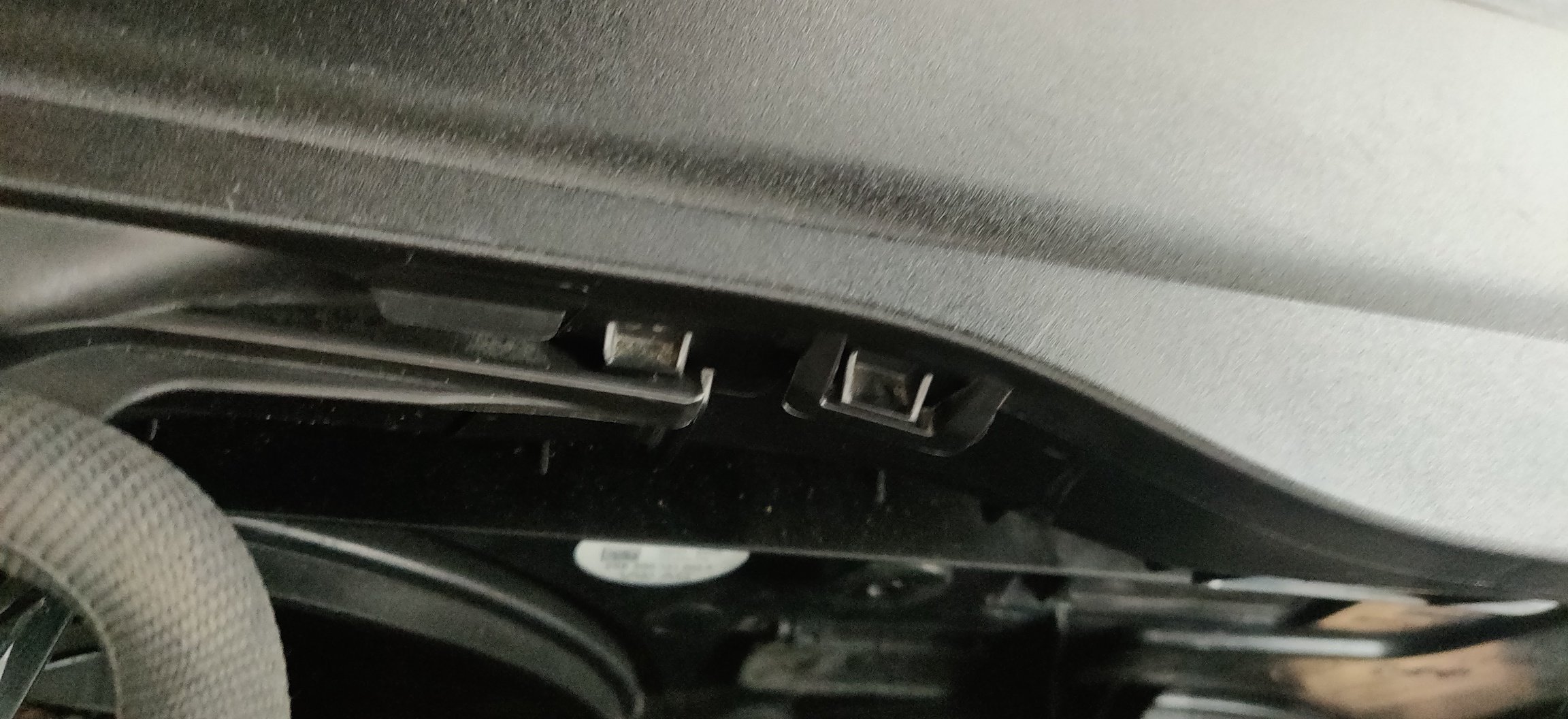

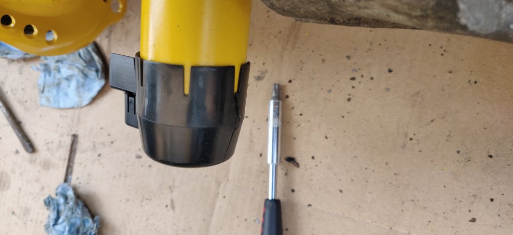

Of course, this also happened:
Another cracked connector cover. Lucky I bought a spare. A slip of the hammer puts this right in the path, so for the other side, I'll take the cover off before I start the process.

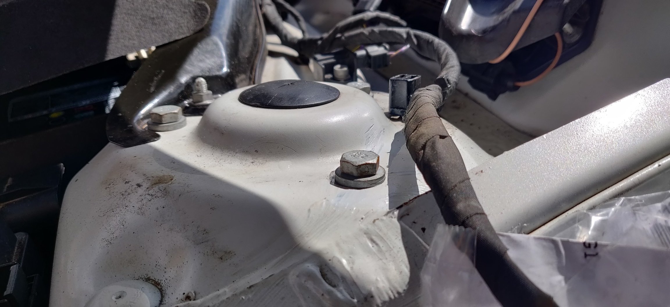

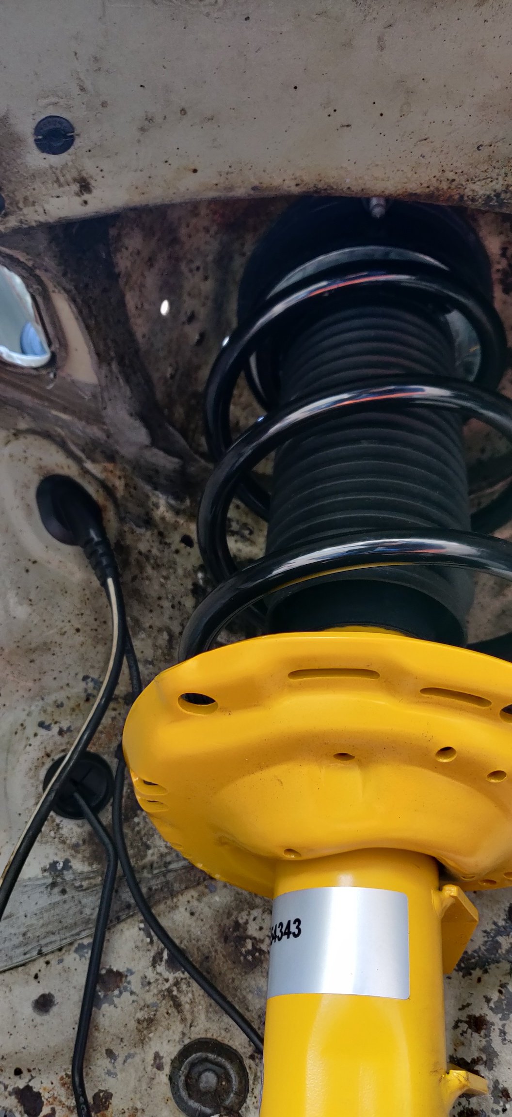

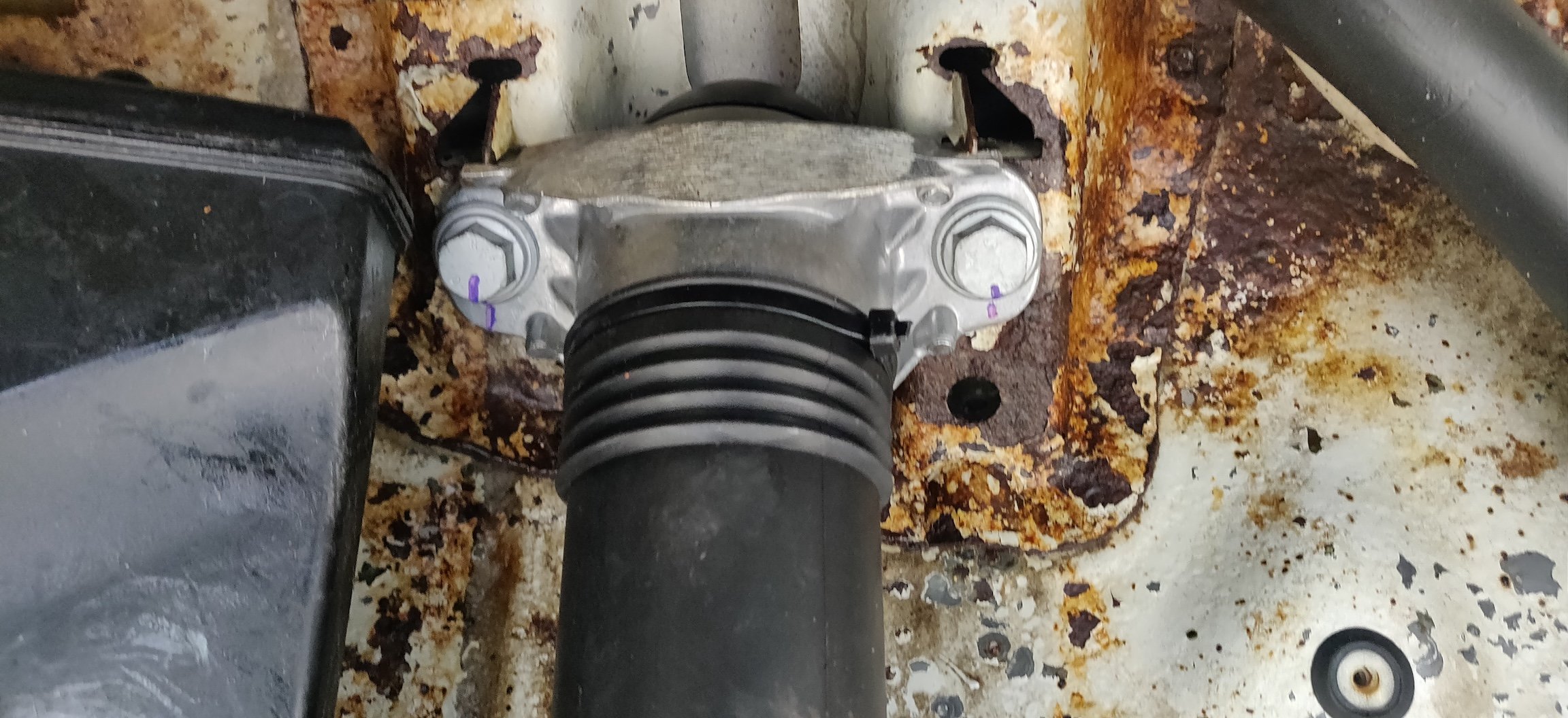

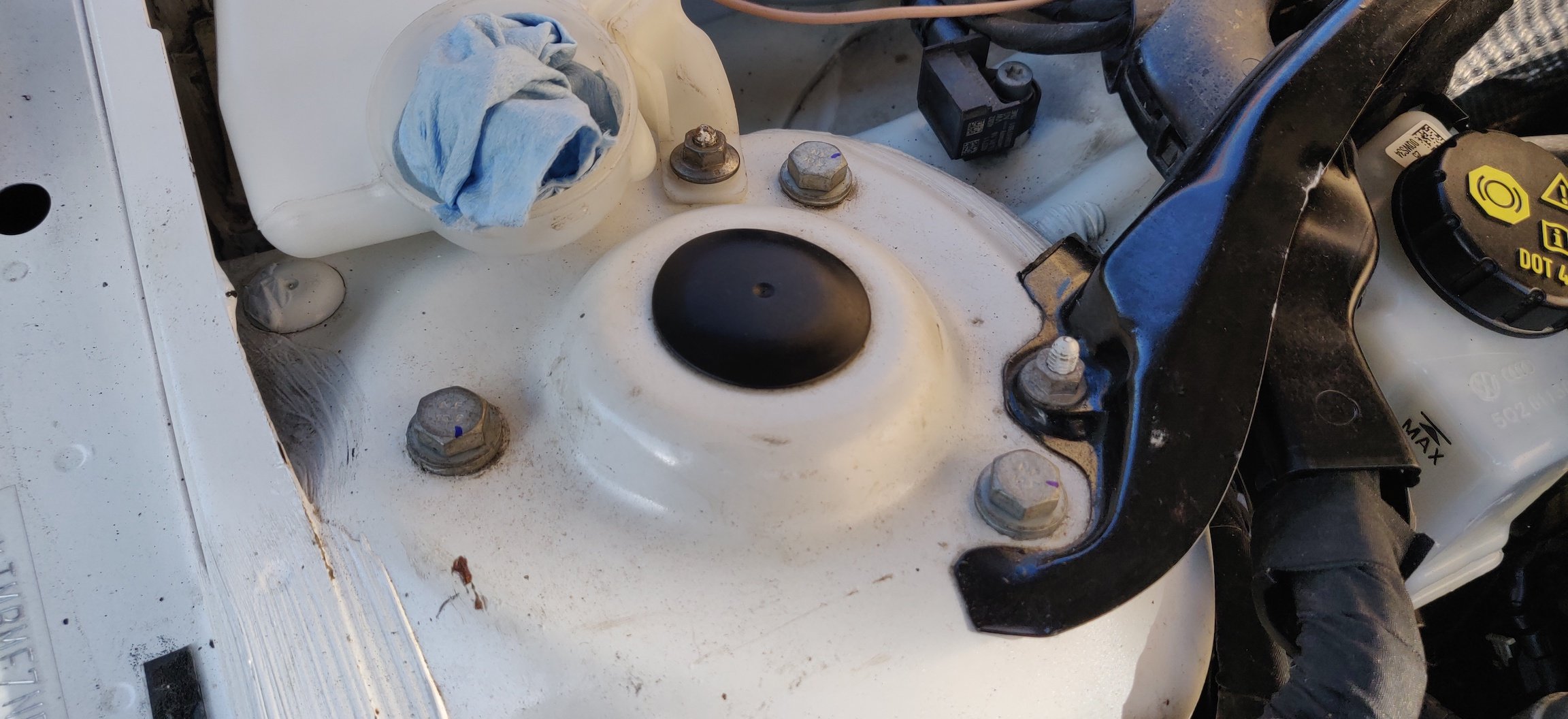

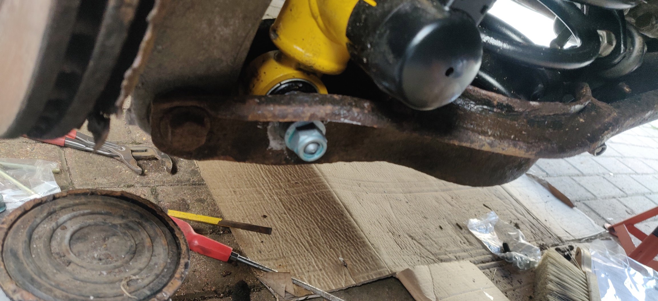

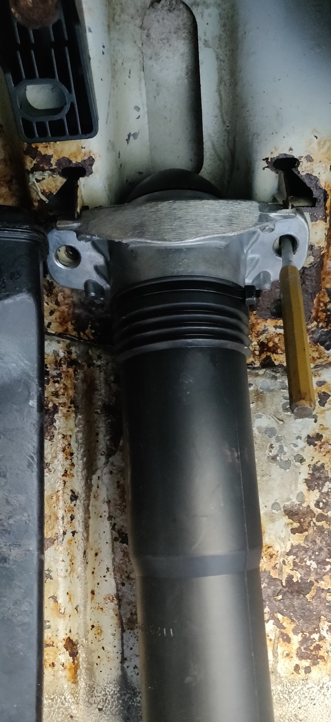

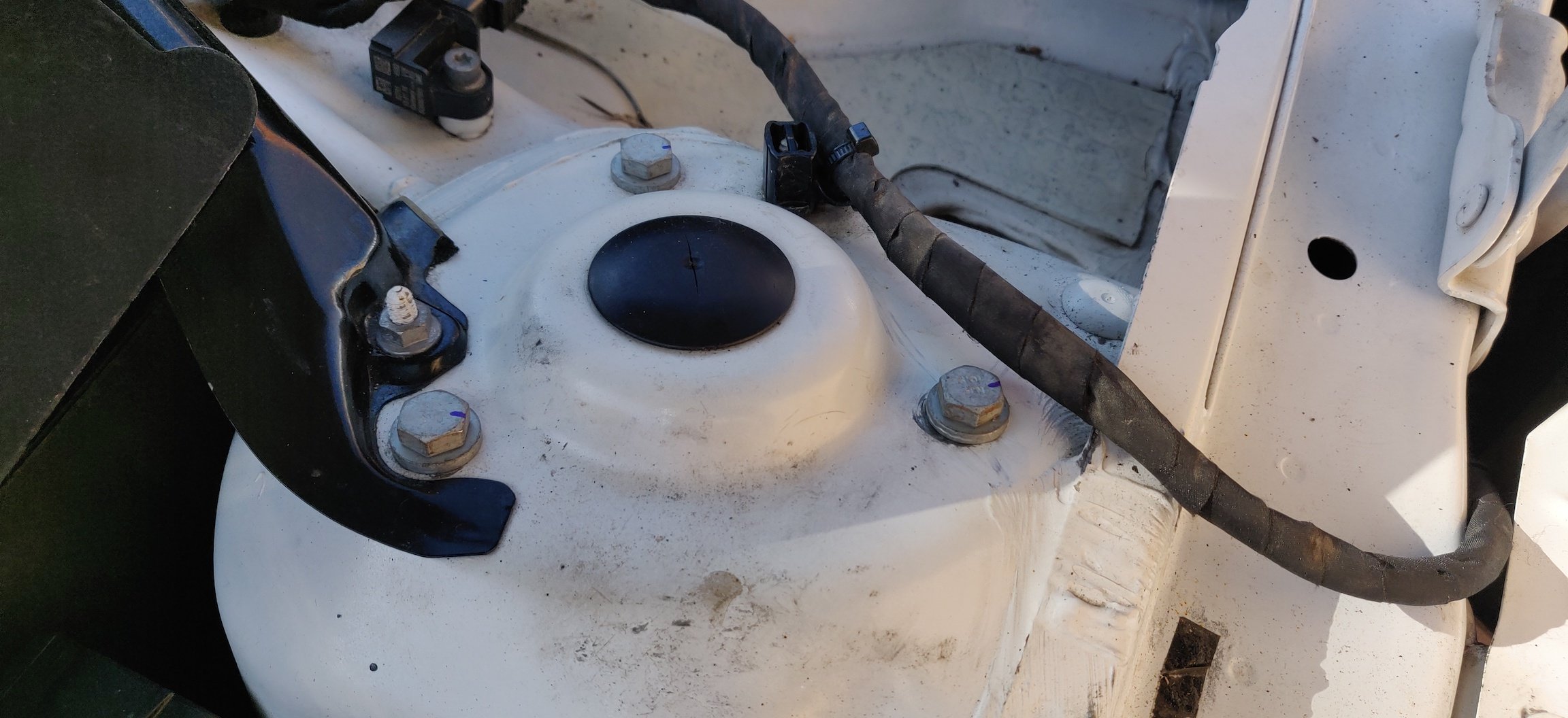

I then started to get the strut up and into the turrent:
This is a bit unwieldy done solo, but can be persisted, then once a bolt or two in the turret is attached to the top of strut then I breathed a sigh of relief, at least it looks like it's attached!

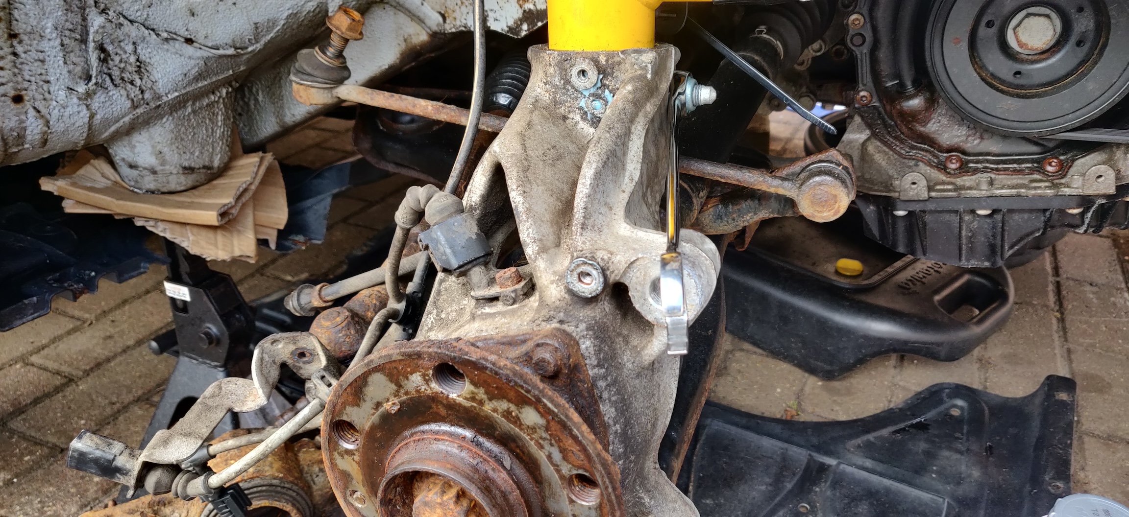

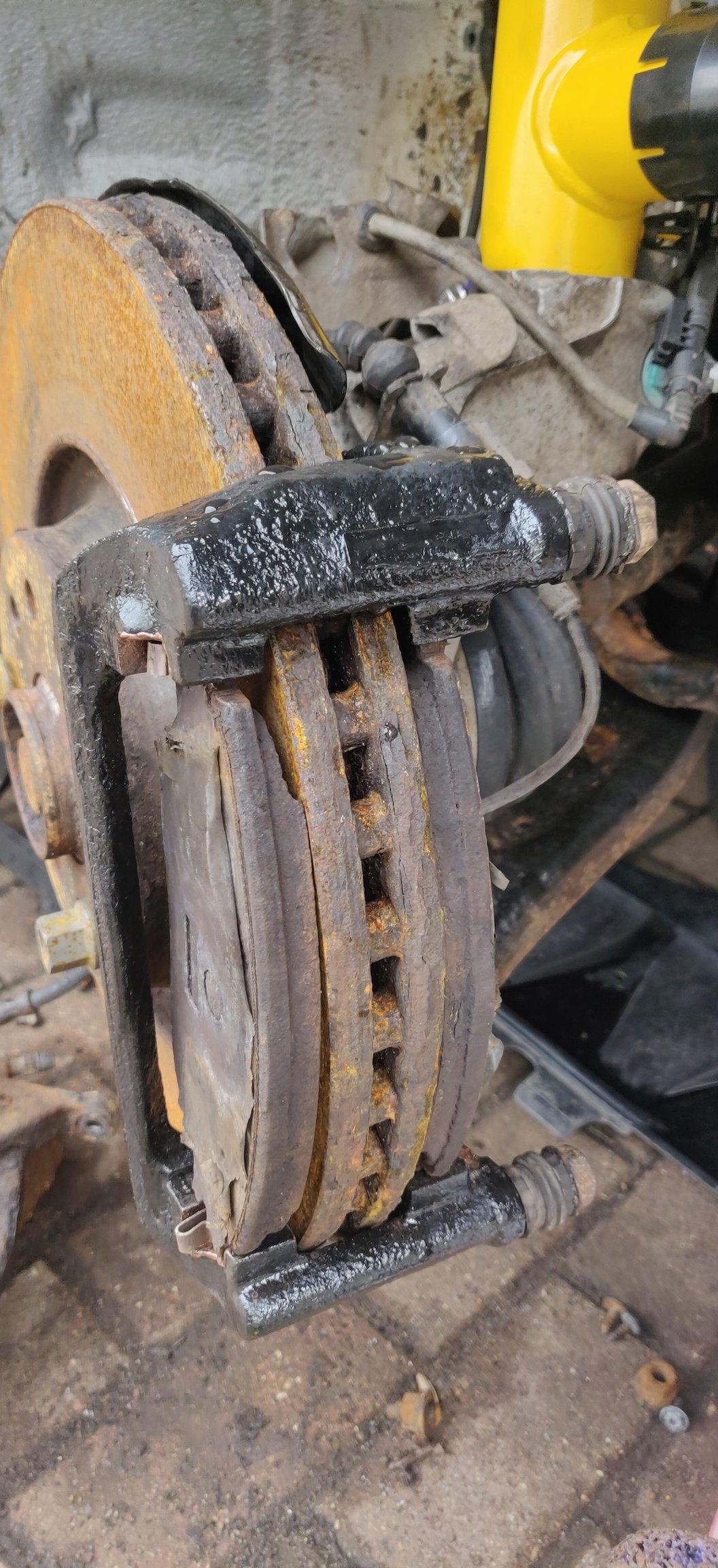

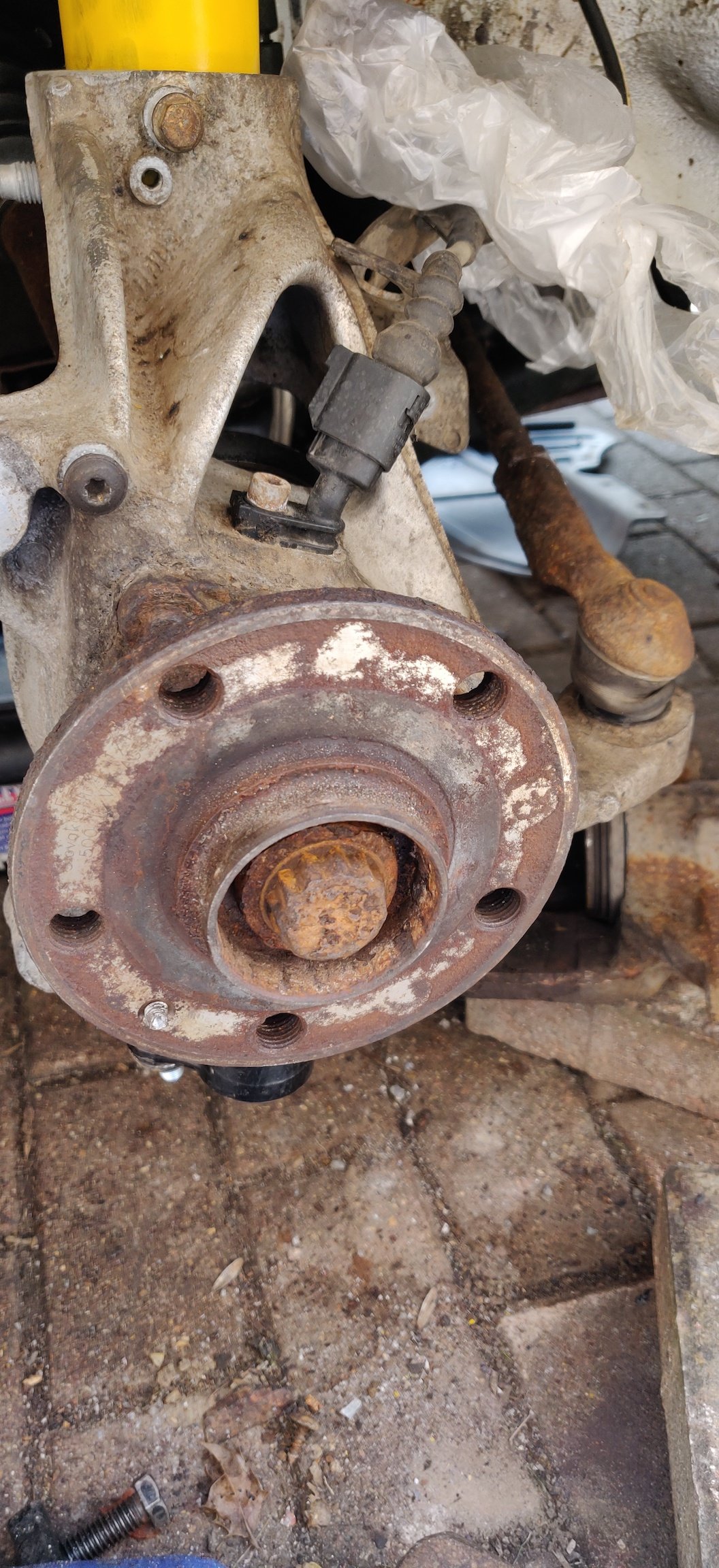

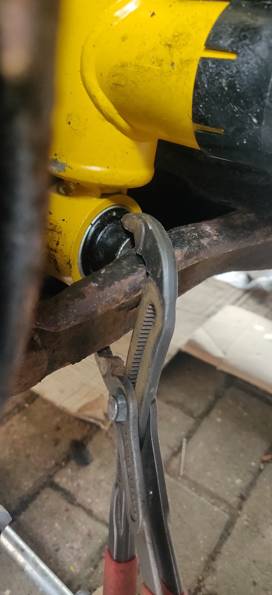

I started to prep the other side, so removed it from the track rod end same as the left side, but this time tightening the ball joint to the hub early doors, to 60Nm:
Did not need any counterholding so probably should have done that for the left side before I continued.

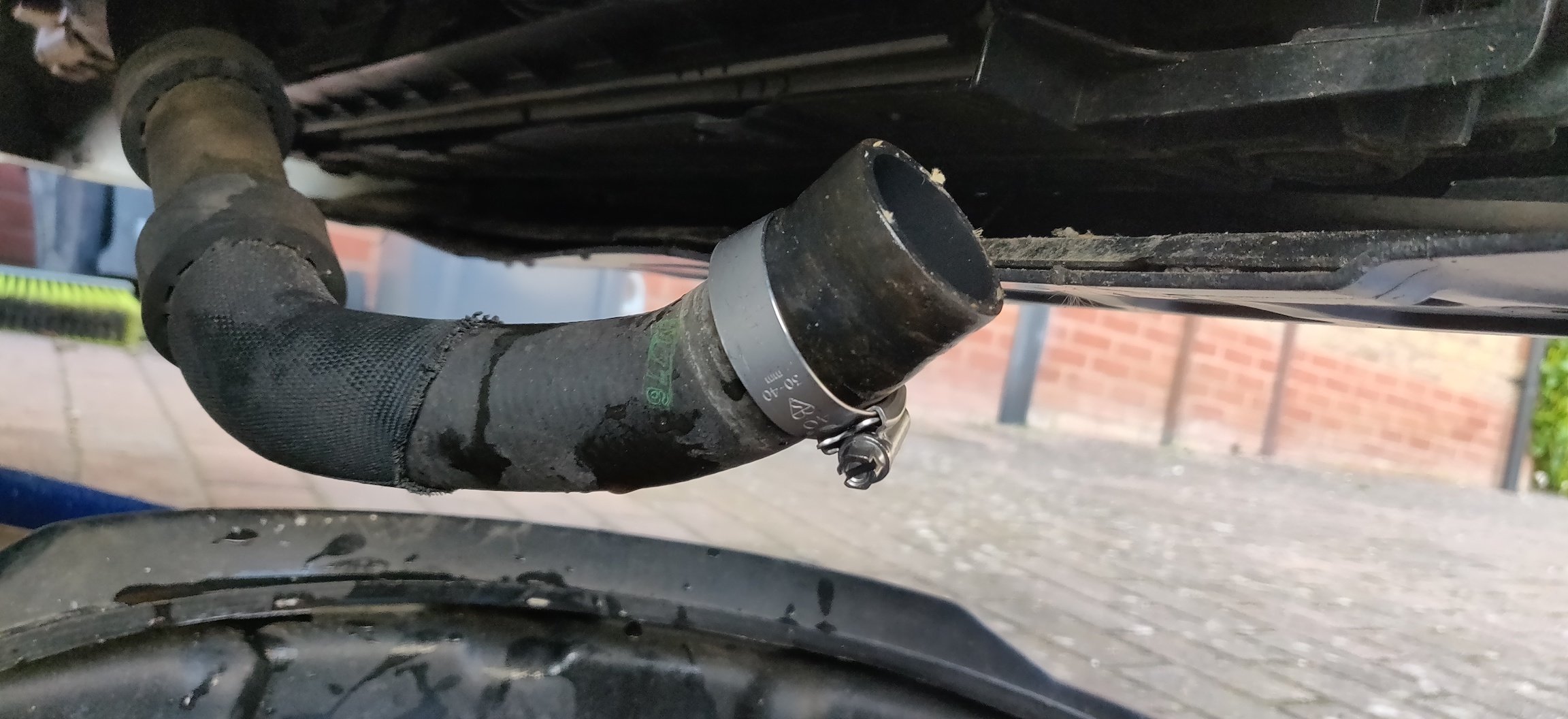

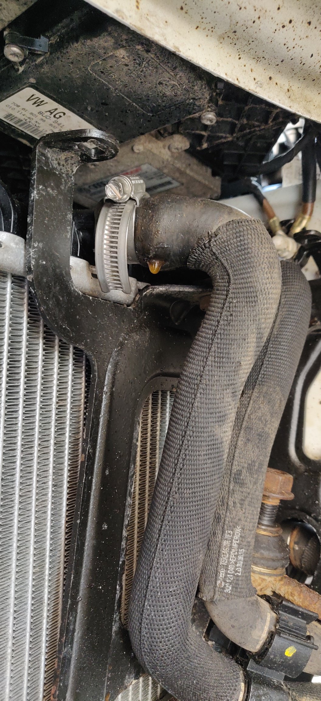

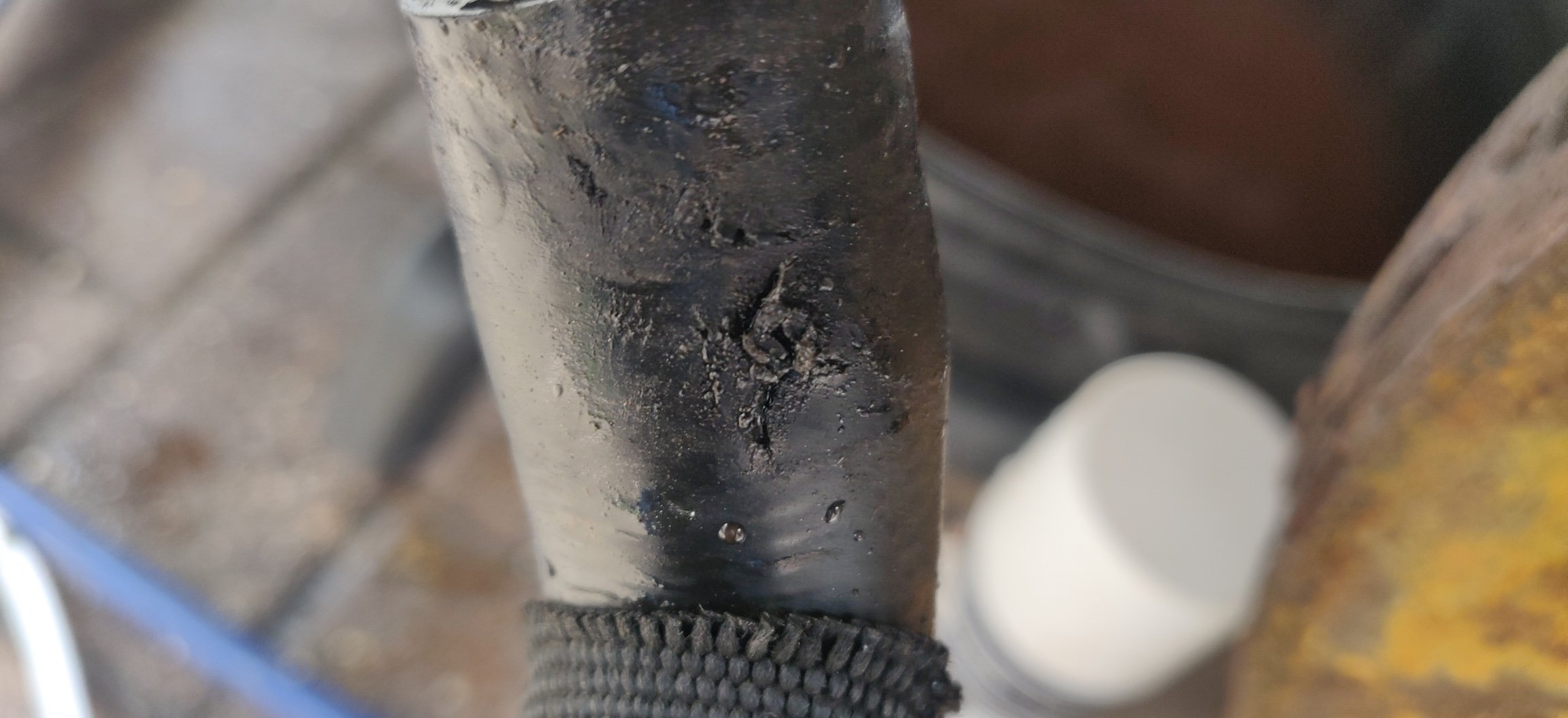

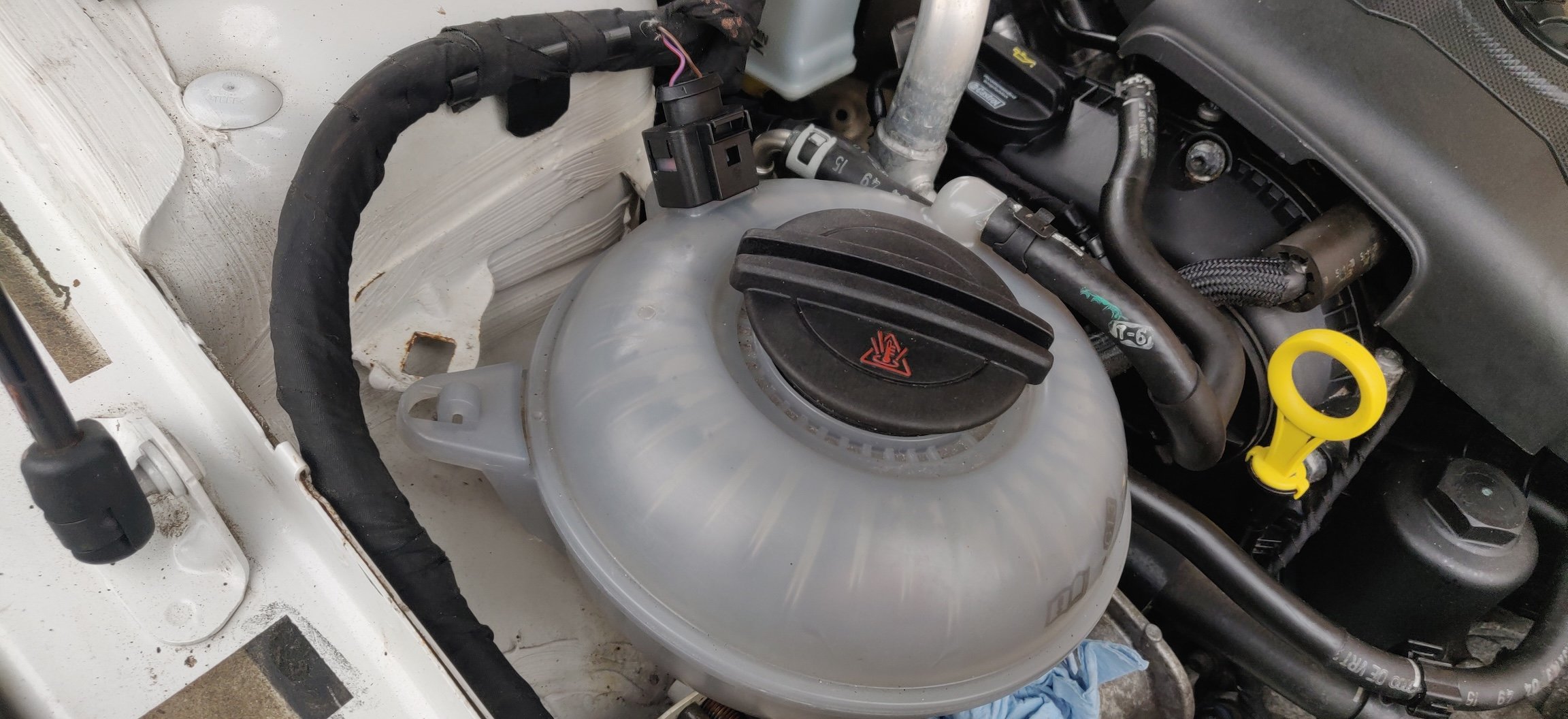

I noticed the coolant tank was low, so started to top it up, but then noticed a wet leg whilst working around the left wheel well:
Looks like my use of the pliers to wiggle and loosen the hose has put a rip into the hose. Extremely frustrating given the top part of these hoses didn't actually need these new clamps installed, so damaging the hose puts a blocker on future progress. I don't think there's a decent approach to address this other than to replace the hose.

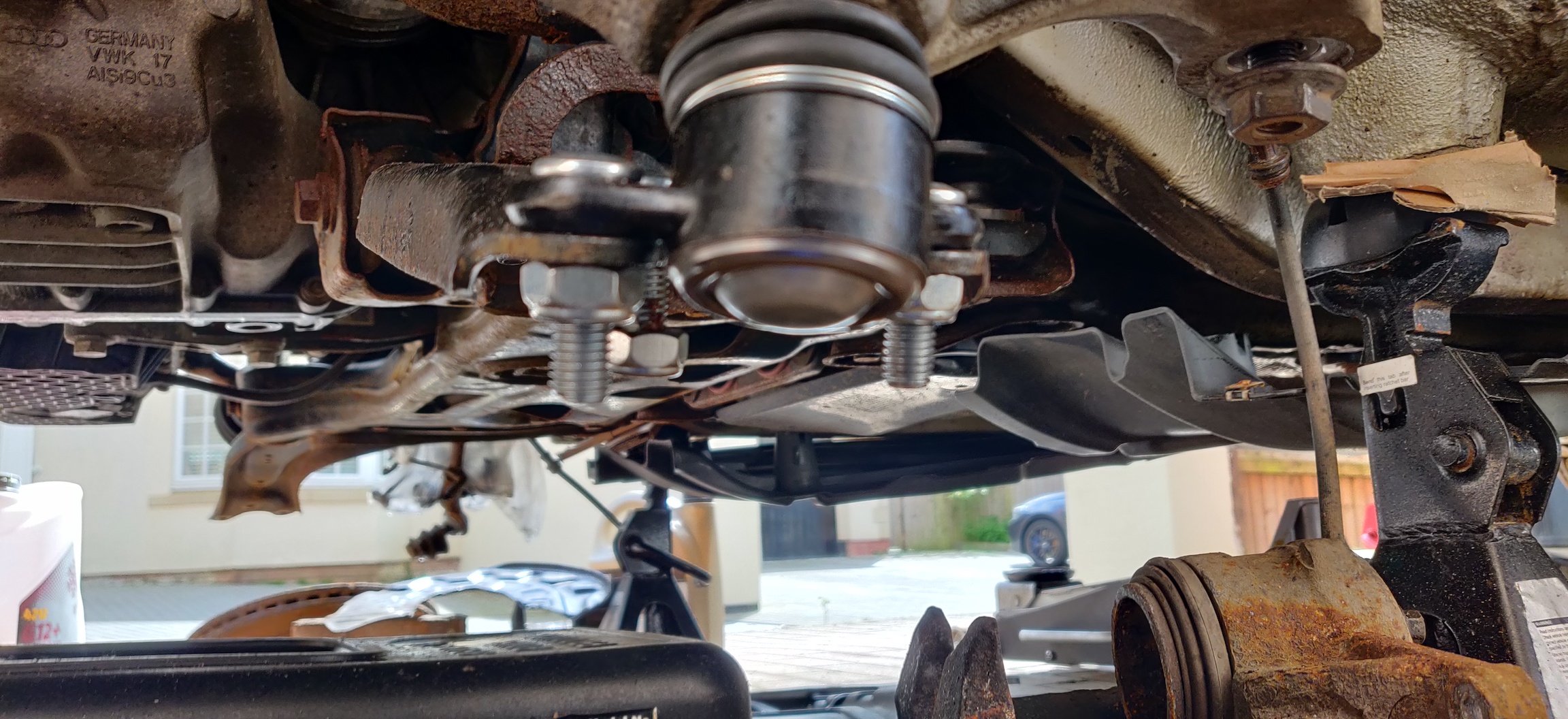

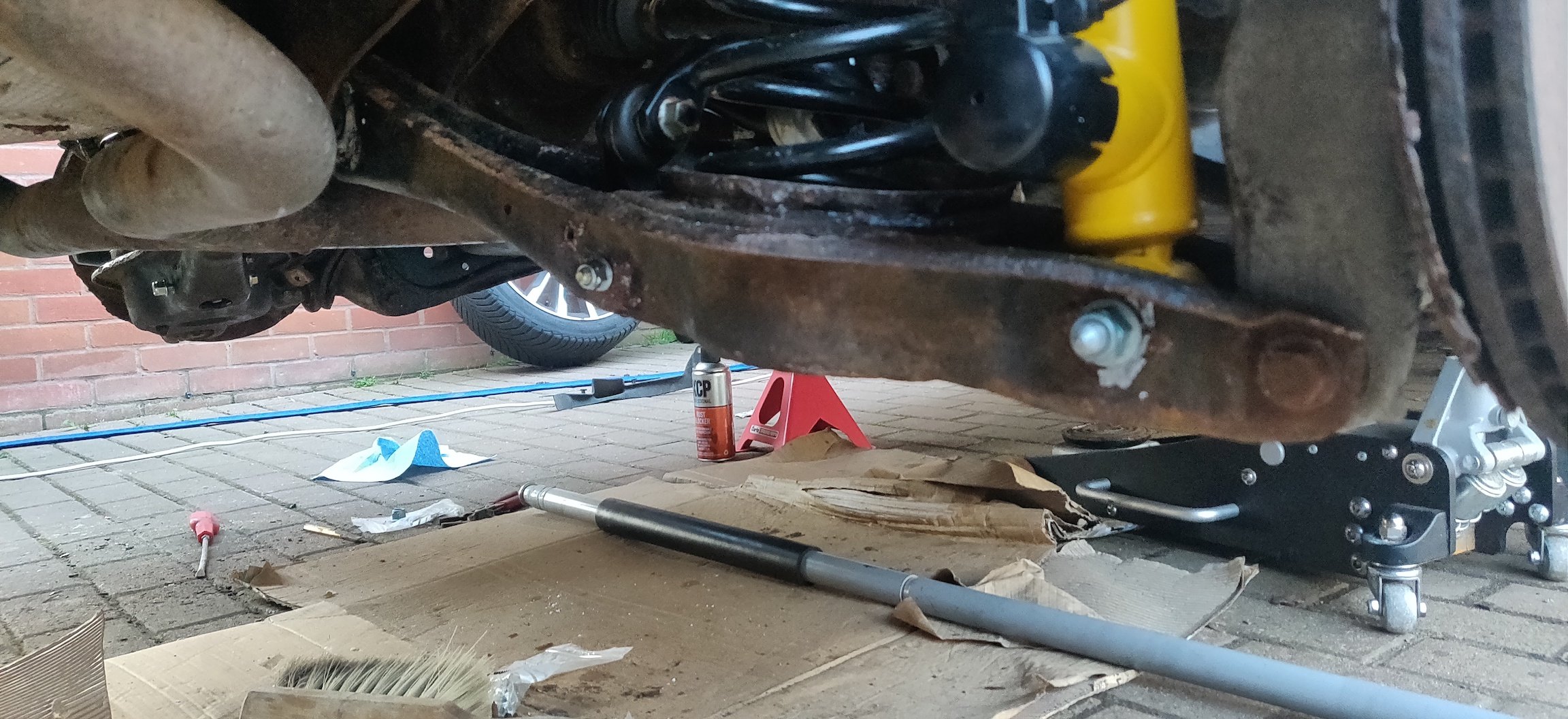

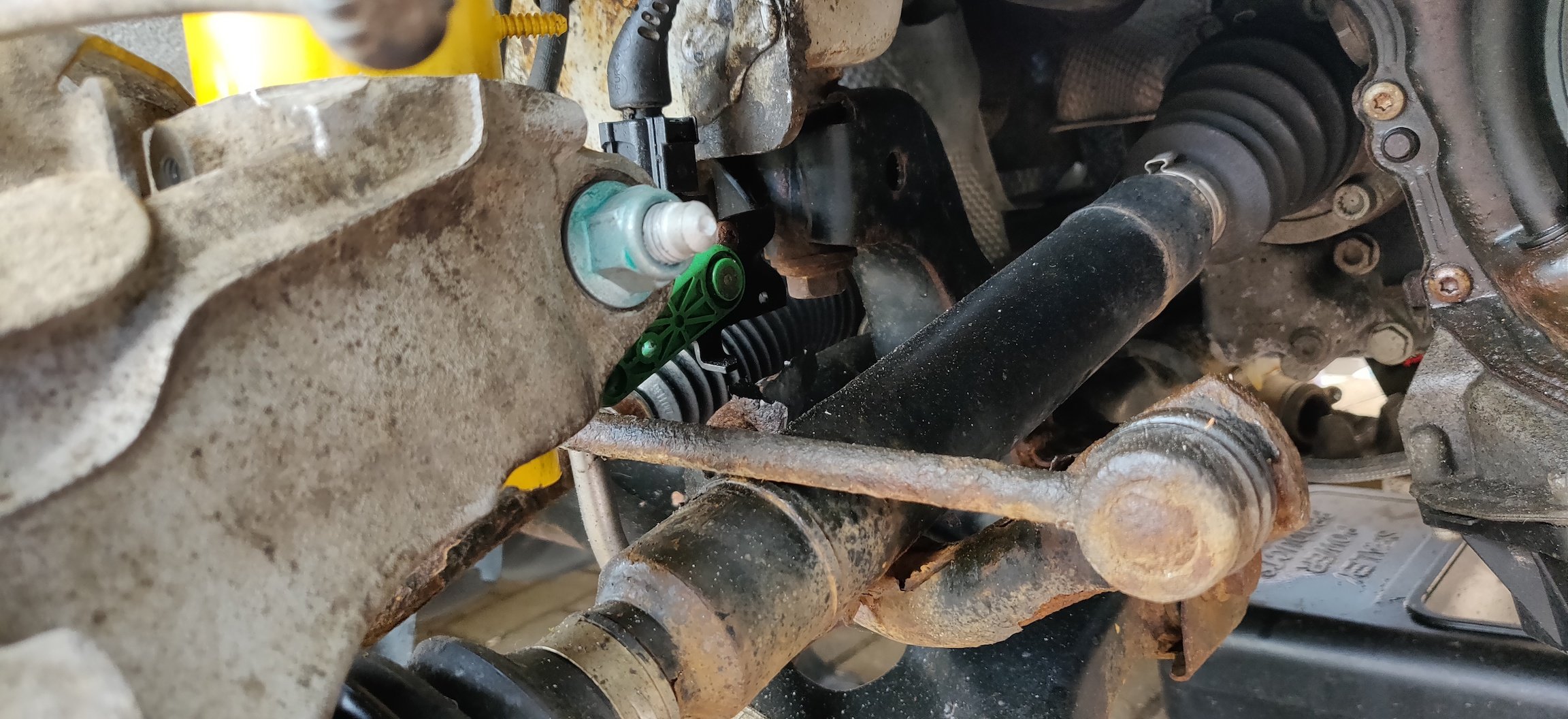

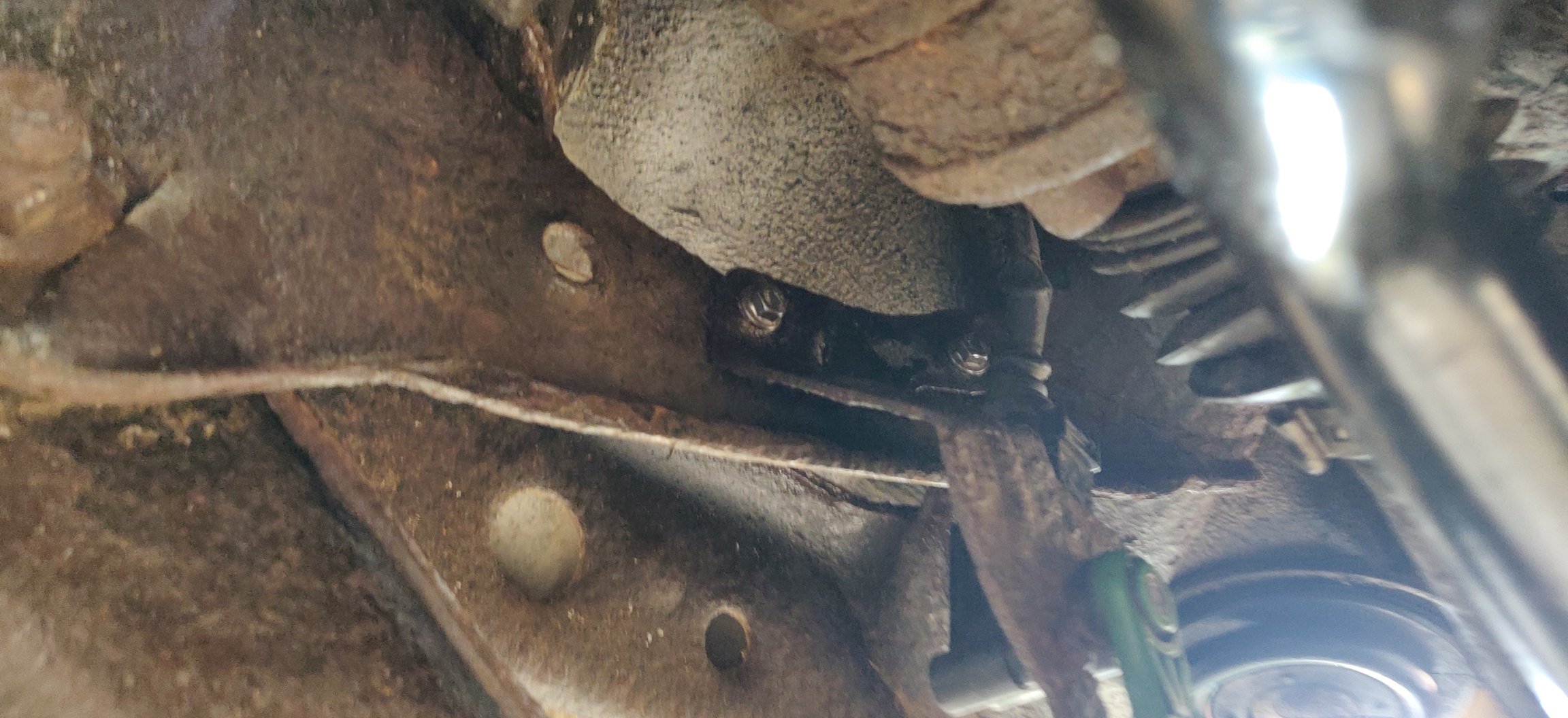

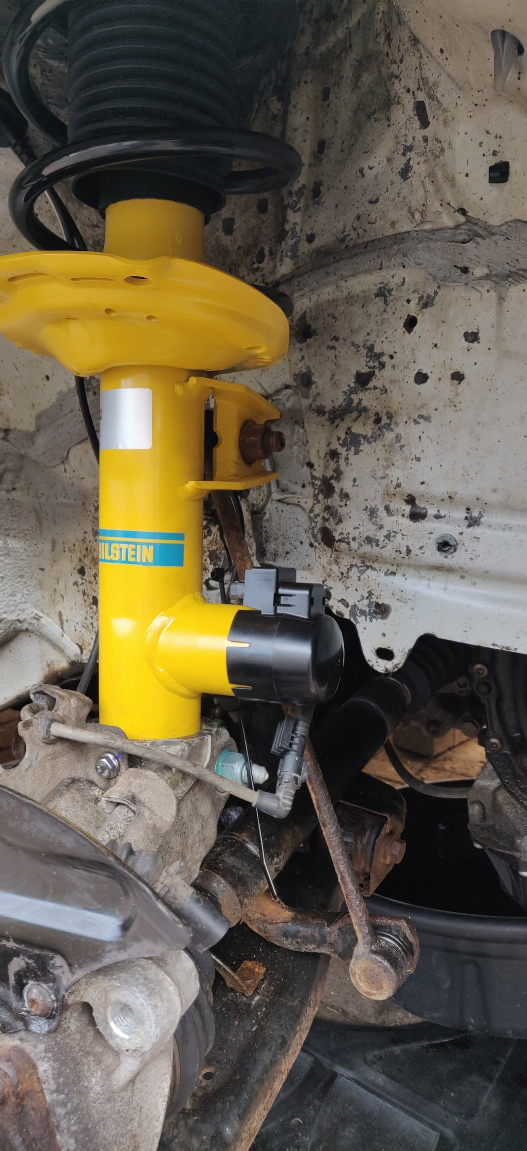

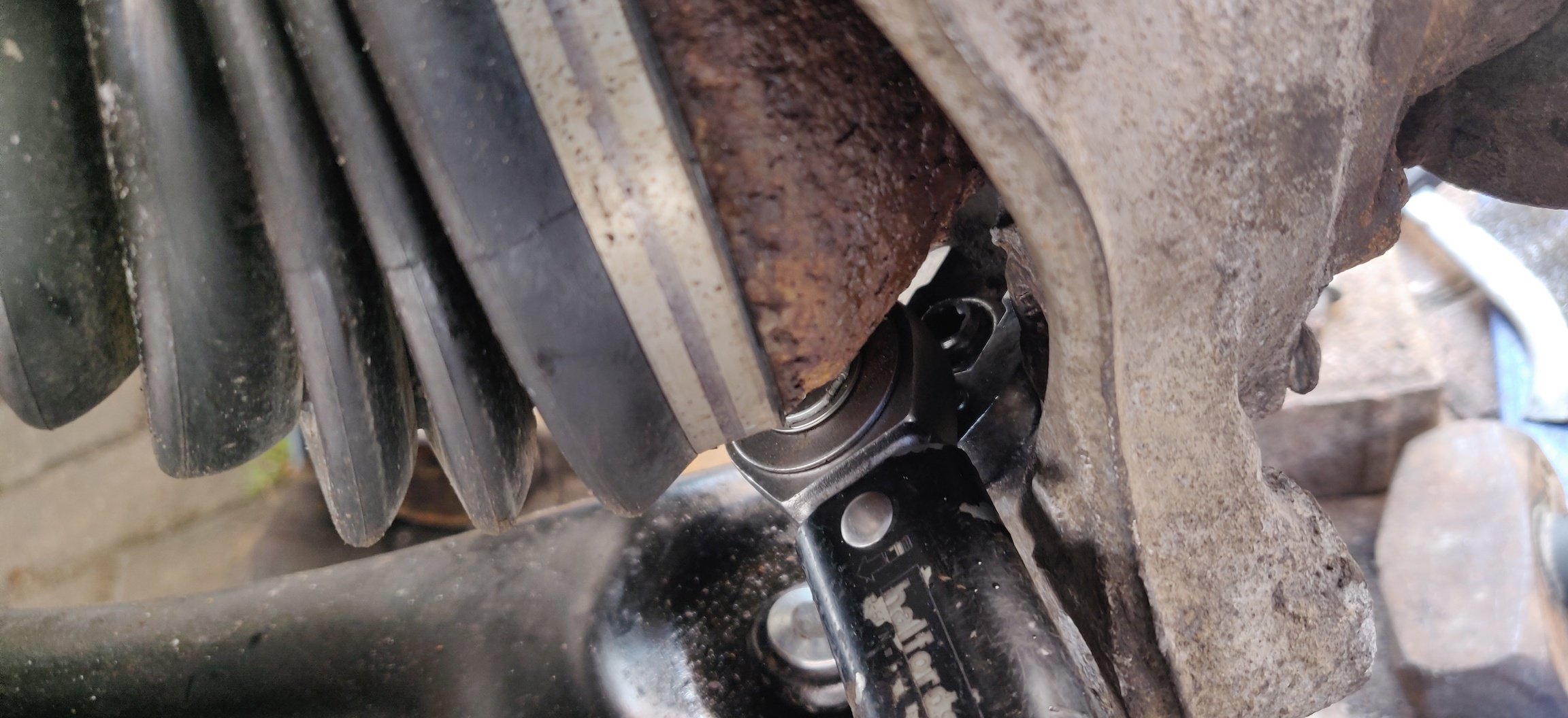

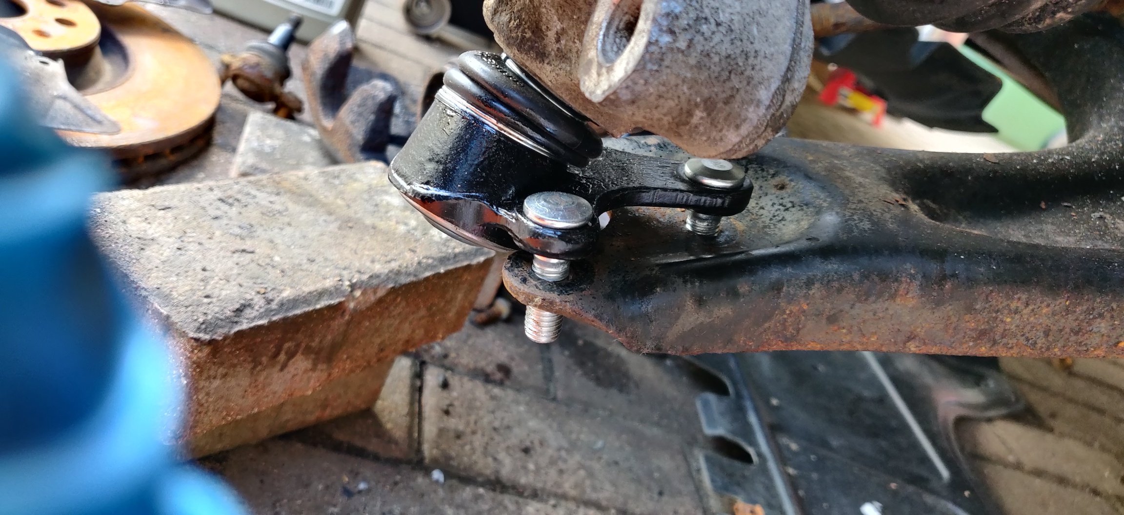

So, looking back at the left strut fitted, lowered the arm and got the balljoint into lower arm and got the nuts tightened:

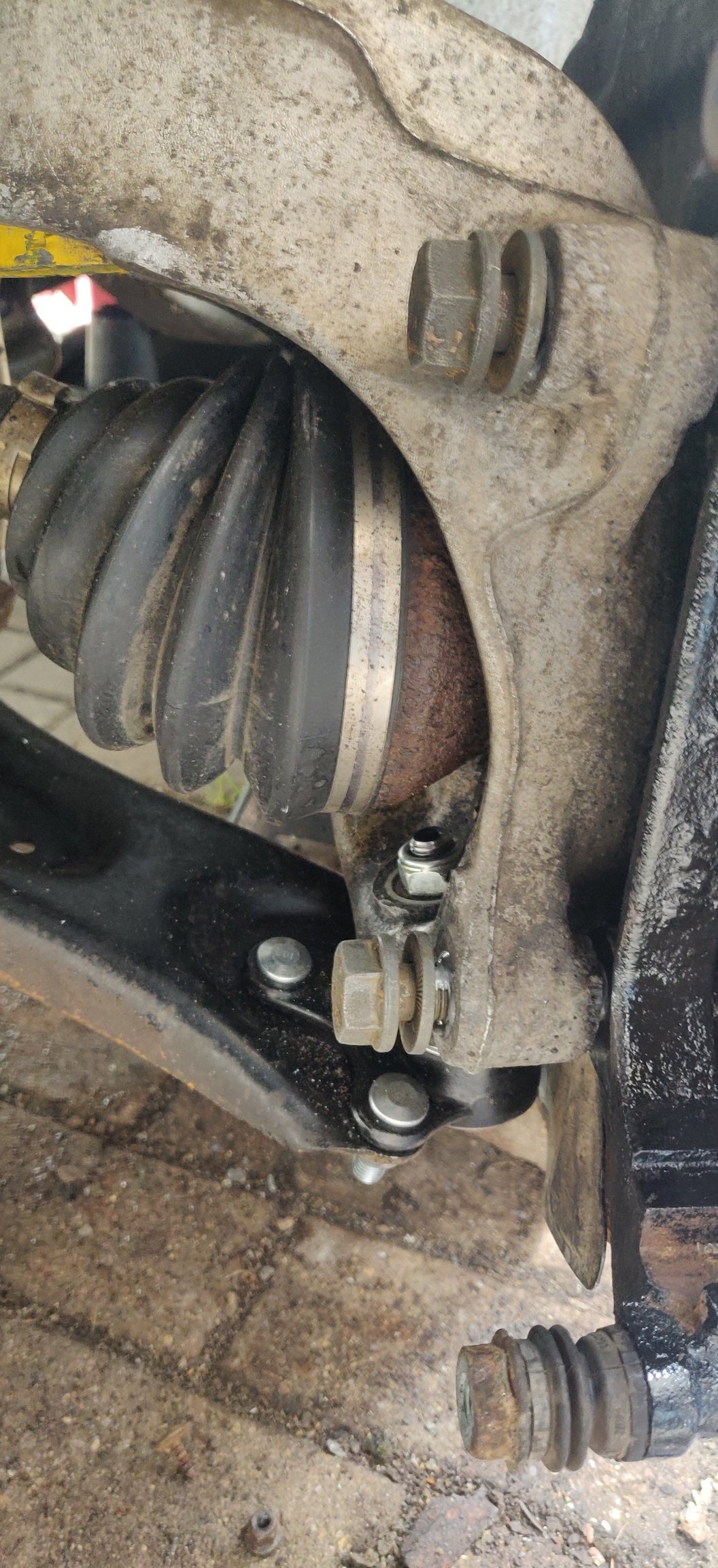

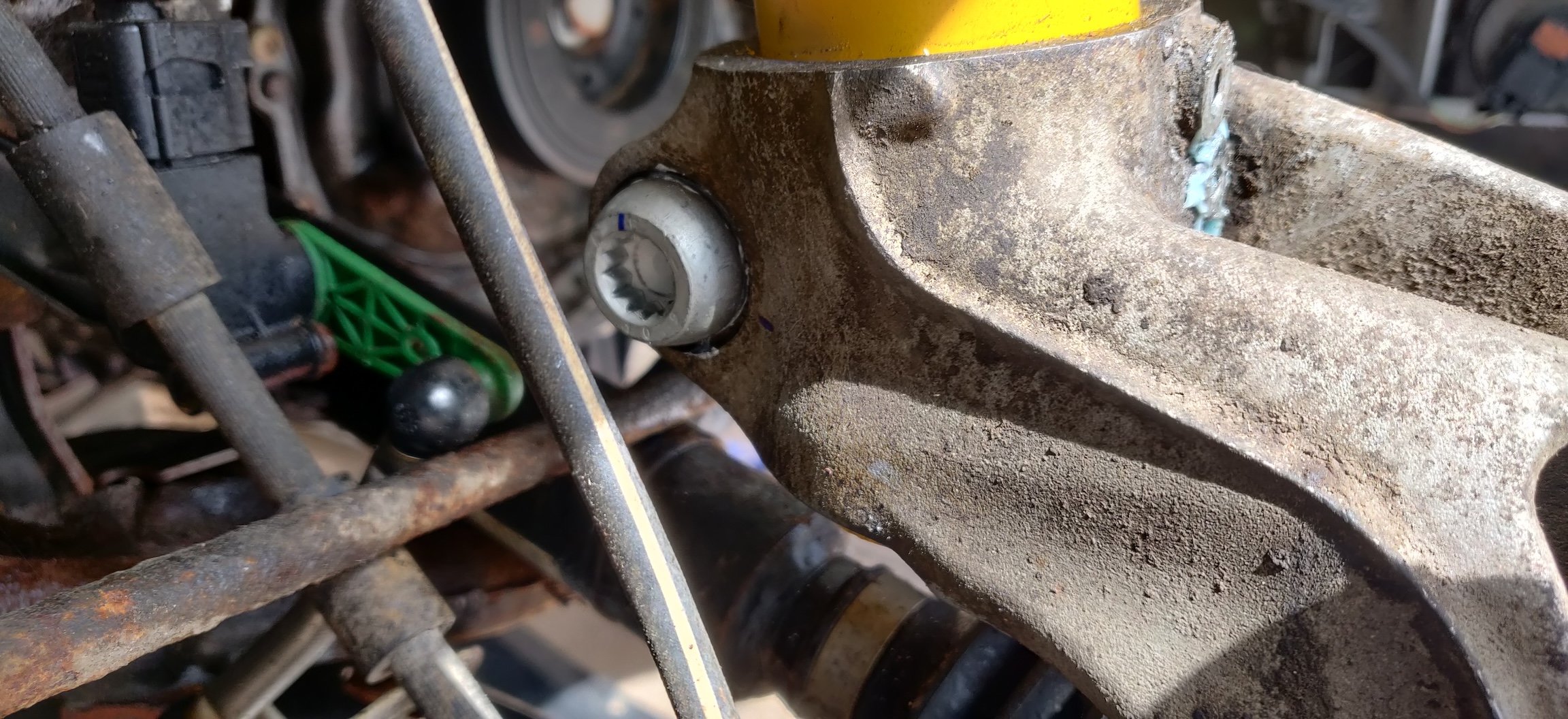

Not torqued it to spec yet. There was actually a bit of a palaver getting the driveshaft into the wheel hub before this, again involved eventual tapping of mallets and so on, until it got in enough so that the old driveshaft bolt lying around was able to start winding in:
This is because it would mean that the driveshaft bolt could then be tightened, hopefully pulling in the driveshaft and getting it home.
With that, the ball joint under the driveshaft was tightened, via a crow's foot attachment:
Kinda lucky it was 19mm as I don't have a 21mm crow's foot.

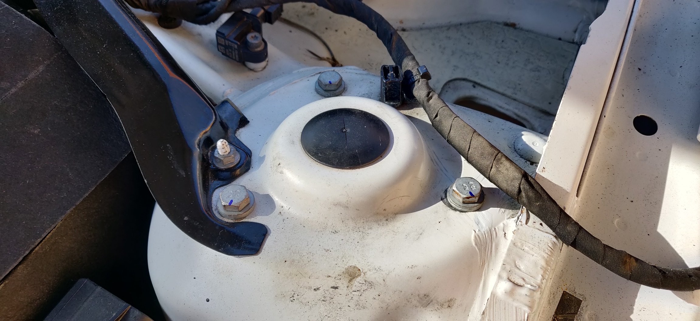

Then tightened up the top bolts a bit more:

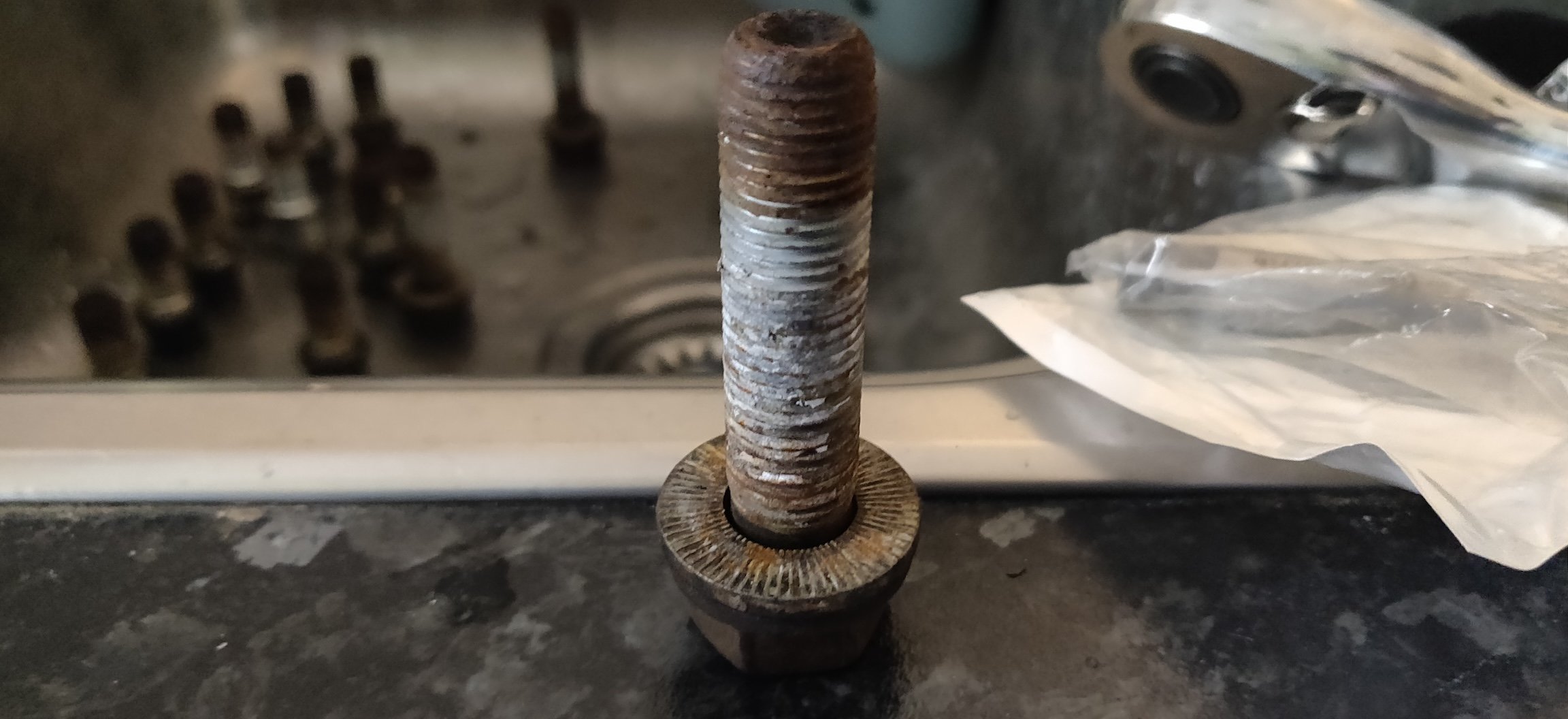

So at this point, I couldn't find the 24mm 12 sided socket I bought to undo these driveshaft bolts. But it was midday by then, so took a break for lunch.

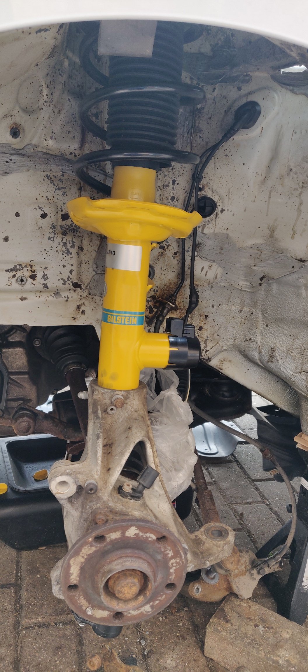

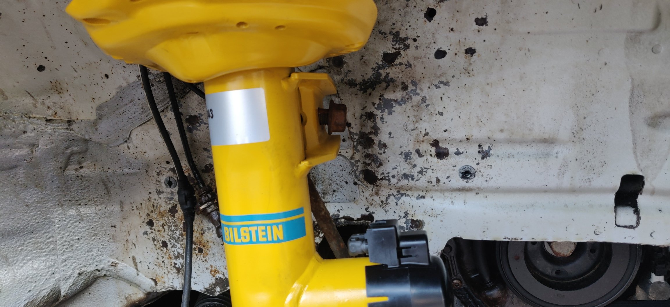

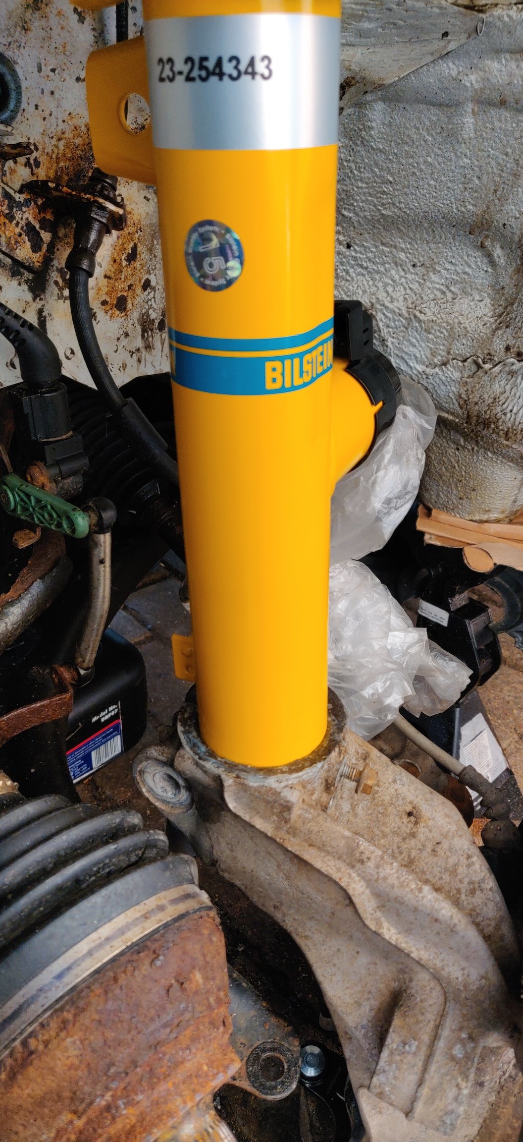

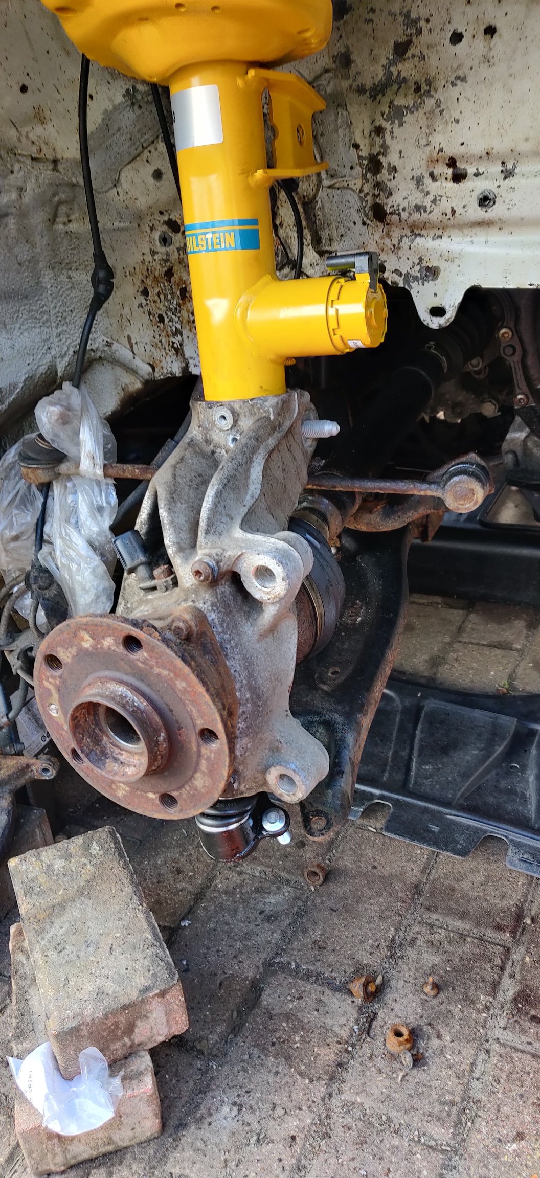

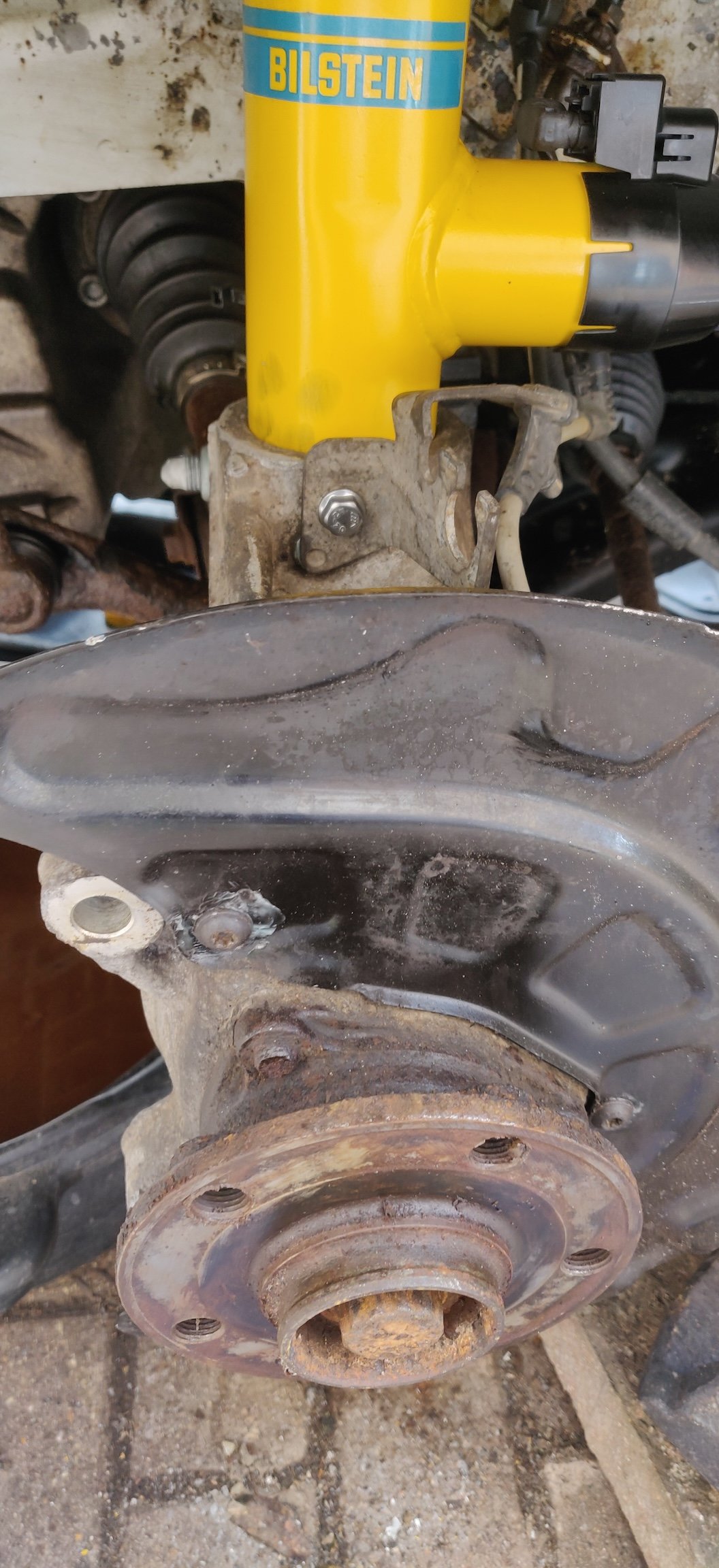

So time to get the strut into the other hub. The other side seemed to go in much quicker:

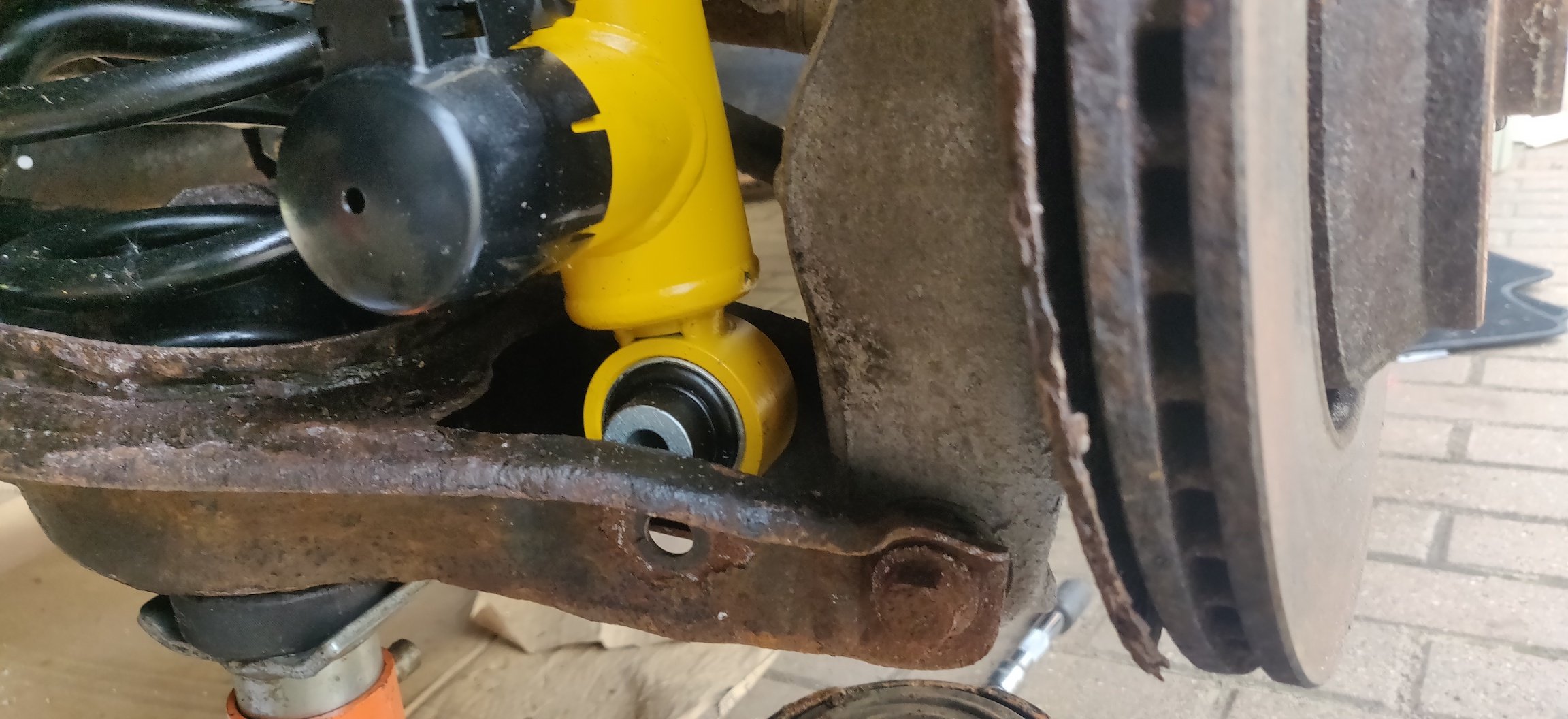

The rubber mallet was able to get a lot further compared to the other side:

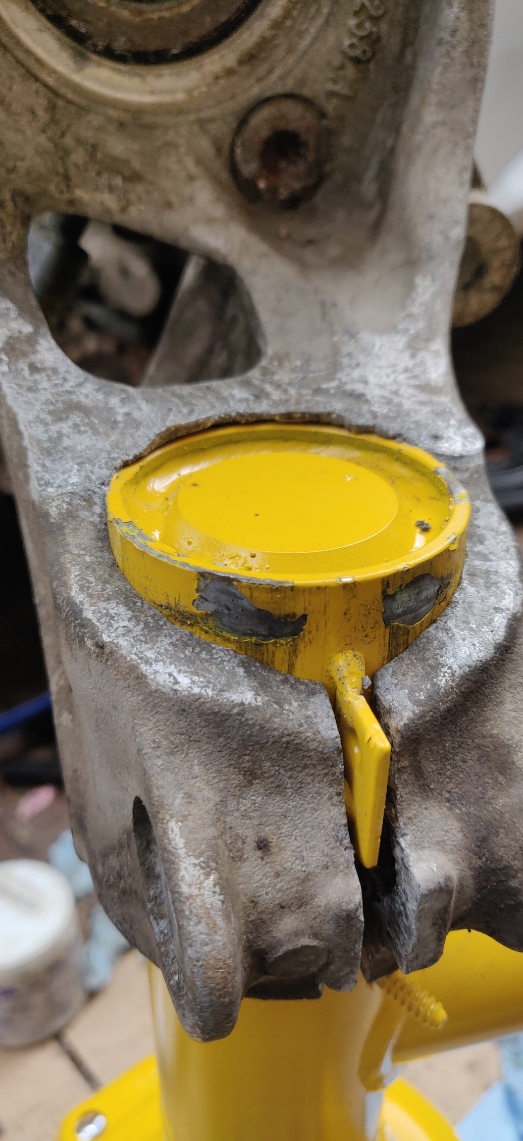

You can see the metal tab bit on the strut as it goes through the strut bolt hole. Presumably, the bolt prevents the strut flying away due to this tab, in addition to it being bloody tight I guess.
Then a lump hammer and a few more taps to get it home:

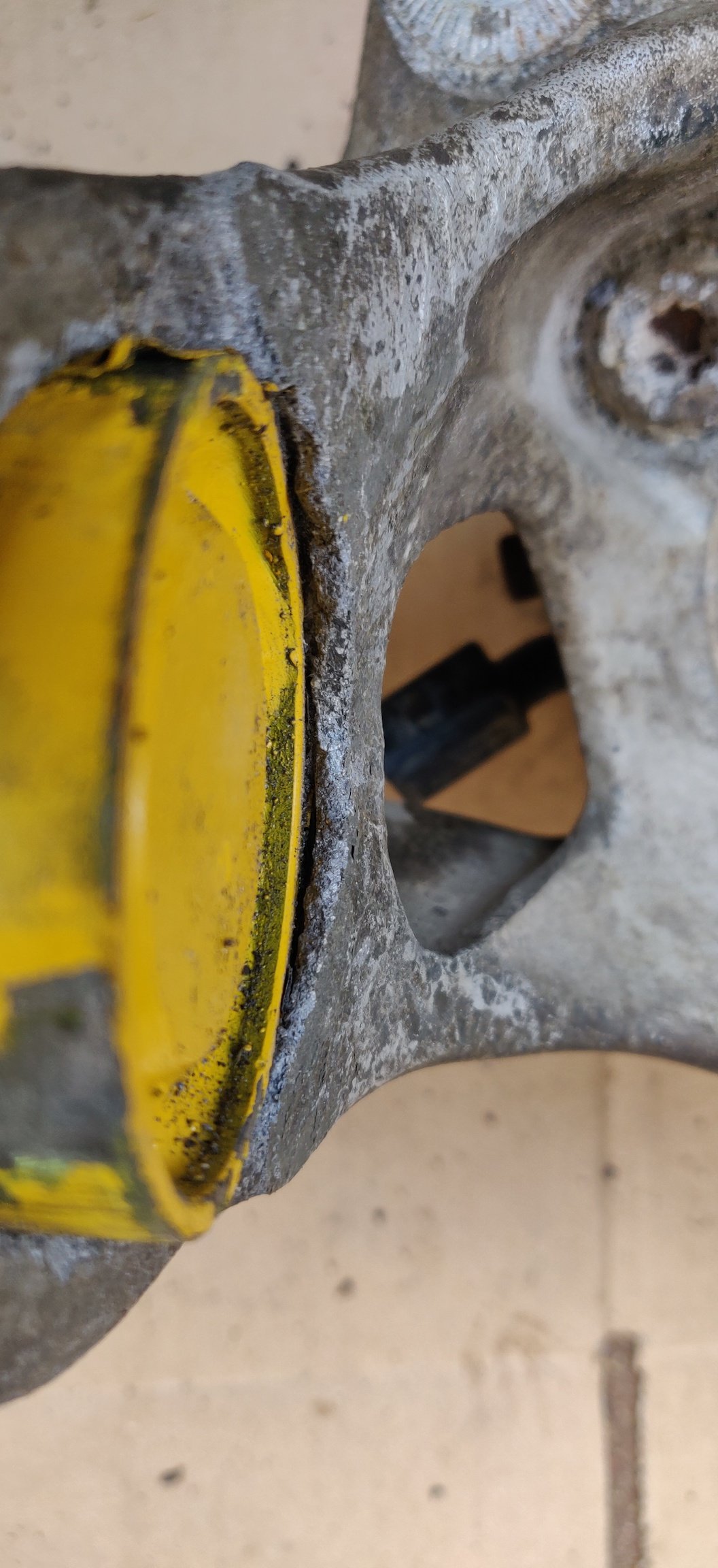

Or at least nearly so. This took an hour in comparison to two for the other side. No idea.
I'm guessing the yellow paint job on the Bilsteins add a thickness, the hubs having years of corrosion, and possibly the spreader tool I used not spreading enough, were contributing to this crazy struggle I've had.
If I get to a position where the struts need to be separated again for whatever reason, I'll probably need to research and see if there's a more significant spreader tool, just a fraction of a millimetre more was probably going to be enough.

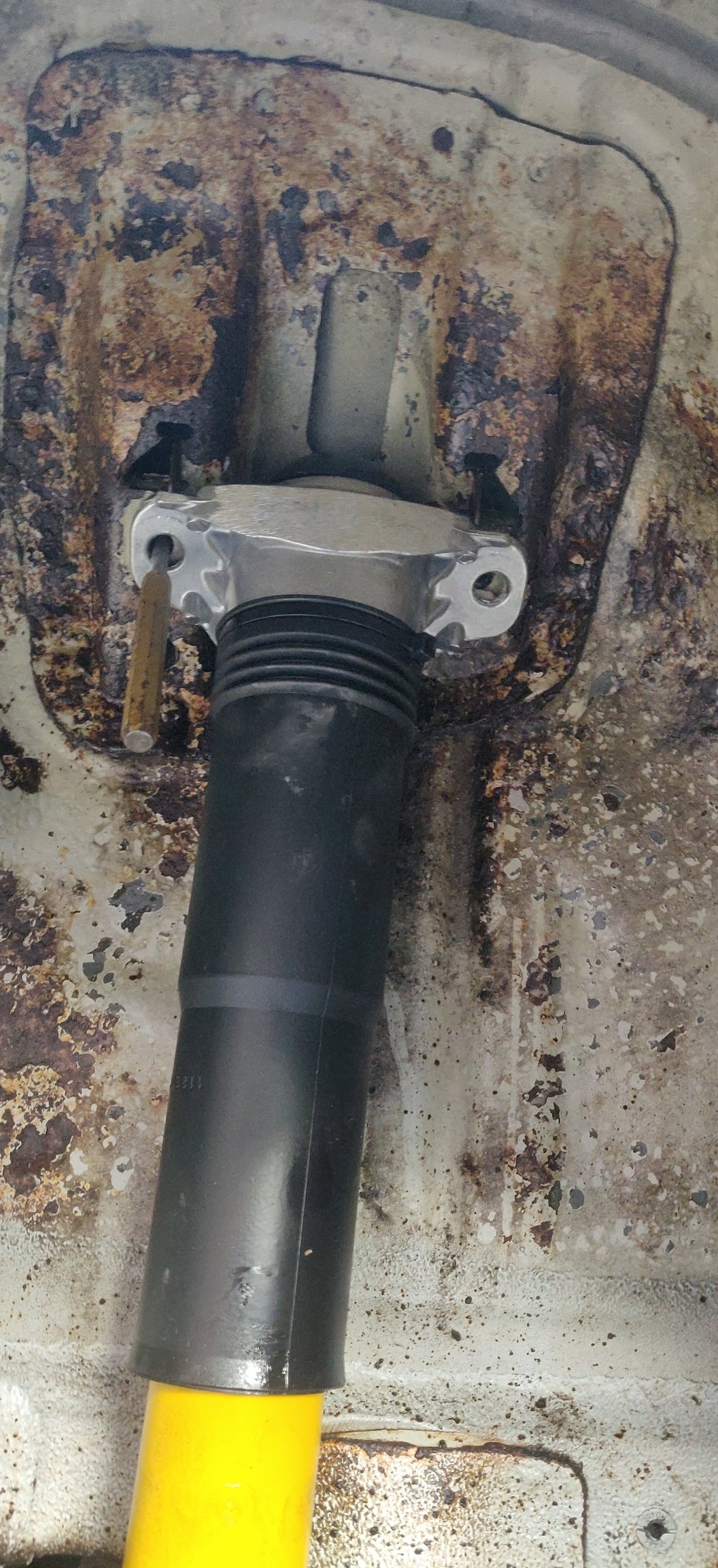

Anyways, fitted the strut to the turret:
Then got one of the strut bolts and checked it goes in:
So that appears to be fine. So then it's the same as the other side, tapping with a mallet to get the driveshaft into the hub, then lowering the arm to get the ball joint bolts in:

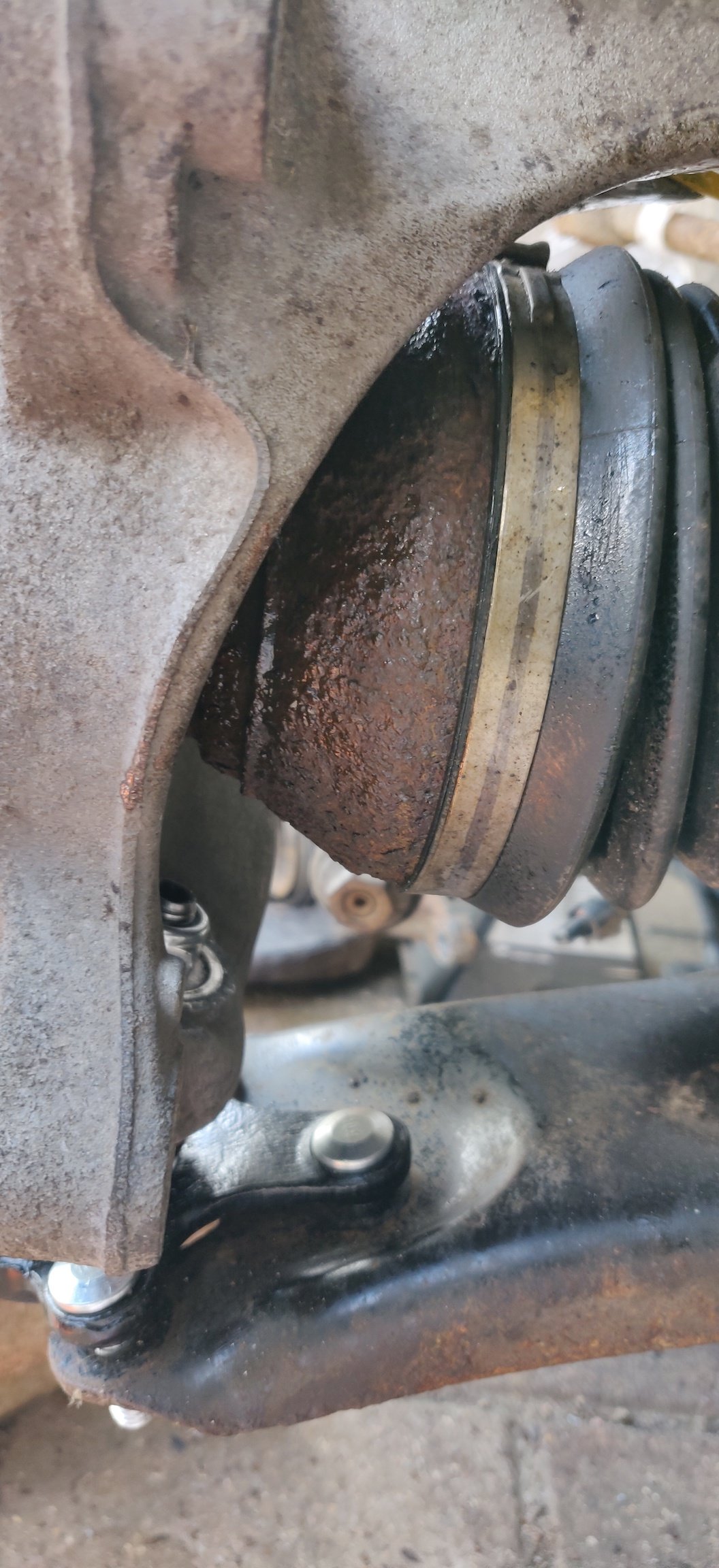

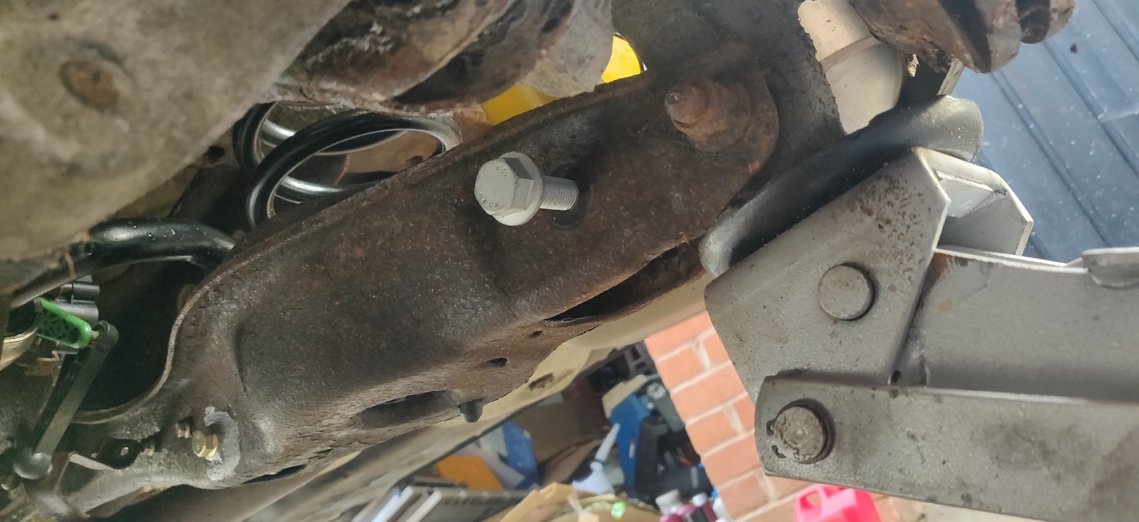

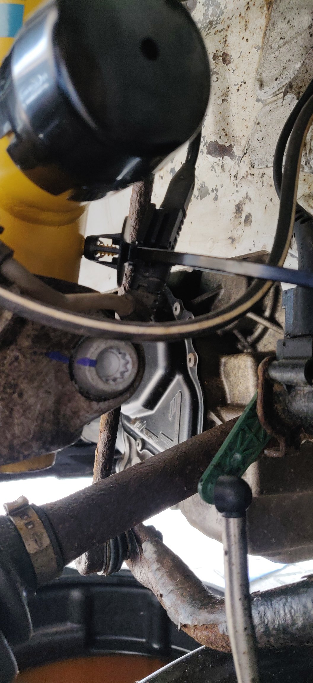

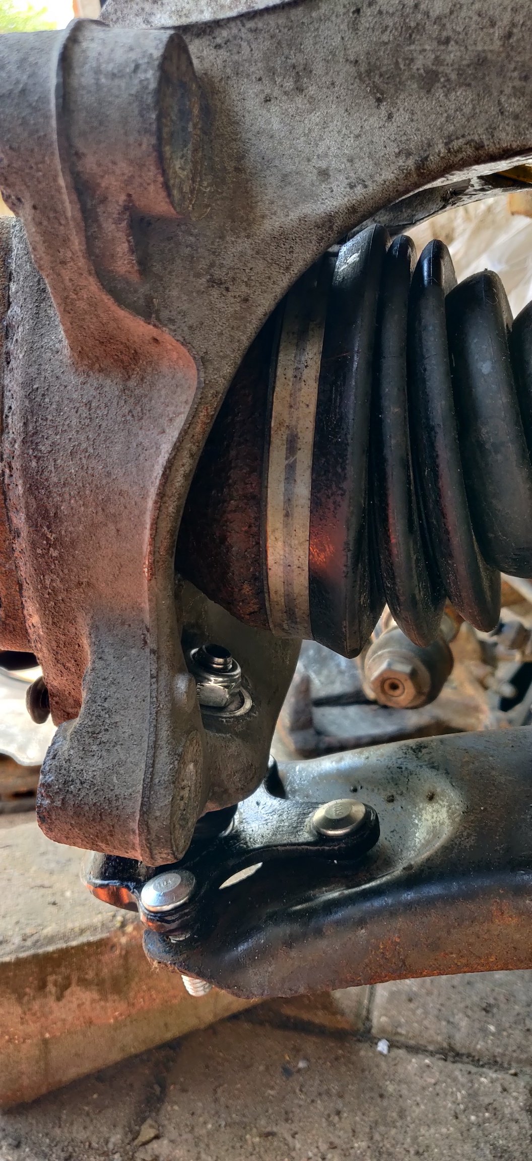

Once a few more taps got the driveshaft in enough for the bolt, then began tightening it down:
So it looked like this before:
Then once the driveshaft bolt couldn't tighten by hand anymore:
So once the ball joint nuts are tightened up, and the track rod end nut, then only torquing them up to spec is left.

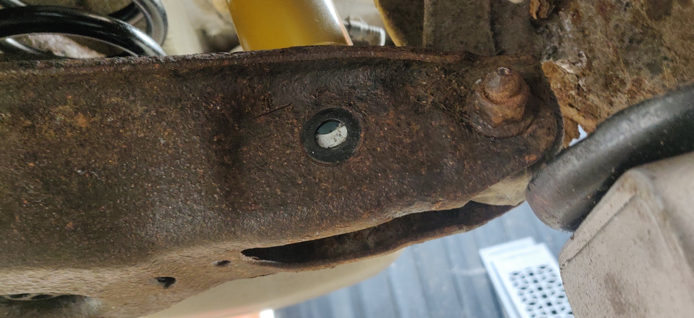

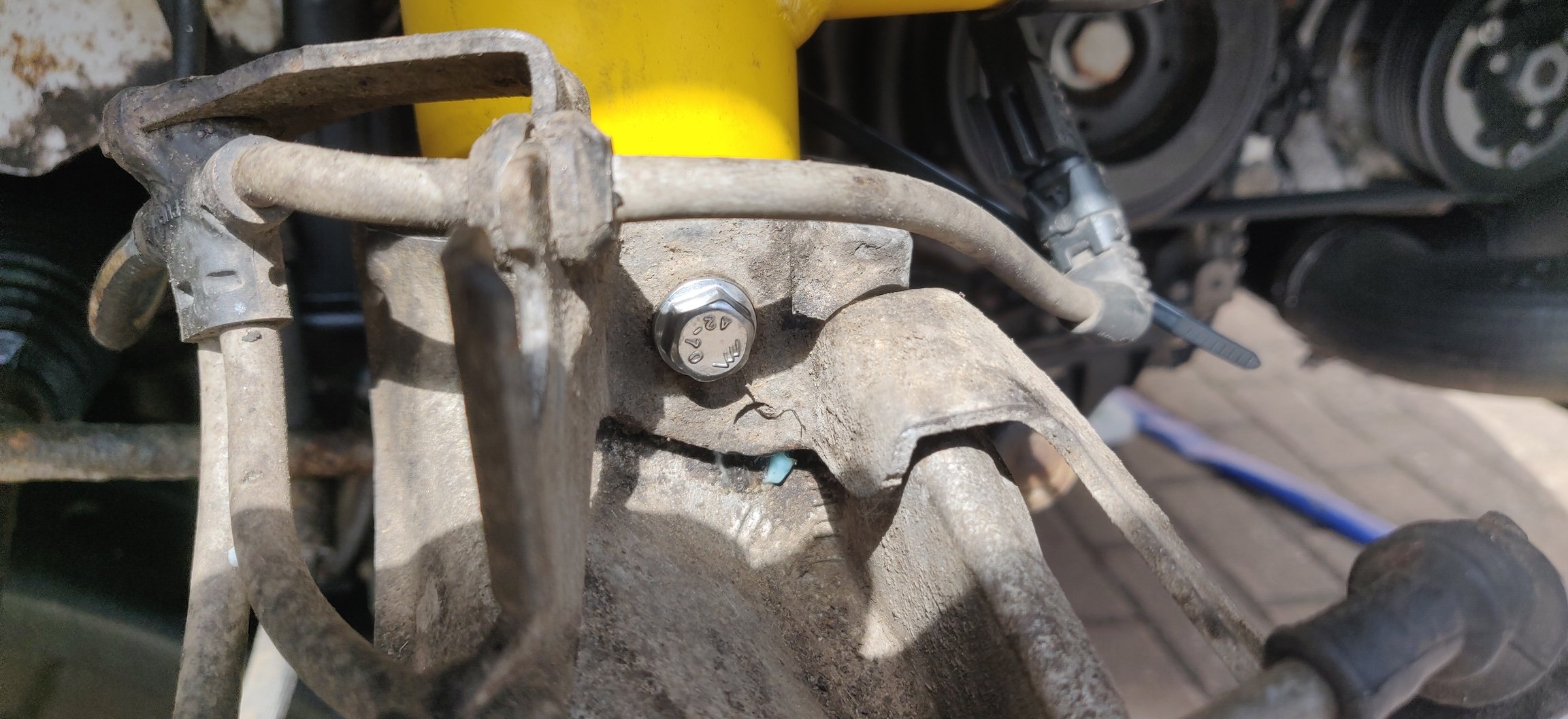

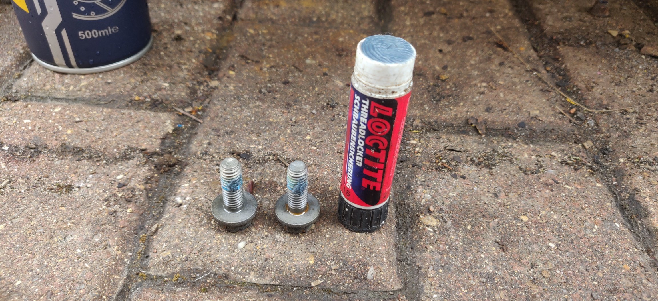

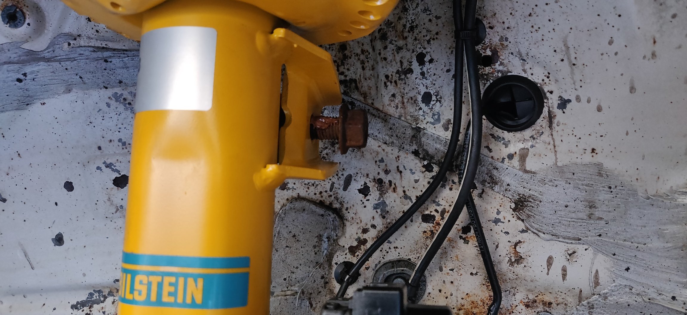

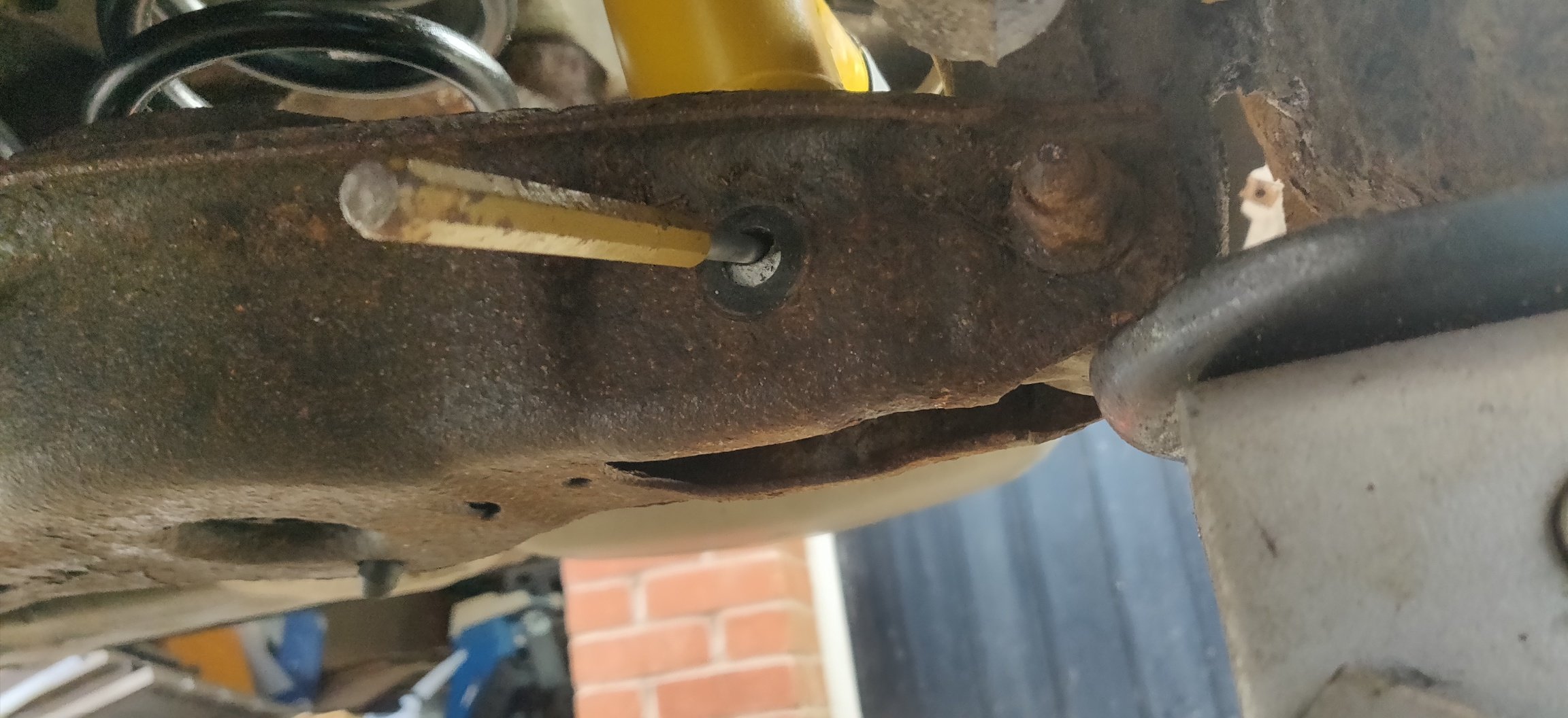

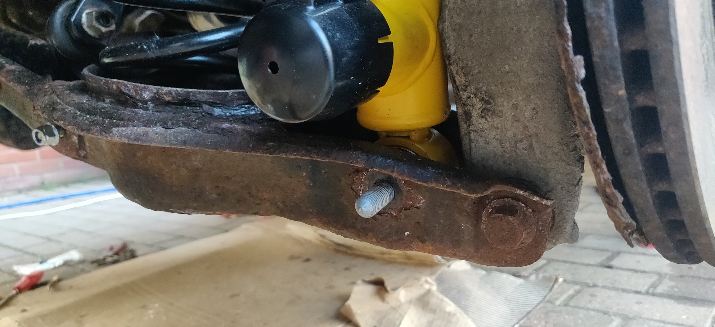

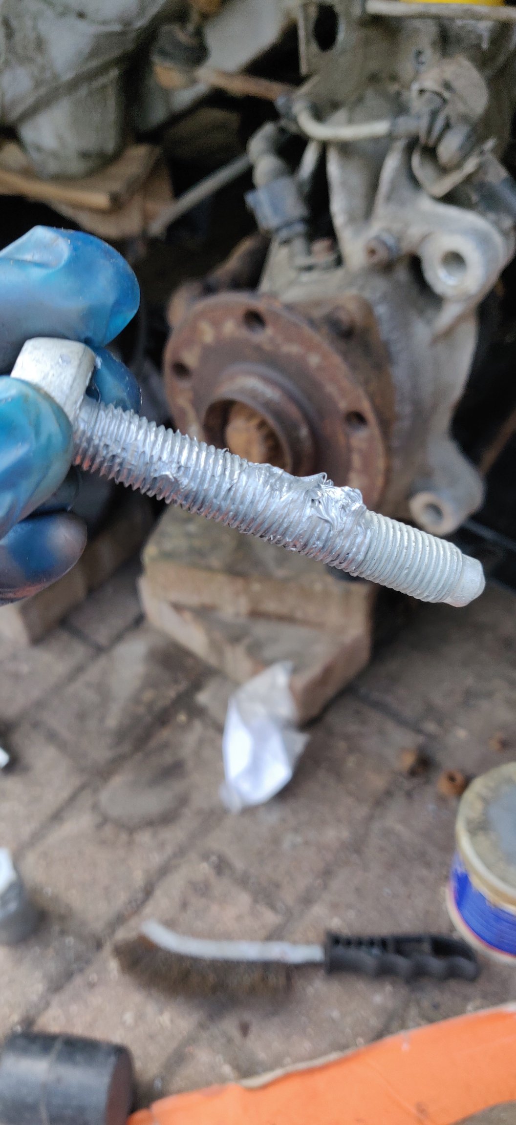

Well, bar the strut bolt, so for that just went mad with the Alumslip:
Then put it into the strut, rotating it as I went in to try and get the grease spread out and filled the strut void as much as possible. The end wasn't greased, for the nut to be winded in:

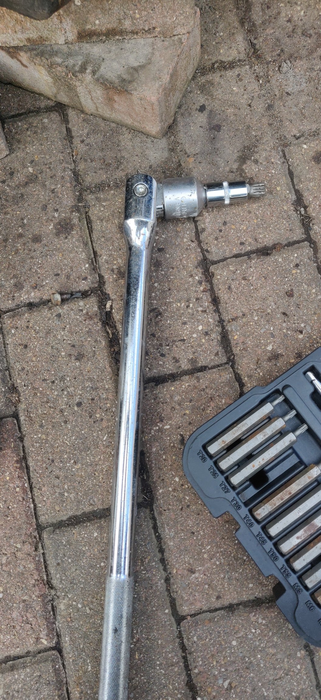

It's an 18mm nut, and an M14 spline bit for the bolt, just hand tightened for now.

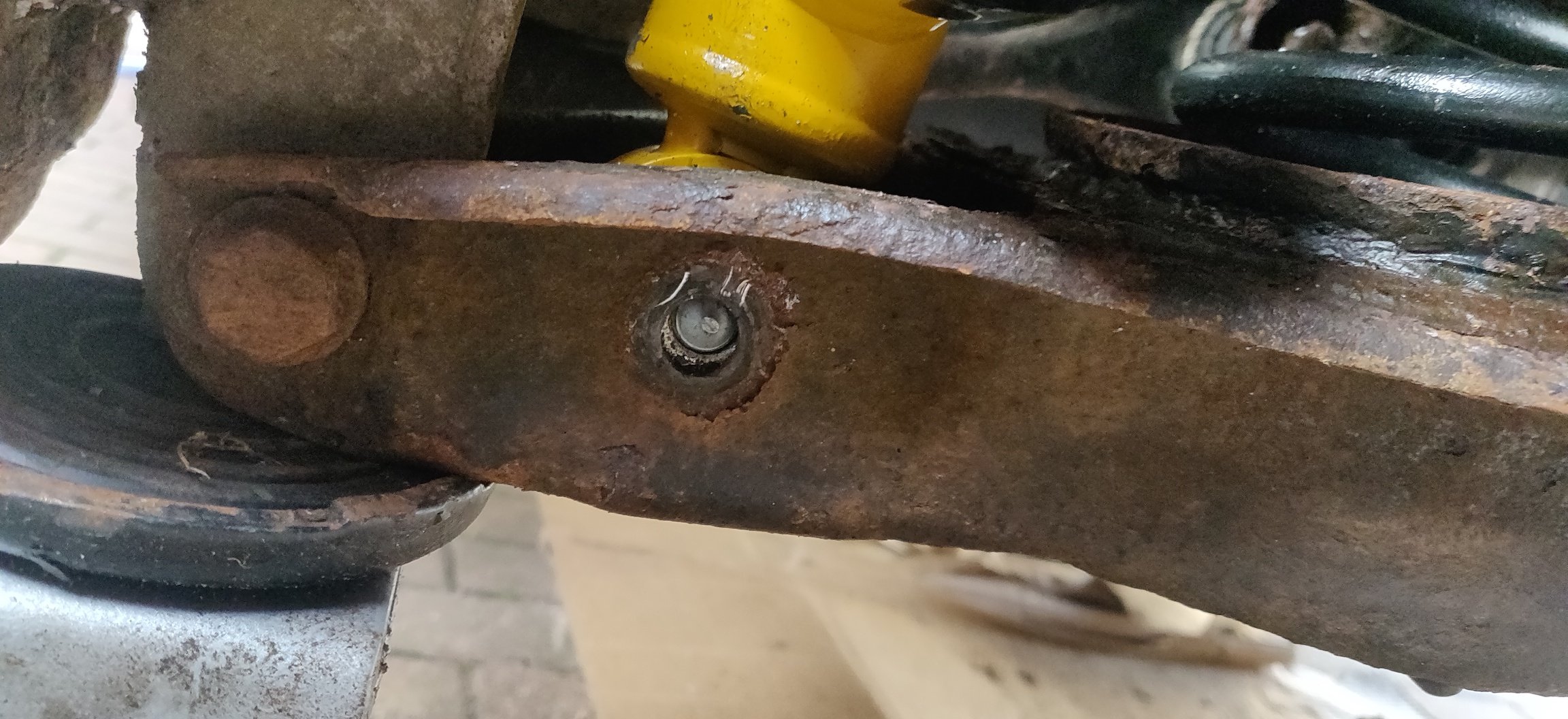

Then slapped some corrosion block grease where the bracket mates to the hub and copper grease on the bolt:
Need to tighten this down later (or maybe source a stainless replacement).

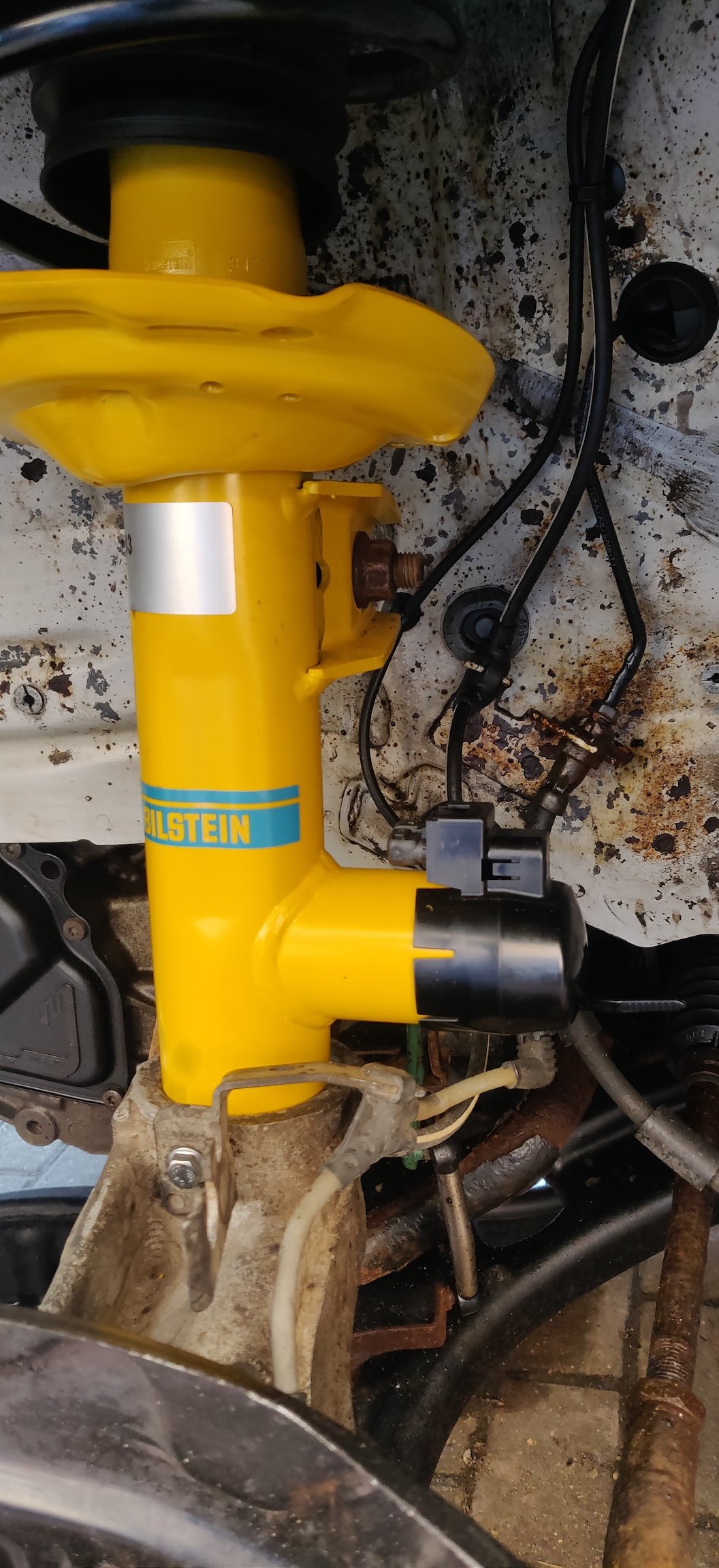

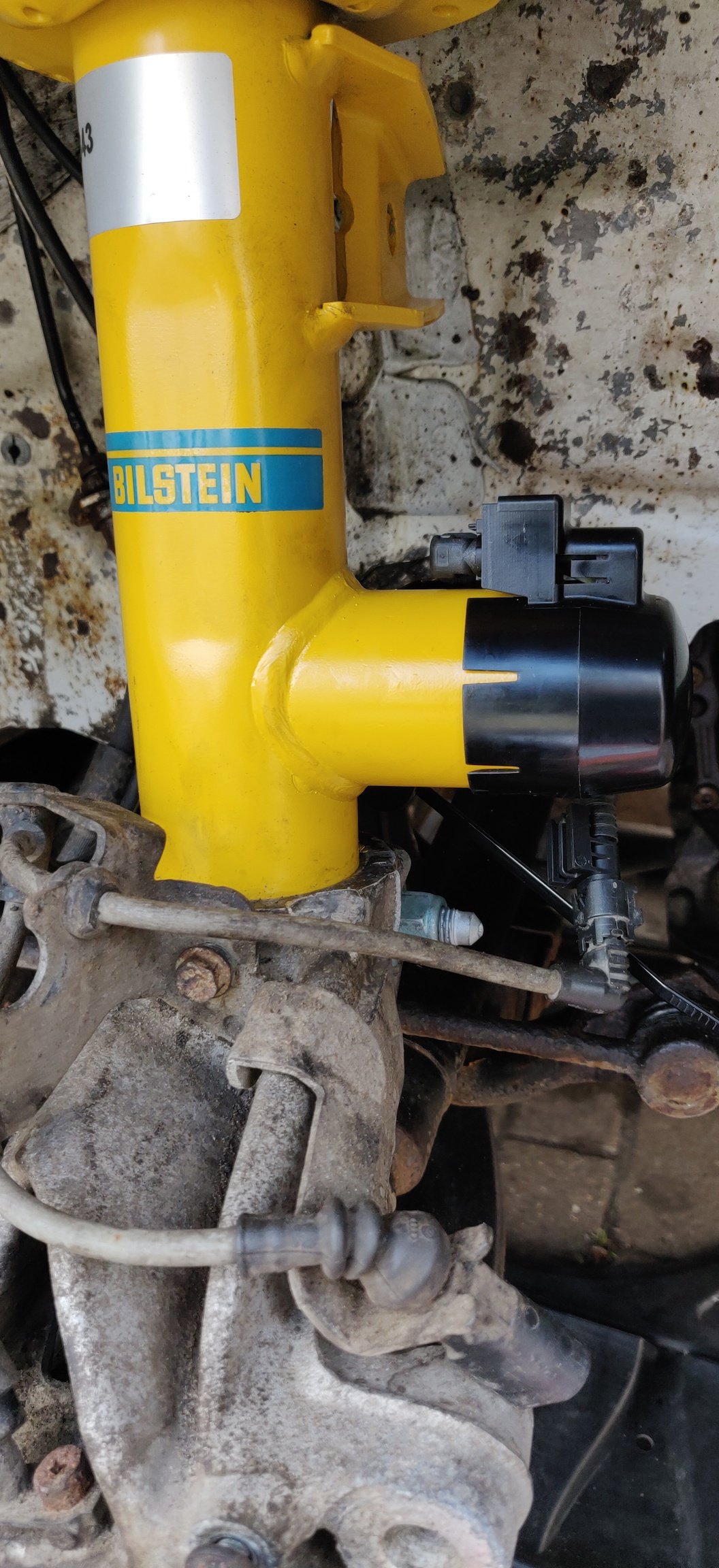

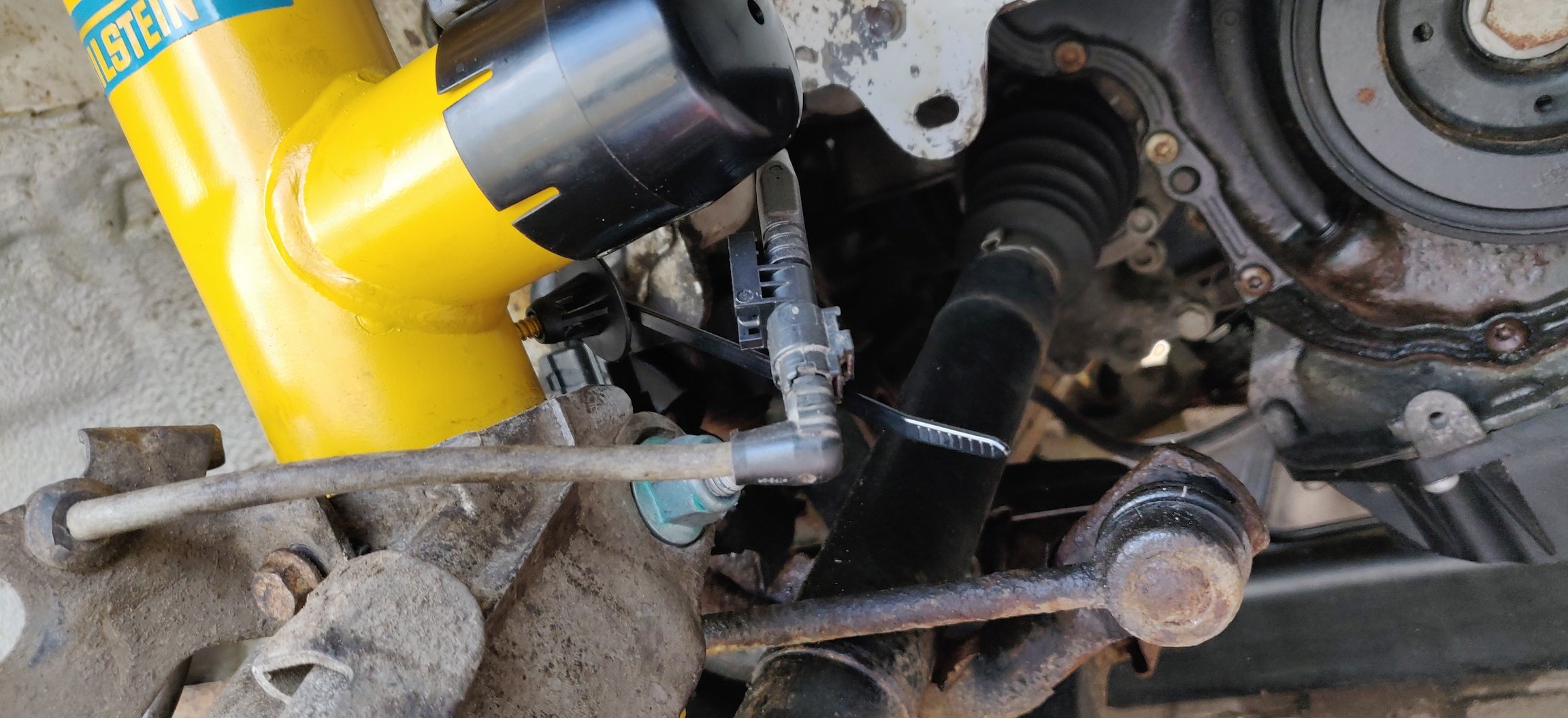

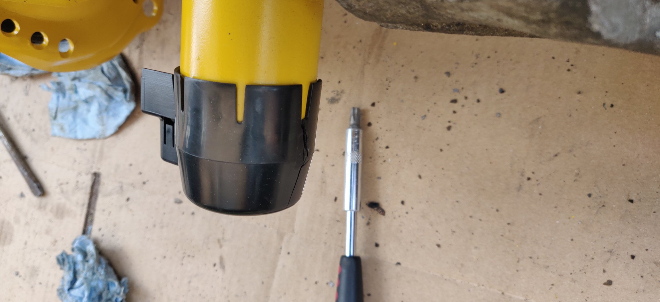

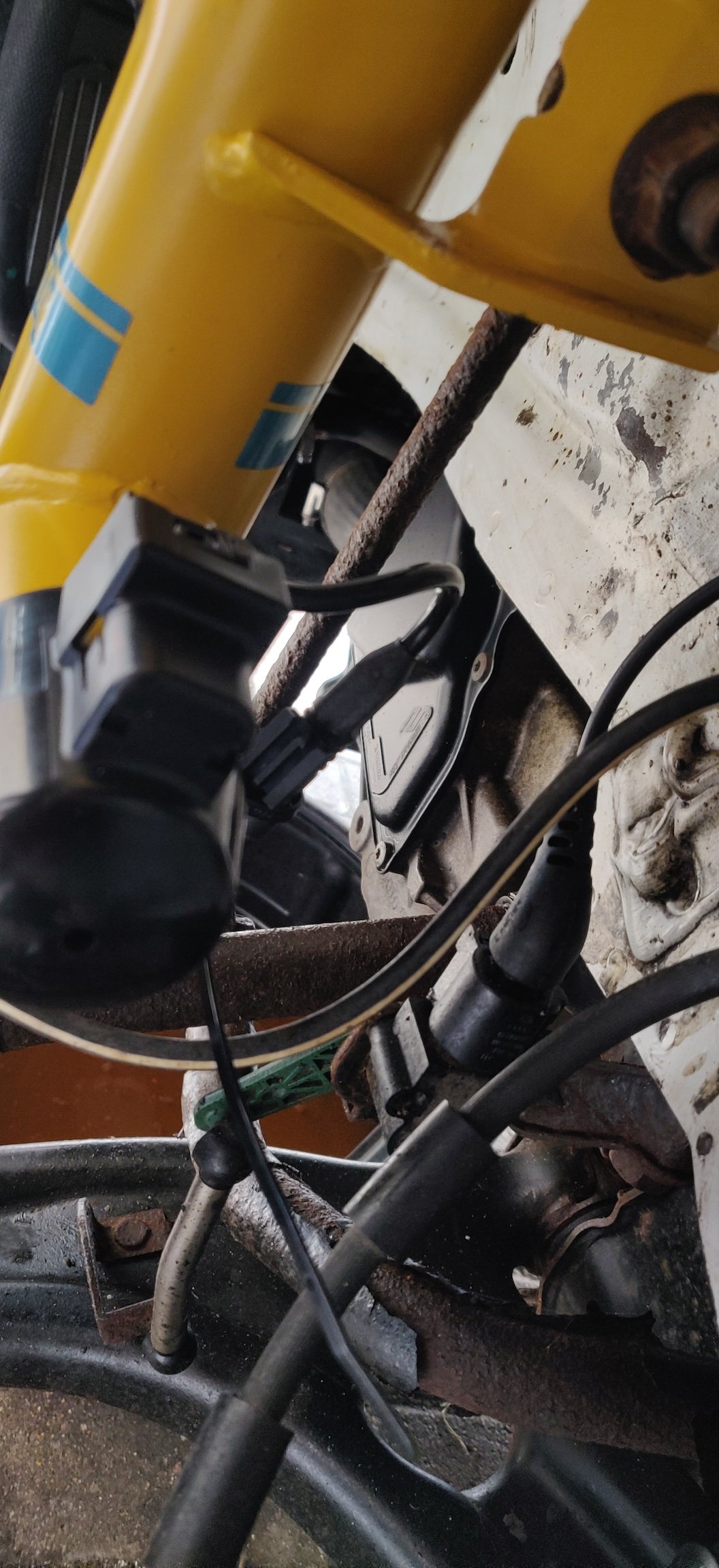

Then dry fitted the wiring to the Damptronic:
The Bilstein dampers are supplied with an adapter to connect the Damptronic to the OEM connectors, fairly self explanatory, but the routing:
Isn't super clear, so I've left the clip on the strut captive bolt and I'll plan it later. This is mainly to not have any connectors exposed.

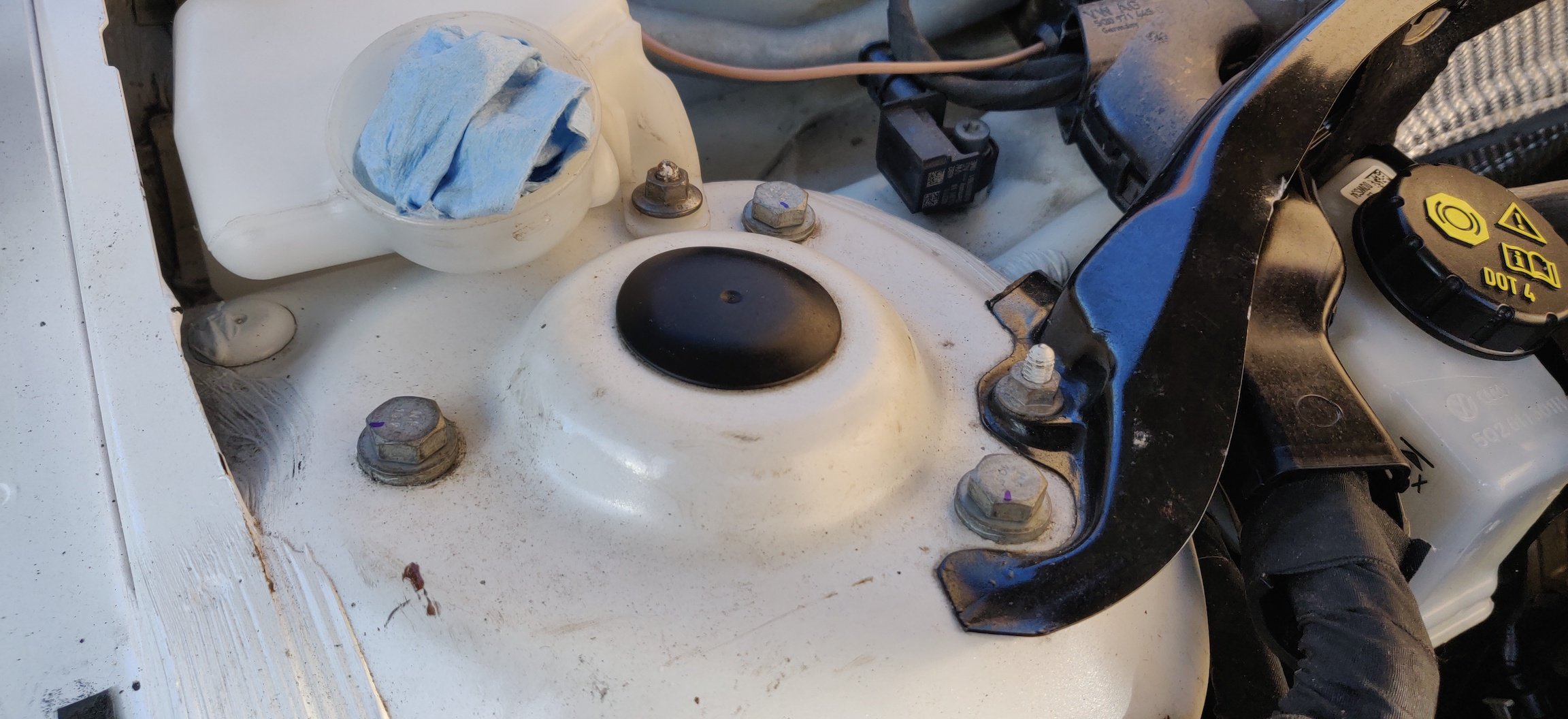

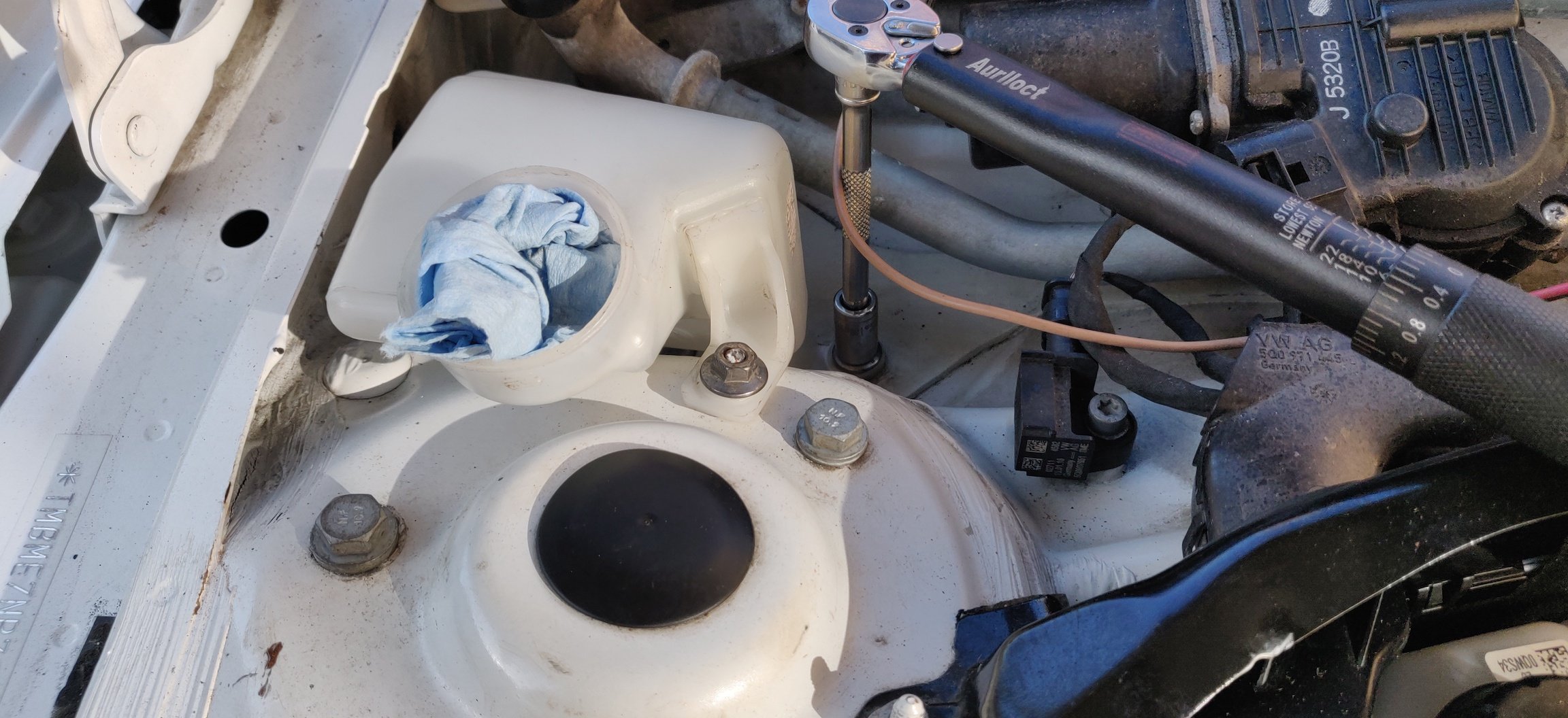

So given the right strut was just done, made sense to sort out the washer bottle, so attached the hoses and connectors to the washer bottle. Looked like it was fairly idiot proof. Used some of the dielectric grease on the connectors whilst I was there.
Then the wiring and hoses were clipped to the top of the washer bottle, and essentially just wedged the washer bottle in:
Takes a bit of wiggling and faff, but it eventually goes in, including that separate side bit, which also needs the hole in the end going through the opening in the windscreen cowl area. Started the nuts and bolt for the washer bottle, to be tightened later.

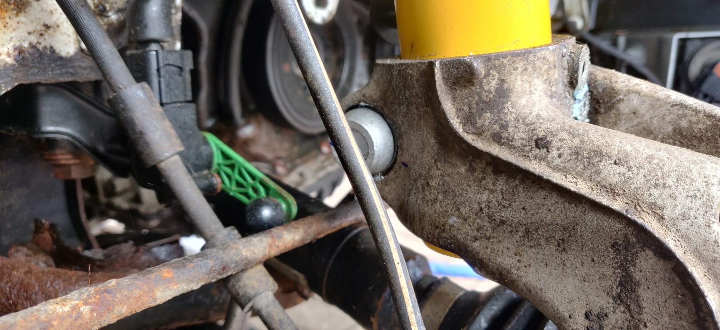

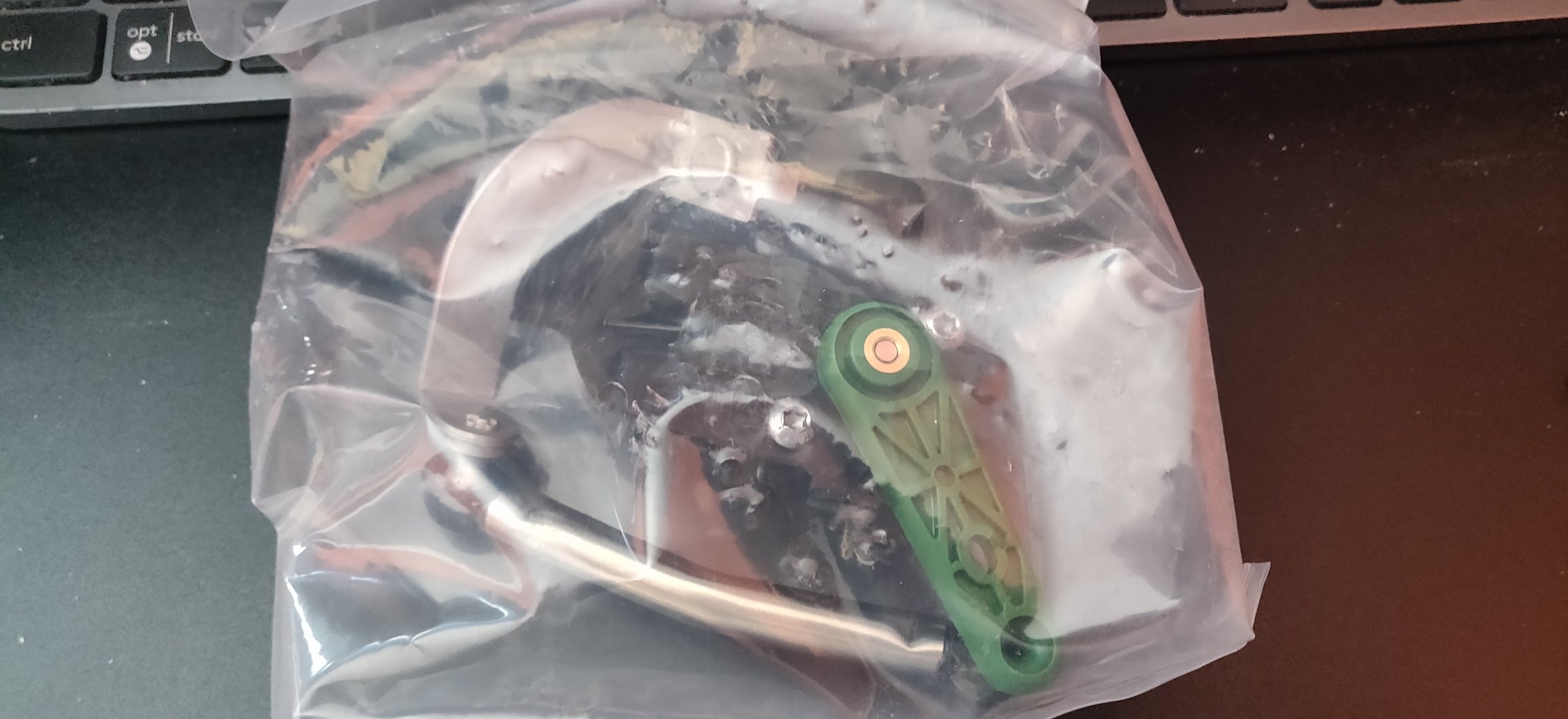

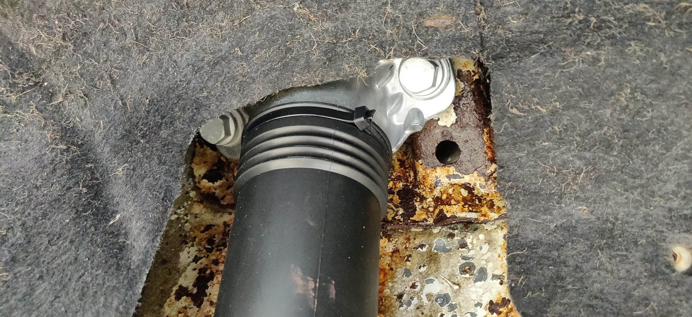

Got the rear level sensor, dabbed some dielectric grease around the connector, and then fitted the top level sensor bracket to the subframe. This is tightened to 5Nm. The top bolt is a little bit of a faff to get to, best to tighten it down first with the bracket swung away, then put into position once ready for torquing. It may be easier to use extensions for the top, but was able to get the small torque wrench in there.
I started dry fitting the bottom:
But decided to undo it for now until the suspension bits on the rear are fitted proper. Not gone round to this as jacking the arms will be involved.

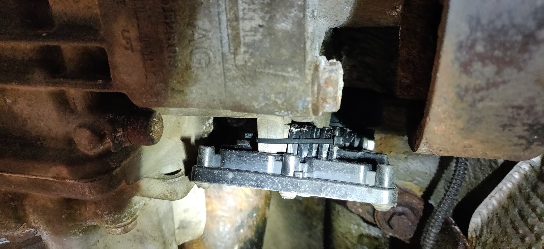

So just the Haldex controller left, so put dielectric grease all over the connectors to try and stop dirt getting in and making it a faff to remove in the future.
Then connected it all up, bolted the top bolt to 9.5Nm, and cable tied the bottom:
Had to use a pair of smaller ones to do so, but tidied up:
Who knows, I'm sure this'll be fine.

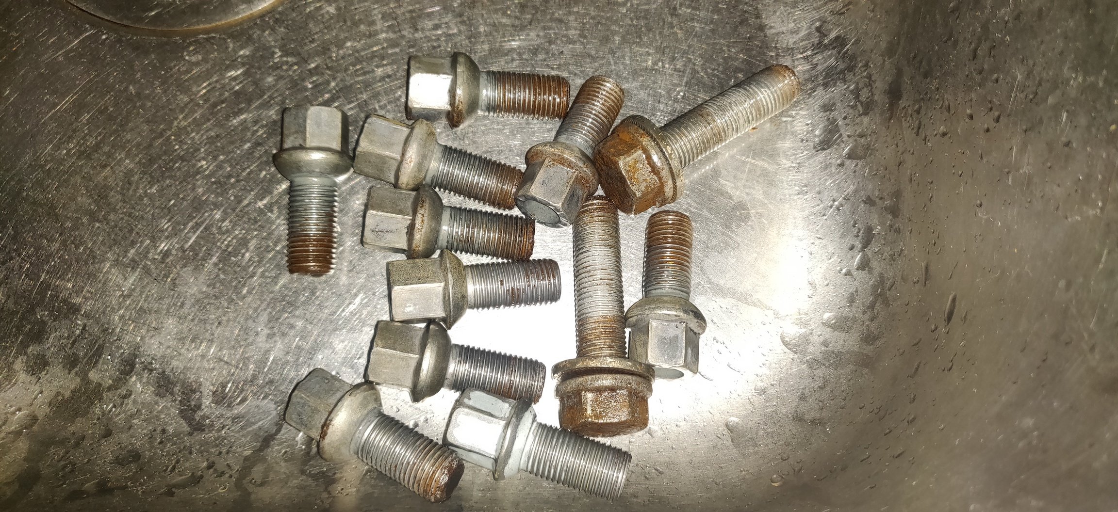

So that was pretty much the day gone unfortunately. Got the flap wheel and started to clean up the wheel bearing faces and the brake disc, and have just used the wheel bolts to dry fit the brakes:
They'll be taken off again in order to sort out the torque tightening of everything, but that's me for the week I think.

Got the washer bottle in the wheel arch all torqued up to 8Nm.
Replaced the torx screw with a stainless bolt, which has a pozidrive so actually like a phillips head just slips off after a certain tightness. The stainless bolts have a slightly smaller head than the OEM ones, so I'll have to play it by ear for the wheel arch liners. If I'm unlucky, I'll have to source some washers to go with them.
Then went and plonked the top part of the washer bottle into the cowl area:
The rubber bit that connects makes it a bit difficult if done dry, so best to smear a thin coat of silicone grease or probably some fairy liquid to make it slip into place without drama. The two nuts are then torqued to 8Nm as per the others.
Then started on the top suspension strut bolts:
The workshop manual actually outlines three variants for the bolts, and the ones I got were N 912 464 01 which needed 20Nm then 90 degrees. Interestingly the ones removed from the car were more likely the smaller N 101 277 07 as they looked like flange bolts rather than having a separate captive washer, so not sure if it actually makes a difference. Just sounds like a bit more exposed thread under the wheel arch?
Anyways, as you can see above, I couldn't actually find my paint pen, so I'll need to buy another, but for now, used a sharpie pen to mark an arbitrary place on the bolt. This I can then use as a reference to whether I've tightened it up to an appropriate angle. I guess one could mark the bolt and then mark on the chassis the expected angle to really remove ambiguity:
In my case though, I have pictures to act as proof I've done it.
Same for the other side:
So again, 20Nm then a right angle:
I know there are fancy tools like electric torque wrenches that beep for a target torque and angle, maybe one day I'll splurge on one of those, but maybe not as this will be the last VW group car I ever own. Depends if any other cars with TTY bolts are on the horizon...
Anyways, with the top strut bolts tightened, there's technically nothing stopping the cowl covers going back on:
So dry fitted the cleaned up passenger side. The new one has holes in it for presumably a left hand drive wiper set up. I think I saw some grommets to cover those, so could still use the new one if I fancied.
I put the clips in, but had to remove them again to fit the other side on:
The driver side has a little latch underneath that slides into the passenger side cover, before it can then go over the wiper blade mounts and the hole for the washer bottle. Then put the clips in place for now more so I don't misplace them. I'll need to get the cowl covers to clip into the small bracket across the windscreen. Workshop manual suggests some washing up liquid as a lubricant, so same as my fairy liquid suggestion earlier.
The driver side sticks up slightly at the edge, not sure if that's due to it being new and been packaged, hopefully it'll go back to a more expected shape.

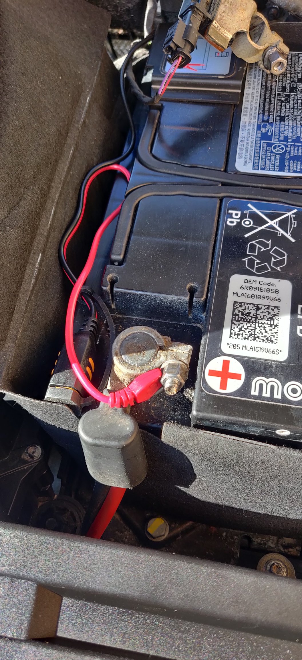

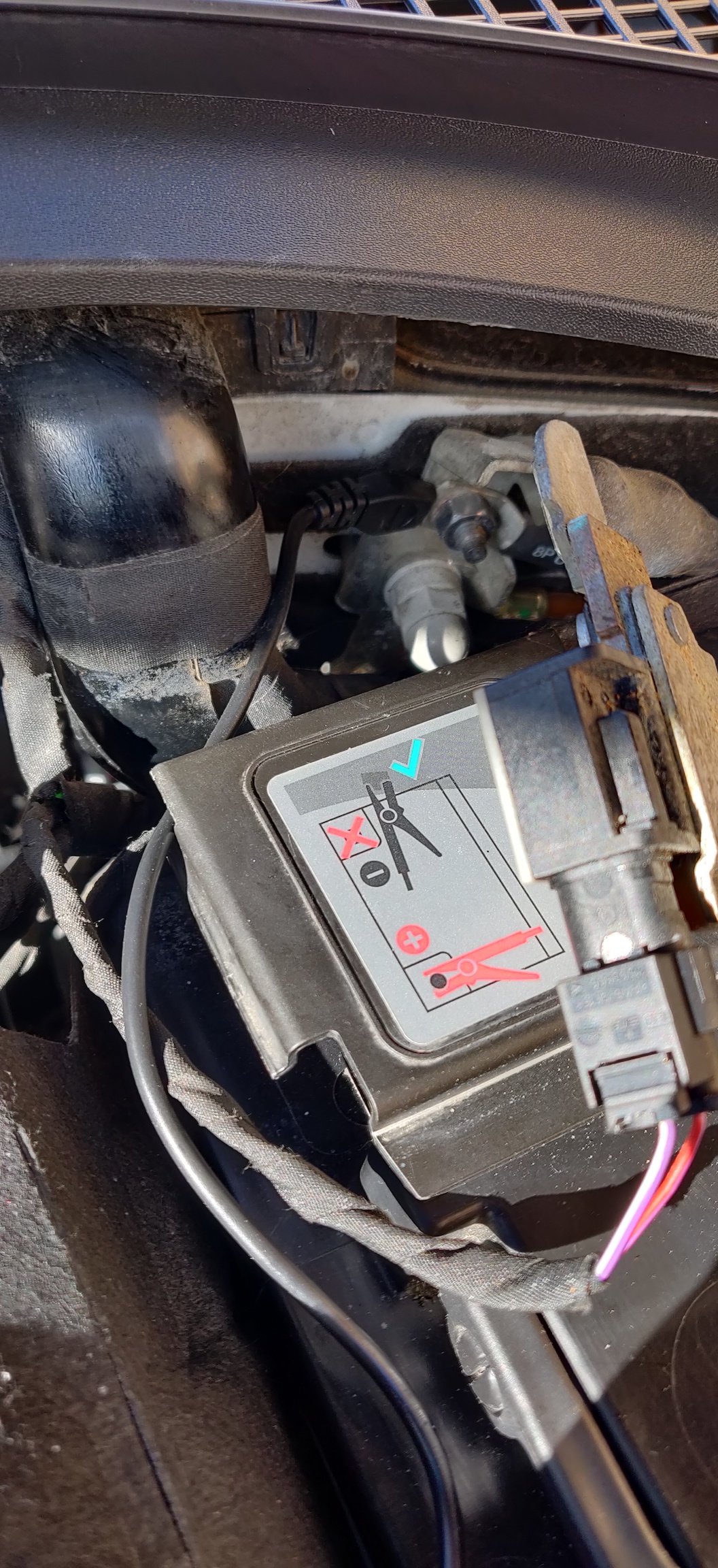

Decided to do another random thing:
Had a spare Ctek connector with M6 eyelets, so connected it up to the positive. Bent the eyelet to allow the connector to be more horizontal, but I don't think that'll be an issue.
The negative was a tiny bit more of a faff:
The negative connector looks to be designed to not have its bolt and nut removed (not without bending out some locking tabs which keep them captive), so decided to fit it onto the chassis point which is used for jump starting too I believe.
Was a bit tight, so just had at it with a spanner and tightened up as best as I could.
Then tackled the ball joint bolts:
I noticed the bolts on the ball joints are marked with 10.9, so consulting Google, for M10 bolts, the recommended torque is 75Nm.
So decided to experiment.
Torqued the bolts to 40Nm, as the workshop manual specifies 40Nm then 45 degrees. I then marked a corner as per above and got the torque wrench set up to 75Nm. By the time 45 degrees was reached, the torque looked to be nowhere near 75Nm.
So left them at the specced torque, but presumably, they are nowhere near being stretched, so I think they should be fine? They're aftermarket, so nyloc nuts are involved rather than the typical self lock nuts as per OEM.
The tie rod ends were at 20Nm and 90 degrees. I guess technically I should replace them, but I'm being a bit blase with the tie rod ends, I'd rather just replace them rather than a single nut. Of course, I totally expect the removal of said tie rod ends to be an absolute pain in the arse given everything else thus far.
So that's it for now. I've torqued up the strut bolts to 70Nm, but haven't angle tightened them yet, as I think I'll need a helping hand to keep things from spinning, as it's 180 degrees, so a huge source of danger in regards rounding that spline bit bolt. Why not just a normal hex and normal non-TTY bolts?

Decided to get an M14x1.5 tap and die from Amazon for £9.99. The initial thought was due to the brake carrier bolts, and their general state, but weighed up the pros and cons of just getting new bolts.
I then realised that the wheel bolts are the same, and they're in even worse state, so I felt cleaning them up with this will be worth it.
Also this arrived earlier:
The replacement hose to that additional cooler. Second hand one from eBay for £15.96 which I think compares similarly to an actual new one from lllparts etc.
Guess I got impatient and didn't want to wait a week or the extra tenner or so for delivery unless I'm buying a bunch of stuff.
It's the correct part I believe:
So 5Q0 121 051 L as per https://www.lllparts.co.uk/product/5Q0121051L/skoda-coolant-hose-5q0121051l (the 5Q0 121 051 without the L suffix is more expensive).
It's interestingly dated circa 2013, so it'll be the oldest part of the car! It came from an Audi Q2 according to eBay, so surely a premium part, lol.
Anyway, the 7mm ratchet spanner to take off the clamps and replace with the new one:
All tightened up to 5Nm. Then just topped up the coolant tank slightly:
The old one with its rip:
Chalk it down to my aggressive use of the pliers to free it from that radiator.

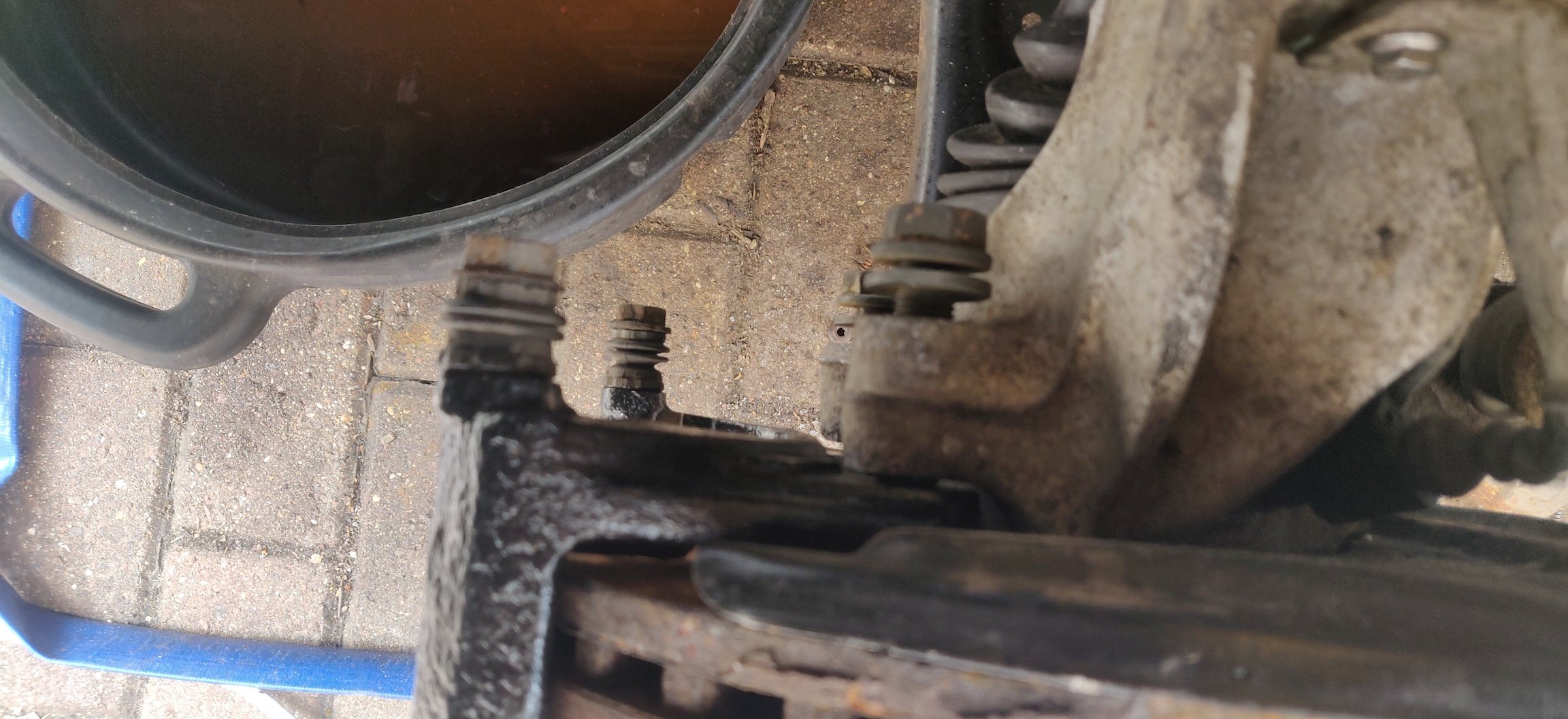

So this is an example of the brake bracket bolt:
Just lots of aluminium corrosion where it passes through the hub and the rusty end which is where it's bolted and exposed to the elements.
So got the die, put some 3-in-1 oil on its cutting thread and all on the bolt, and just winded it through:
Any bit tight just got the ratchet spanner and for these bolts, a 21mm socket to aid getting the bolt through. It'll then usually go through easier and can then be done by hand. It's normally a case of winding a turn then back half a turn, but that's more applicable to cutting new threads.
Once wound all the way in, just reverse it out:
Quick wipe and it's better than it was.

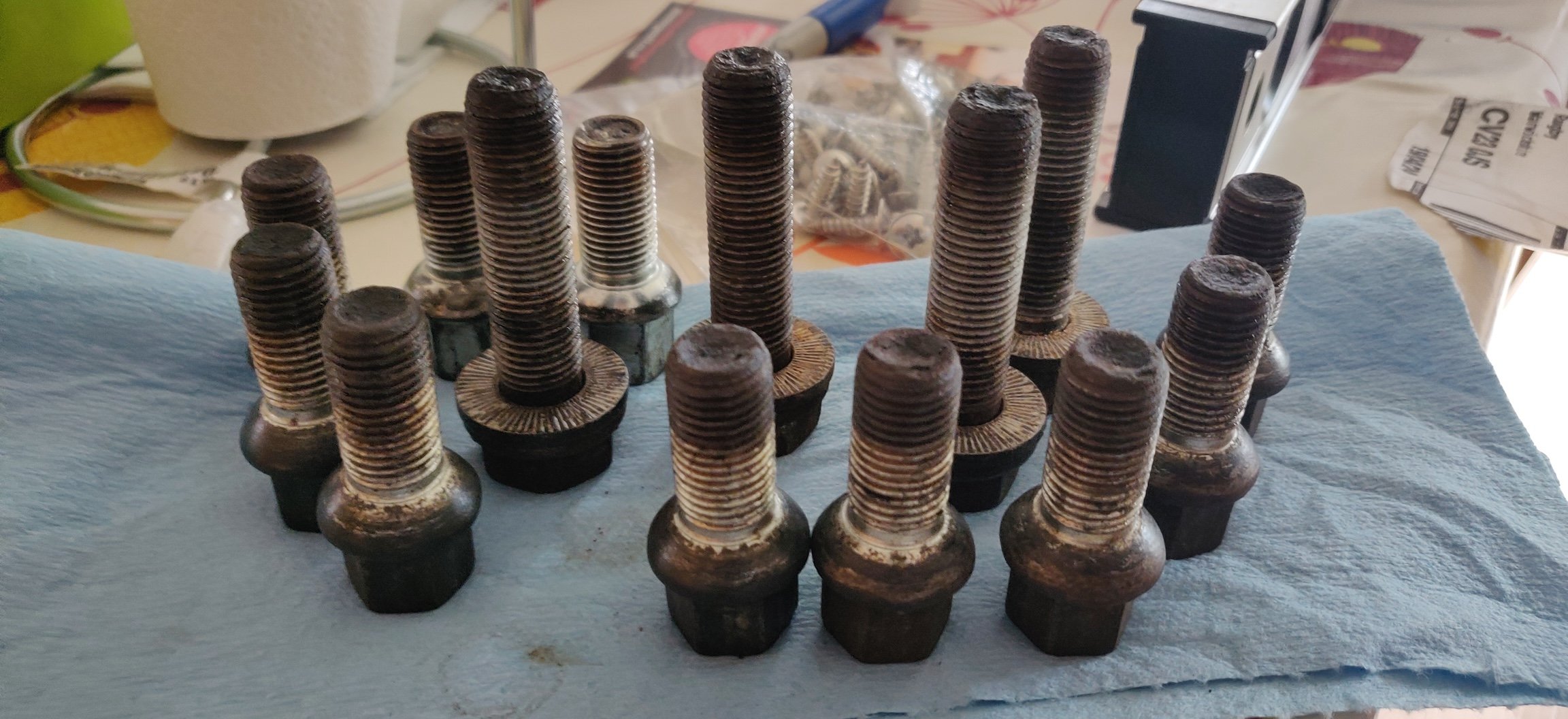

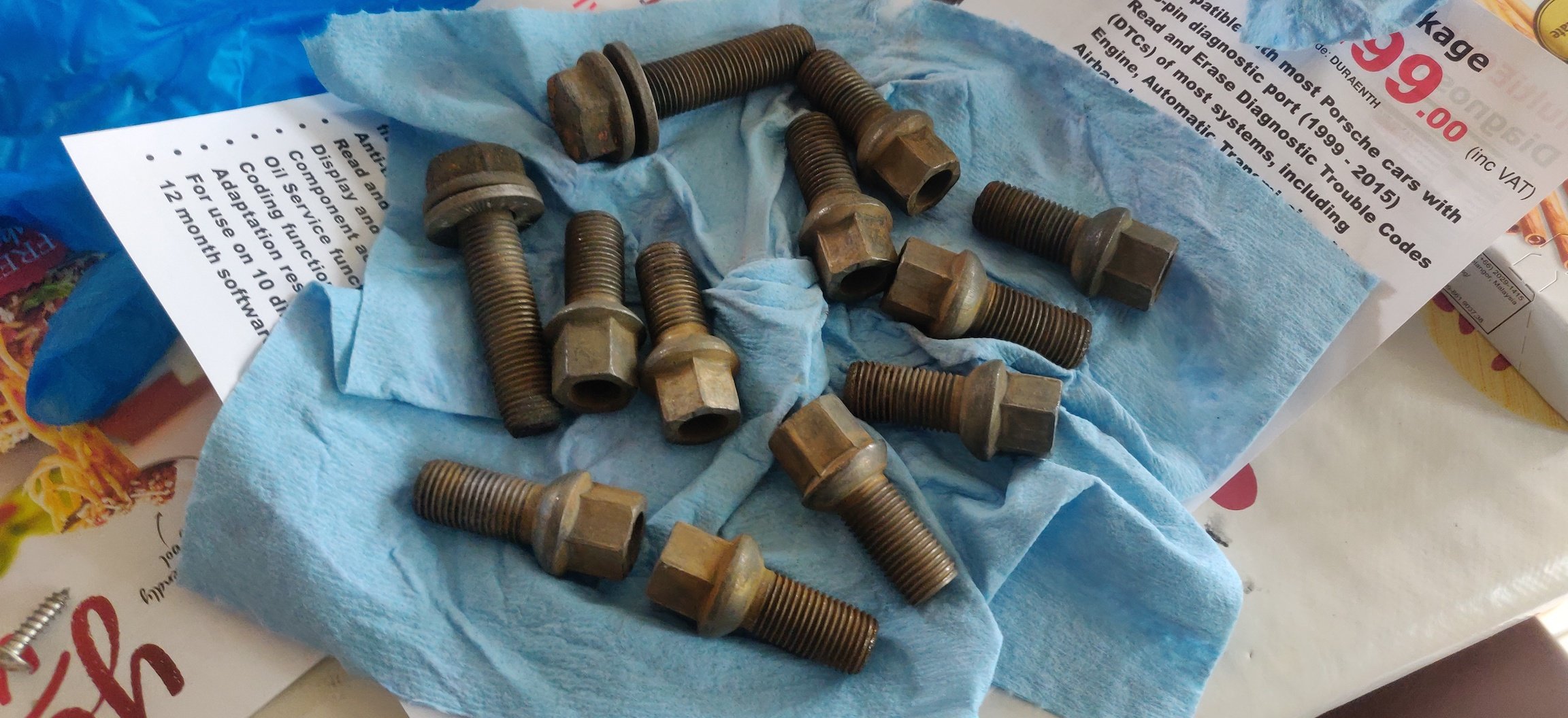

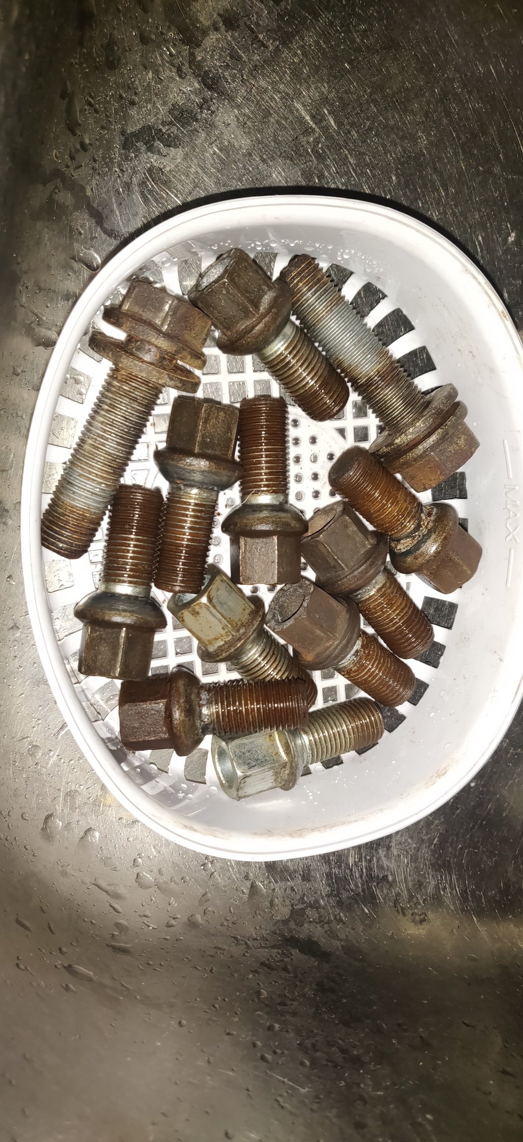

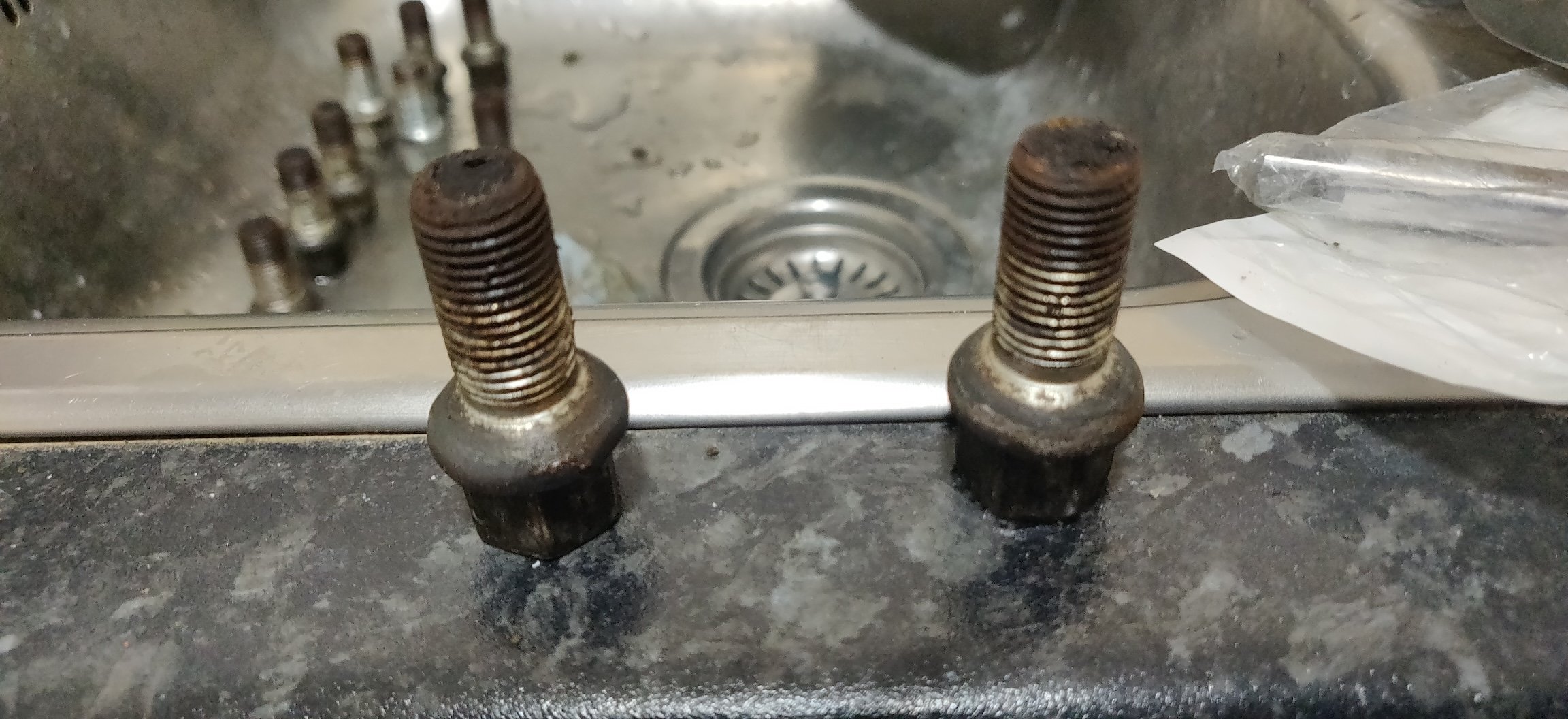

Repeated for the rest and started on the wheel bolts:
The wheel bolts were a mixture of ok and horrid, some with mountains of grease built up and some without.
This is after half of the wheel bolts:
So I guess some brake cleaner would probably finish these off ready for reuse.
Oh, and the other 10 bolts I guess.
I'll check up on the coolant level later and once I top it off and it stays relatively stable, then we're really getting there.
Still need to angle tighten the strut bolt to the hub, then reassemble the front brakes.
Once those are done, then technically there's nothing stopping the car from being fired up!

Weather is apparently going to get grim over the rest of the week, so decided to get some stuff in over lunch.
Replacement paint pen arrived:
Something from eBay for £2.89, got a purple one just because.
Some more bolts:
So some M6 x 10 flange bolts to replace the brake bracket ones to the front hubs, some M6 x 16 countersunk ones for the future when I get new wheel bearings and brake discs, and some additional screws in case I run short when reassembling the wheel arches.
Totalled £10.78 from eBay.

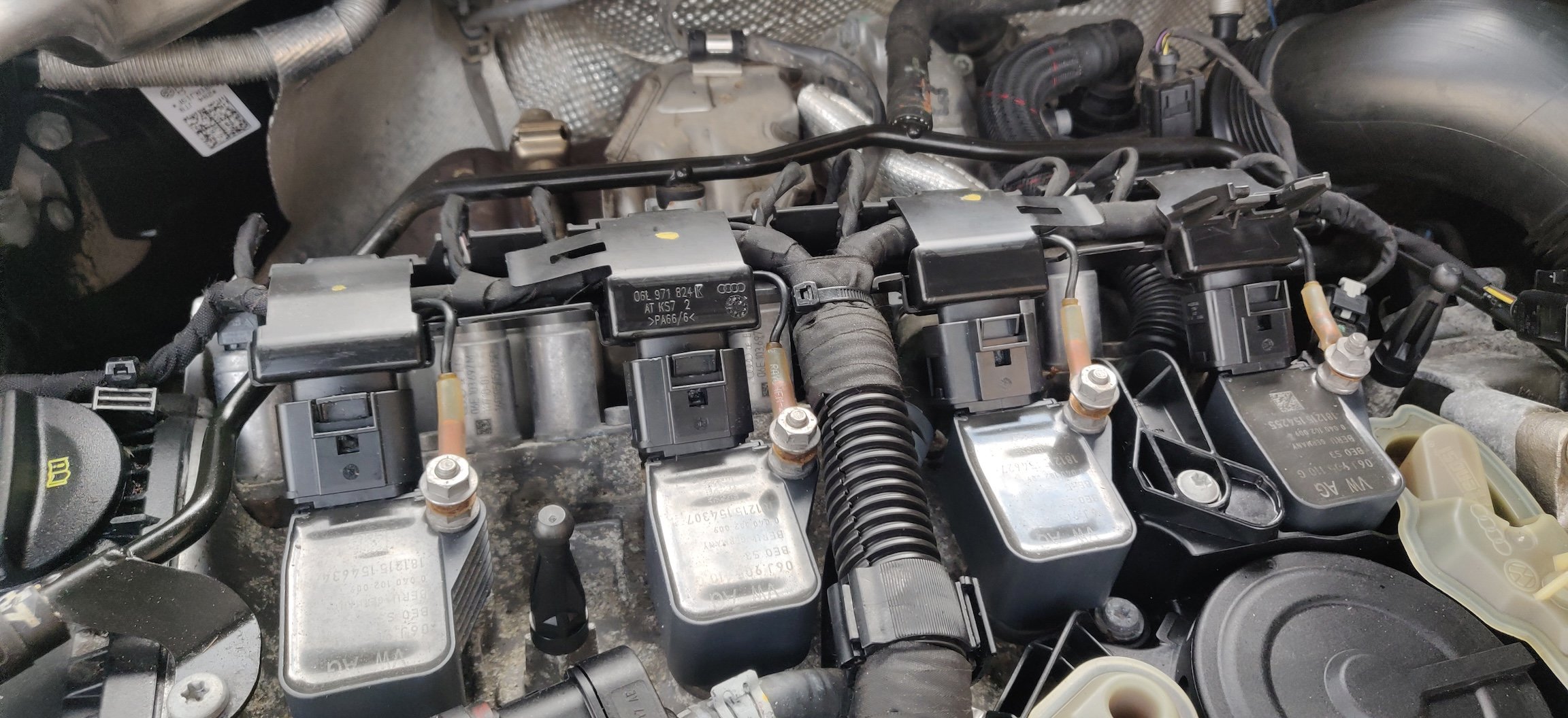

So another easy win thing, clipped the things on the coil pack connector back:
Bit more of a faff than I thought it would be getting it all aligned up and actually snapping into place.
Then checked the coil pack bolt thing to ensure its done to 10Nm, before nipping up the nut for the presumably additional ground bits also at 10Nm:
Don't think there's anything else I removed at the top of the engine, so popped that plastic cover back on:

Then decided to tackle that 180 degree tightening. I rummaged through the garage to find:
A 3/4 inch breaker bar, which I last used for my brother's Audi A3 where that crankshaft bolt is something insane in regards angle required. I ended up using my legs with my body braced against the wall to get the required leverage. If I'm ever unlucky enough to need to replace the timing chain on this engine, it'll be deja vu.
Only have the reducer adapter for this thing though, as I can't justify the cost of dedicated 3/4 sockets for such rare use cases.

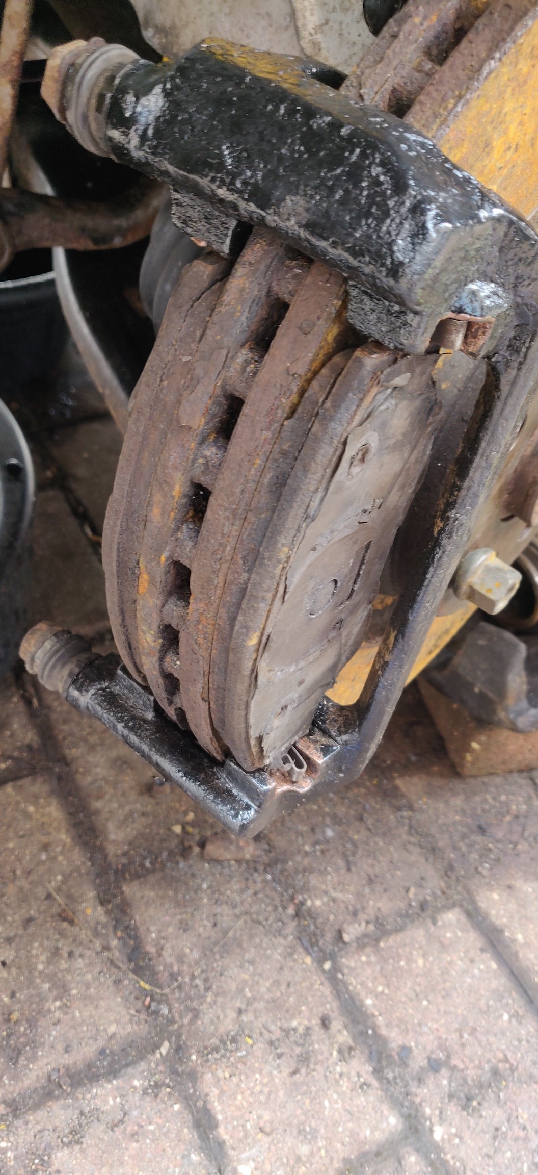

So for the right side, took off the brake dust shield, and moved the brake hose and wiring brackets out of the way, so that the 18mm wrench essentially wedges against the hub:
The plan was to mark the bolt with the sharpie and the opposite side of it, so that when it lines up, it'll suggest the required 180 degrees:
The pic has some wiring in the way, but you can see the intended destination as it were.
So got the M14 socket, into that 3/4 breaker and carefully applied some force:
This pic shows it better, halfway there, just continue until:
It's probably easier with some extension on it, but didn't want to risk rounding the bolt so kept a hand on it over the centre.
Then got the paint pen and marked it up.
So that's that. Got the stainless bolt to replace the existing one for the brake bracket and tightened to 8Nm:
Then got the dust shield back on with that tightened to 12Nm, so that's the right side sorted.
Left side was a little easier. For whatever reason, the nut was not rotating with the bolt, so was able to tighten the thing with just my other arm counter holding the spanner:
Then the same process:
The dust shield could have been removed which would have meant more of a swing with the bar, so probably slightly easier:
But once done, tightened up the brake bracket and dust shield:
So that's that!
As eager as I am to get the wheel arches on, I ordered a replacement coolant expansion tank to replace the existing one, so want to replace that, before adding any more coolant in and checking for leaks.
The other side has all the washer gubbins, so I still need to check for leaks and to flush all that hose work through. But for all intents and purposes the front suspension is complete.

Got the right anti roll bar bolt into place into the lower arm:
Didn't take pics of this side as simply forgot to. This left the strut on the arm:
Which seemed to be a bit stuck. So went ahead and did the opposite anti roll bar link, with pics this time.
Essentially, its a case of clumsily using a jack to raise the lower arm:
Then using a pry bar or some such under the suspension arm to move the link and try and get it aligned.
There's a gap under the lower arms to do so, and after lifting it up a bit more, the side was clear enough to slip the bolt in:
Once done, went and slathered a load of anti seize on the bolt before reinserting.
The bolt stops roughly where the other side hits the arm:
So it's then a case of raising and lowering the arm to try and rejig the link and get it clear:
Tried not to raise it too high so as to start clearing the rear jacks, but eventually, this and more pry bar action eventually gets the bolt to be visible, so a few taps with a rubber mallet on the bolt head:
Then it's clear enough for the nyloc nut to go in place. I've used aftermarket bolts, which are 8.8 bolts, so I'll double check the internet for recommended torques for such a bolt. It'll be the same as what I've used for the anti roll bar clamps to be honest.
I then struggled with the struts. No amount of lifting the arm up and down was getting it to go in smoothly, so had to resort to being a bit ham fisted:
I firstly used Knipex pliers with a widened jaw to try and clamp it into place, which got it started.
From the opposite side:
The hole for the bolt was starting to be visible, so just went at it with a chisel and hammer on the bushing part of the strut to get it a few millimetres further in:
Then managed to get a punch small enough into the hole, and used it as a pry to get it further into place:
Then a few more taps with a hammer was able to get a bolt into place:
So once done, more anti seize before refitting.
From there, it was a struggle with a hammer and chisel to get the other side further down and into place:
This was as far as I got, before I decided to try a different approach.
I went and undid the top strut bolts, and it immediately looked like the better option:
Basically, once the top bolts were undone, the strut flies out, seemingly straightening out, which then meant the bottom bushing of the strut was easily manoeuvrable in the lower strut arm, hence the nut being put into place in the pic above.
So it was then a case of trying to get the top mount aligned:
This was met with a bit of resistance, but essentially, with some convincing, I was able to get it positioned a bit better, then a jack to lift up the lower arm helps locate it a bit better, then as per above, used the punch to help align the bracket with the holes, and once one bolt is in, the rest is straightforward:
So yeah, lesson learned, do the bottom bolt first.
Undoing the top strut bolts on the other side immediately dropped the strut into the lower arm, so it was actually not an issue at all getting the bottom bolt in:
The strut can then be wiggled to get the bolt through:
Significantly less drama. The top still has some resistance when being mated to the top:
But it's pretty much the same thing, jacked up slightly, and using something to align it to get a bolt in.
So went and nipped up the bottom bolts:
Just to get the nuts in place for now, 18mm for the strut bolt, and 13mm for the aftermarket ones for the anti roll bar link (it's not a Japanese car, but the car still probably wishes me bad luck).
So that's that:

Moving on, went to sort out the top rear strut bolts:
Tightened to 50Nm, then marked up with a Sharpie to 45 degrees.
Access is a little bit awkward:
Didn't want to use extensions, but without them, there isn't enough clearance in the wheel arch to get the bolt tightened, and anything smaller was proving too much for my puny arms.
Smaller wrenches would risk rounding (brute force can get clumsy, in my experience anyway) just as much as all these extensions if they're not on straight.
Kept a hand firmly pushing against the extensions to the bolt, and gradually did it a few degrees at a time:
So got the paint pen to mark it formally:
Repeated for the other side:
So with that, dry fitted the wheel liners:
I think I'll need to get some washers to add to the bolts attaching the wheel arch just to give it some more spread, but it's getting there.

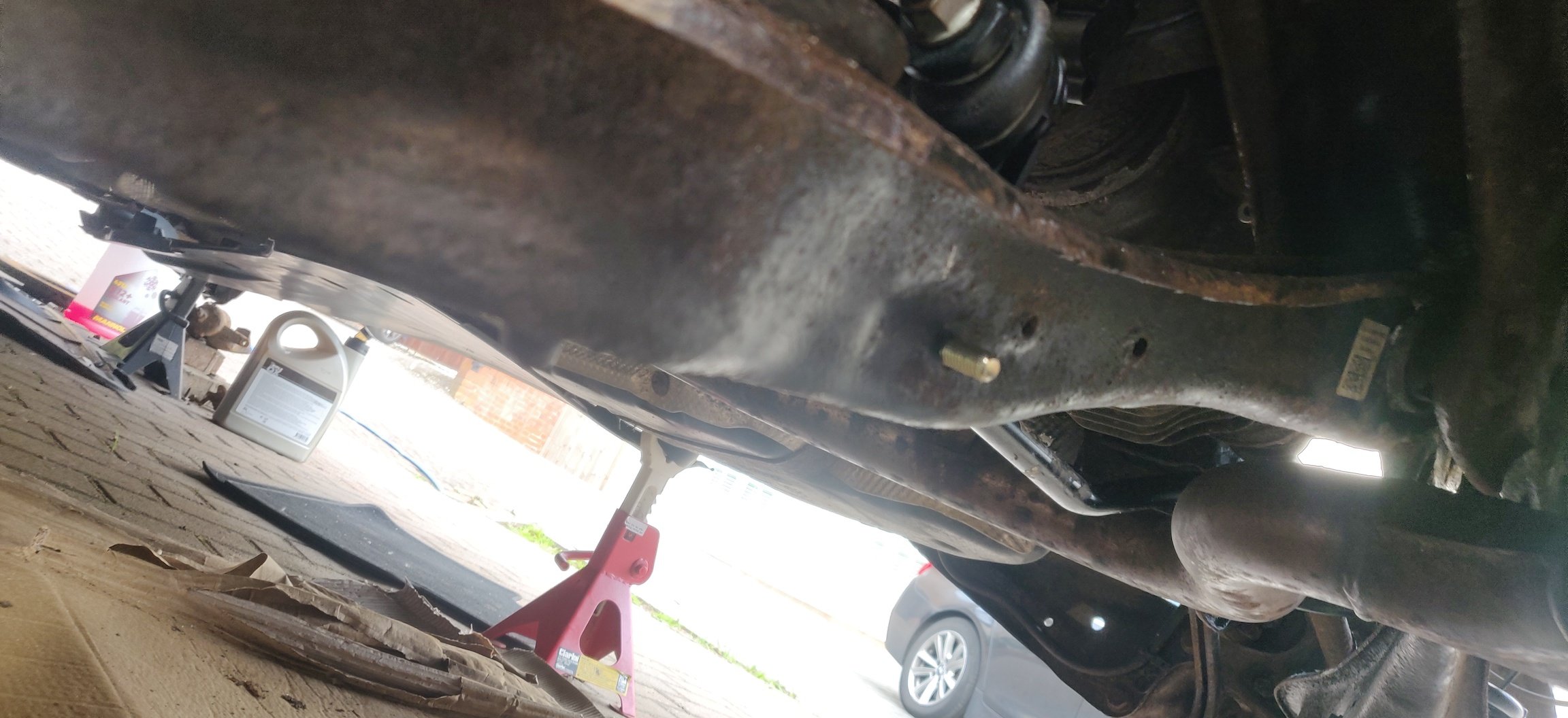

Went to the front, and started to lift the lower arms with the jack:
This then compresses the strut and eventually lets the anti roll bar bolt through:
Slathered some copper grease and started the nut on it. Didn't take long before the bolt to spin with the nut.
So went and raised the other side to attach that bolt:
Once done, the raised anti roll bar had a holding effect on the other side, so just went with the impact wrench to buzz the nut in:
Tried my best to not give it too many ugga duggas, regularly checking with a torque wrench to see if it clicked at 80Nm.
Jacked up the other side to do the same process:
I imagine I've probably overtightened them, but the torque wrench was still tightening them slightly when clicking, so I think it's not insanely so. Not too bothered, new shiny anti roll bar links are eventually needed (if not an entire replacement roll bar, it's looking as manky as the rear one).
That's the big bits for the front suspension done. I'm waiting for some replacement nyloc nuts for the level sensor as they're a bit grotty, but otherwise, once those are done, that's the front suspension complete!
Just need to clean up the Bilstein Damptronic wiring...
Maintenance: £2217.41
Upgrades: £1322.97
Miscellaneous: £684.25
Random stuff:
Got some deionised water from Tesco, £3 for the pair.
More pics of nuts!
Some stainless nylocs, M6, £3.49 from eBay.
Whipped those right onto the level sensors, and tightened to 8Nm:
Then started to sort out the wiring:
The left side was fine, routing made sense, but the right side needed the wire to be forced out of the way a bit lest it will rub on the anti roll bar link. Once tightened the zip tie, cut off the excess. I think the clips that came with the struts can just be replaced with new zip ties when needed.
The clips themselves just push onto the thread:
As mentioned, the left appears to clear the anti roll bar link without issue:
I'll have to keep an eye on these once the car is on the road.
Then started to pop out the coolant tank:
Looks like it's just clipped into place in about three areas without any fasteners. Not sure when the arrival date is for the replacement tank, getting a bit impatient!

Clipped the cowls into the windscreen, put the foams in and the seal. I'll probably need to get some foam tape to get the side foams firmly in place, but that's pretty much that.
Will probably put the wiper arms back on once the washer stuff is checked out. Hopefully I don't have to remove the washer bottle as that'll mean the cowl is off again. Totally jinxed it I reckon.

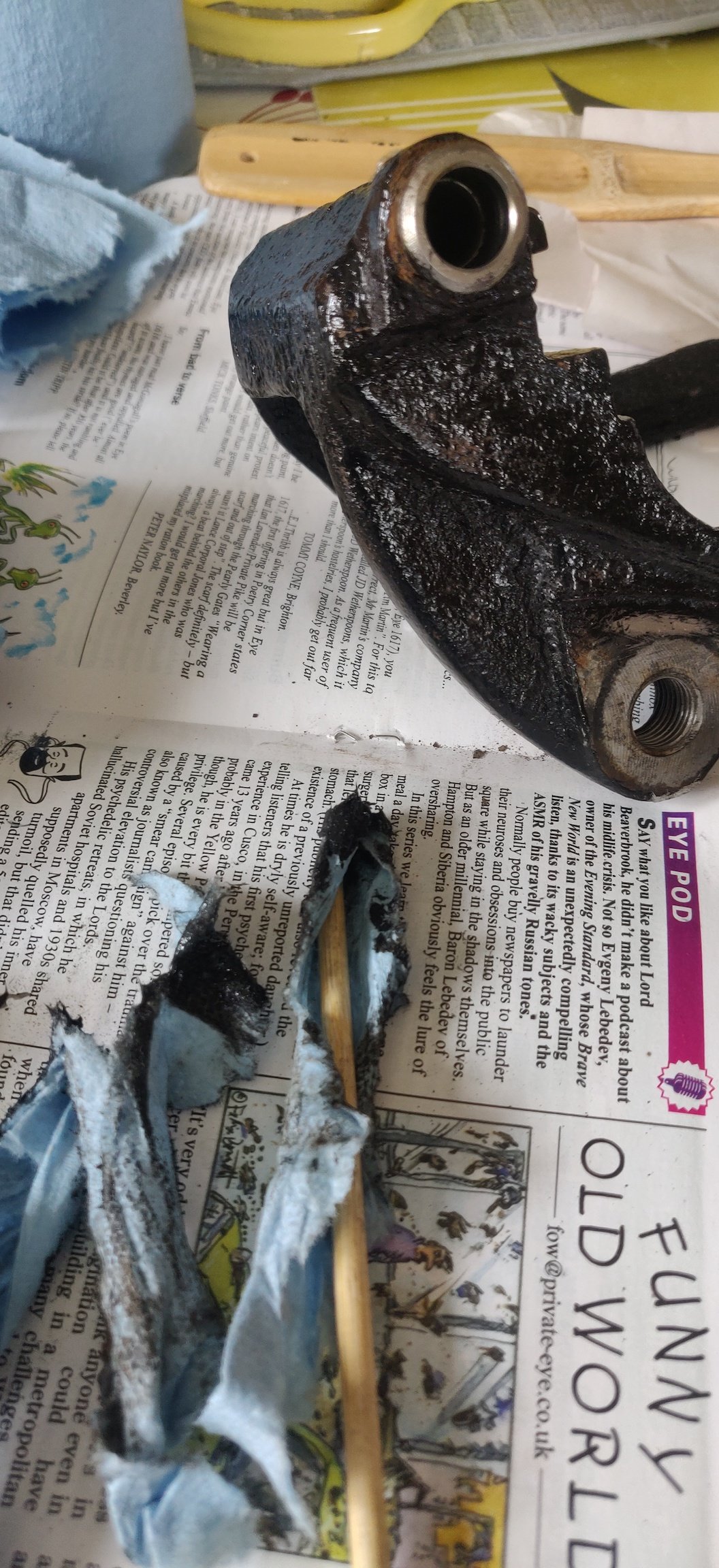

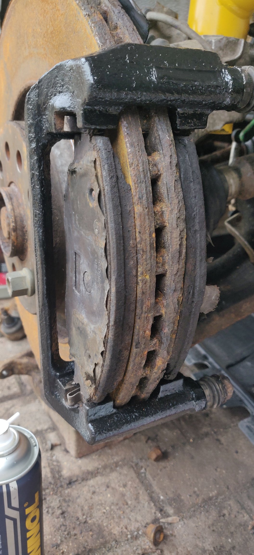

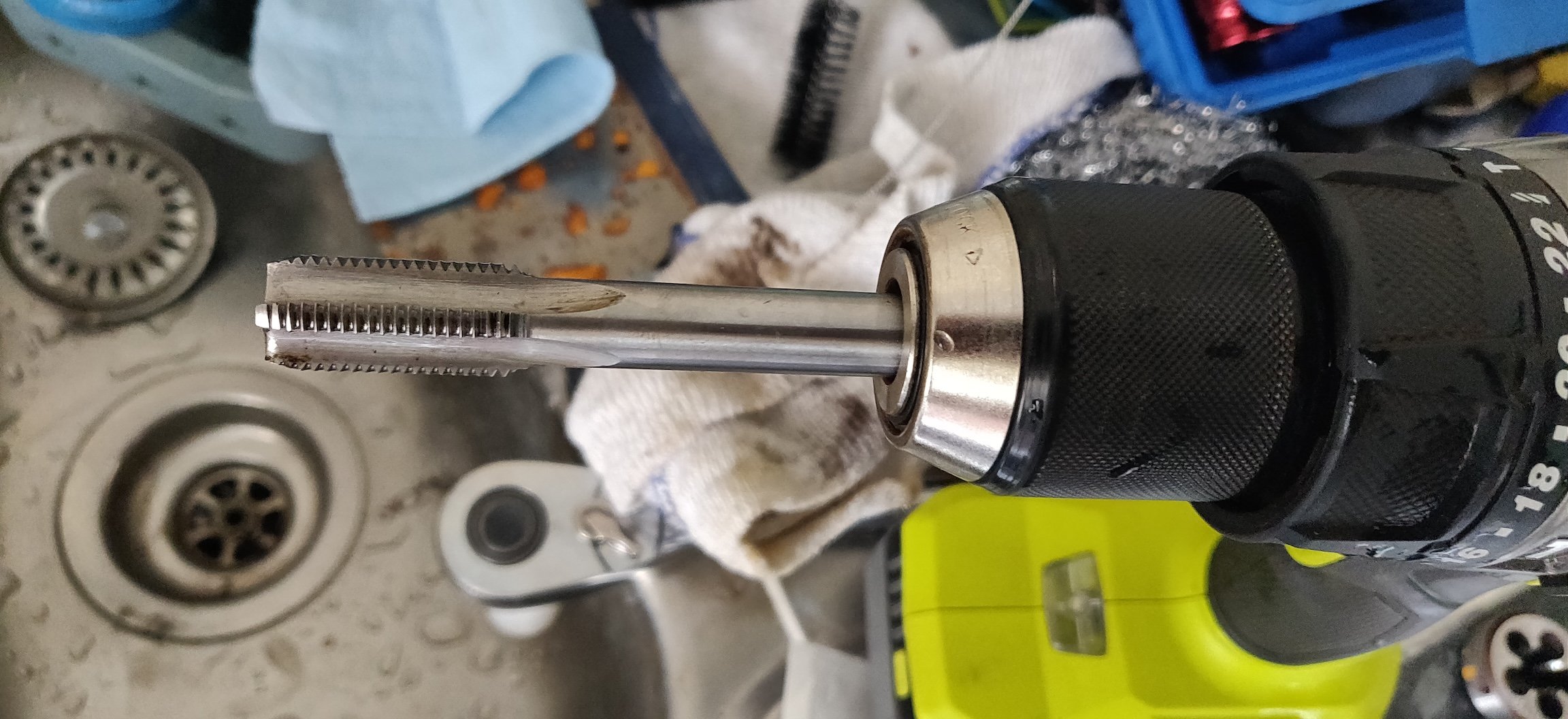

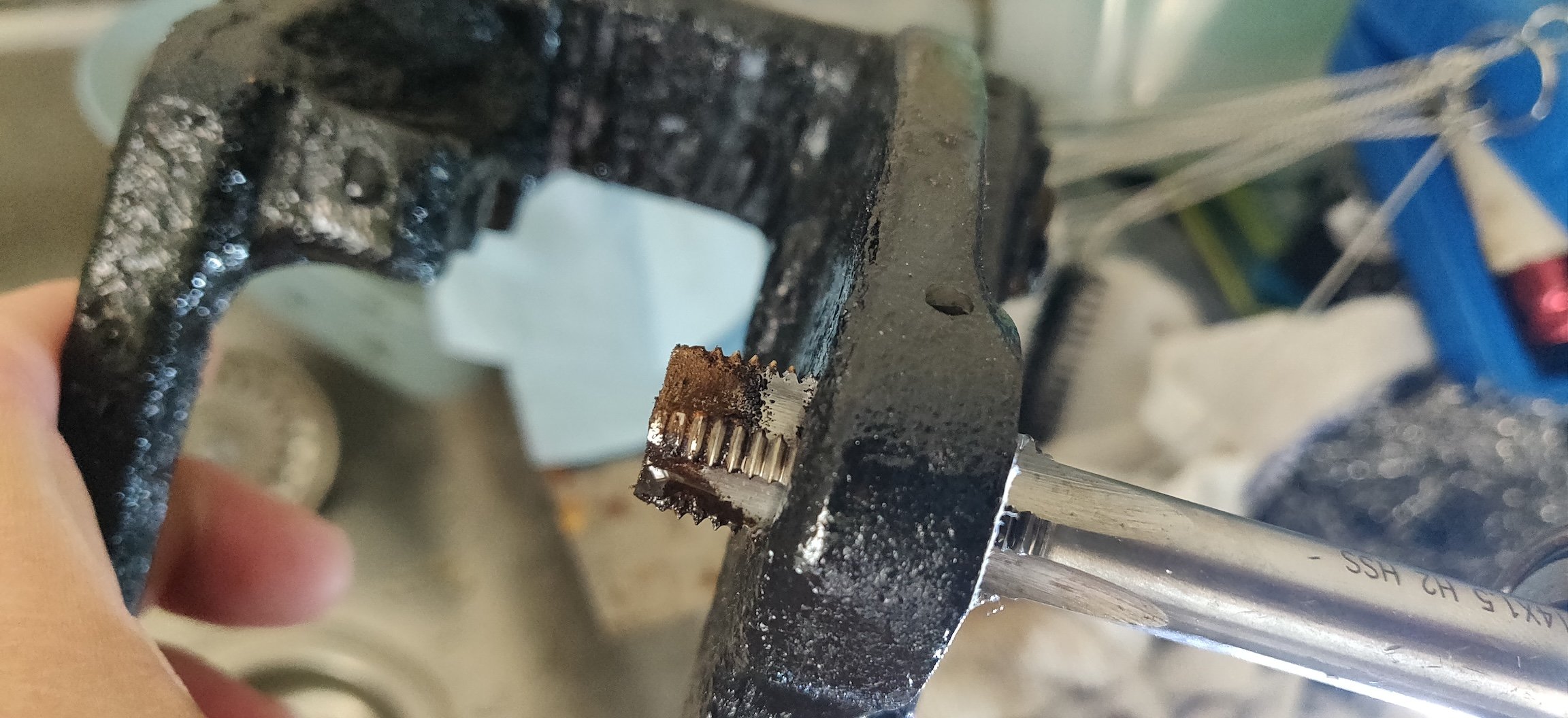

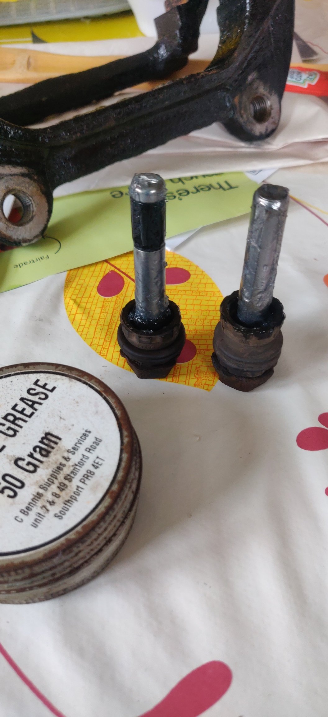

So back in the house, got the tap and put a drill onto it:
Then with some oil, gave the threads in the brake pad carriers a pass through:
Will go through the wheel bearings with the same step to clean them all up. Hopefully will make assembly nice and trouble free.

Some M5 washers to go with the stainless replacement screws for the wheel arches. £2.88 for 50 from eBay.
Also some brake hose clamps:
The ones I removed from the front brake bracket have decided to go missing, either that or they're still under the mass of removed and destroyed nuts and bolts. These were £3.23 for four.

A bottle of rust remover. This is pretty much by the look and smell of it generic Phosphoric Acid, mainly because if the weekend is just rain, I'll be inside. This was £9.95 from Amazon.
So lo and behold:
I stick half of the wheel bolts and brake pad carrier bolts into a tray:
Then poured out the Rust Remover. This is into a small ultrasonic cleaner I bought years ago, which every now and then makes itself useful.
Once the tray was put into the cleaner:
The Rust Removed immediately went to work. These bolts were all put through the die with oil, so I suspect the resulting mess will be dirt, rust and oil amongst the Rust Remover.
Turned the cleaner on for a 8 minute job:
Then it basically bubbles away. Once done:
Gave them a quick rinse to assess, and it's getting there. Put them through another 8 minute run:
Probably as good as I'm gonna get it without seriously going mad. Be easier to source new bolts rather than carry on.
So got the slider bolts for the pad carrier and gave them a good wipe clean:
Then cleaned out where they go in the pad carrier, previously the grease in there was black, couldn't tell if it was dirty:
Gave the sliders a coat of new grease:
Then in they pop:
So with a dry spell outside:
Popped the brake discs back on and kept in place with a couple of the wheel bolts. I'll deal with the brake retaining screw in the future by simply replacing the wheel bearings if the car gets there.
The wheel bearing threads were cleaned out earlier, so the bolts went in like new.
Dry fitted the pad carriers with the cleaned bolts:
Easier then at this stage to turn the wheel in the car to get a better angle to them:

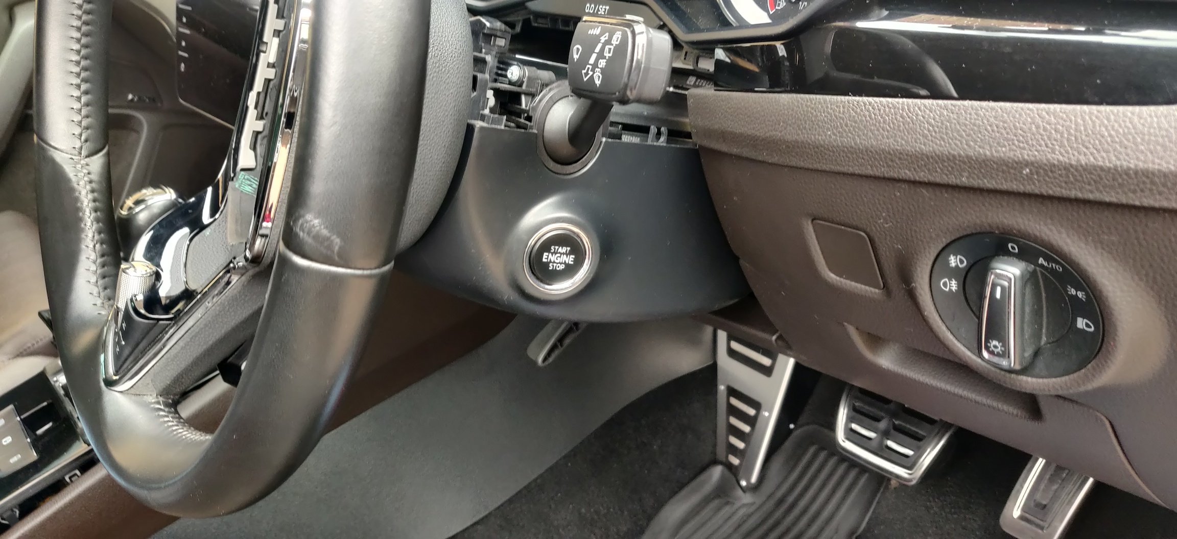

So took the opportunity to procrastinate and reassemble the bottom steering column trim whilst the wheel was going to be at angles (as the T25 bolts can only be accessed with the wheel at right angles).
So it ends up looking like so:
Then it was a case of taking out the bolts one by one and going mad with the Alumslip:
Then getting them back onto the pad carrier and hub:
With the hub turned there's enough clearance for the big torque wrench:
So got the bolts to the 200Nm as specced.
Same deal for the other side:
Then dry fitted the brake pads:
Looks like the right side inner pad is missing its little tab thing, but I don't think that's the end of the world, that'd be more for keeping the pads from banging I believe.
The inner pad is also not moving on the carrier so freely, so will need to get some further cleaning on that part of the pad carrier. Probably should have done that all whilst it was off the car, but I guess I'm getting ahead of myself.
Rain got just a bit annoying at this point (not heavy, but enough to be a nuisance), so took a break.

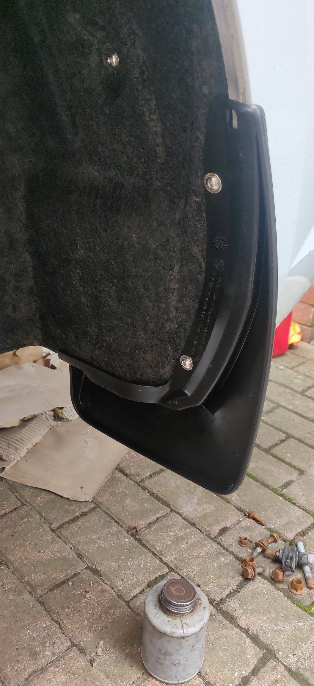

Between bits of rain, also managed to get those washers involved:
So got the rear mudflaps in after fixing the rest of the wheel arch on. Partly followed this excellent guide:
 In addition to just using whatever was there. The wheel arch needed one of the new clips in place which does need a bit of alignment whilst looking straight up, so a bit of a faff with the wet weather:
Just about seen on the inboard side of the liner.
Repeat for the other side:
The rears have a hook which kinda needs a bit of convincing to slot into the rear bumper, but other than that, pretty straightforward.
Also fitted the other bits of trim on the other side. I think the part catalogues call them "spoilers":
Again, used the three screw holes that I could see (one is underneath), there are two other holes, maybe to attach to the wheel liner, but can't tell at the moment.
That could well be it for the weekend if the weather keeps misbehaving. TIme to get car insurance quotes as it looks like mid to end of May is a possible target.

Overnight was heavy rain, into the morning, so bit of a write off. The weather got a little clearer in the afternoon so tried to get some quicker simpler things done.
Went over the brake pads, where they contact and slide along the carrier, with the same flap wheel I used for said carriers:

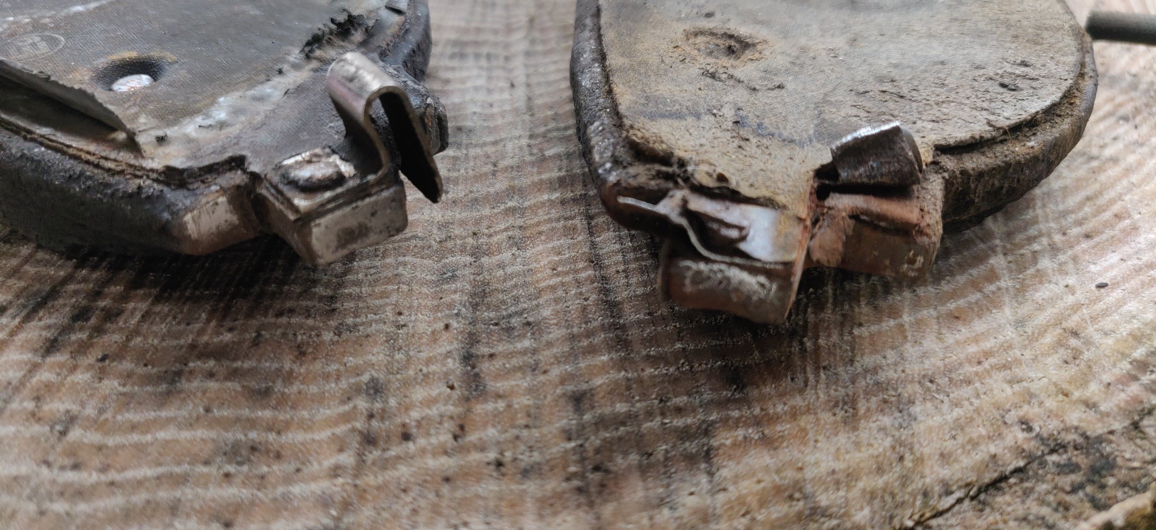

Only one pad seems to have its original stainless spring clips fully intact:
One has one completely snapped, and 3 have a metal bit on the other side snapped off, so just went at them with the flap wheel to get them as clean as possible. Not too fussed as eventually these will be all be renewed over the next few years.
Interesting that these cars have them physically riveted onto the brake pads, they're usually bits that clip into the carrier, or sometimes nothing at all. I presume its a small bit of stainless to reduce rust being a factor in gumming them up.
Anyways, copper greased the contact areas on the carrier and slid them in:
It's better than it was the first time they were dry fitted, but still not super smooth all round, some were fine, other's a bit stiffer. I'll keep an eye on them over the first few months on the road.
The bolts for the caliper to the carrier had some blue threadlocker on them, so reapplied some fresh stuff:

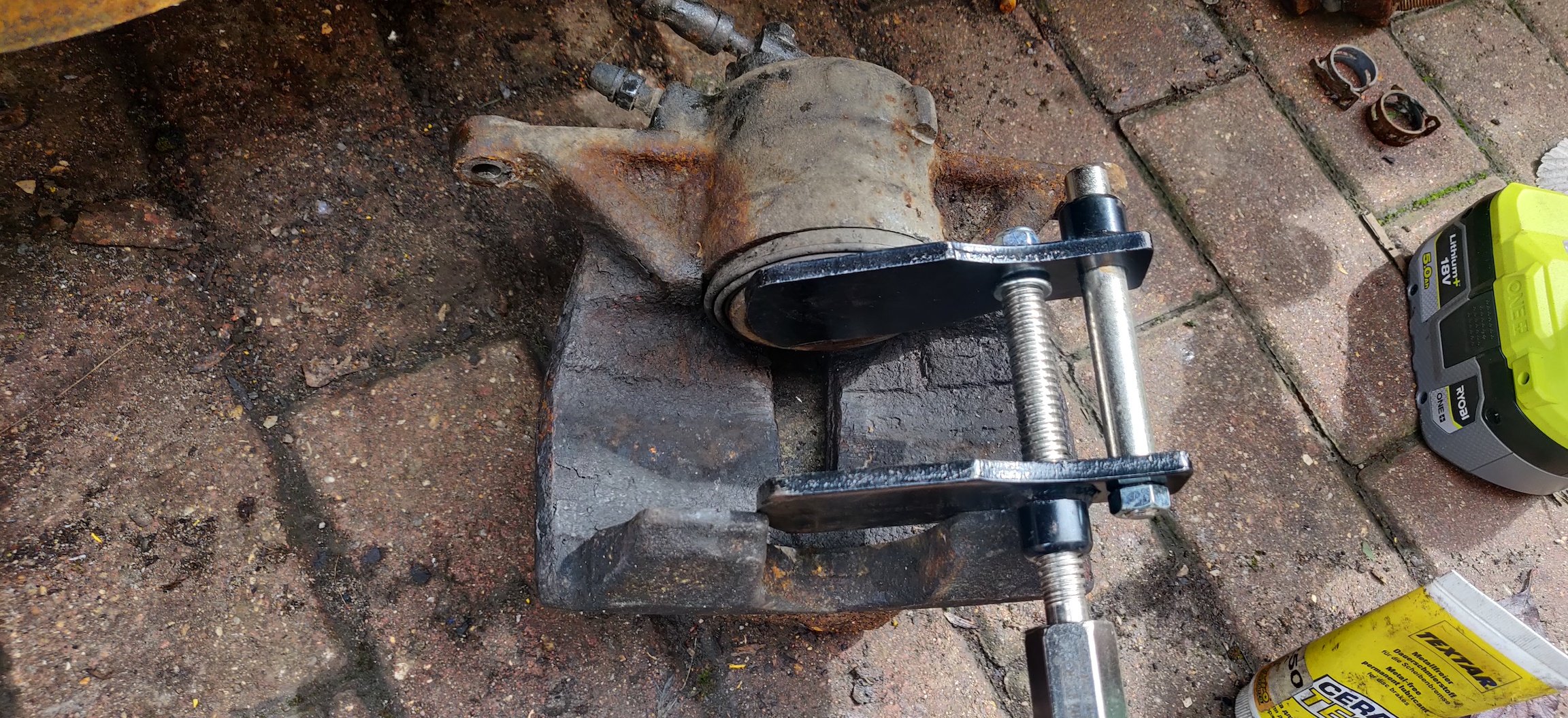

Then went and retracted the calipers:
This is mainly to make it a lot easier to put them back on, and to gauge whether these calipers are going to be trouble in the medium term. They retracted in fine.
Got some anti squeal paste and put it on the piston, and the backs of the pads where it'll touch the piston on the inside and the caliper on the outside, then put it in place:
It was a 13mm socket for the bolt, and a 17mm spanner on the slider pin to counter hold it. These were tightened to 35Nm.
So simply a case of doing the same on the other side:
Definitely easier to do with the steering turned appropriately as per the pics above. Again, the pads were sliding better, just stiff on a couple of them.
Used the flap wheel to clean the caliper piston face:
Although it's really hard to tell given it's still manky. They all eventually look like this I suppose.
But as per the other side, attached and tightened to 35Nm:
I'll need to get those brake hose clamps tapped into the brackets for the hoses, but otherwise, that's it.
The calipers were sliding horizontally without issue, easy to check with them retracted and the pads looking like halfway through their life.
Went into the car and gently pressed the brake pedal a few times to get those pistons out and ready.
The pic above shows the wheel bolts already rusting from the rain, so I'll probably need to clean those up again, then spray some of that XCP stuff on them once the wheels are on.
Didn't want to risk getting caught out by the rain, so packed up for the day.
