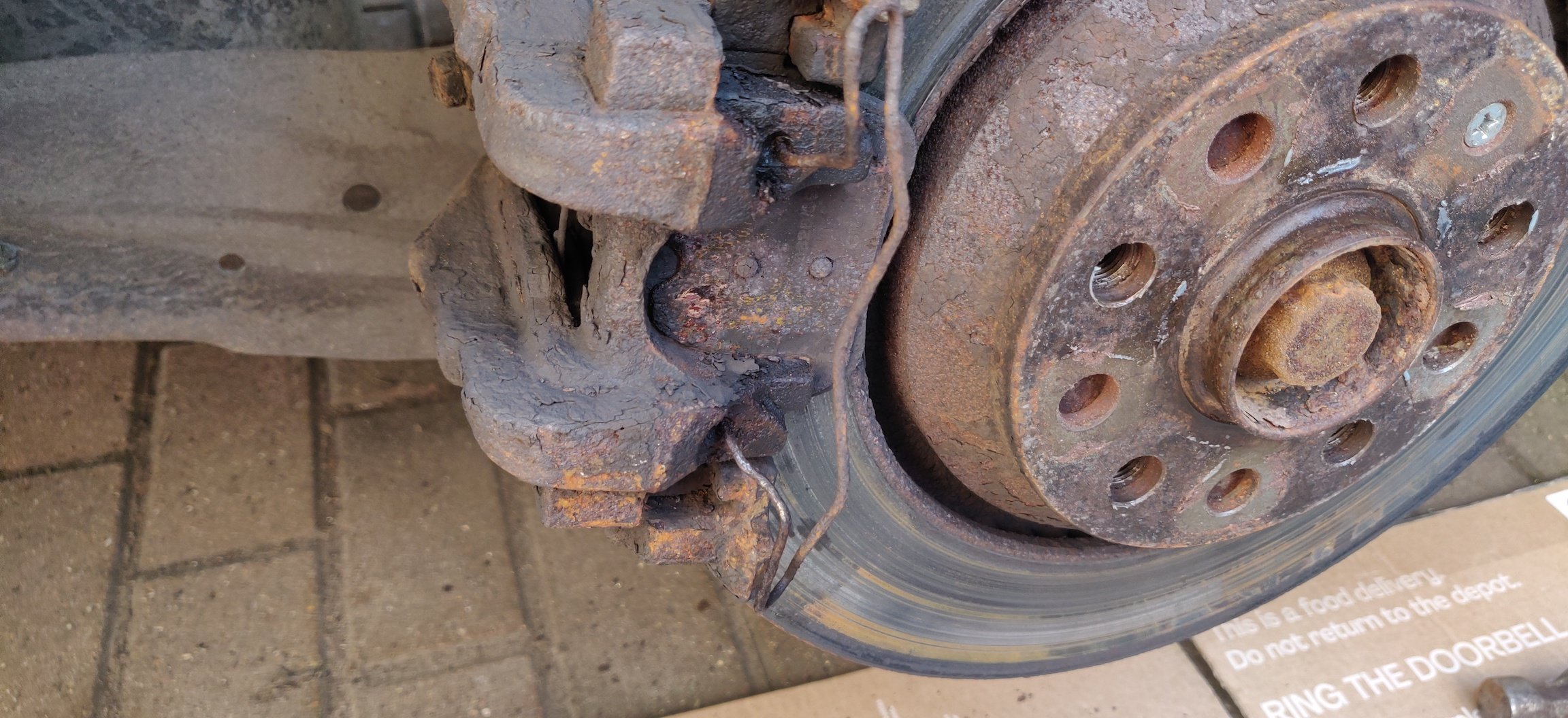

After jacking the car up and removing the wheel, the first step involves removing the retaining clip holding the outer pads:
So of course, something I've never seen before happens, where the clip is seized into the caliper:
Thus snaps off leaving some remains in the caliper after attempts to persuade it out with pry bars and pliers and whatnot.
This was probably the sign to stop and just leave it. Tackle them a bit later.

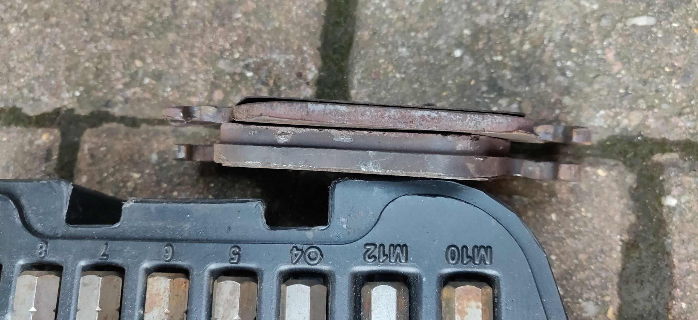

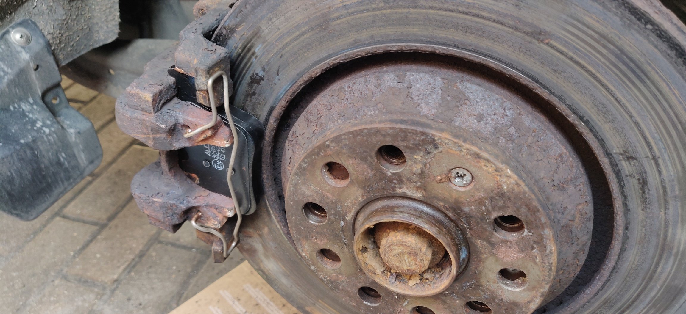

For now, just remove the slide pins (a 7mm hex behind the plastic covers), then a pry bar and light hammner taps to free the caliper. Set the caliper aside hanging off the suspension arm, then removed pads:
Or rather, what remains of it. I suppose there's about 0.5mm of friction material left, so no big surprise that the caliper was probably at its end and years of crud keeping things stuck.

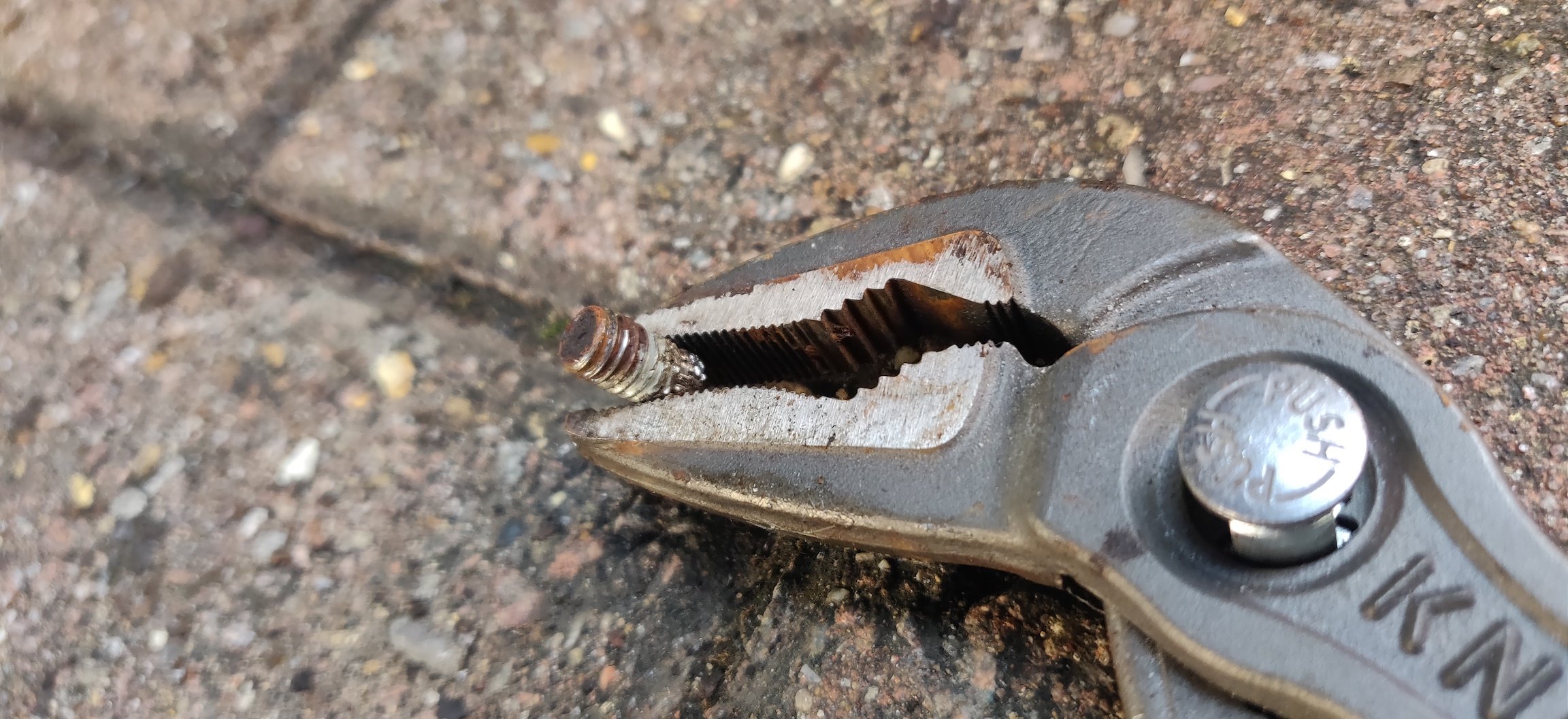

At this stage I put the caliper back on with the pins, to try and tackle the remains of the clips in the caliper.

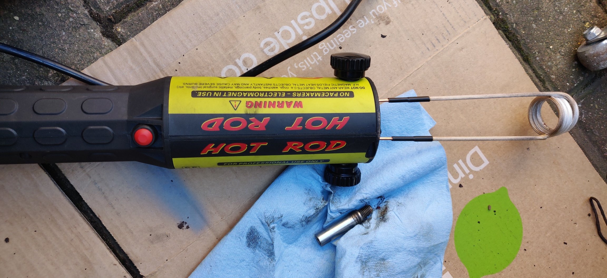

Wife was in China a few weeks back, and I asked her very nicely to procure me one of these:

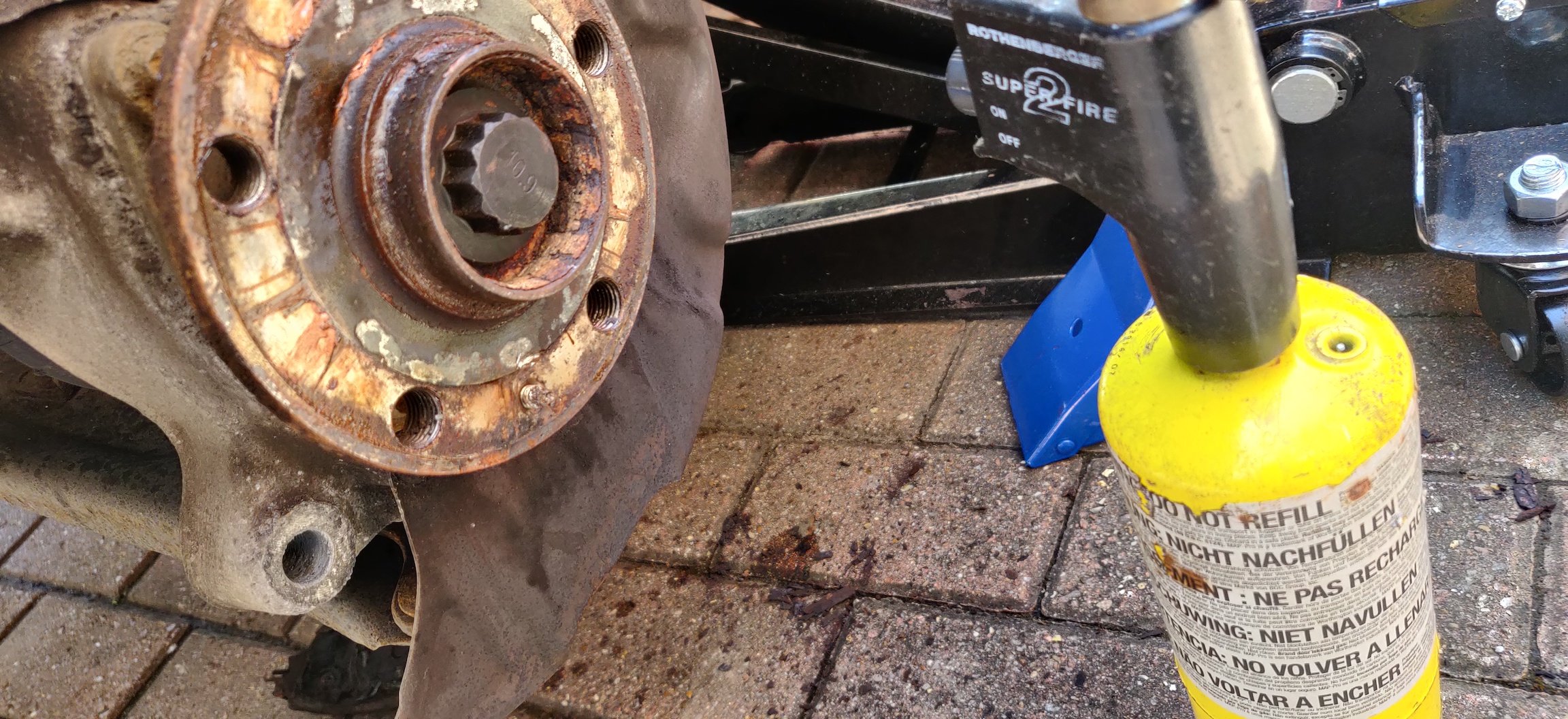

It's essentially some funky induction heater which allows a concentrated heat to be applied to whatever is within the coils. The particular coil attachment was large enough to slide on the end of the caliper, where the clip remains are.
So got them glowing red, then some plus gas, then some Knipex pliers on the remains with some twisting, swearing and praying.
The top came free, but the bottom needed some additional convicing with a hammer and chisel, and then eventually just went at it with a drill:

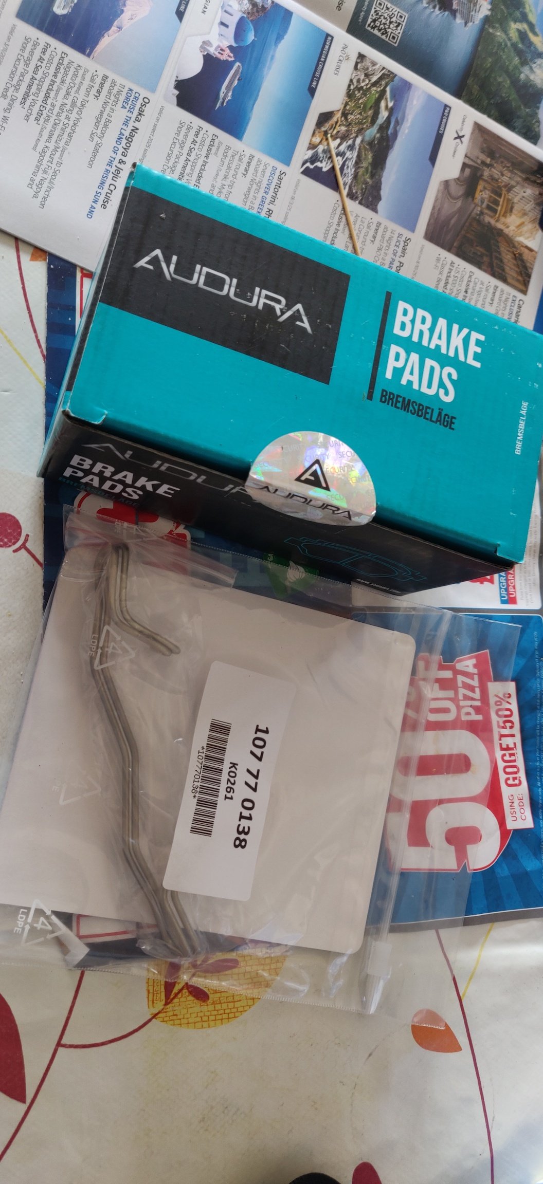

It being a Sunday, the only local source for car bits I was aware of was Euro Car Parts, which fortunately had a cheap enough set of pads plus the retaining clips, so spent the 25 minutes drive there and back to get them:
Did not want any fancy pads for reasons I will explain in a later post!
Parts came to £27.58, I guess via eBay might have squeezed a fiver saving, but wanted to get this done today.

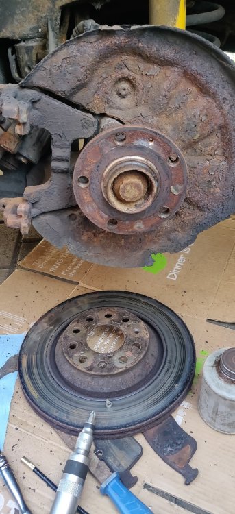

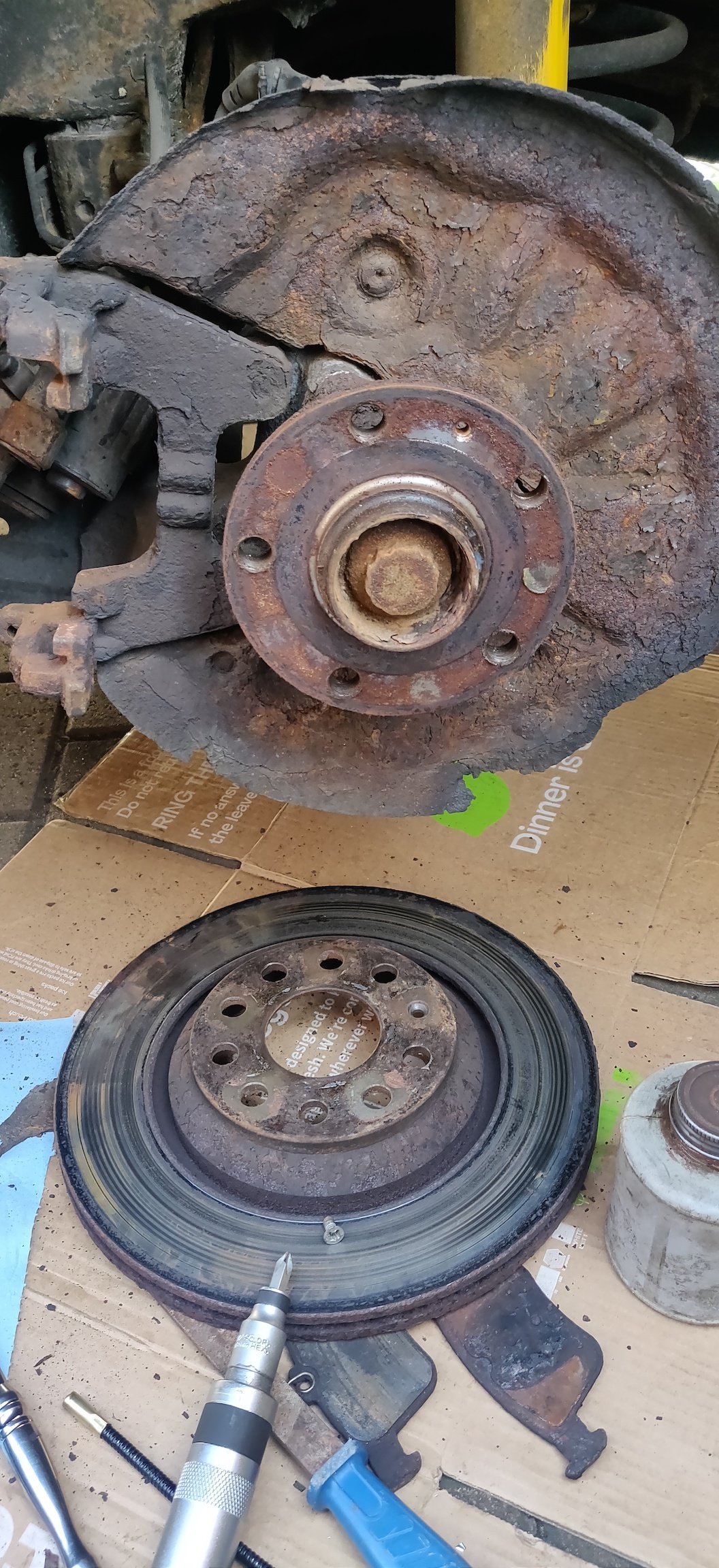

So decided to attempt to tackle removal of the brake disc:
Which amusingly decided to not be anywhere near the drama I anticipated. I have an impact driver tool from Halfords from years ago which was specifically for those retaining screws for the brake disc.
The rear left had a cross head, so firstly, got some fire on the screw for about 30 seconds, then hammered at it with the impact driver. A relief once I saw the screw rotate slightly.
The brake disc itself can be wiggled to free it from the pad carrier, which is a huge relief.
This allowed for easy access to the carrier to continue filing away the years of crud.

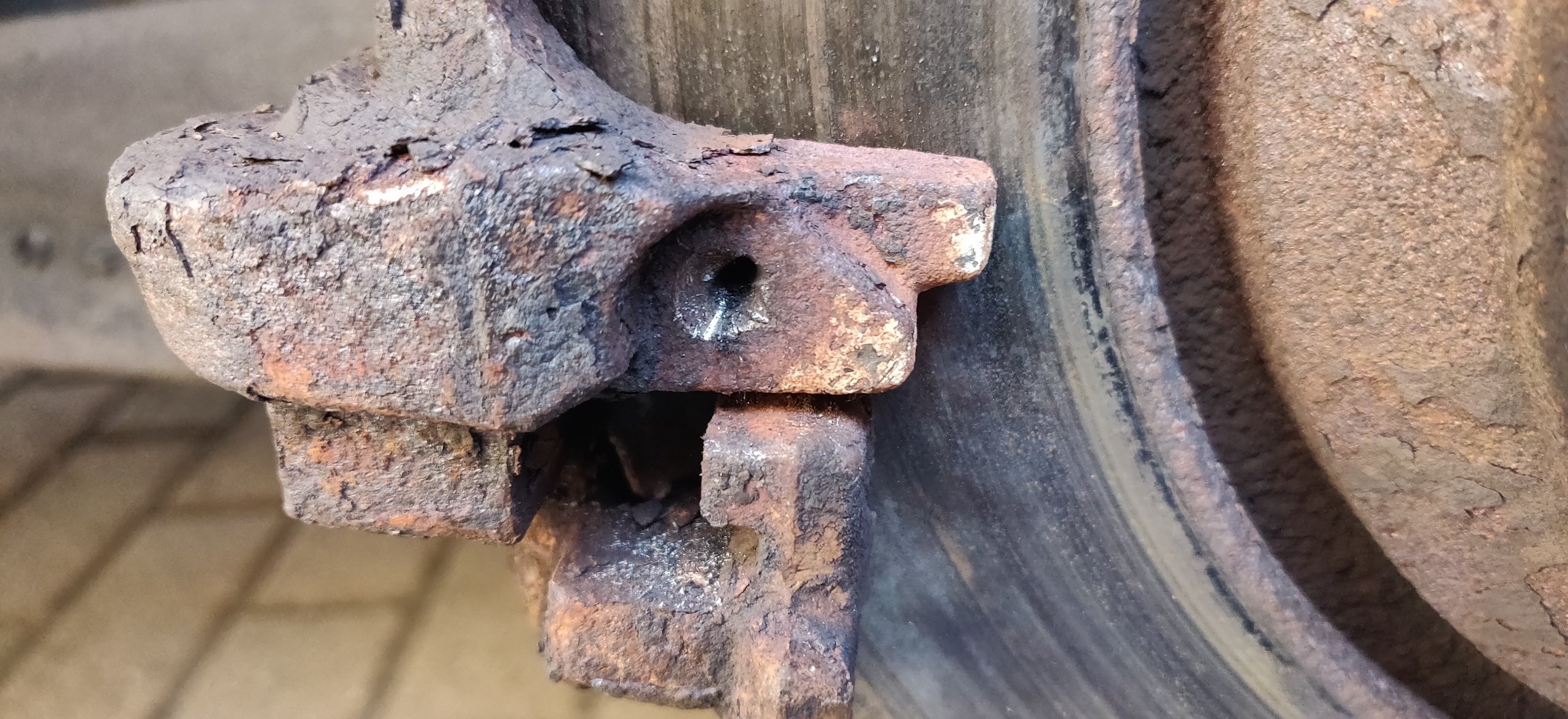

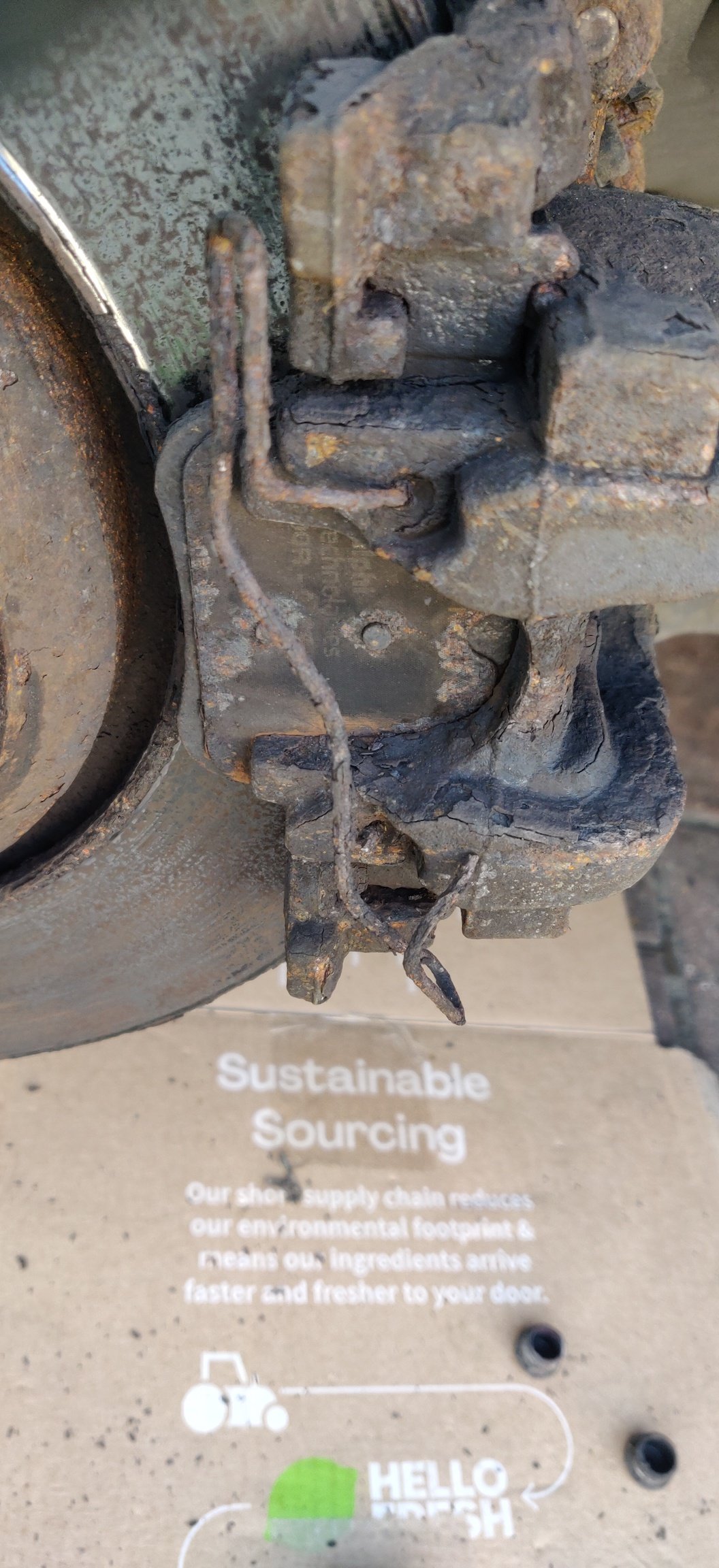

So of course, the clip on this side suffers the same seizing as the other.
Unfortunately, whilst the top seized part was removed without drama, the bottom was resolute, and this time, bits came off the remains in such a way that there was no more leverage.
Attempted at this point to drill out the remains, which basically left 3 drill bits in pieces.
Fuming, I decided to just carry on with the pad replacement:
So there's the new pads and the shot of the bottom supposed hole where the clip would go. Genuinely amazing.

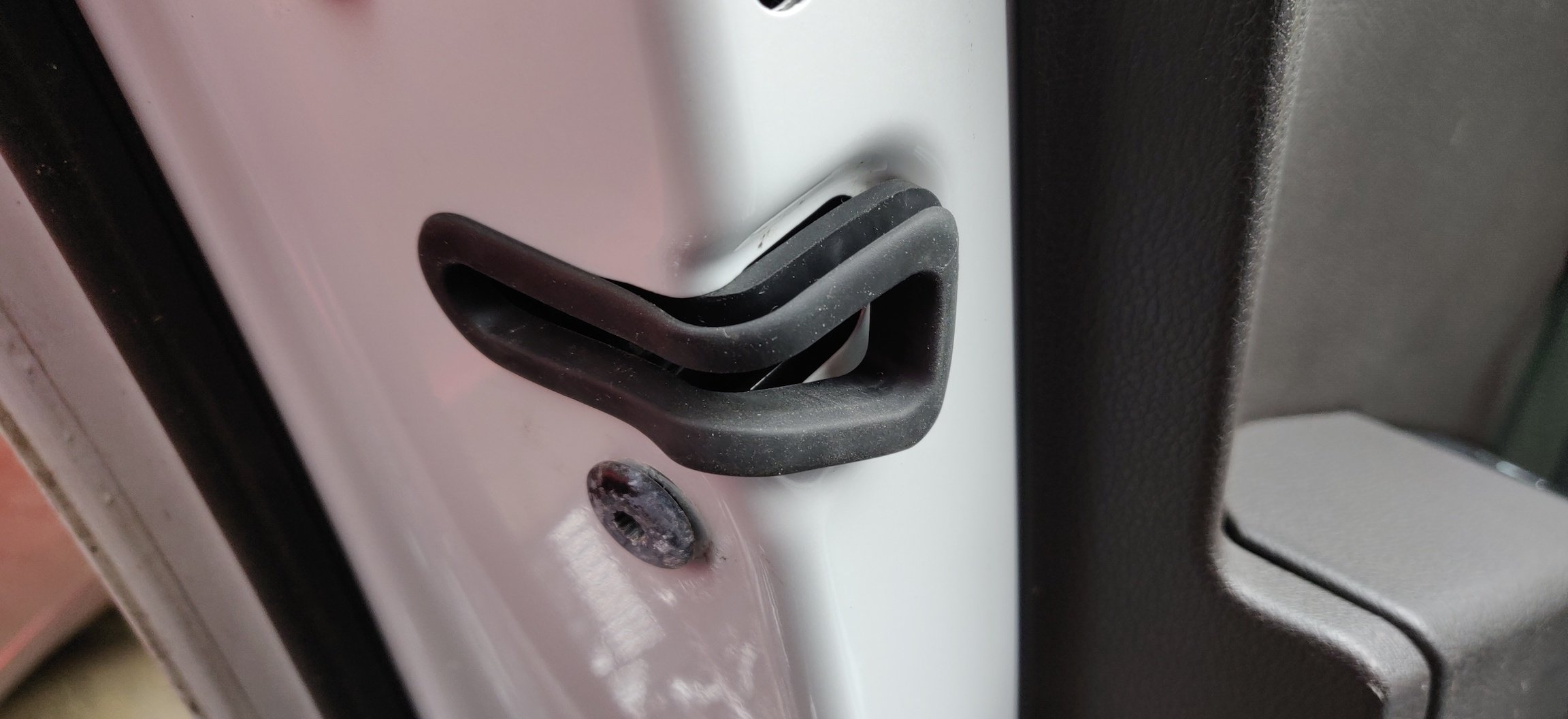

Got an aftermarket one as seen above. I figure a genuine one about £50 or this one for £9.59 from eBay, so buy cheap, buy 5 times sort of situation.

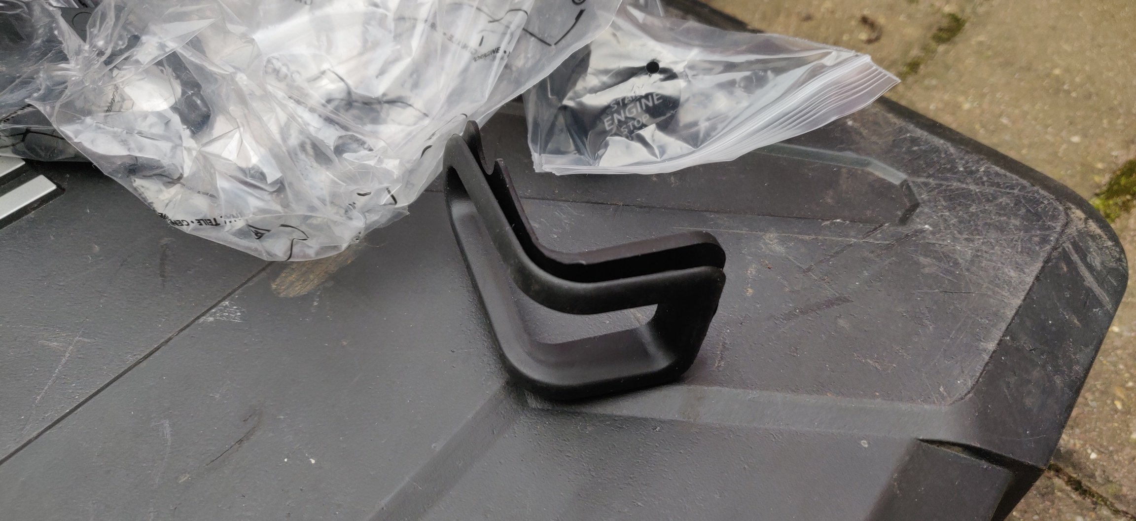

Also, something that's been on the back burner. I think @MartinB might be to blame, random rubber bits that go in the door latches!
I got these at the same time as some other bits for the future, and were £5.66 for 4, I'll tally shipping in the future.

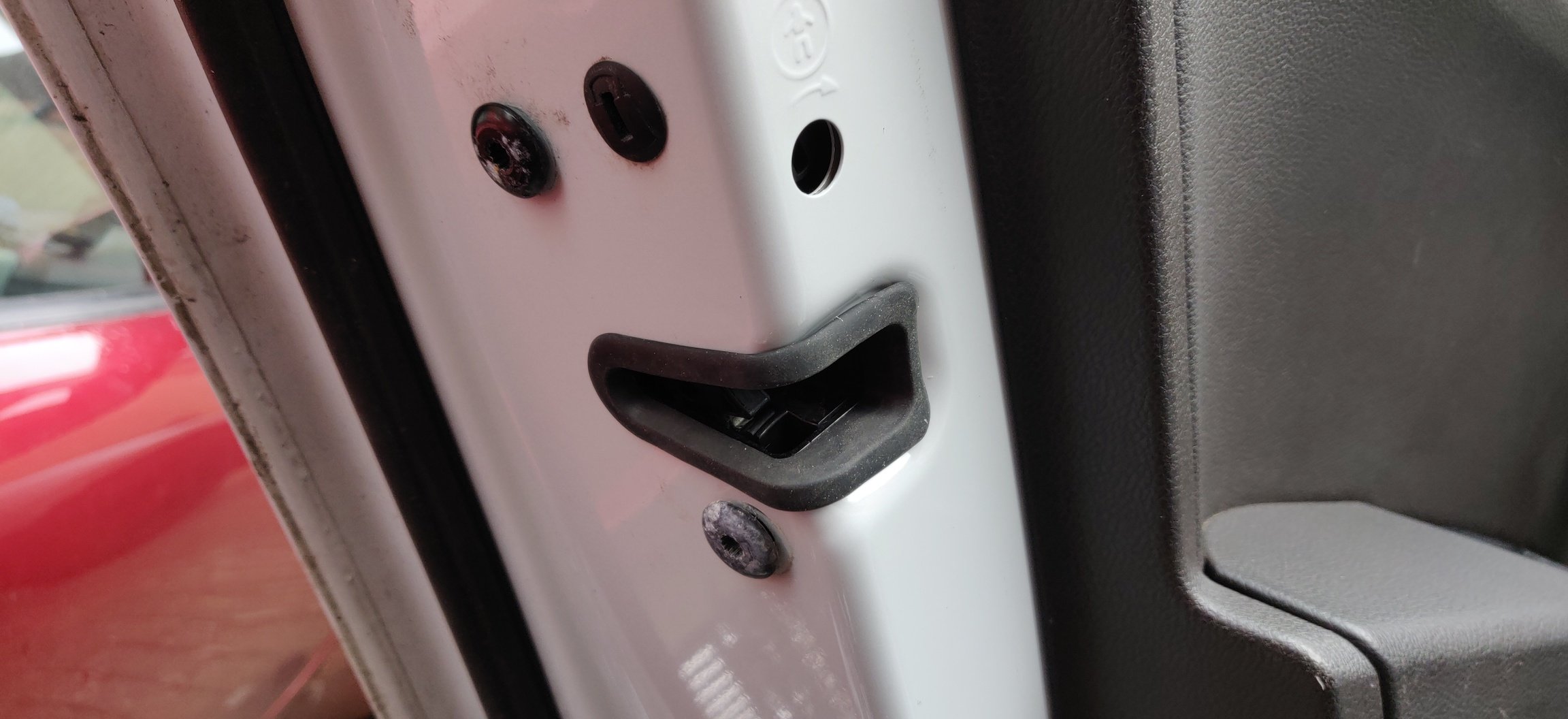

They didn't go straight in, as the rubber bits are a little thick on one side, so went to loosen the bolts holding the latches to the door frame:

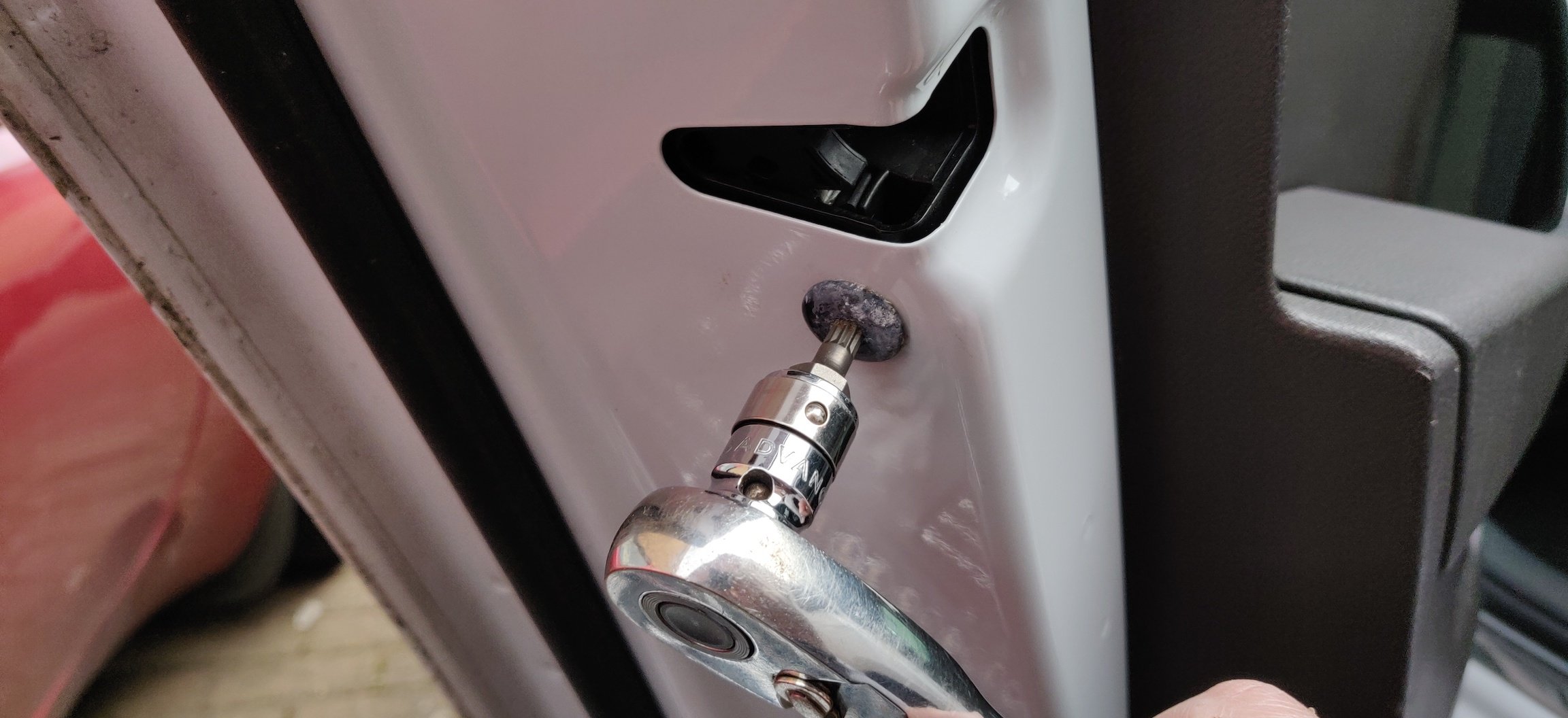

It's one of those weird bolts, which I think is called a spline? My Halfords tools had one and I think M6 was the one needed.
Once loosened a few turns the latches can be wiggled about a tiny bit, just enough to force these things in:
Just a bit of persistence really, but they get in. Then retightened the bolts to 18Nm. The workshop manual mentioned 20Nm on certain pages to add to the confusion, but most references were 18Nm.

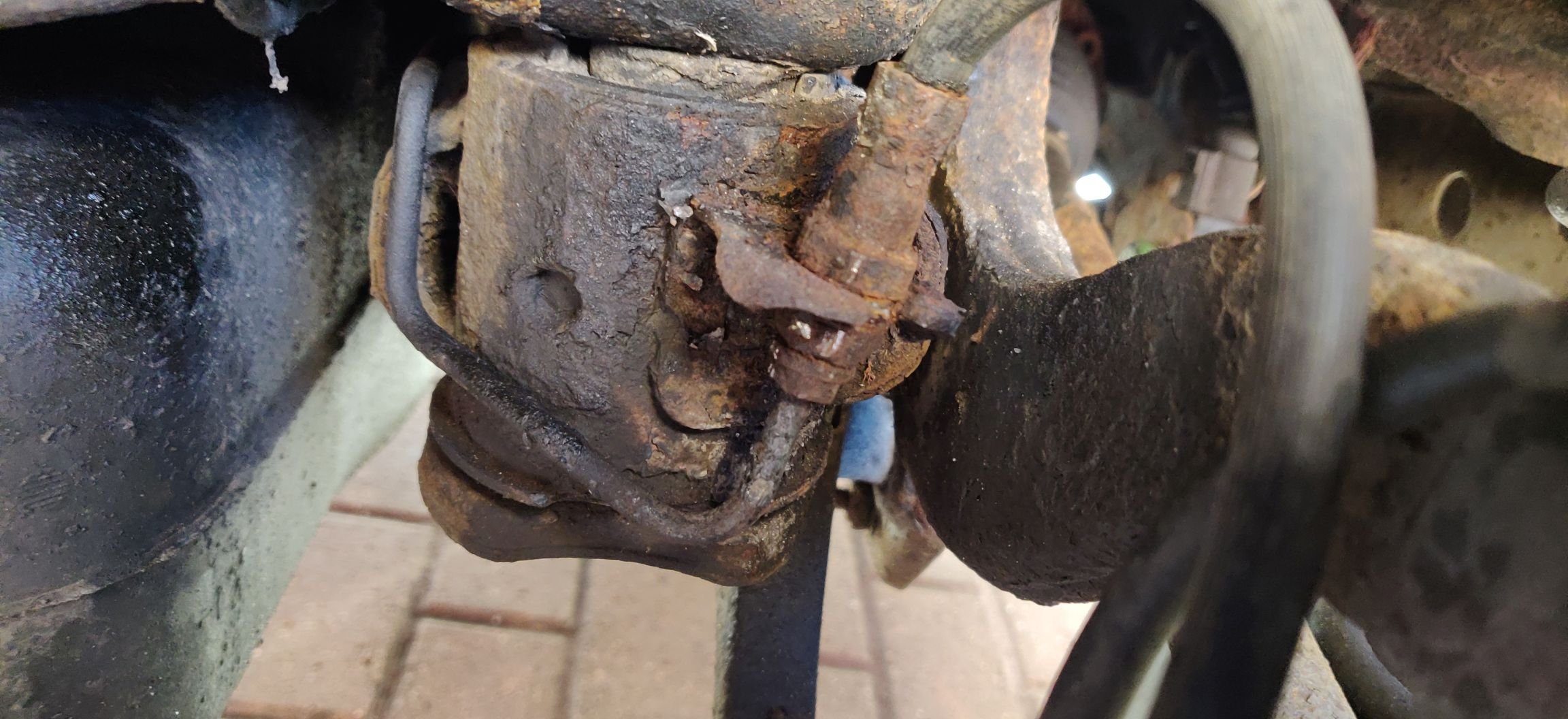

So given the last post was a while, and I believe 9 March when I replaced the rear pads, I've been forced to add an update, luck not on my side.
The hope was that changing the rear pads would be enough, but the rear left caliper unfortunately looks like it was still sticking.

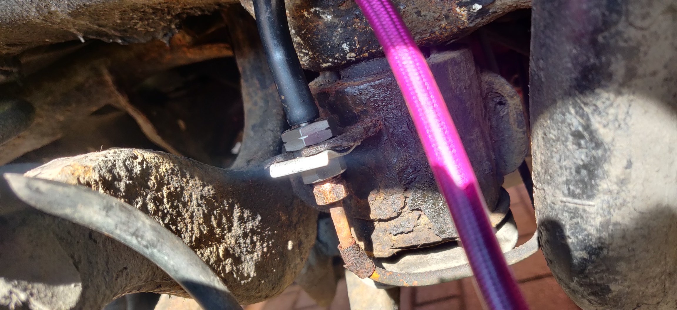

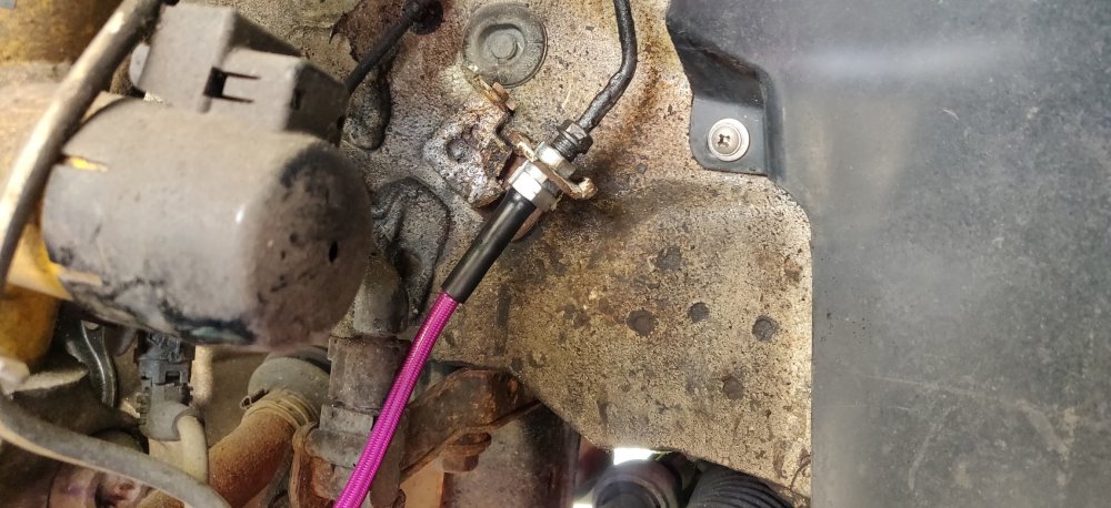

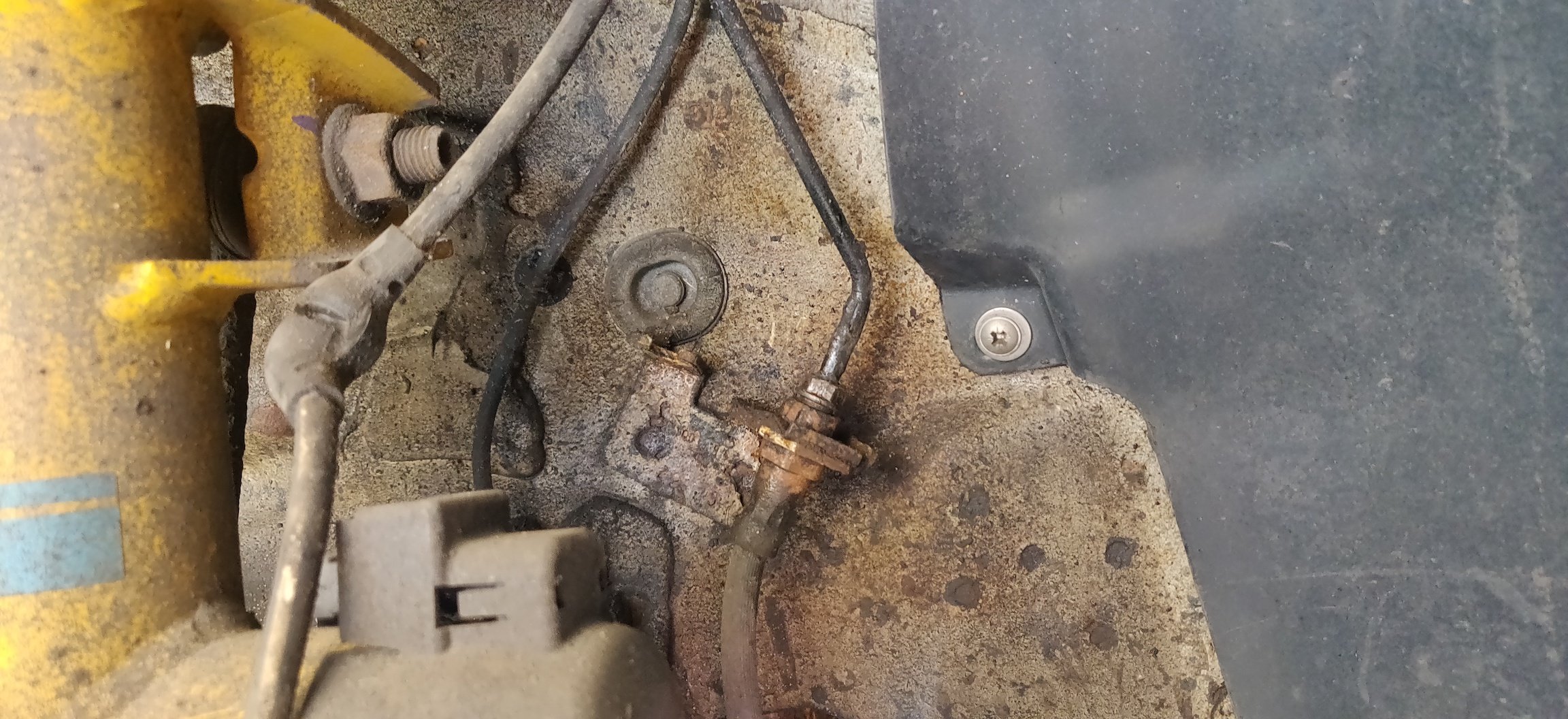

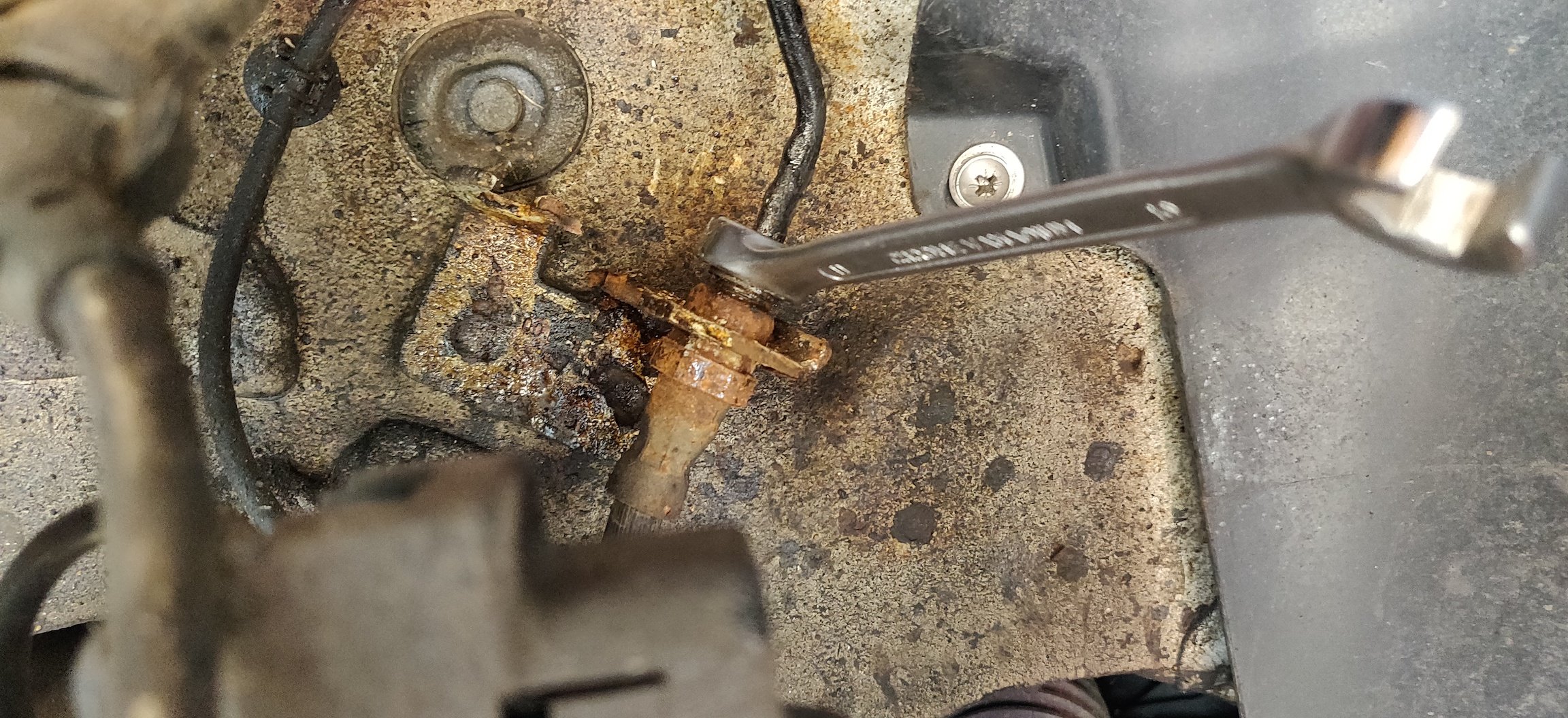

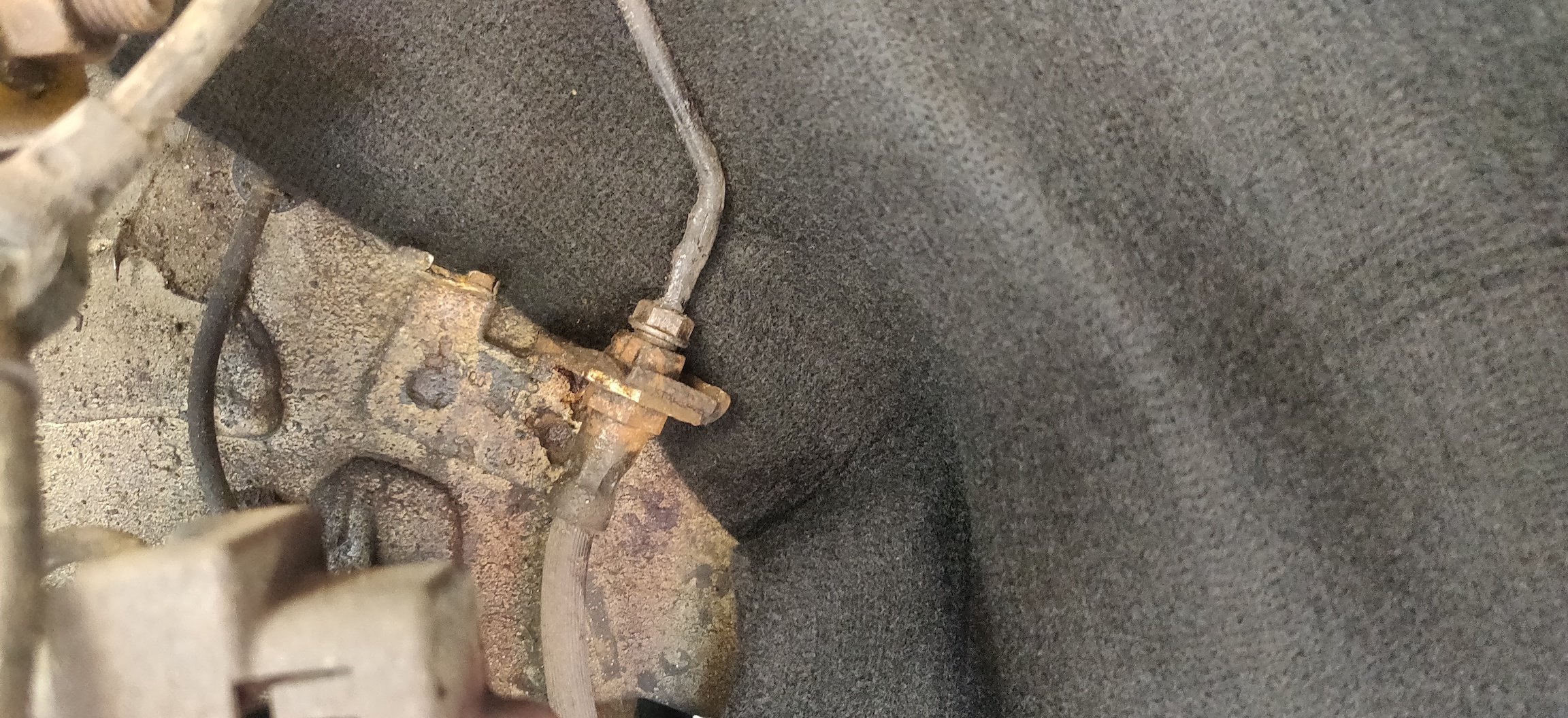

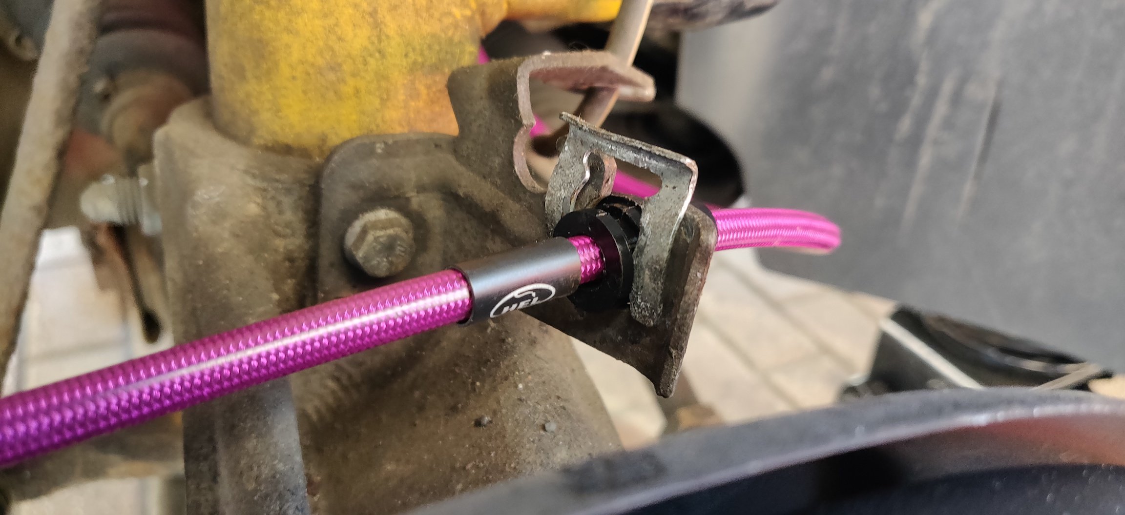

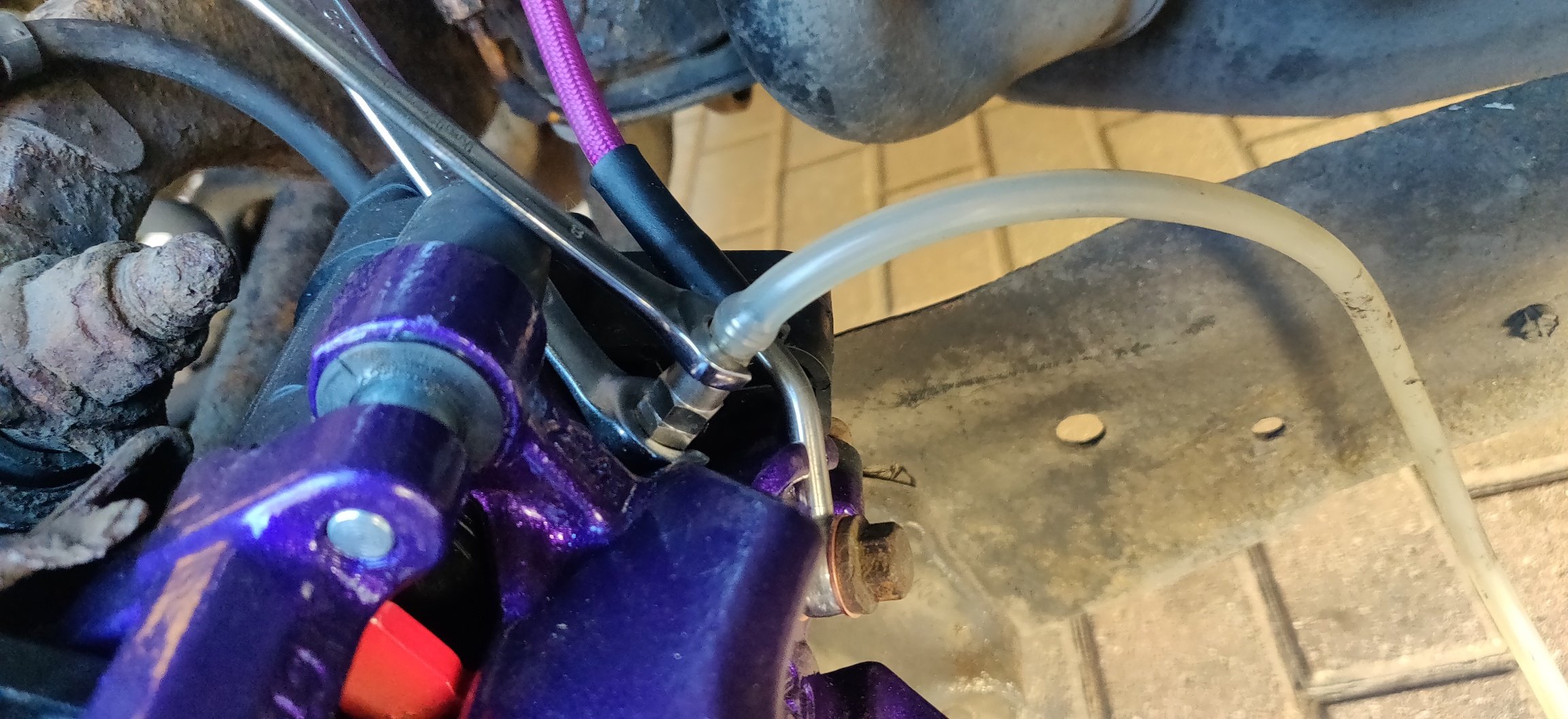

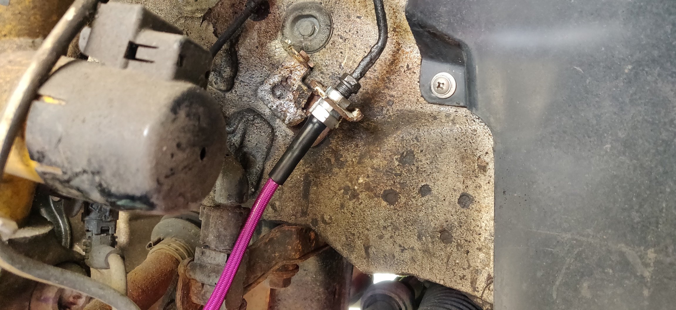

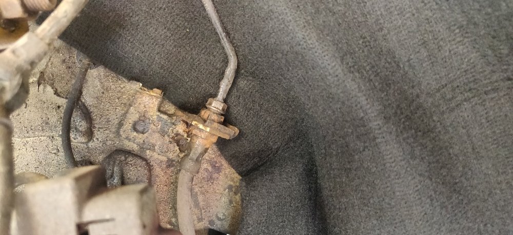

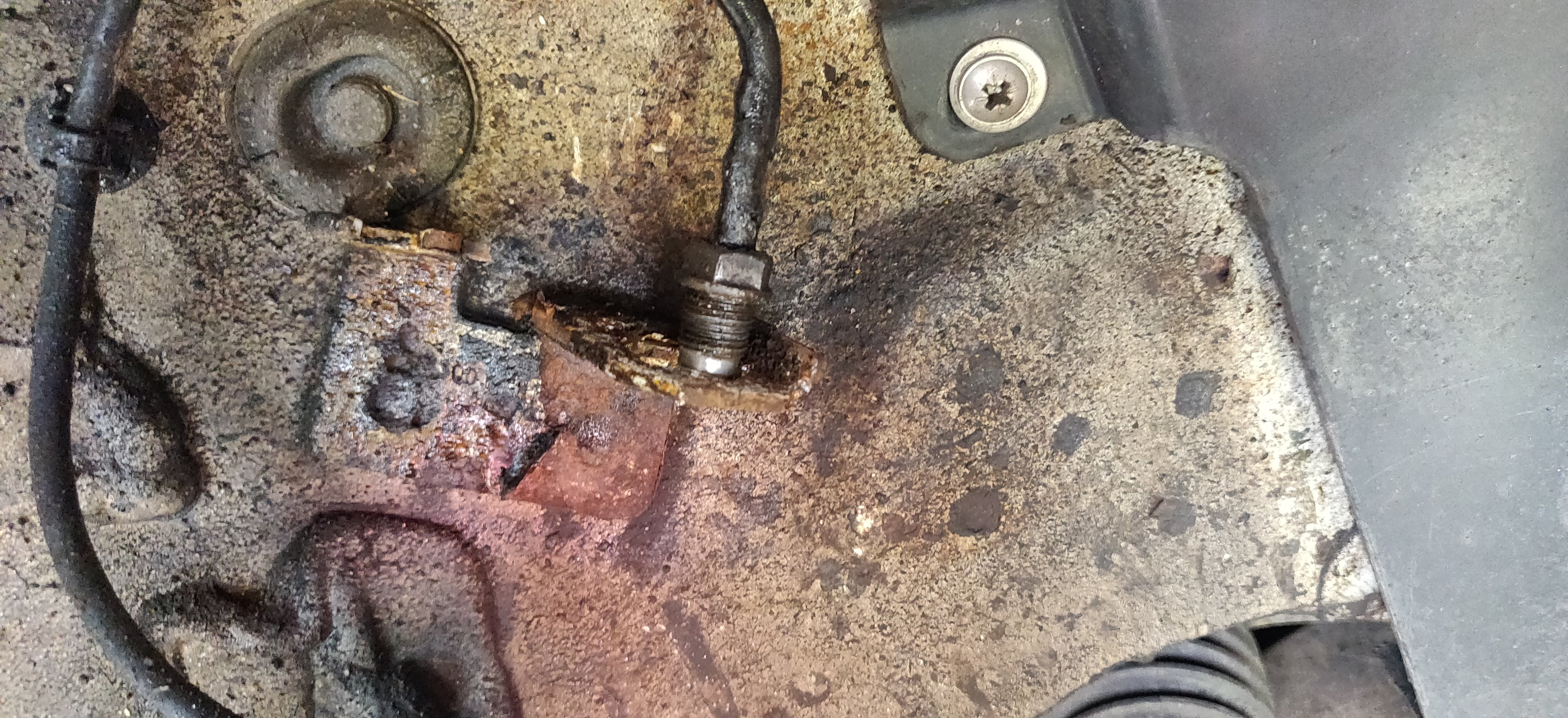

It appears I didn't do a post about replacing the rear hose to the caliper, which I saw as another possible cause for the sticking.
I was probably not in the best of moods at the time so didn't take many pictures. The main concern was undoing the brake union:
A case of hitting it with some heat and deep breathes until the union started to turn.
You guys know the state of the rear of this car, so the brake union was never going to turn without the pipe. So had to undo the rest via the hose, otherwise the pipe would twist and that would be a very bad day. In a few years time and some luck, I'll probably attempt a subframe drop, which seems the only way also to address these brake lines in a proper manner.
Anyways, replacing the actual hose is just reverse, really hoping that screwing the new brake hose in would result in being the right orientation for the caliper. I think it ended up near enough. The hose was £12.99, nothing fancy, as it was all to try and buy me some time...
Less than 1000 miles later, and after lots of evidence of the caliper still sticking (super hot), we were hearing metallic scraping sounds. I was hoping it wasn't going to be the rear pads.
The reason I wanted to buy time was because I have replacements ready to go and ideally wanted to do it in the late summer or autumn as part of changing other things like the brake shields and wheel bearings, which could be a terrible time and so wanted a decent uninterrupted block of time to tackle it steadily.
However, it was now looking like the front right caliper is also starting to get hot compared to the left, so my hand is forced, and all the brakes will need to be changed.
So undoing the rear calipers and removing the pads for the right hand side:
Absolutely fine, barely run in.

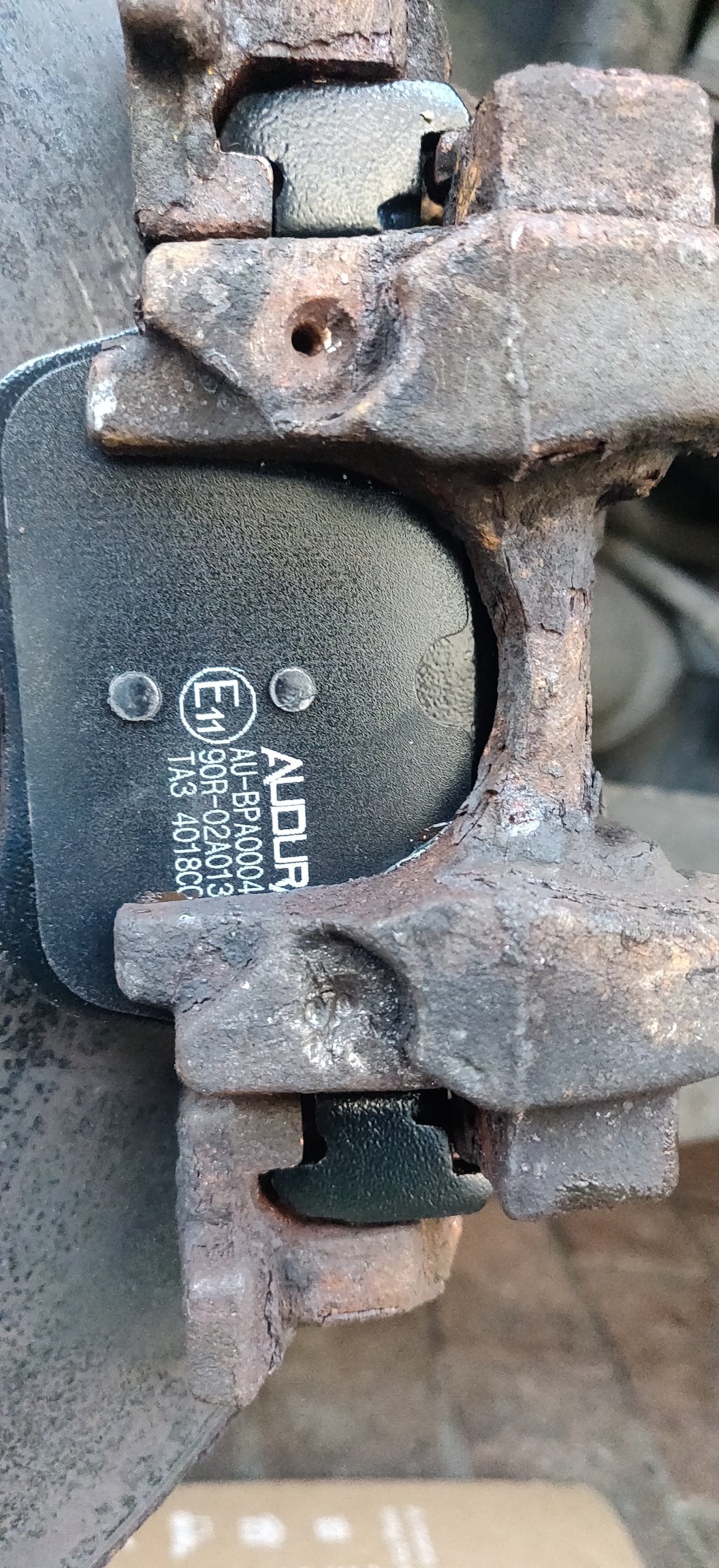

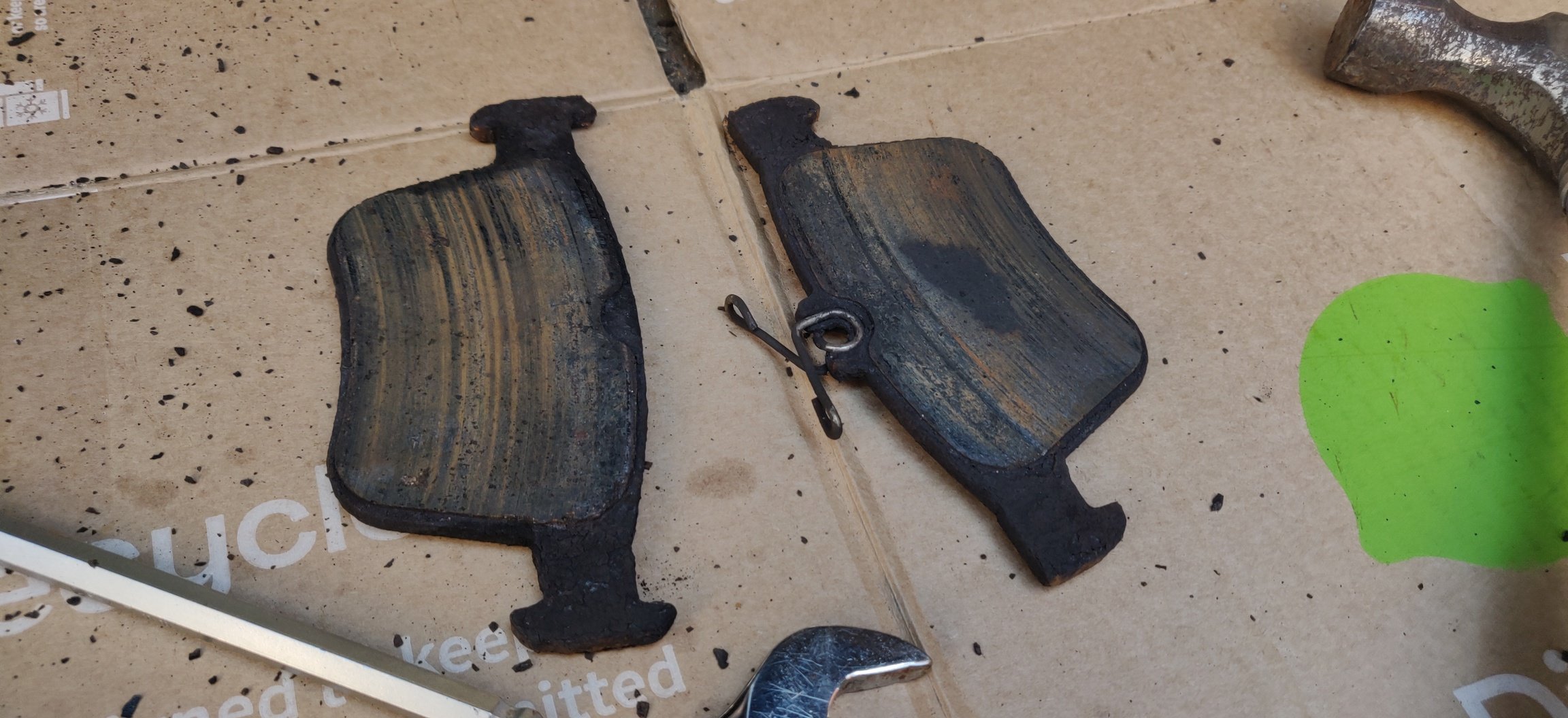

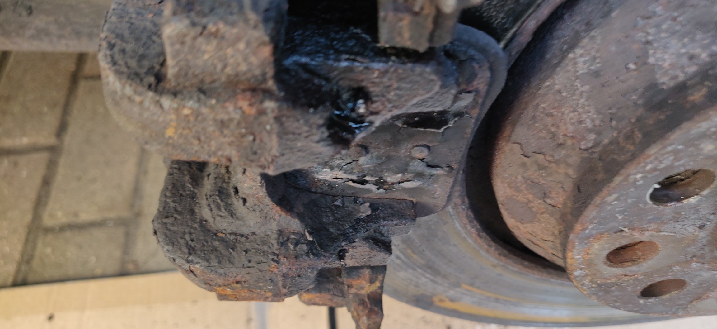

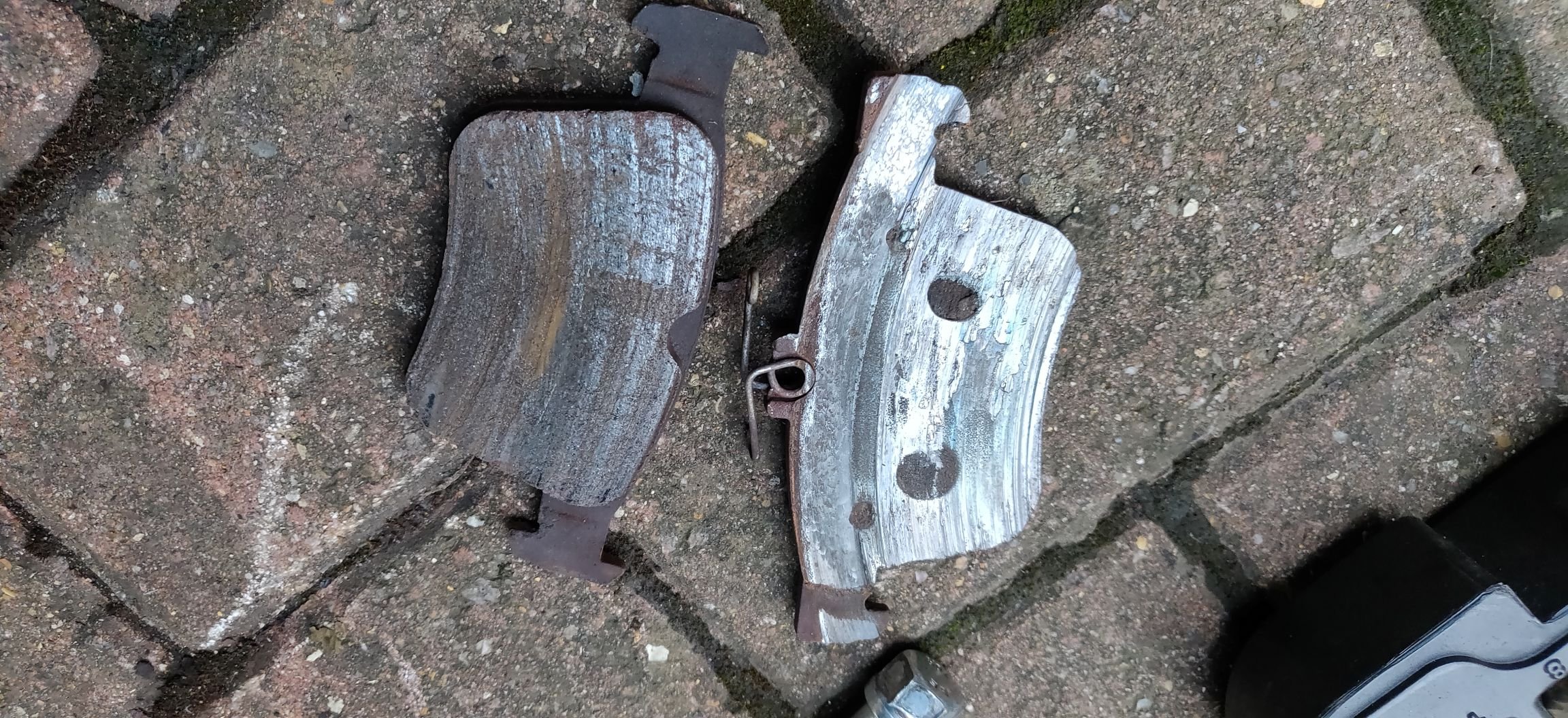

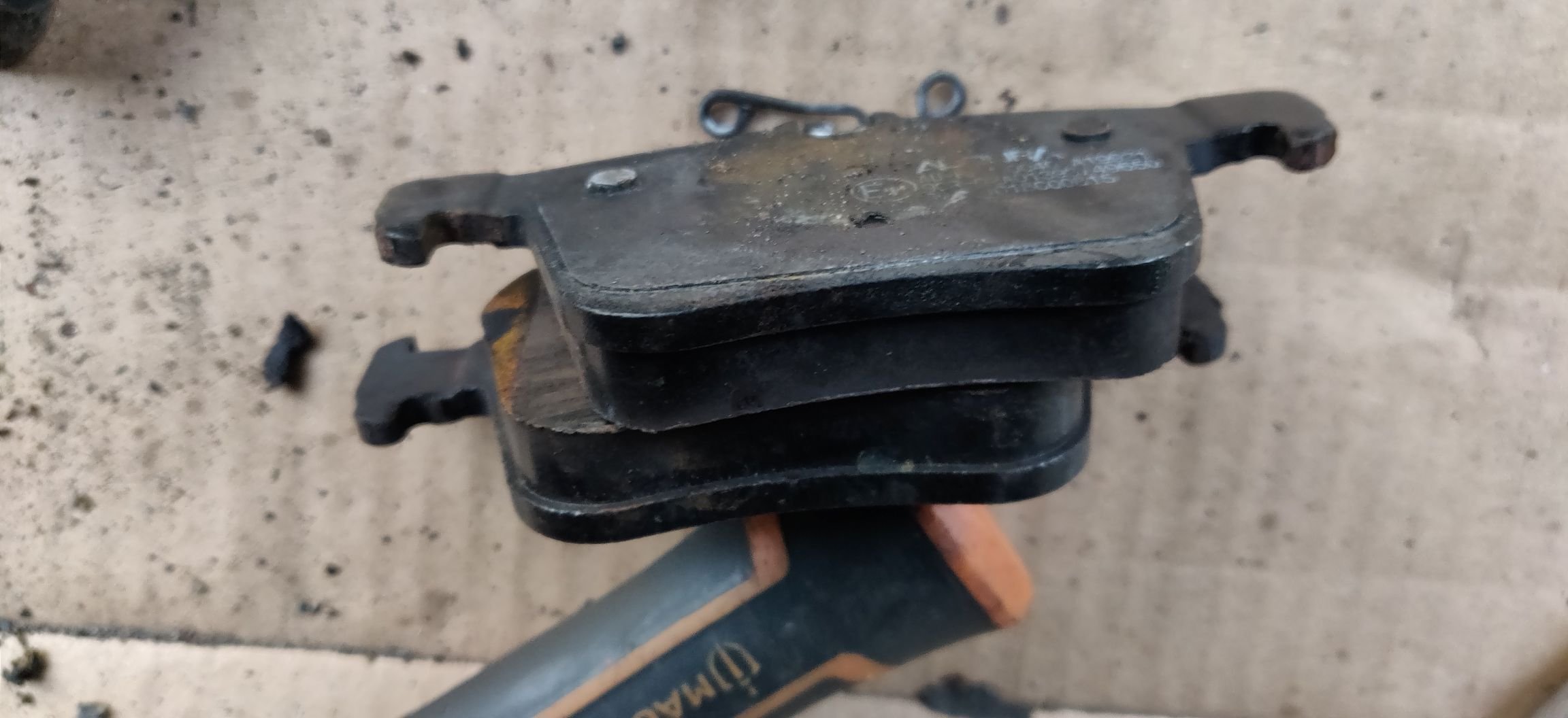

The same can't be said for the troublesome left side:
So the metallic scraping sound was the caliper being stuck enough that the inner one has worn to buggery. I've only seen this one other time where it started to grind away the actual pad backing.
So my hopes that the rear pad change would tide over the MoT coming next month are somewhat dashed. We literally can't drive this any more at risk of doing all sorts of damage, which may already have happened to that poor caliper. I suppose another set of cheap pads might tide it over for another month, but I imagine the MoT would fail on the state of the brake discs.
Was always blasé about these calipers and brakes due to intending to replacing it all though.
So for now, the plan is to just do the brakes and leave the shields and bearing for a later time.

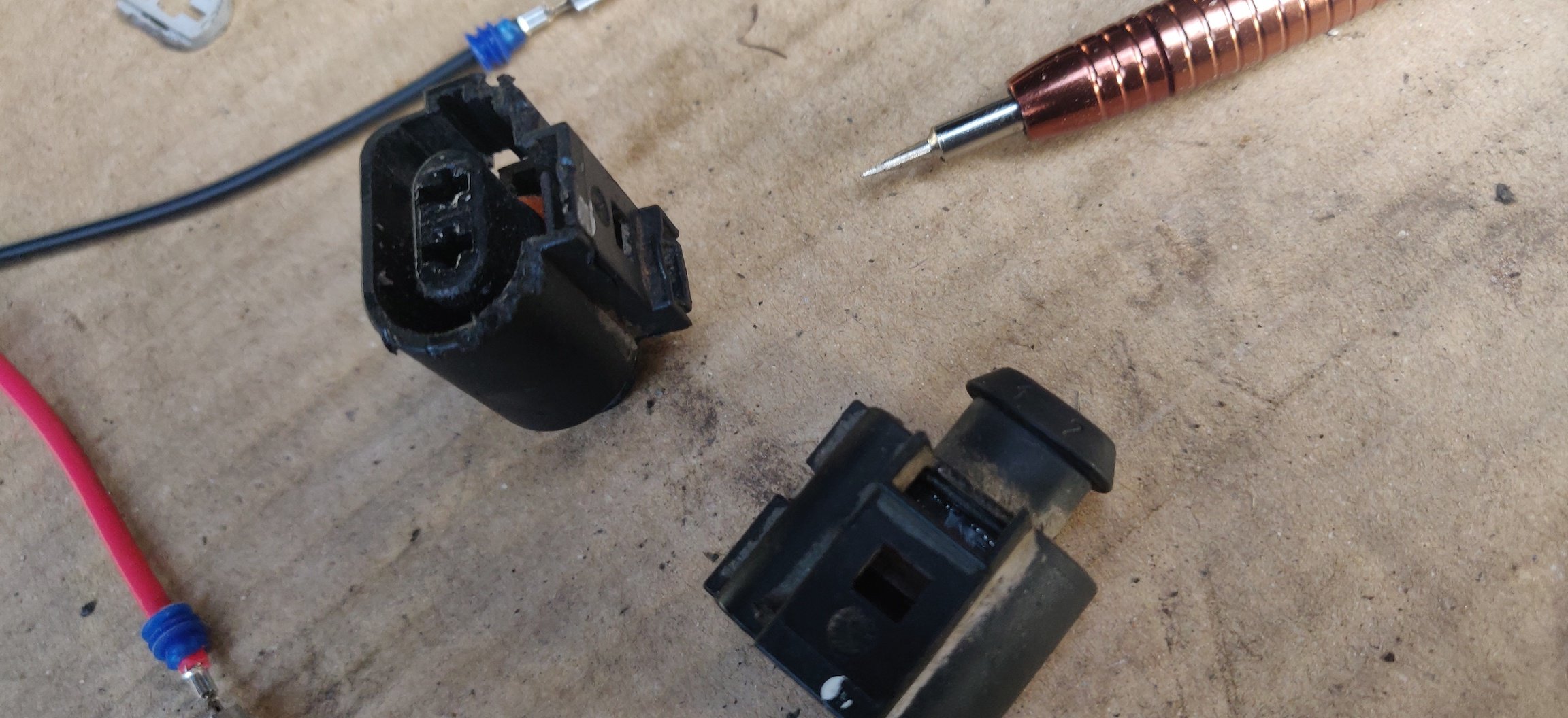

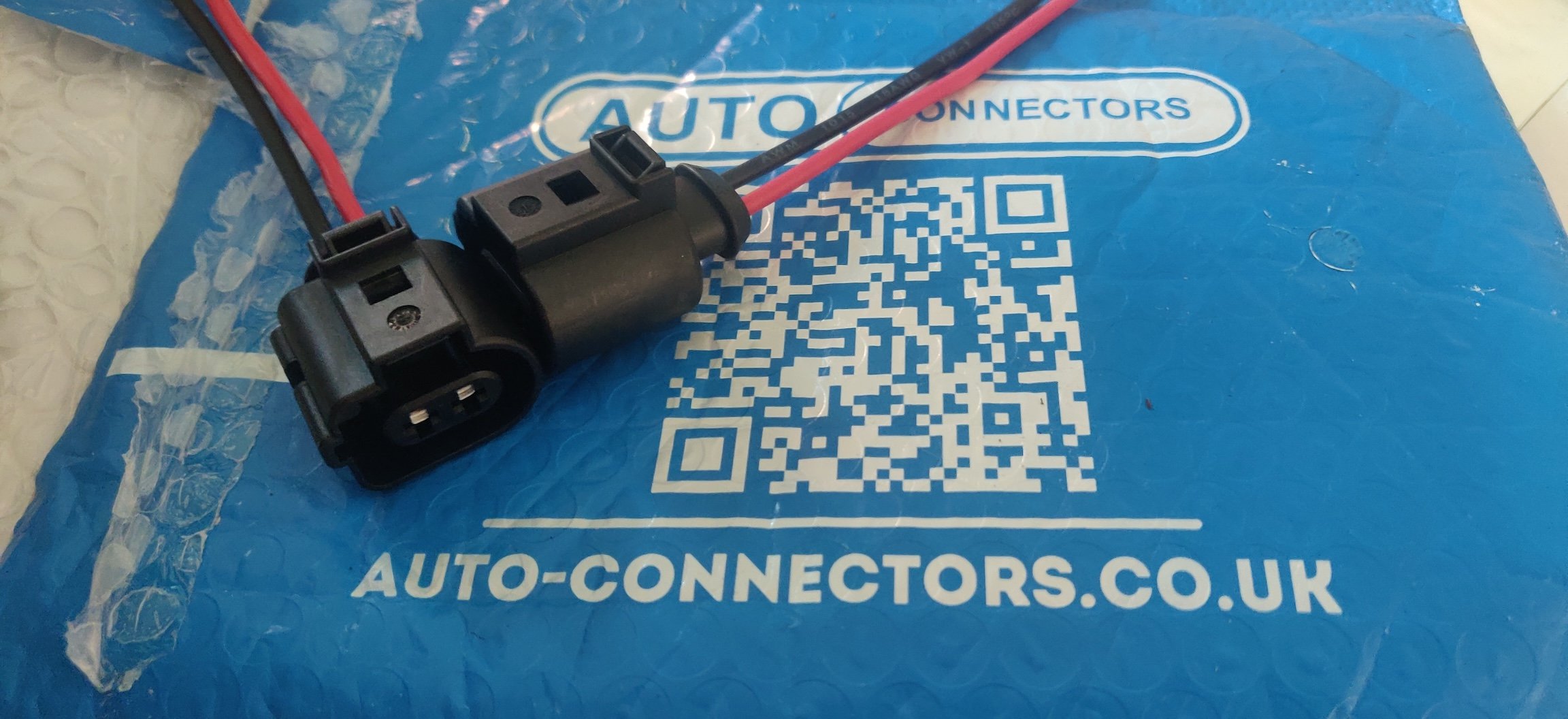

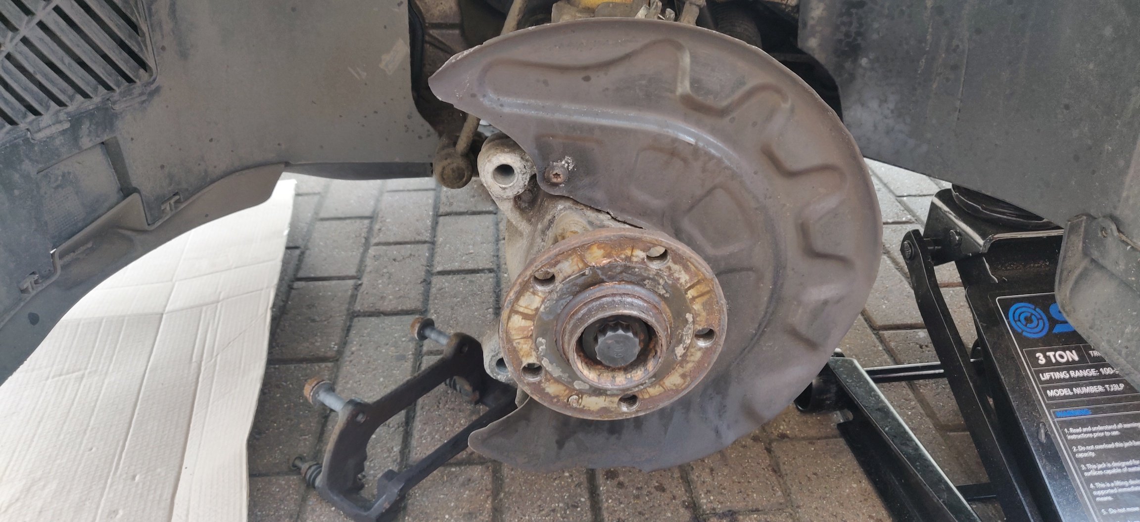

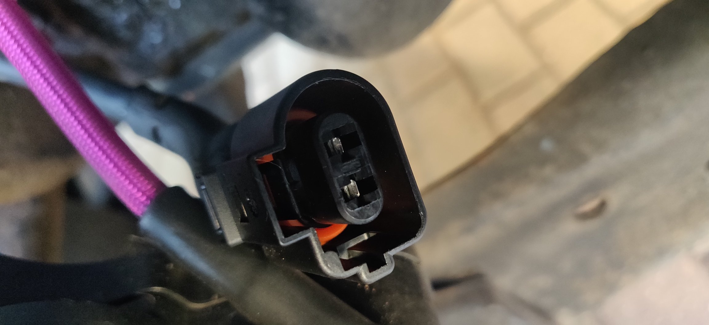

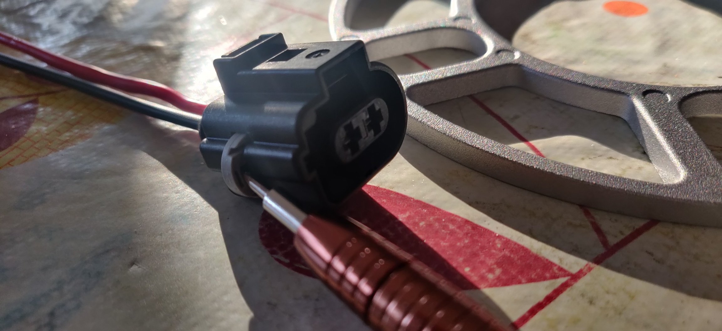

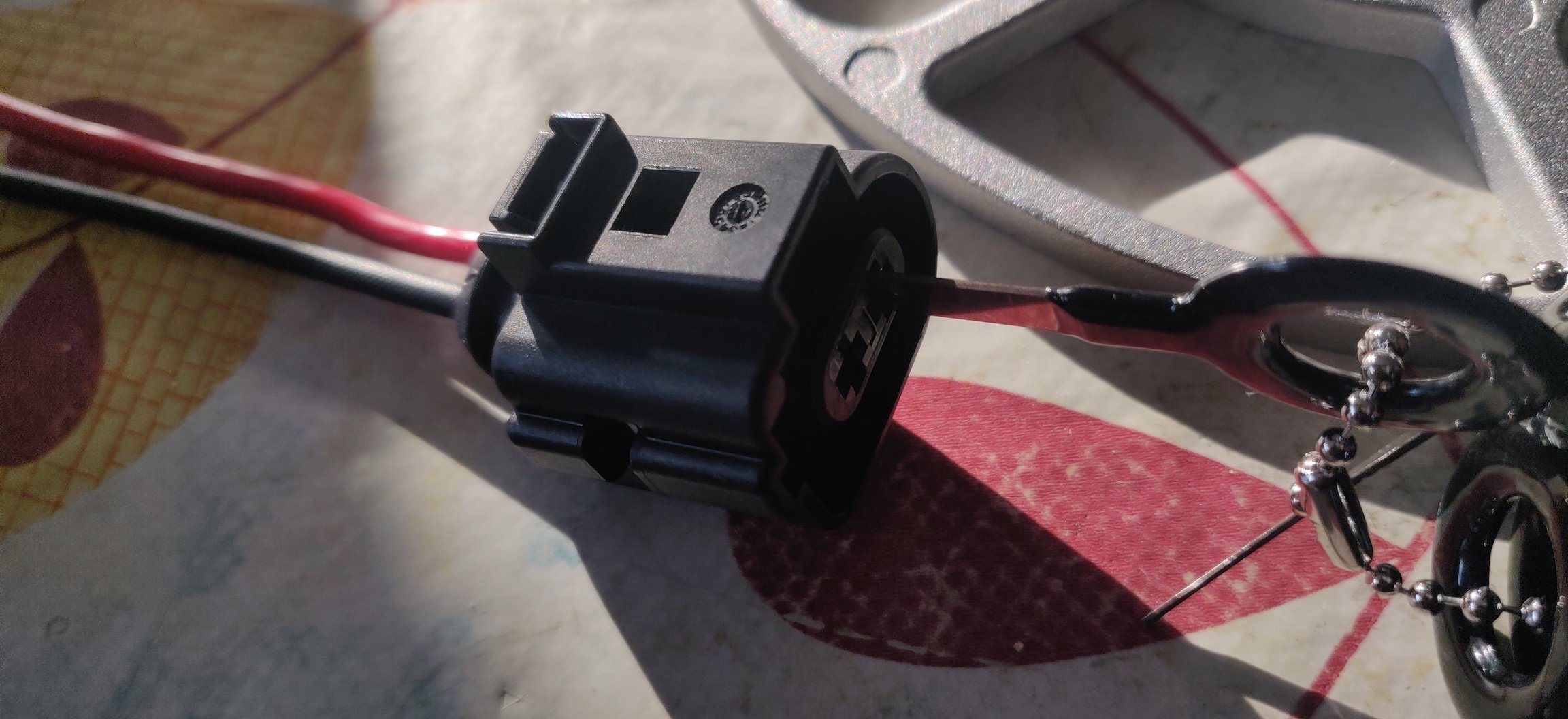

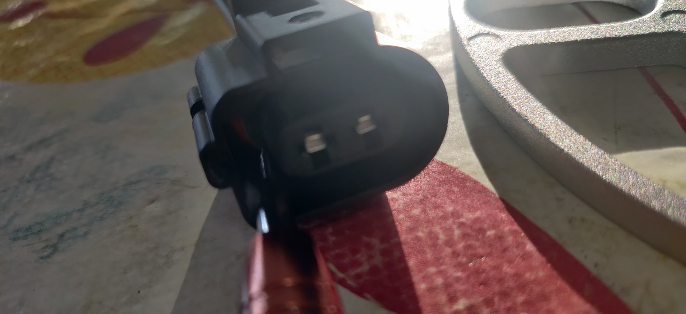

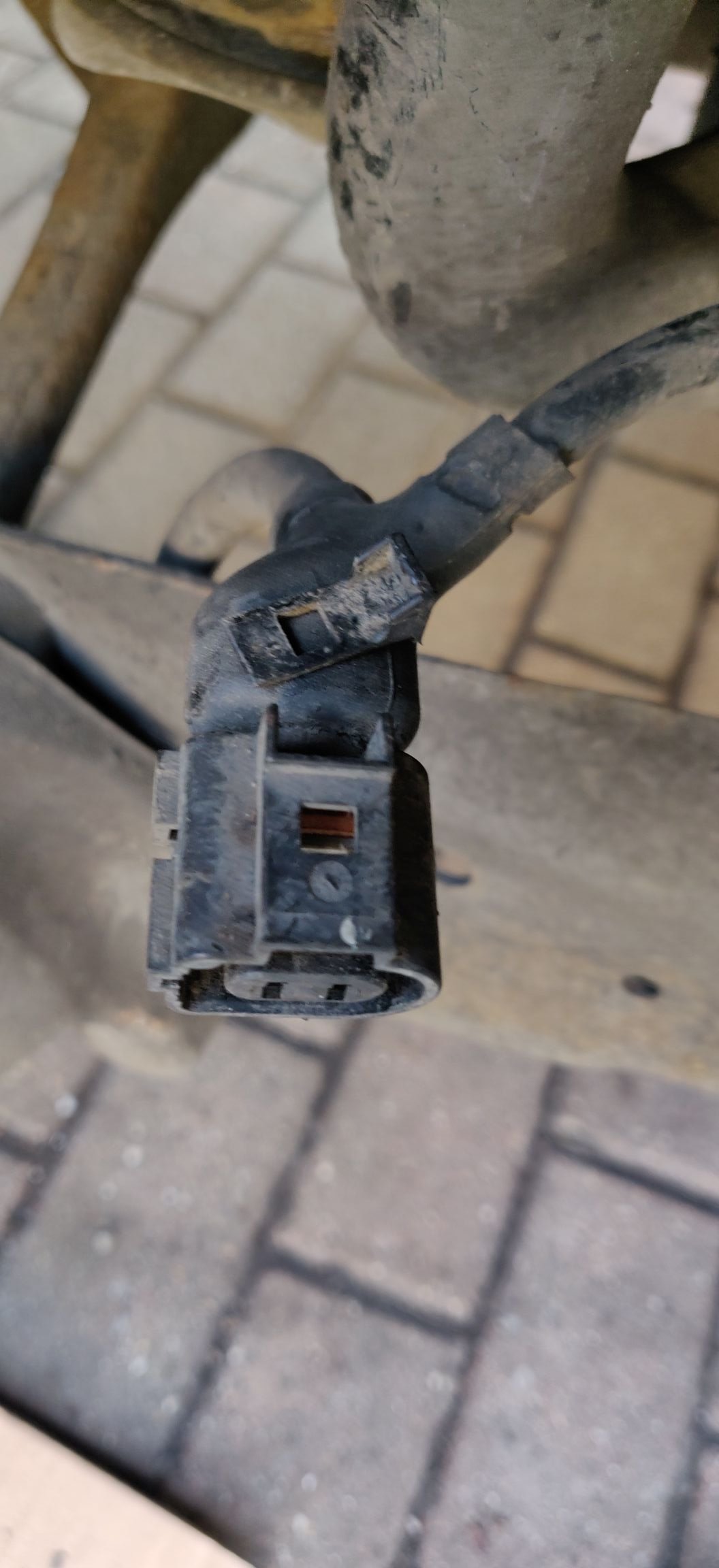

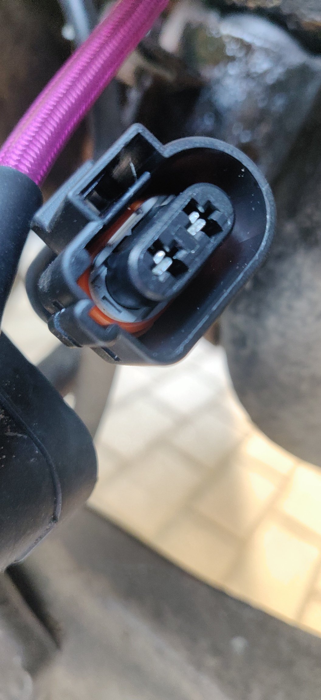

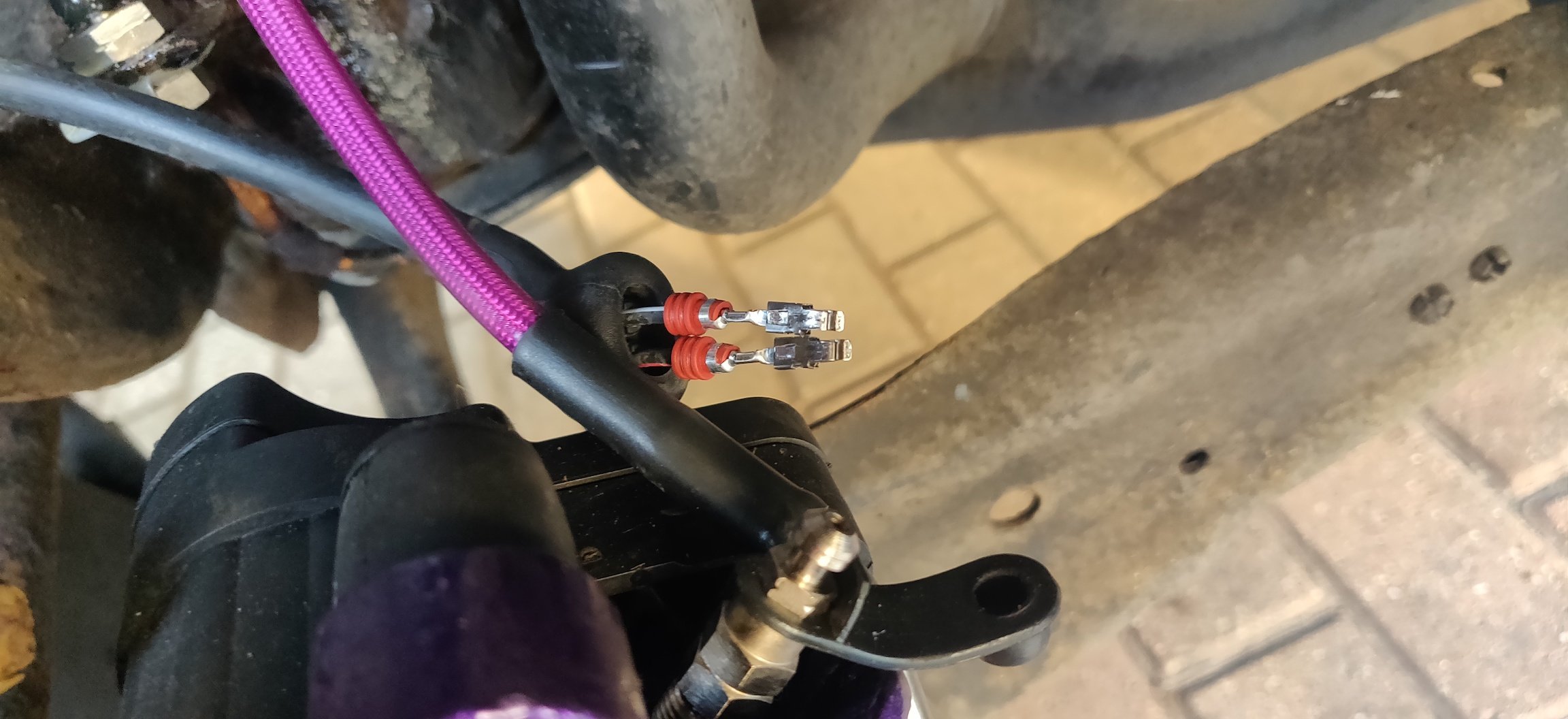

Of course, attempting to undo stuff has led to:

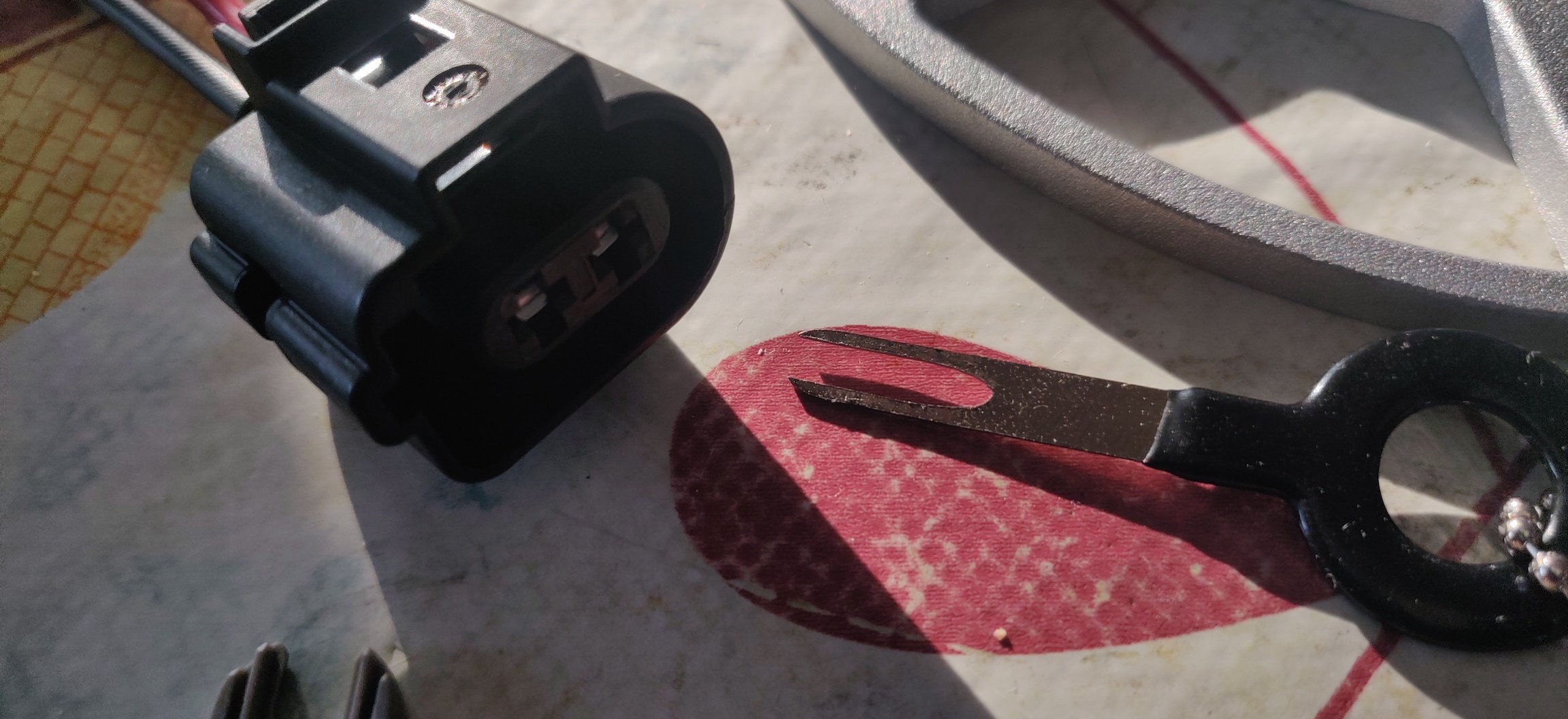

Broken electronic hand brake connector. I seem to have this happen too often with VW stuff (coil pack connectors usual suspects). I'm hoping the moulding to that connector is just rubber and so the connector itself could be replaced by extracting the original pins. If not, then I need to plan some sort of bodge. I guess a lot of time exposed to dirt gets into the nooks just enough to make undoing things awkward, and then slightly too much force.

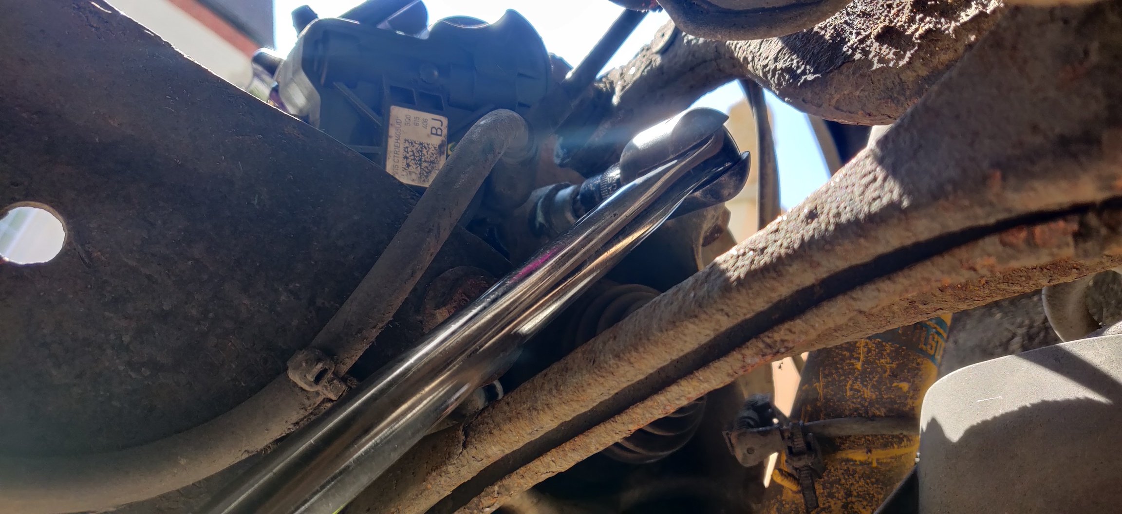

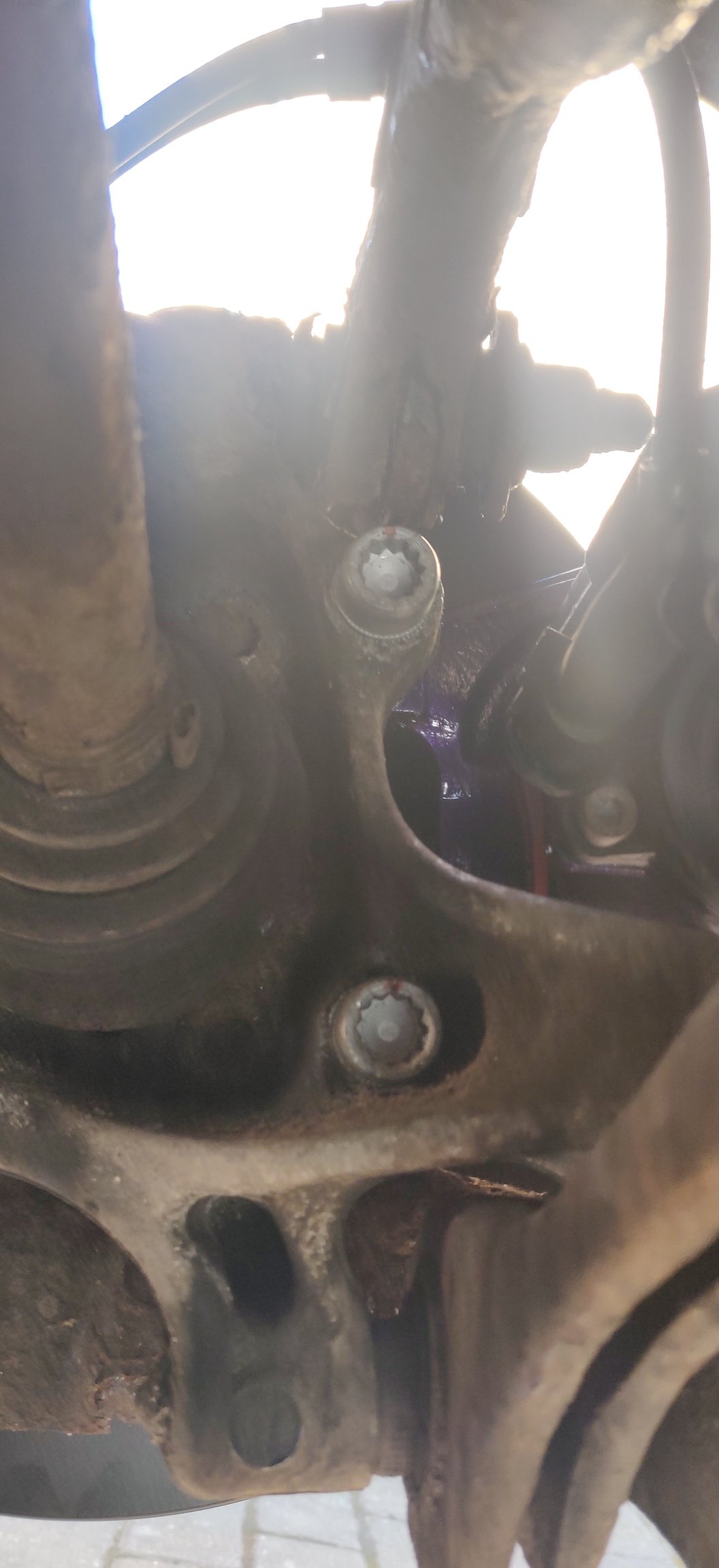

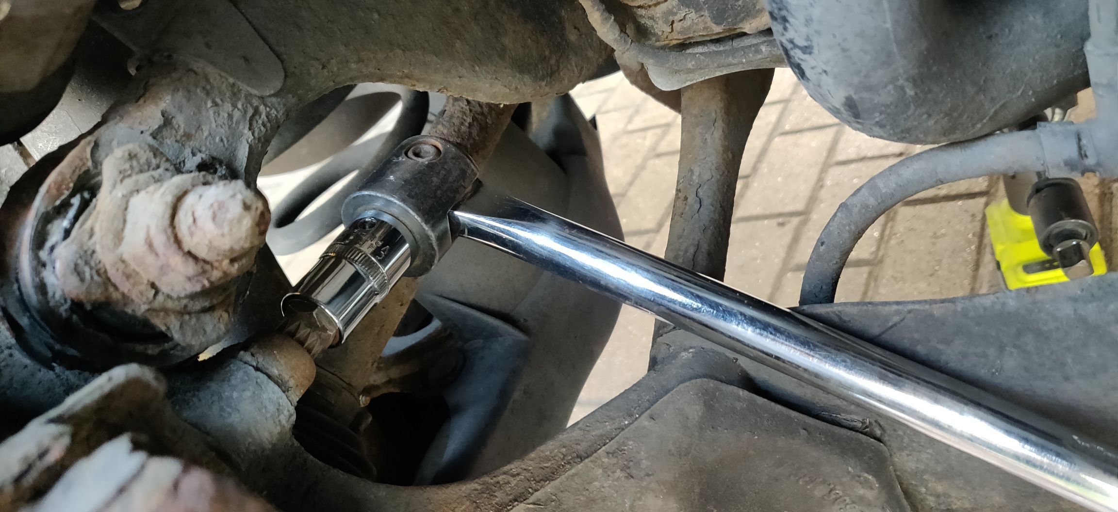

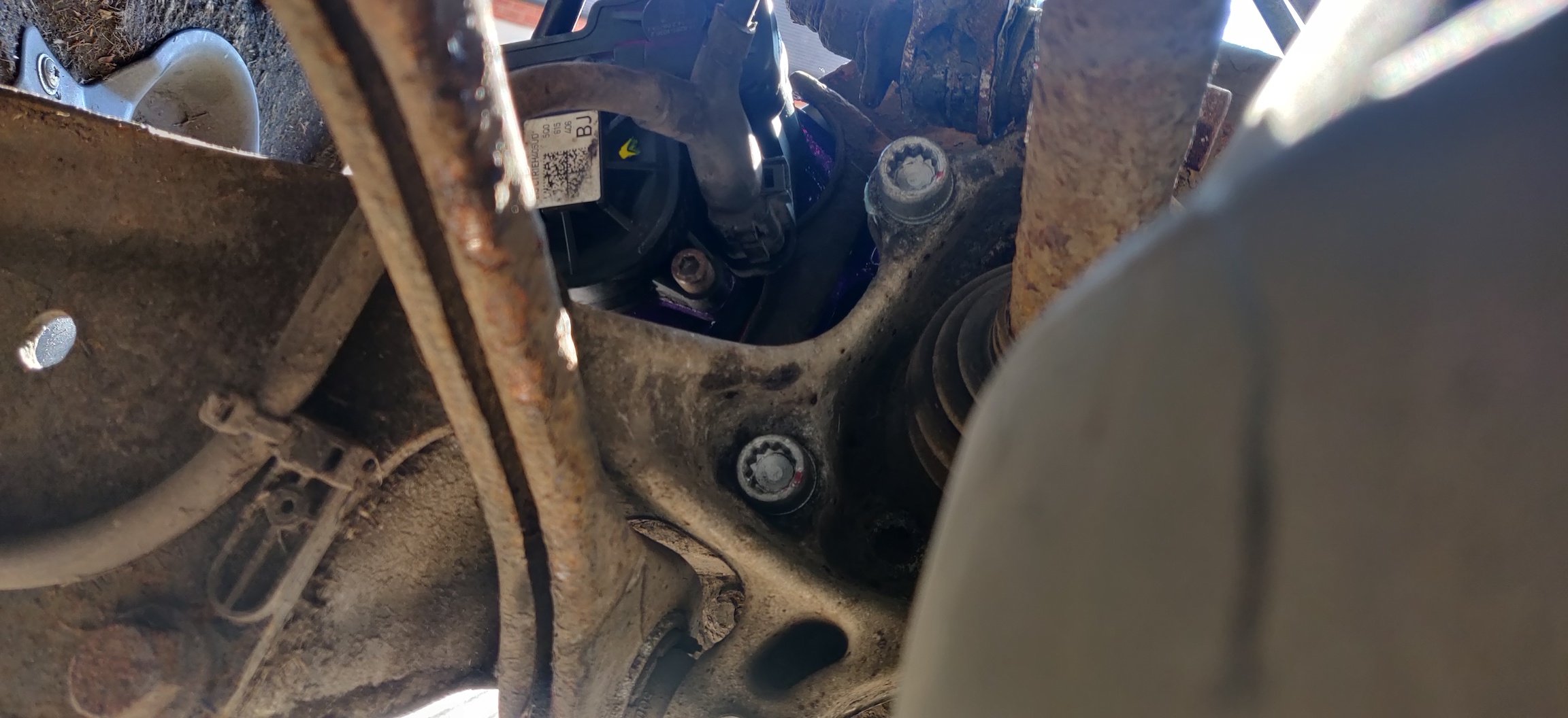

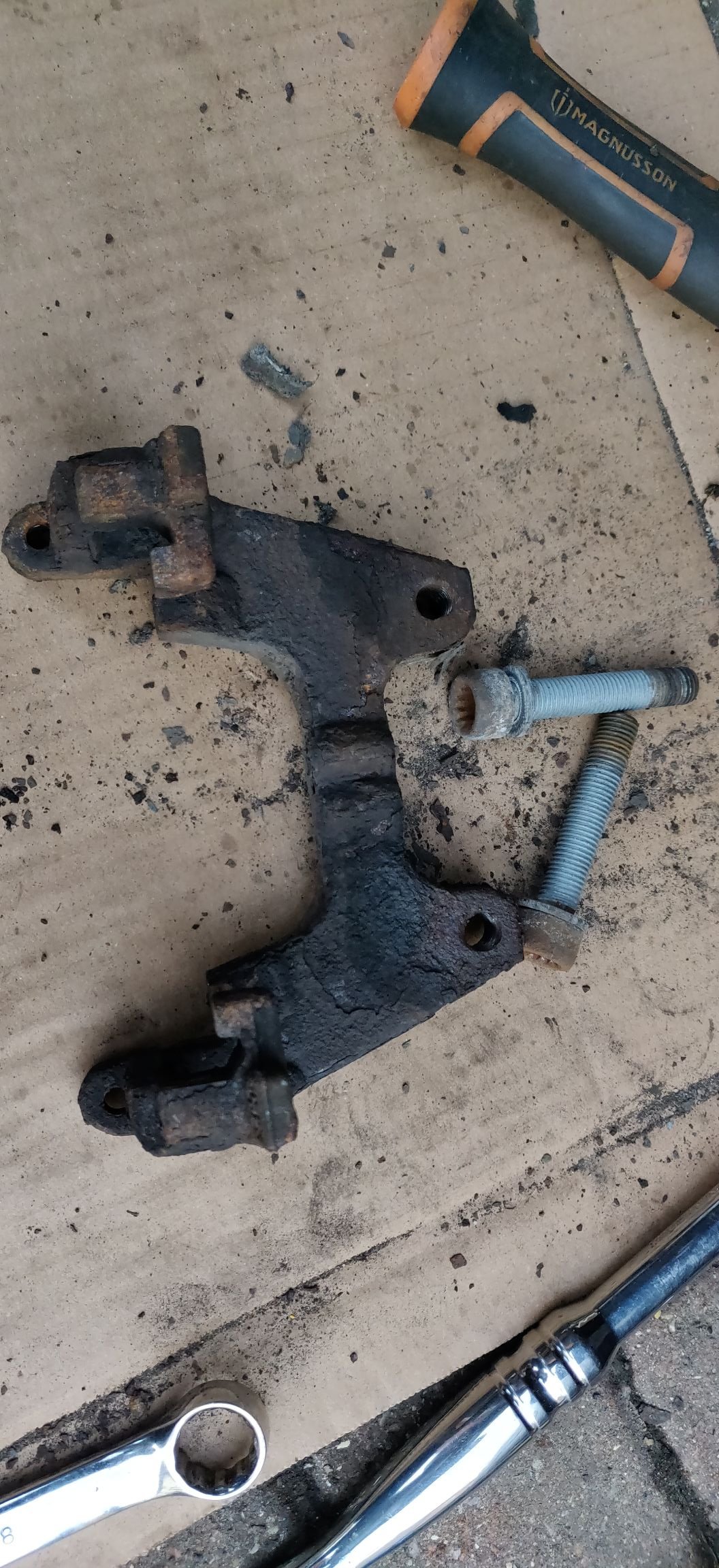

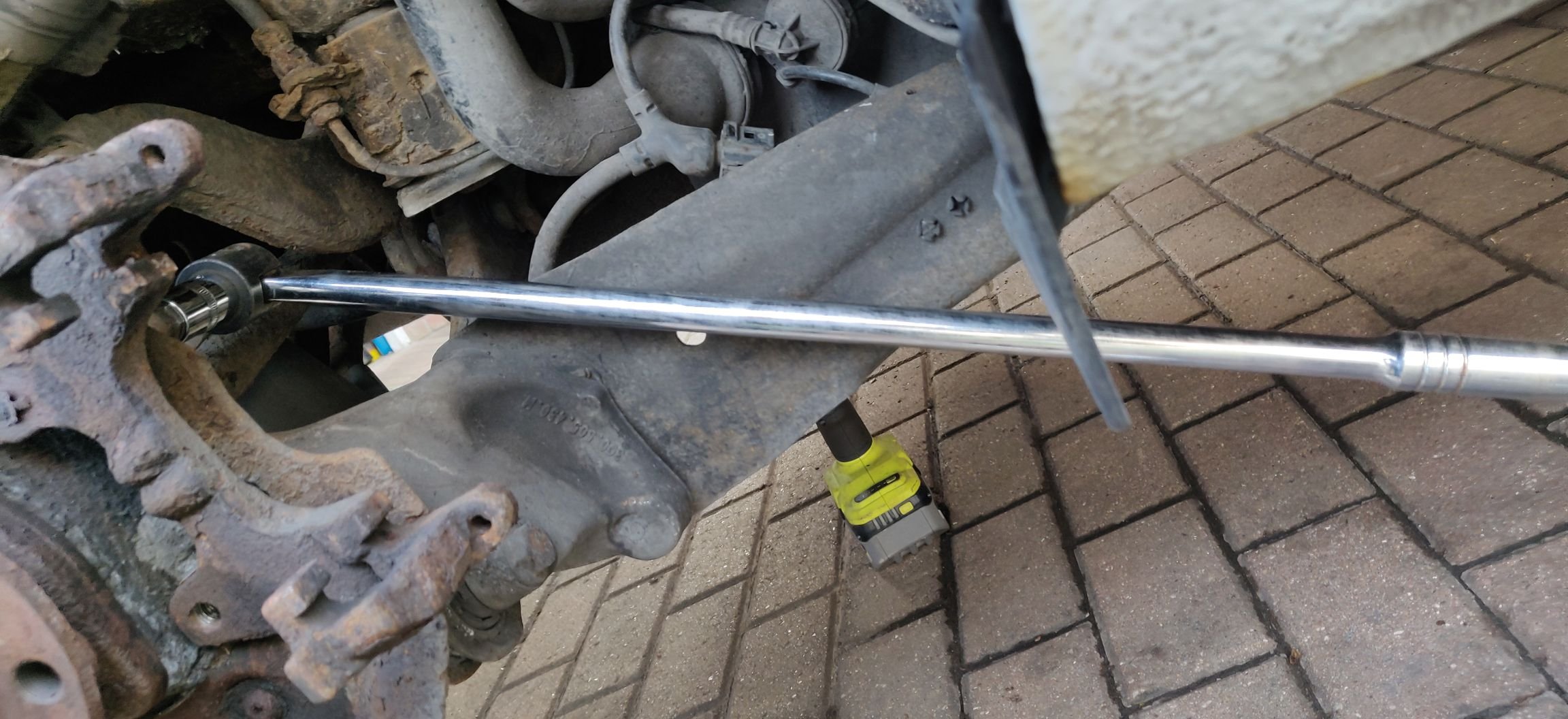

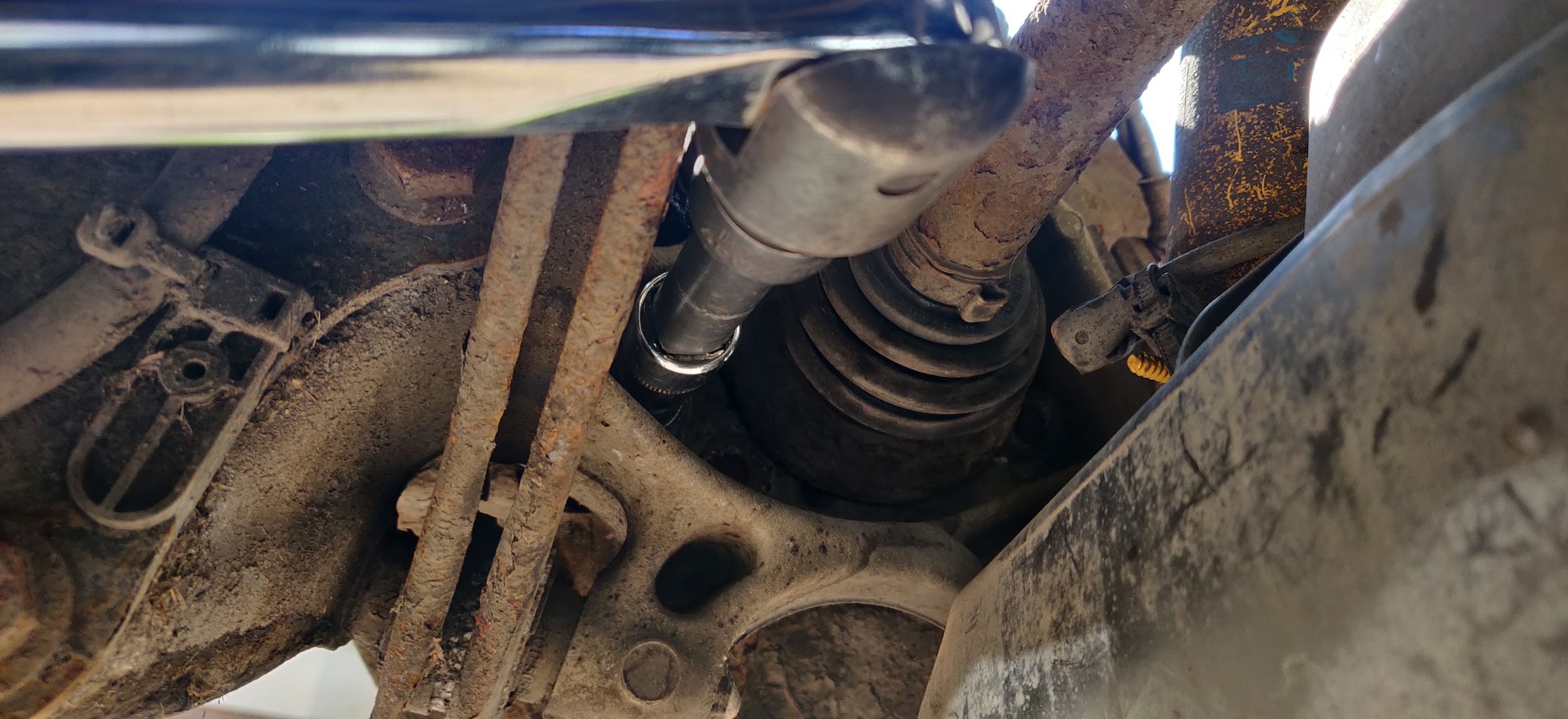

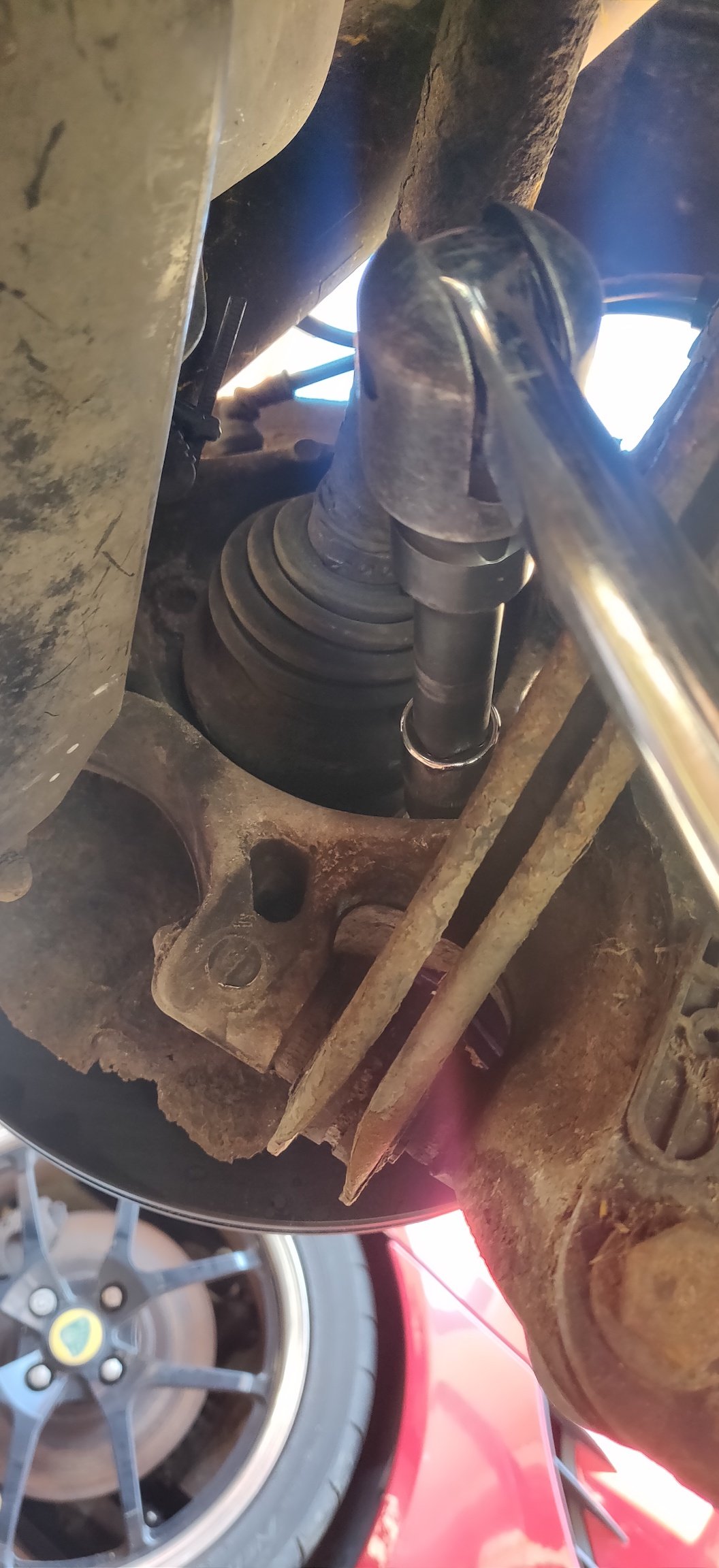

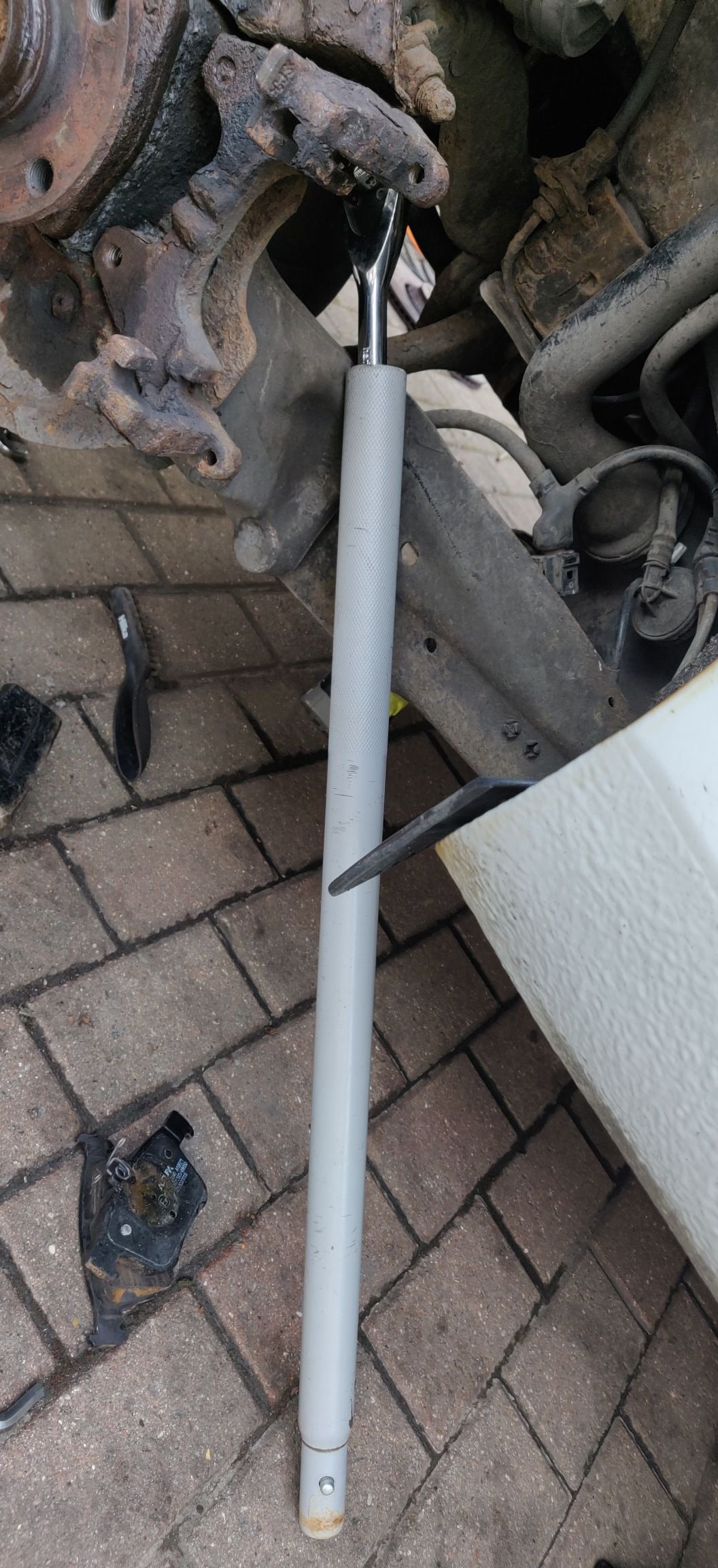

Other than that, the main obstacle is the removal of the pad carriers. This has meant various attempts at breaker bars, extensions and ratchets with a pipe over:

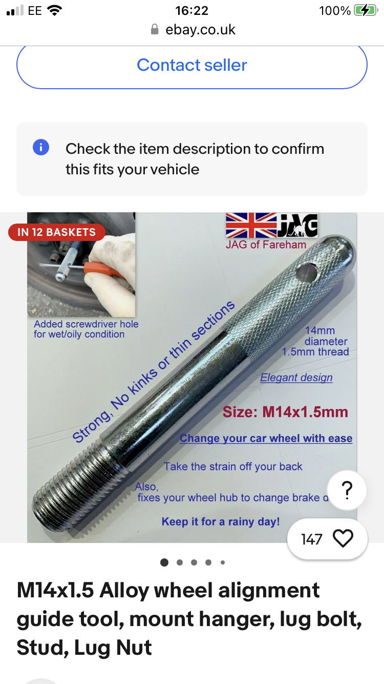

The bolts are an unorthodox M14 bolt. Or at least that's the name of the socket used. Given the wife used to have a Seat Ibiza, I've had a set of these sockets available for a while. Fortunate as the Halfords tool set I have only goes up to M12.
For the right hand side, I was somehow able to start the lower bolt with just the ratchet, and the lower bolt has just enough space for a wobble UJ, extension and impact driver to get out.
It's all super fiddly with the driveshafts, rear damper, rear spring and suspension arms all conspiring to basically get in the way.
The top involved an attempt with the breaker bar as seen above which wasn't successful, so the ratchet with the trolley jack handle as a pipe was used:
Almighty cracking noises ensued, but the bolt was starting to loosen:
So that's that side sorted.

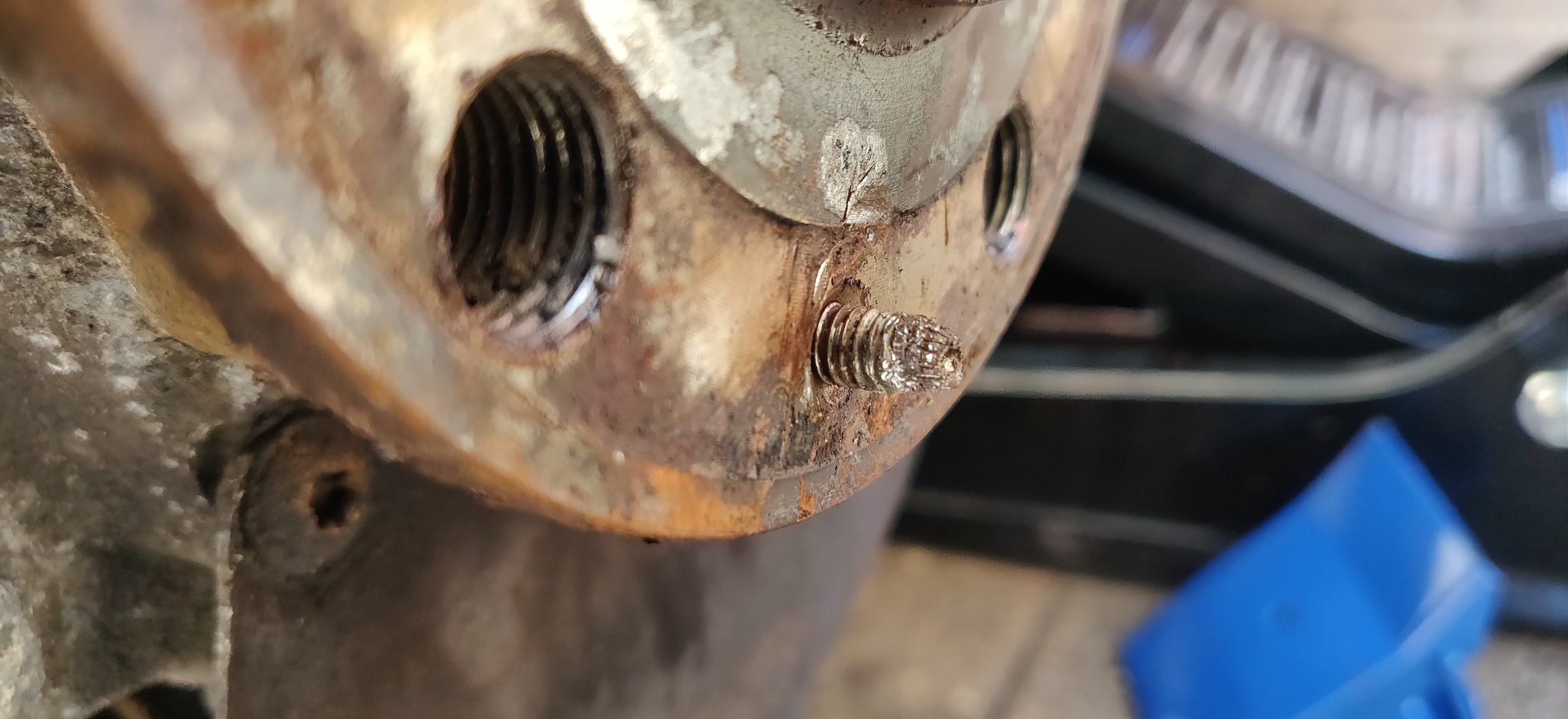

Absolutely no luck with the left side. I imagine the heat cycles from the sticking caliper has not done any favours. I'm just about able to use my feet against my garage wall for leverage (essentially horizontally shoulder pressing the damn ratchet and pipe) but still no luck.
Put some plus gas on it for now and will try tomorrow morning. If heat doesn't suffice, then I will happily get violent and cut the pad carrier out, given I have a replacement.
I'm still not sure why on earth they decided these bolts were the ones to go for, especially considering the front ones are just normal (albeit chunky 21mm socket I think) bolts. Bolts that aren't TTY either.

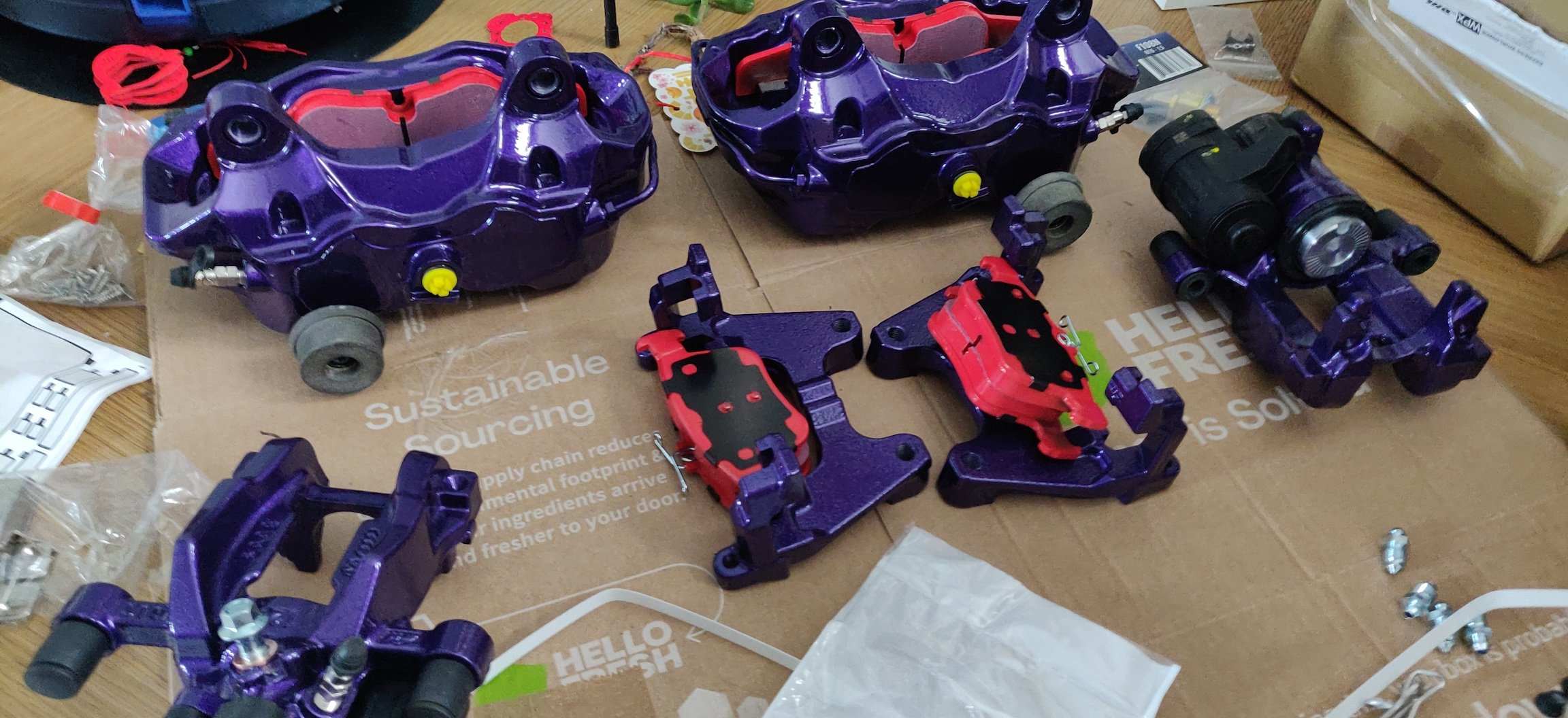

So something that has been on the list of things for this car:

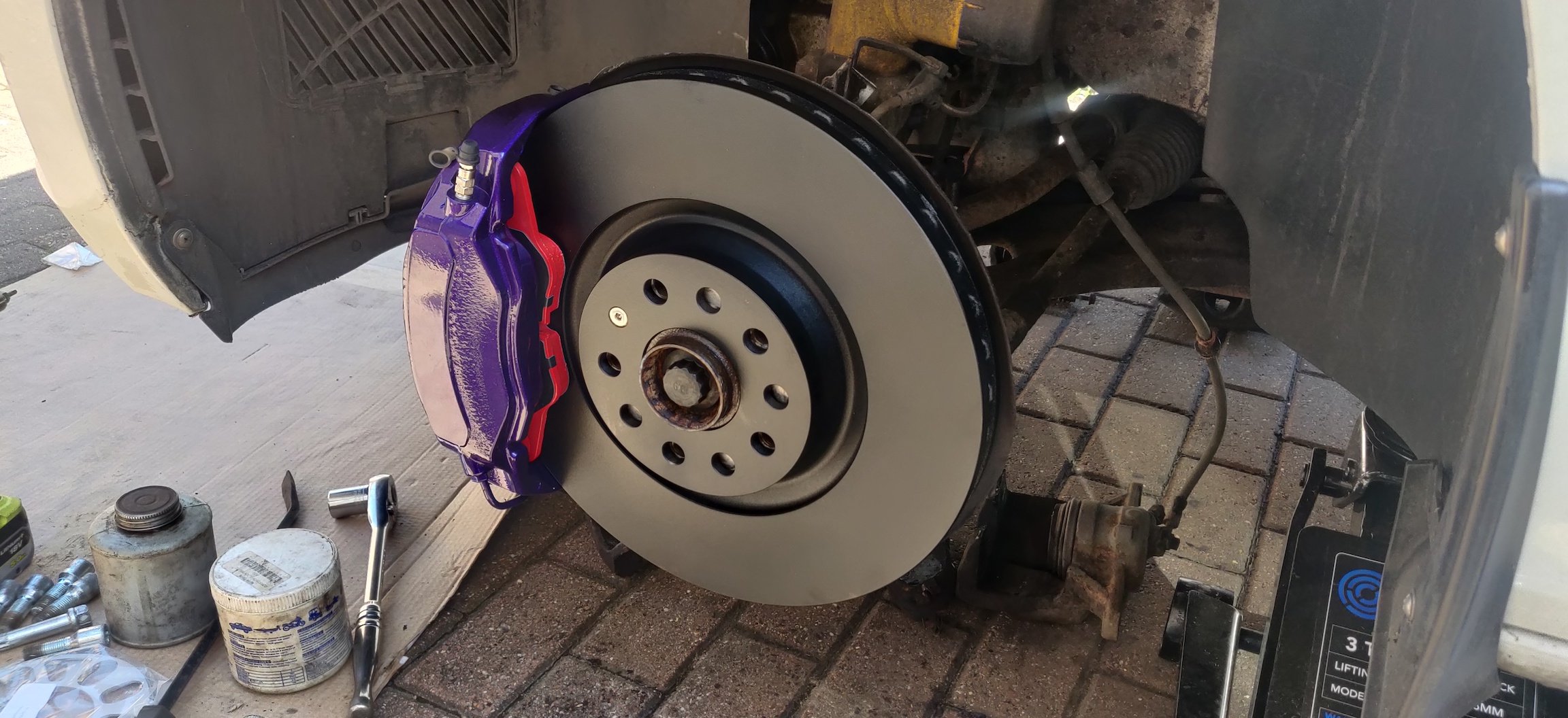

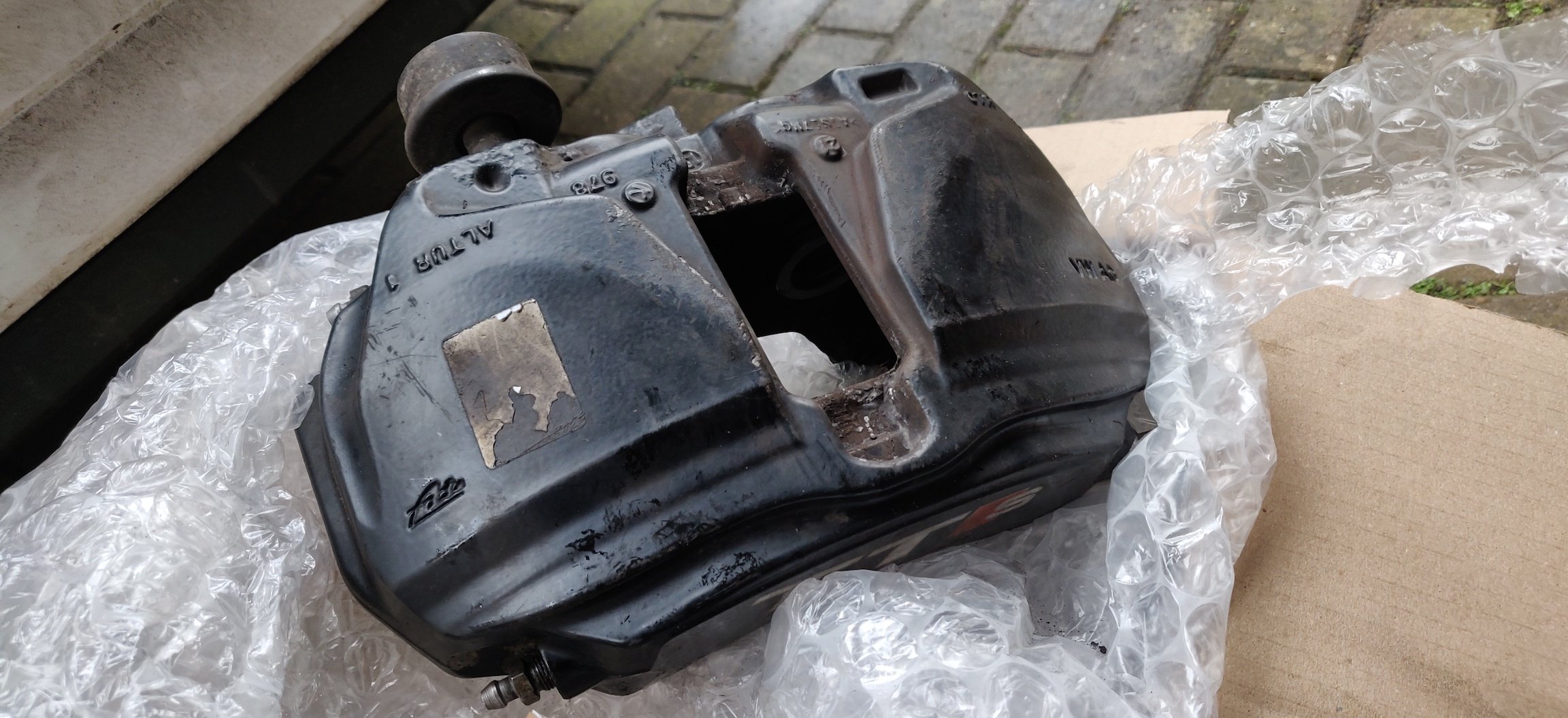

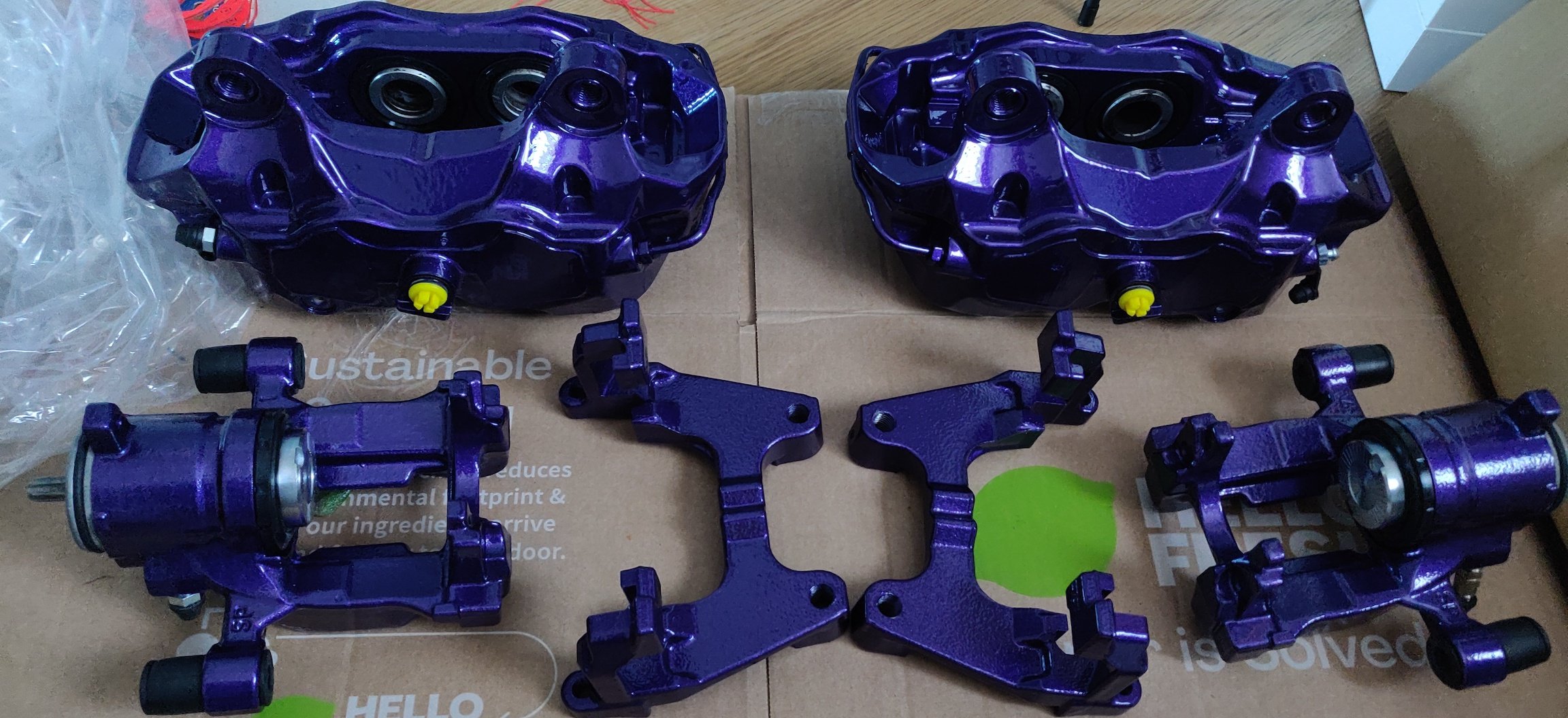

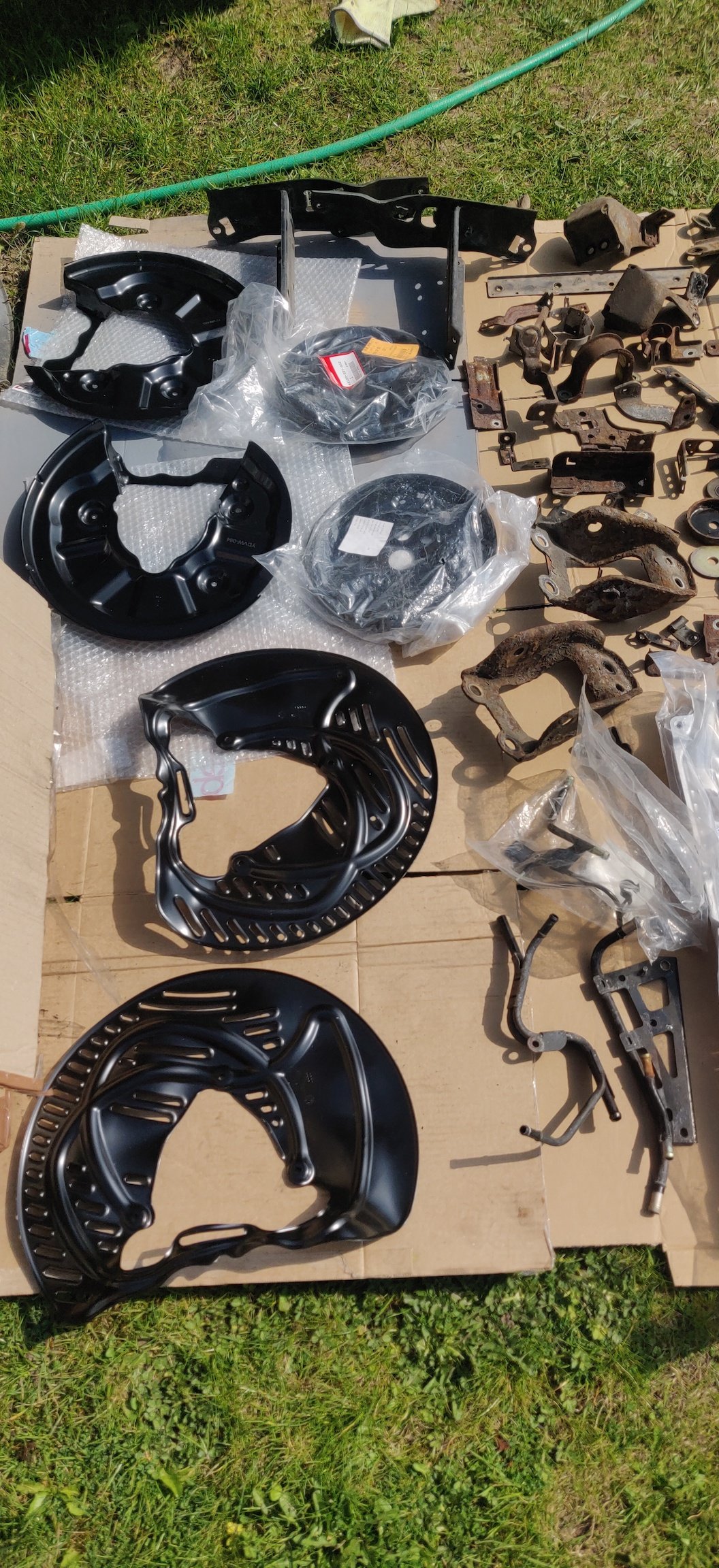

Some Audi TTS calipers to replace the fronts. The aim was to scour for these until they were at a price I couldn't refuse. This was the case, as not only was it a good price, it was also all 4 calipers, front and rear. Came to £409 with a discount. I did reduce the delivery cost by picking them up myself, so a 3 hour round trip if I remember correctly.
This was mid February, and from there, was a case of sourcing the other bits.
So things like:

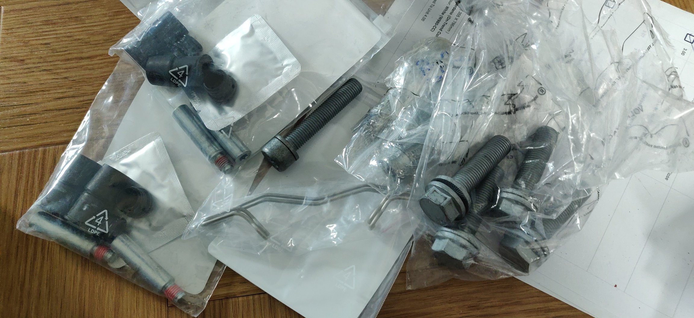

Caliper bolts front and rear, and the rear caliper gubbins, like slide pins and those clips that were buggered.
Front bolts probably don't need replacing as they're not TTY, and I'm sure they would fit the Audi TTS calipers, but got them anyway, N 910 84 901 at £10.87.

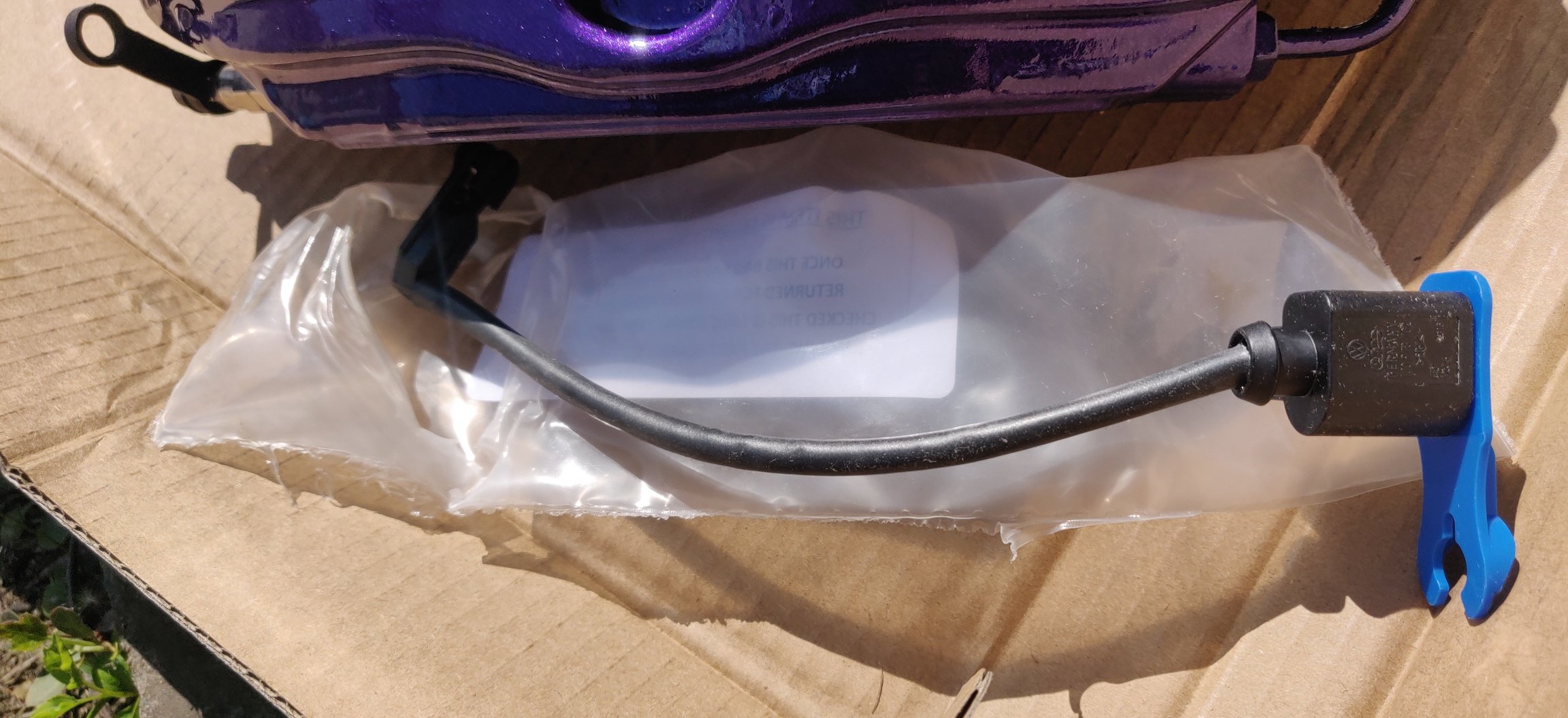

A pad wear sensor for the Audi TTS caliper, 8S0 615 121 A from eBay at £19.49.
The slide pins for the rear (£10.83) and the clips (£6.89) were from eBay, just aftermarket bits, notable that the 7mm socket is now a T40 torx on these pins. I'll have to make a note of that somewhere for future work (probably scribble it on the brake disc or something).

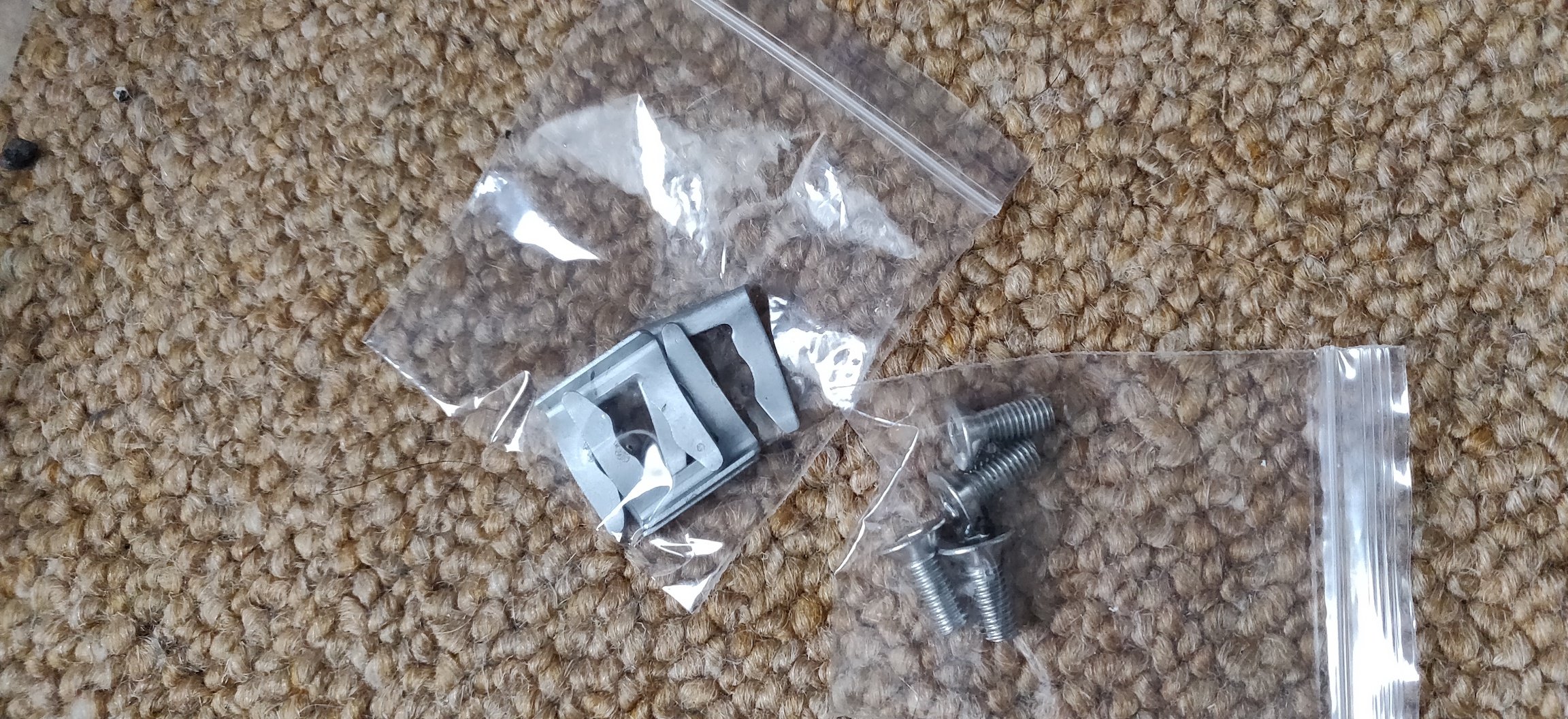

Some other random bits like brake hose clips (£3.23) and brake retaining bolts (£3.25), stainless ones, and probably really for the new wheel bearings once those are ever in place. Just random bits from eBay, as it'd be mad to use genuine retaining bolts and risk them seizing.

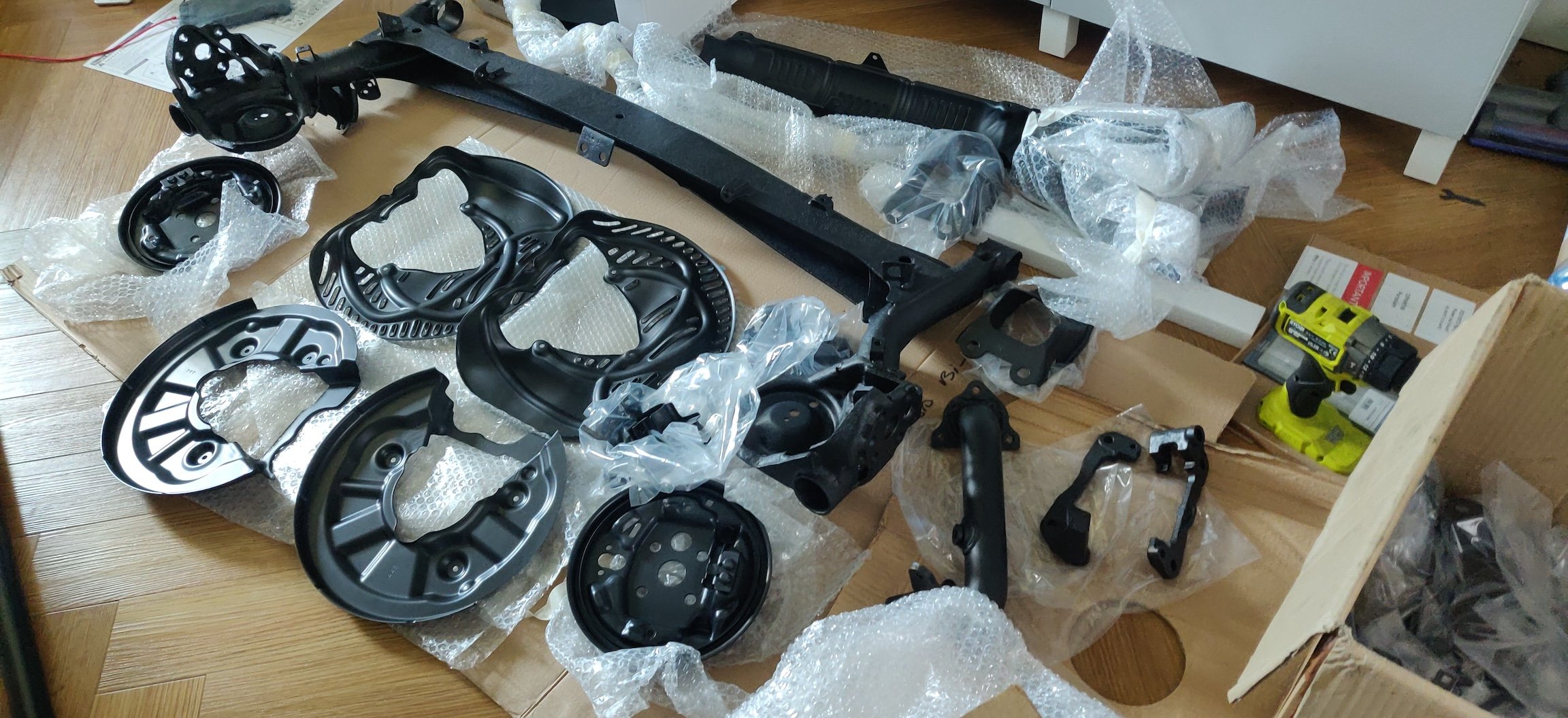

Also a set of brake shields front and rear:
Obviously the bits on the left side. The rears need replacing as seen on previous posts, and the Audi TTS ones have these air vent bits, which I suppose is for cooling, yet, feels like it defeats the purpose of shields.
Fronts are 8S0 615 311 D and 8S0 615 312 D at £57.20 for the two from lllparts, and the rears are from eBay apparently parts 5Q0 615 611 K and 5Q0 615 612 K at £40.70.
All the other bits are for my Honda Insight, basically in a state of disassembly, with a huge amount of rust, in such a way that means I'm not worried about the Skoda. All the bits are being sent to be coated, to something hopefully more corrosion and scratch resistant. Lest the rear shields disintegrate away again. The grand irony being the Insight is aluminium, so it's the rest of the bits that have really rotted away.

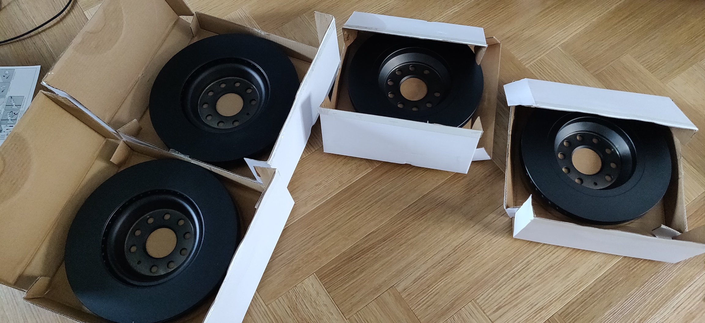

Anyways, brake discs:
I've used MTec for brake discs for a lot of my cars, mainly because they do coatings which seem to help keep the unbraked surfaces hold up reasonably well. Sometimes not perfect though, but the price of the discs make it hard to argue. Set of 4 large discs for £228.48 seems hard to beat. One has to start chasing big money for lighter discs or "better", whatever that may mean.

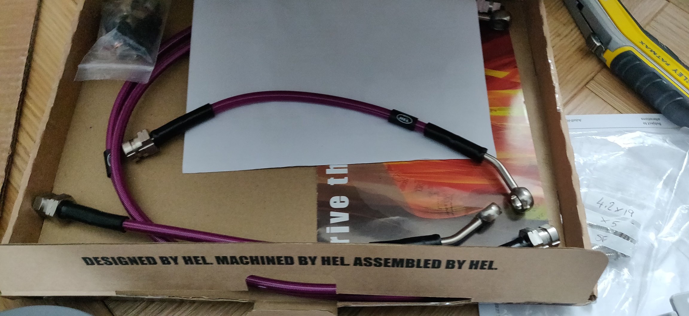

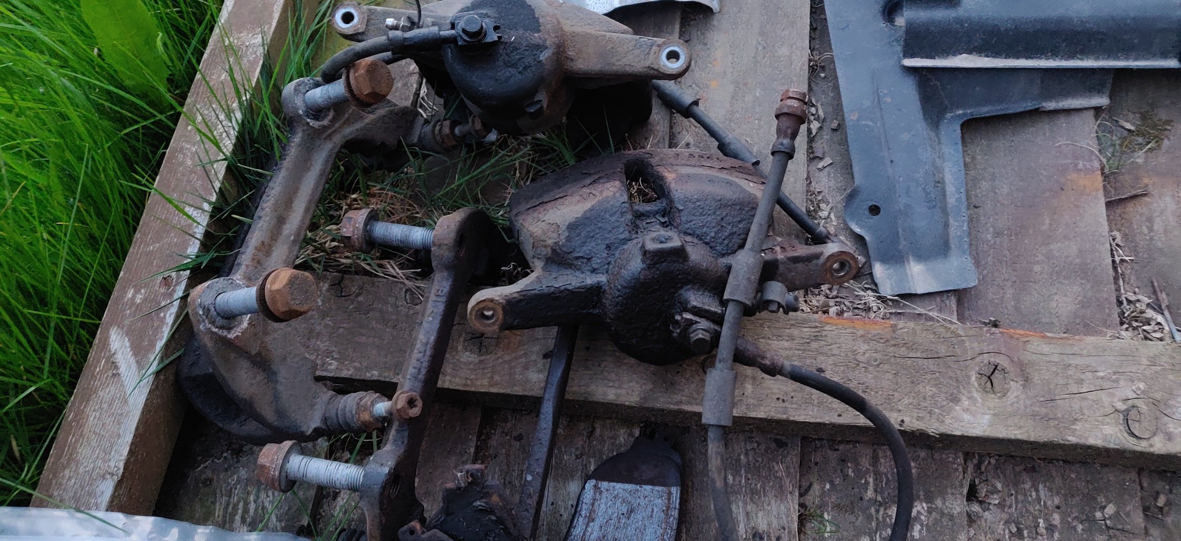

Set of HEL brake hoses. Picked purple for reasons to be revealed later. Given the state of the rear hoses, and the fact the Audi TTS ones need to be a tiny bit longer than the standard ones, meant this was a decent chance for fancy braided ones. These were from Progressive Parts at £108.
So whilst the calipers were sat there, with these shiny bits alongside, the general grottiness of the calipers meant this was probably the best time to get them refurbed and rebuilt, and I guess be repainted before they were fitted.
So dropped them off the Brake Caliper Specialists at Long Eaton, and a week later:

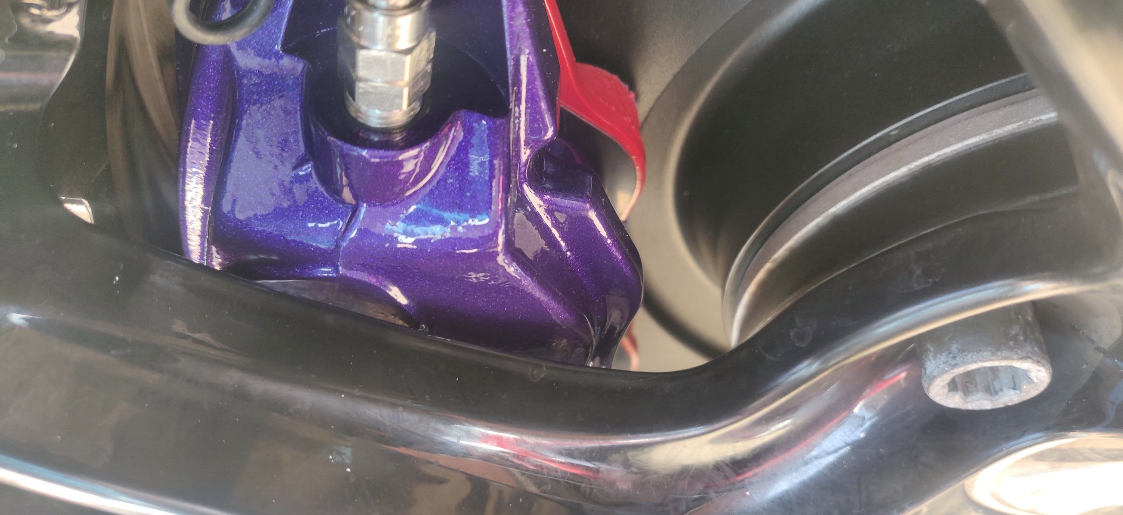

So all in purple. Bit much perhaps, but all looking nice and fresh. If the calipers were to stick after this, I'll put the car into a ditch or something.
Divert your eyes: this cost £697, where £50 was added because the pistons in the rear calipers were buggered and needed replacing. The TTS calipers are using the same pistons originally, shame they weren't spruced up, but hey ho. They'll probably get dirty quickish once actually used.
In spare moments, the calipers were all fitted up, electronic parking brake and stuff like that, in addition to:

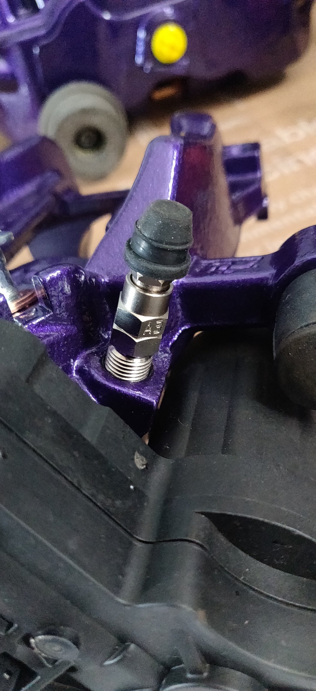

Stahlbus bleeders have been fitted throughout. The rears have the bleed screw in frankly a stupid place, difficult to get any spanners in there. So the idea is that the Stahlbus bleeders stick out a bit more due to it being two separate pieces, so an even longer one means it sticks out even prouder.
Hopefully this makes future bleeding even easier.
Annoyingly, the TTS caliper does 2 bleeders each, and these bleeders are not cheap! The rears are M10 x 20mm lengths at £52.31 and the fronts are M10 x 16mm lengths at £96.19!

Yesterday, the left pad carrier bolts were tight as buggery. I think it might have been possible if the car was lifted off the ground sufficiently enough to get maybe a couple of pipes on a wrench to get enough leverage.
Another attempt early in the morning was no better, so went absolutely mad. Do not try this at home:
So yeah, very drastic measures, but luckily nothing else was hurt in the process. Would not have been this destructive if another replacement wasn't at hand for sure!
I imagine the reason the bolts were stuck was similar to the front struts:
Bits of aluminium corrosion, which presumably held the bolts in tighter than normal.
So next step is to remove the old calipers.

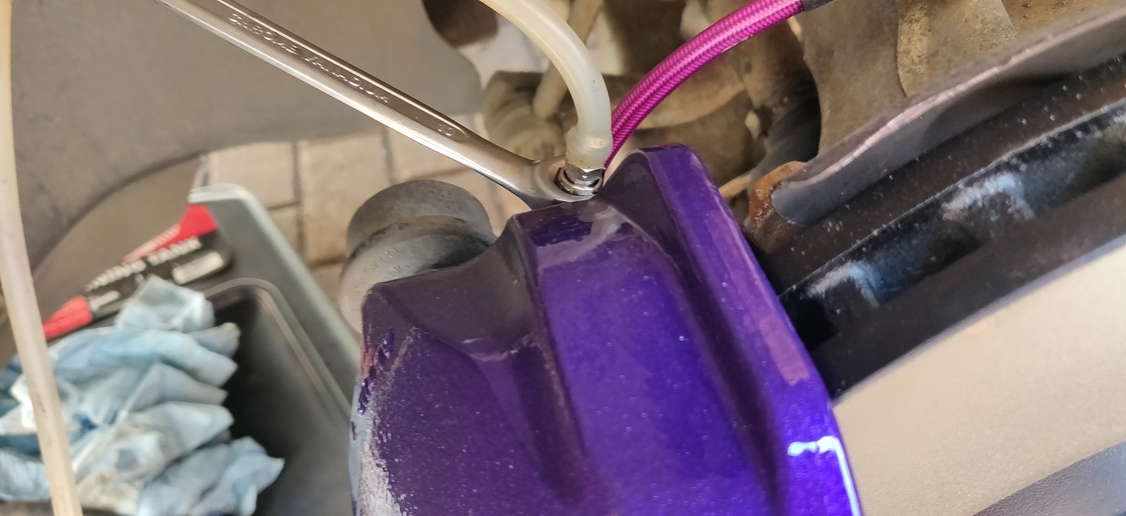

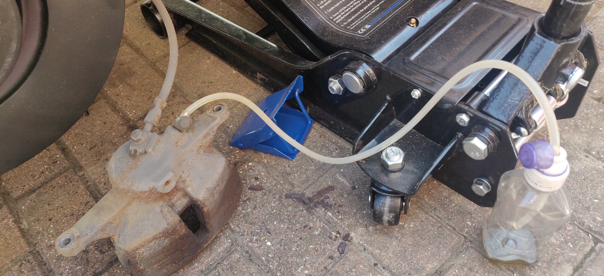

So in goes my trusty bleed hose into a water bottle, and the bleeder loosened:

So with that done, got an impact wrench on the banjo bolts to get them loose, would have probably been awkward otherwise as the calipers are just dangling freely:

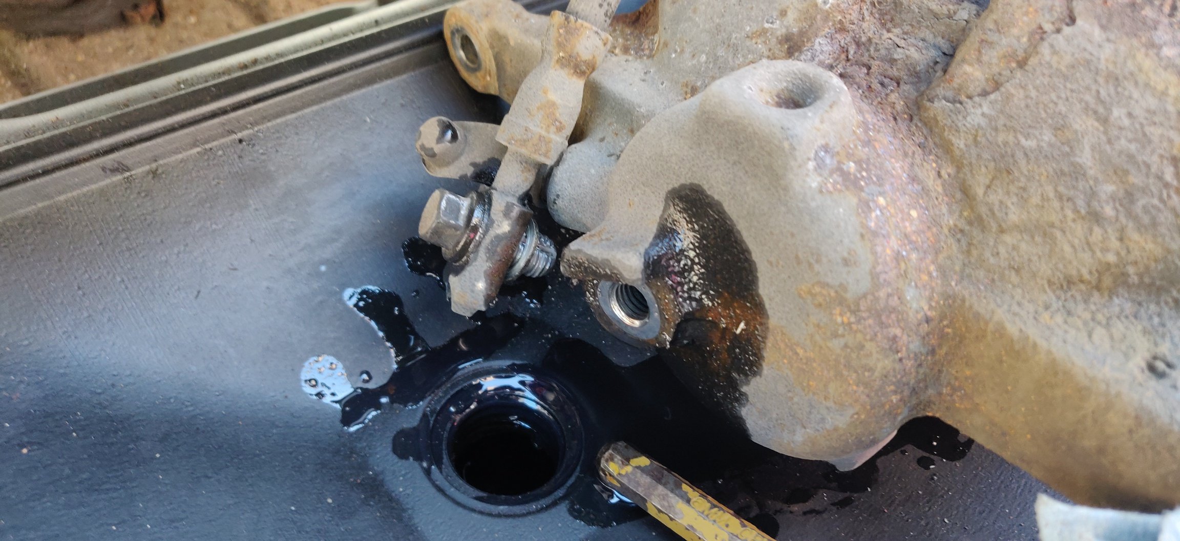

Then just unscrew the bolts and have something underneath to catch excess brake fluid:
This is the unchanged right side brake hose, you'll have seen this before.
The left side hose has already been replaced before, so I know it's been greased up and should be easy to undo. The right was an unknown.
So first step was to remove the hose clip:
Which probably if anything went exactly how I thought it would:
Not the end of the world, but just a tiny bit fiddly with a hammer and chisel to get that stubborn bit out.
With that out, and applying some fire around the union as part of mentally preparing for this, went at it, 11mm union at the bottom and a 17mm spanner around the top:
In a non-salty world, the brake hose at the top would be held whilst the brake union at the bottom would be loosened, and that turned until it came free.
Over in the UK though, it's the opposite, as there's no way the union would not have seized to the pipe, which this one has. It's a case of doing both until it started to loosen, then holding the bottom union in place whilst the hose at the top is undone.
I was then met with:
Looks like a copper pipe. So this tells me a repair around here was done before. I'd be very interested to see how that was done, as the pipe run disappears around the fuel tanks and subframe. Shame they didn't put a dab of grease between the union and pipe though, as that would have prevented the seizing.
Anyways, repeated this on the other side so the old hoses are now out. Next step was give the wheel bearings a quick clean:
Used the angle grinder again, with an abrasive disc, which seems to do a fairly decent job without looking like its ruining things.
The right wheel bearing face looked a lot rougher than the left:
So took a little longer to clean up:
Not sure what the green tint is there, camera must be on the blink.

The brake hoses for now are just twisted onto the unions, with a dab of copper grease on the union threads:
Did them hand tight then snugged a little with the 17mm spanner. It looks like I've lucked out in terms of the orientation of the hoses, as they are almost dead on to where they would need to be for the caliper. That's usually why the union is the one that turns, as the hoses should be put in place (with clips) first.

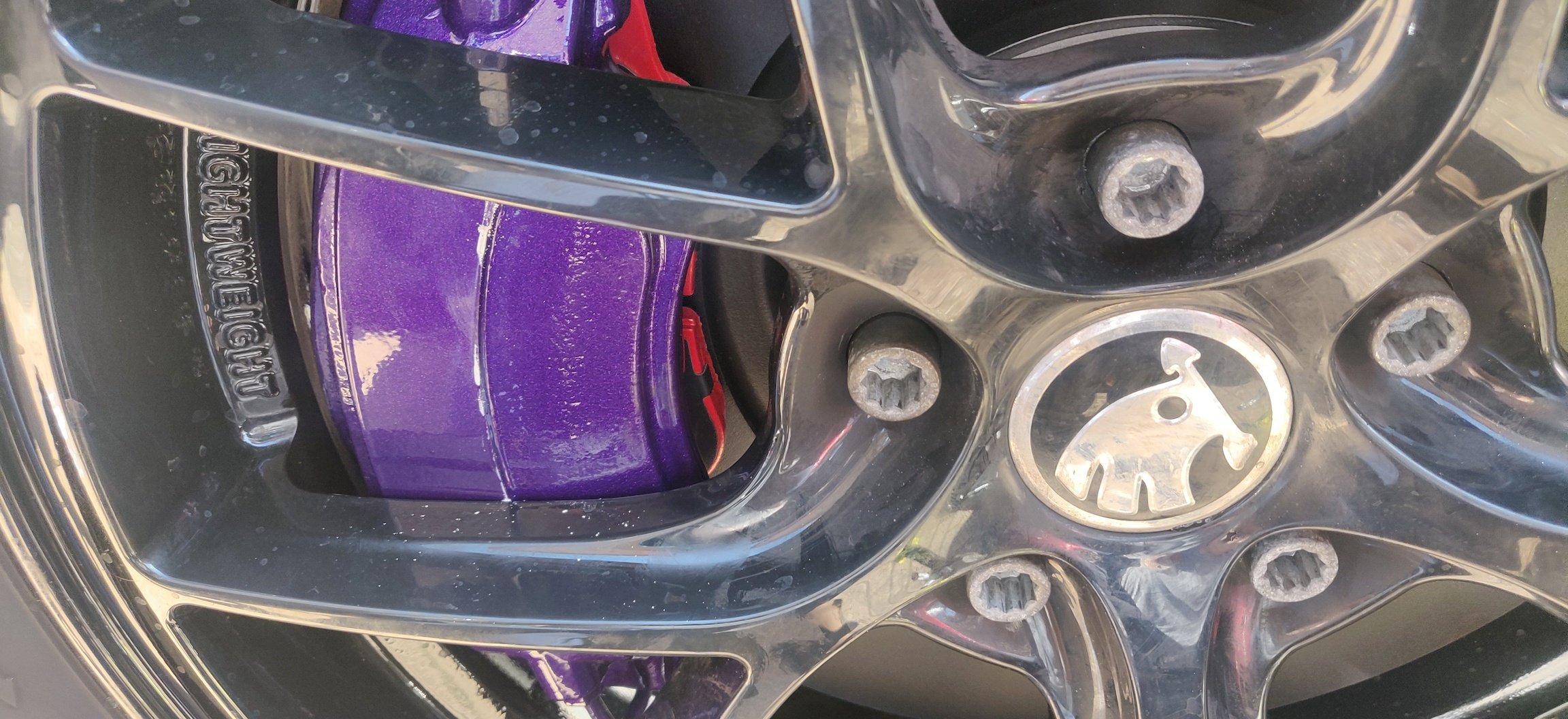

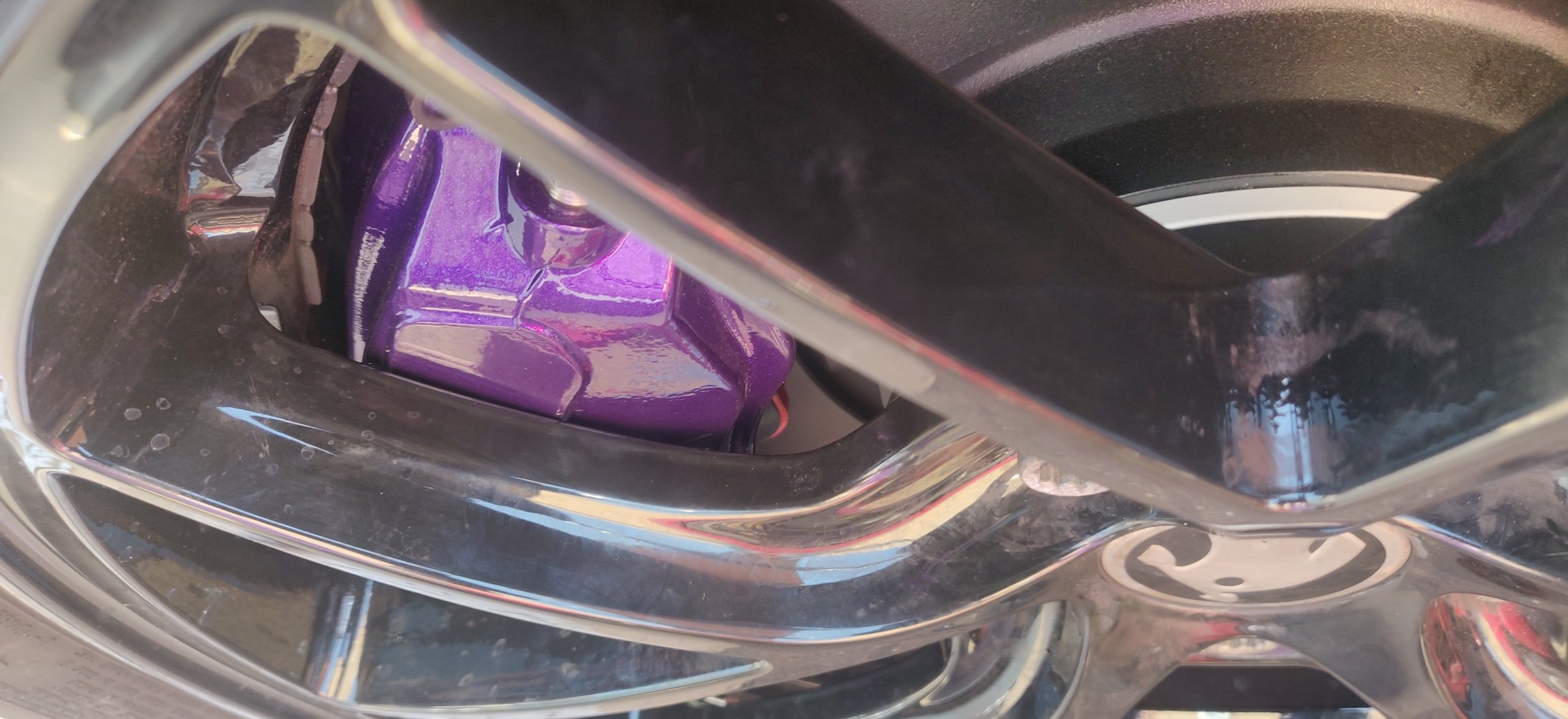

So it looks like the 17" wheels fit:
But unfortunately:
The caliper fouls on the face of the wheel.
Amusingly these wheels are ET40, the most I could get. With some checking on willtheyfit.com when I was researching wheels, the site says:
The outer rim will poke out 2.3mm less than before.
Which looks to almost be what I appear to be missing to clear the brakes. I wondered if the 19" wheels would have been, then realised I've sold those.
The dreaded TTY bolts. Even getting them to 90Nm was a hassle because of access and just generally being in uncomfortable positions.
Used a sharpie to mark at the 12 o clock position, so the target is 3 o clock.
The following is more for my future reference, because I'll need to do this again sadly when I decide to tackle the wheel bearings and shields (as the pad carrier will need removing and refitting again.
The right driver side was easier, where the bottom had the M14 bolt, with an extension, then the breaker bar. It then goes from the floor and essentially bench pressed upwards until no more space and repeat.
The top doesn't need the extension:
With it being to be done next to the suspension bit (Ford called it the blade when it came up with it, I think for the original Focus).
The left passenger side was a bit more difficult:
Ultimately still the same extension and breaker bar, but with it going downwards, it wasn't exactly graceful to do. Probably looked daft if someone was to look on.
The top was done but with a ratchet and pipe on, but this time on the other side of the blade suspension arm, as otherwise the fuel tank was blocking the range of movement. More fiddly bit had enough purchase in the valley between tank and sill.
More not-so-graceful grunting and groaning:
Probably all 85-95 degrees probably, not the most pleasant of experiences. I do hate when car manufacturers put their rear calipers towards the front of the car instead of the back, as you're at the mercy of the gap between wheel arch and suspension with not enough free space to do stuff like this.

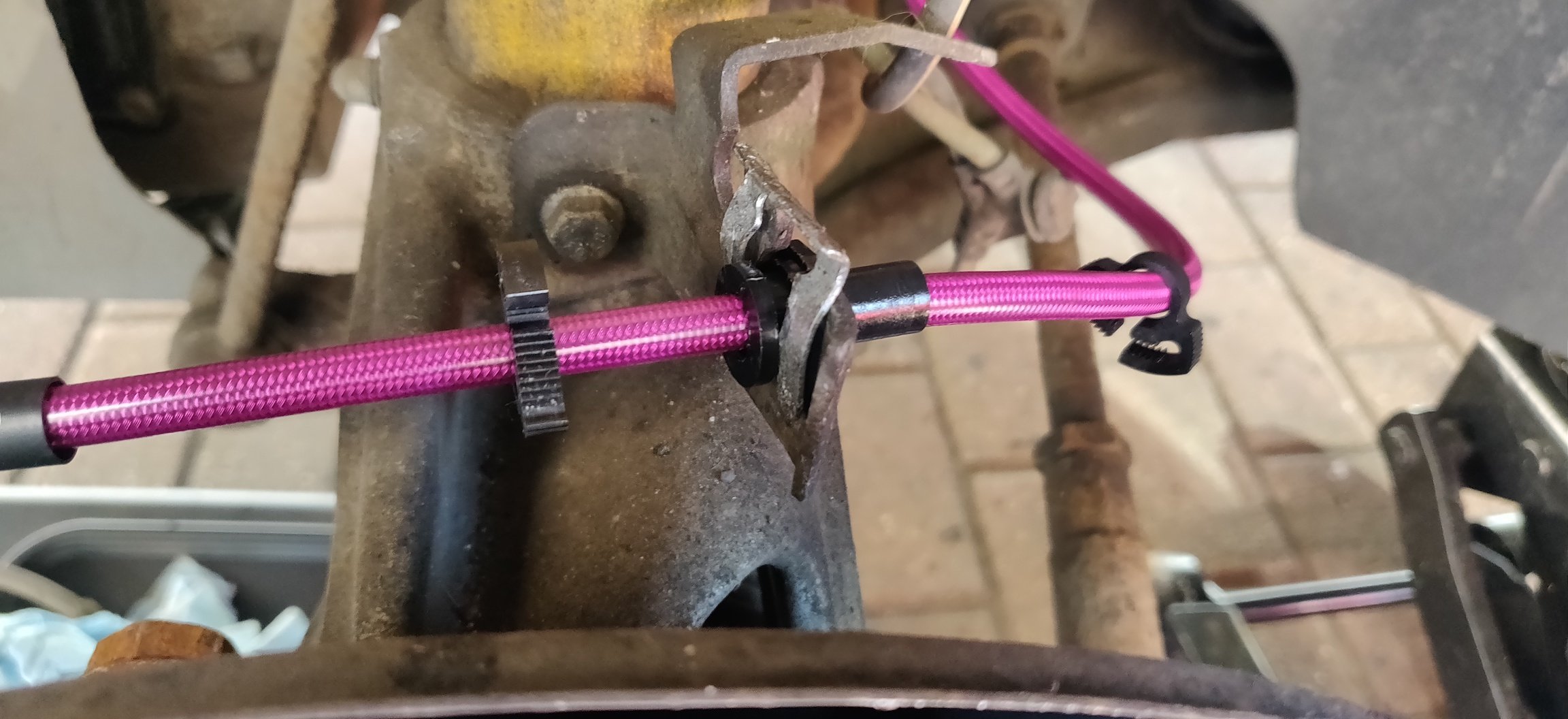

Anyways, a mental checklist and almost forgot:
Clips for the brake pipe and braided hoses. This was more of a faff than I suspected, more because the caliper and brake discs being installed made access too difficult for a hammer and chisel to thwack it in.
I ended up using the Knipex pliers to close it into place, with the rear of the braided hose connector as leverage. The clip clicks into place and can then be twisted into the appropriate orientation (until rust then solidifies it into place).

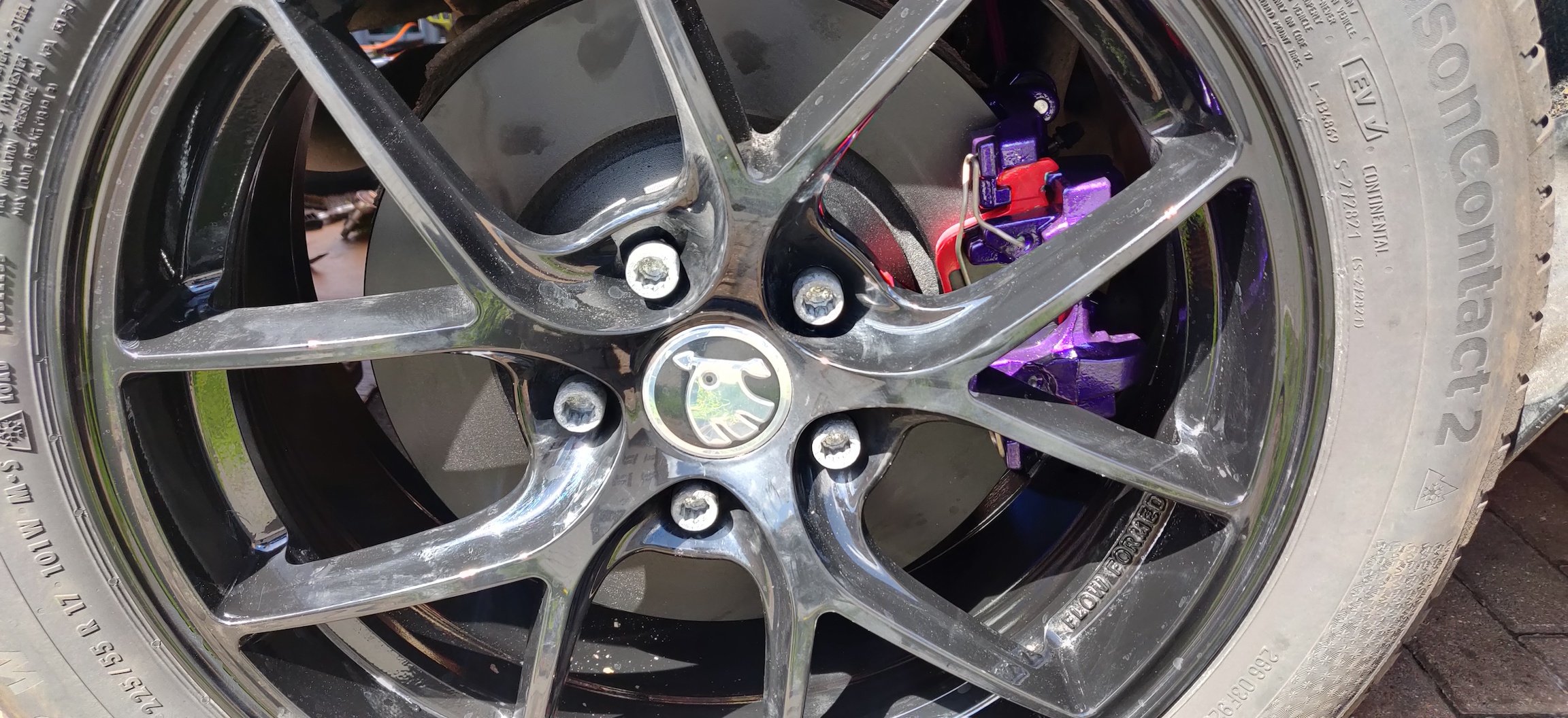

Then dry fitted the wheels:
I feel the reason the left wheel was stuck was because the brake pedal was applied before the wheels were attached. The brake discs on the rear can be removed without the pad carrier, but it appears that the brake disc retaining screw isn't enough to keep the brake disc flat on the hub. So I reckon when I pressed the brake pedal to get the pistons out, the brakes then pushed the disc at a slightly weird angle, then we proceeded to drive to ages.
That's the hope anyway, so the plan is to have all the wheels fitted before pushing that pedal. I guess once all the braided hoses are in though, there's probably too much air in the system, so probably should do an initial bleed. I'll sort that out once the fronts are sorted.
Did the same as yesterday for the front right brakes, so disassembled the caliper, carrier and removed the brake disc.
I noticed on this side that the brake disc retaining screw still had remains that were slightly proud, so went at it with fire for about 30 seconds:
Then got the Knipex pliers out:
Minor victory:

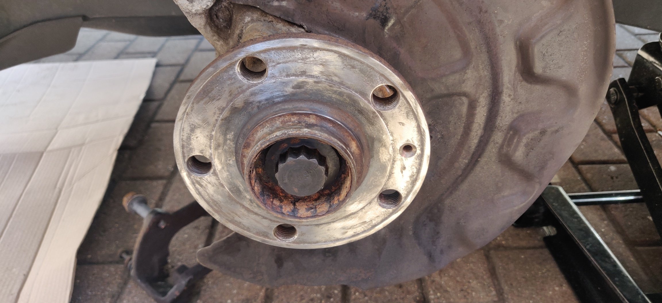

So back out, and gave the wheel bearing face a quick cleanup like the rears:

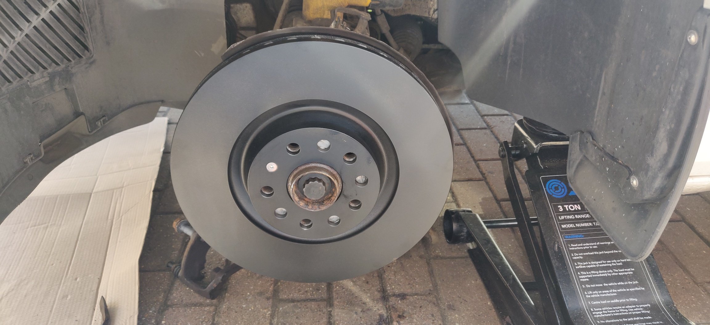

Then coated the face with a thin layer of corrosion block grease, before lugging this thing on:
Before this, got the retaining screw, gave it loads of copper grease and then blasted it through the hub with the impact wrench in and out to clean out the threads, before reapplying more copper grease and then using it to hold the brake disc on. Not bothering with torque until we're actually finished.

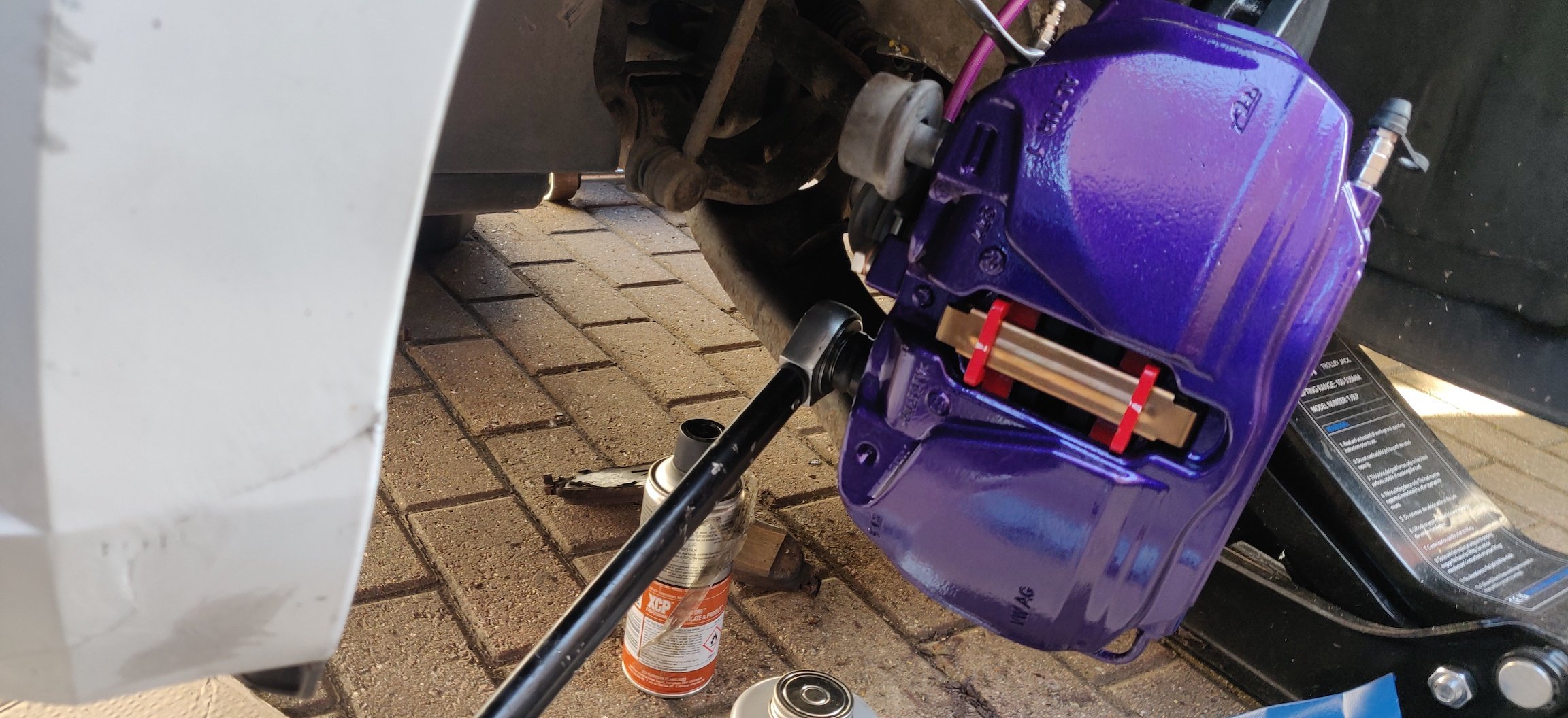

So got the left side caliper out and dry fitted it with the old bolts for now:
Ready for trying out whether the spacers are correct.

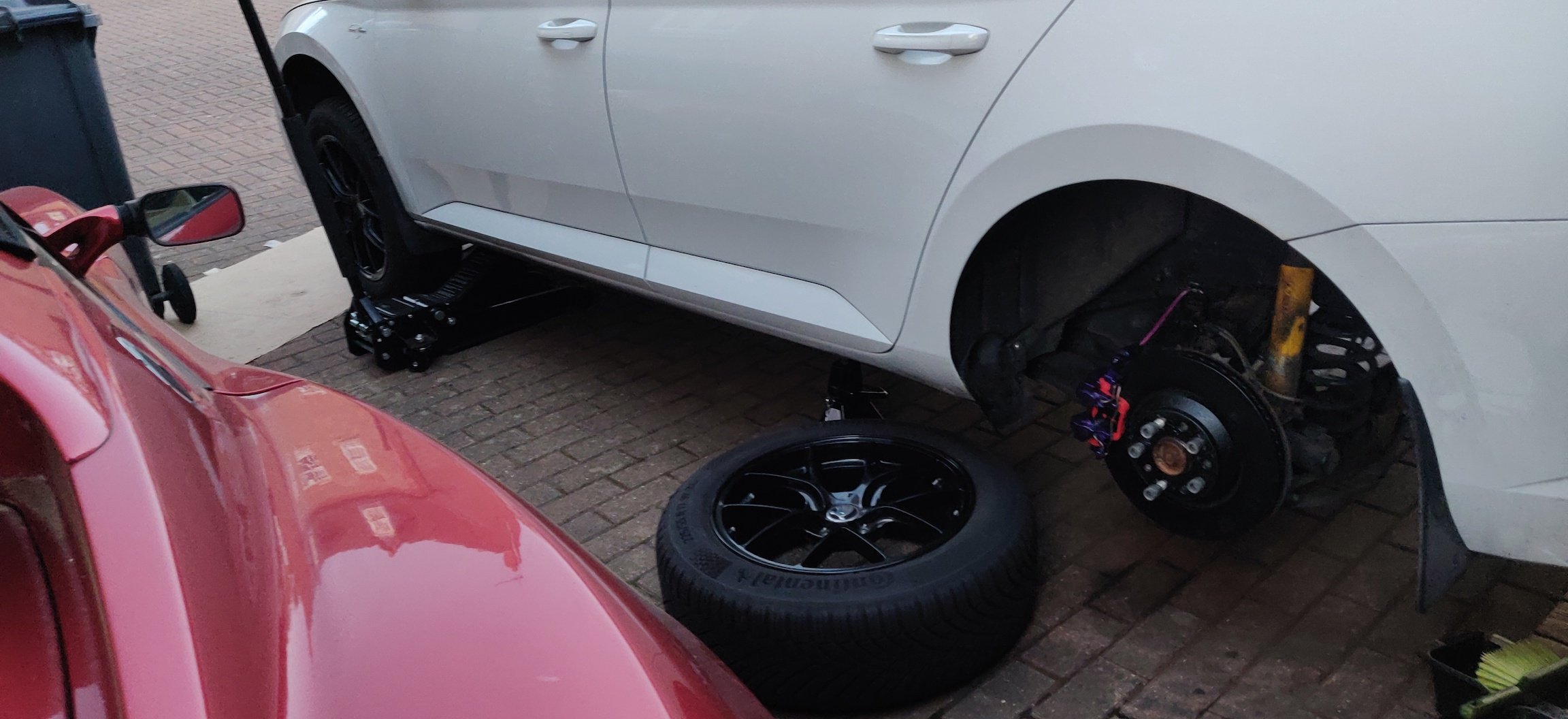

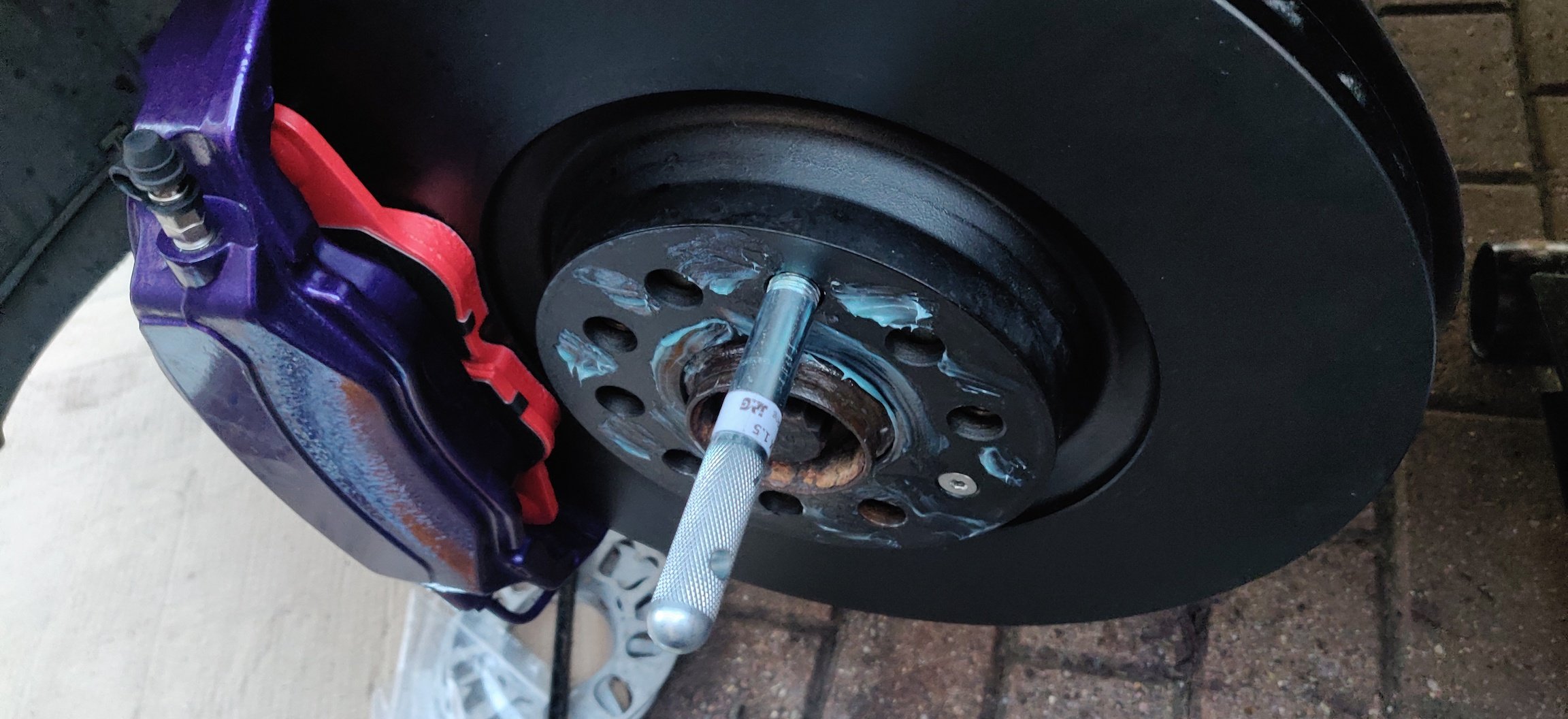

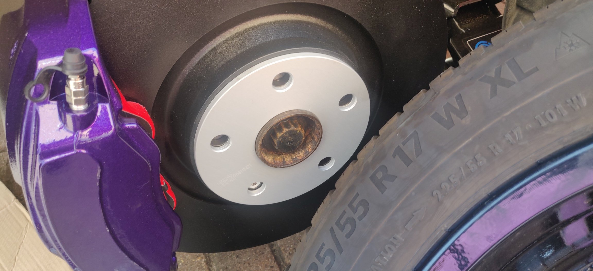

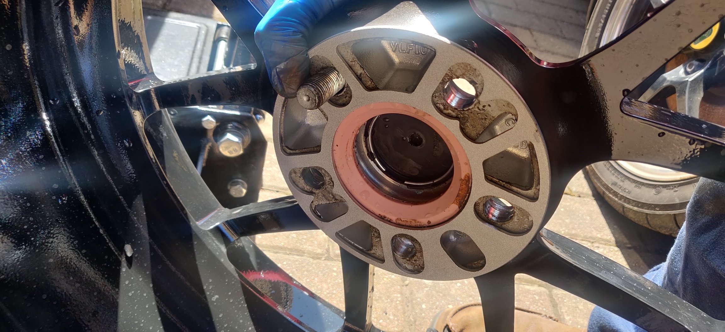

Because the car's not Japanese, I can't just slap the wheel spacer onto the brake and then the wheel (until I git wheel bolts, of course), so had to use a couple of bolts and just...hold onto it:
Then try and plonk onto the hub.

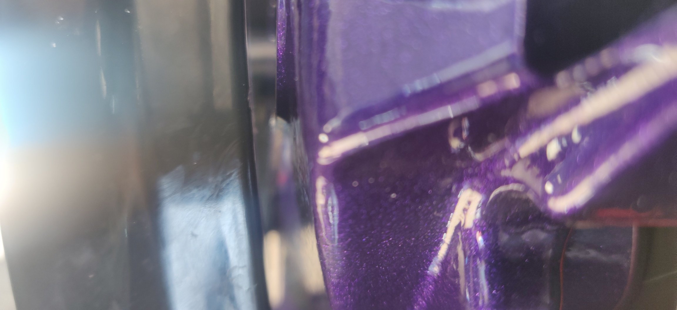

Wheel wasn't going on, so at 3mm, was still fouling:
So off with the wheel, and on with the 5mm:
Sadly still fouls, and worse:

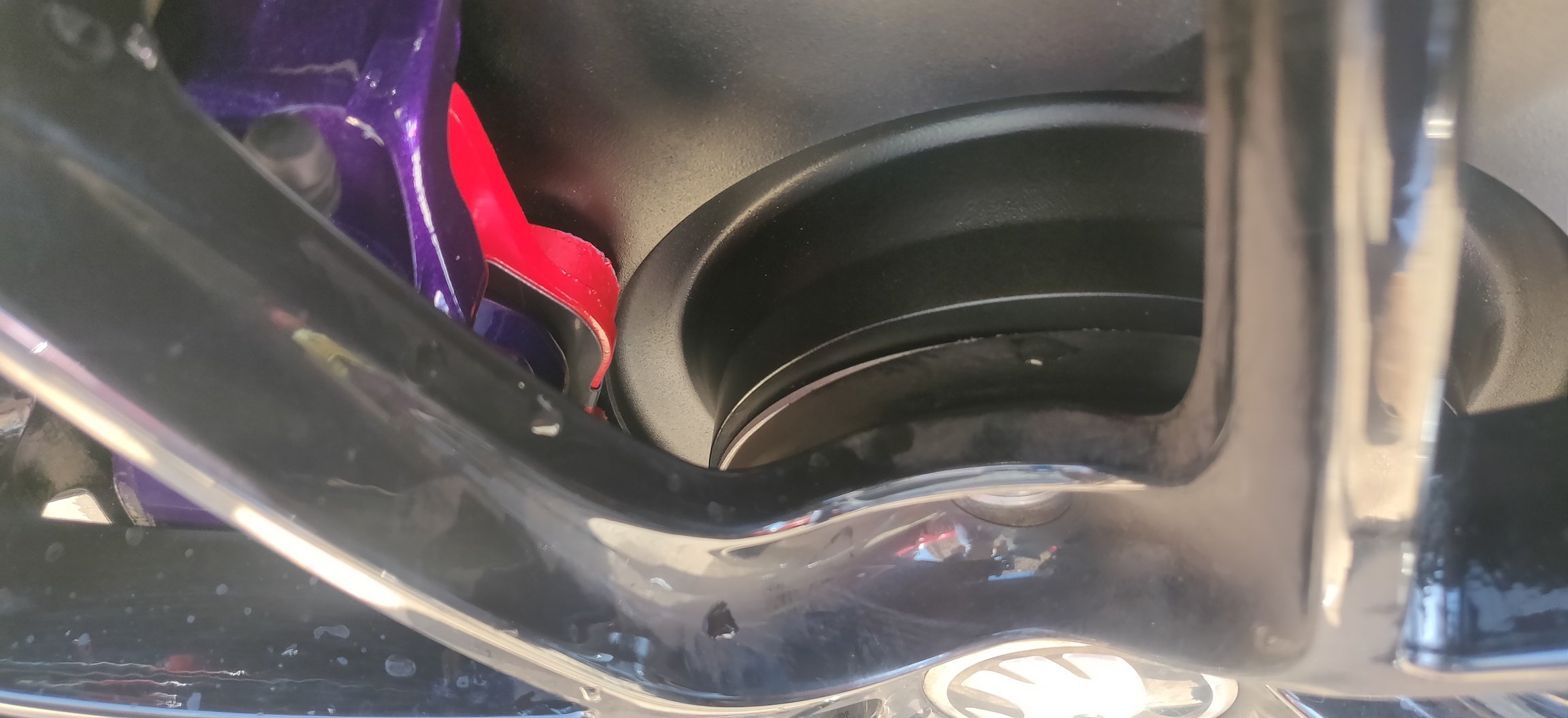

Left a few scuffs whilst turning. Not the end of the world, but a bit annoying as they're freshly painted. I suppose If I was reckless, I could just get the wheel to scrape off what paint it needed to.
So sod's law, it implies 6mm is probably the required spacer. With both spacers in place:
It's fine. So I guess I'll try with a 6mm spacer, and I guess if I'm super unlucky and it needs to be 6.5mm or something, then I guess a 7mm!

Looking at the fronts, in order to change the wheel bearings, it looks like the driveshaft will need to be clear of the hub, as there's no way the top can be accessed from just looking at it.
I'm hoping that means just the ball joint can be undone and that would be enough, but I'll need to mentally prepare for the possibility of the strut bolts being involved too, which'll mean new bolts...

Should try a couple of these things for alignment ( right first time) when changing/ refitting wheels:
16 minutes ago, Shuggyboatsuperb said:
Still enjoying and learning from reading your work.
I actually had a couple of these from my time with the wife's Ibiza, I'll need to see if I can find them!
Great work and I like a lot your wayto describe work! I admire your tenacity, compliments!
The "pin" thing should be part of the toolbox when the car is new, actually all my former Audi cars had one, and I got some every time I was going to the breakers, if I see 'em, it has been extremely valuable. It is plastic but holds up well, I broke only one in maybe 100 wheel swaps....
This item, together with the plastic "plier/clip" remover for the plastic caps of the wheel bolts, are really a treasure to have in the car at all times!
I have seen how using normal pliers damages both the cap and worse, the rim!

So on Monday, got these back from the coaters:
Replacement brake shields as per the earlier posts, where presumably they blasted off the original coating and applied Cerakote Blackout. I'll probably still give them a spray of something (especially the rears).
One could argue that the fronts being aluminium means this is overkill, but the rest of the bits in the pic above is for a Honda Insight, which also used aluminium brake shields, which now don't exist, mine being corroded to buggery and one side completely missing before I got to it. Honda don't make those parts anymore so want to see if get these shields to just last a tiny bit longer.
So those are ready for when I do the bearings, probably some time in the summer/autumn assuming nothing untoward happens.

These also arrived:
Hopefully replacement connectors for the electric parking brake. Cheapest I could find them was £13.28 and from, well, the pic plugs the site.
The connectors having wire tails already inserted probably means I can then find the appropriate terminal extractor to remove them and then do the same on the actual connectors. Hopefully.
So off to double check the spacer is ok:
Because they're not universal, they can be plonked straight onto the hub, I guess eventually I'll get one of those alignment pins.
Then the wheel on:
Skin of the teeth. Reminds me of the E55 AMG we were SO close to getting instead of this, with its paper thin clearance of caliper to wheel, which to me is the correct wheel size.
So I guess it's onto the brake lines before this is all sorted, but back to work...

So yesterday was time to tackle those brake hoses.
Got the brake bleeding bottle onto one of the calipers:
Loosened the bleed screw and reinstalled the brake pedal hold tool, 60mm.
Tried to move the wiring alongside out of the bracket and out of the way:
Primarily because some fire is involved to see if that loosens the union.
Had some fire proof material which I tried to use around where I would be hitting:
Sorta a cheapy soldering mat I guess. Just something lying around the garage.
Then just got on with it, about 30 seconds, then like the rears, 17mm spanner over the union and 11mm over the flare:
Then it started to loosen. So again like the rears, a case of keeping the flare still and turning the hose instead.
Before that, buzzed the banjo bolt off the caliper:
So the brake hose can turn without a lump of metal attached to the end:
So then reverse of removal. The HEL brake hoses have the bit to attach it to the bracket on the hub, with a couple of clamps as it were, to essentially go on the hose to restrict movement, as the bit on the bracket is free moving, presumably to allow for quicker construction of the brake hose.
Anyways, added a dab of copper grease on the brake flare, then twisted the hose onto the flare:
Small nip with the 17mm spanner and then to double check the route to the caliper:
Seems to be ok, again, lucked out with the orientation possibly.
So the workshop manual for the TTS calipers state 45Nm for the banjo bolt, but the HEL booklet states a range between 20-33Nm. I’m presuming this is due to them being stainless, and not wanting to repeat what I did with the Haldex bolts, I’ve nipped them up to 32Nm. Didn't want to wiggle down there to get behind the caliper for a pic.
Then just wiggled the hose a bit and checked for kinks alongside steering lock to lock, then used the Knipex pliers to tighten up the clamps:
So that’s that. The driver side also contains the wiring for the pad wear, so installed that:
I don’t think I tallied up the replacement pad wear sensor, it was part 8S0 615 121 A and cost £19.49.
Just a case of clipping that onto the inner pad and then to the connector. Although initially I tried putting it in the wrong way. It looks like the way the sensor works is essentially sacrificial: there's a wire that sits a little proud of the mark on the pads that suggest replacement time, so it looks like once the brake pads wear through that wire completely, the warning light(s) come on.

For the Stahlbus bleeders, they needed a bit more turning than normal bleeders, a full turn, before it looked like a tiny bit more before fluid started coming out.
Once the initial rough job was done, pumped the pedals, then randomly tightened up the caliper bolts:
Like last time, because they're beastly 200Nm jobbies, had to put the calipers on lock for clearance for the big torque wrench.
Yup, got the alignment tool so might as well. Was £7.40. It does add a tiny bit of time to the proceedings, but I'd imagine if you had a fancy car, these are very useful to stop alloys from getting damaged on the way of fitting or removing (because German car buyers love their massive and heavy alloys).

Se err:
If anyone wants some 110k+ miles, 9 year old calipers, get in touch! They're still usable I reckon, certainly too good for scrap, but also probably not worth much in the grand scheme of things as they need a cleanup (to say the least).

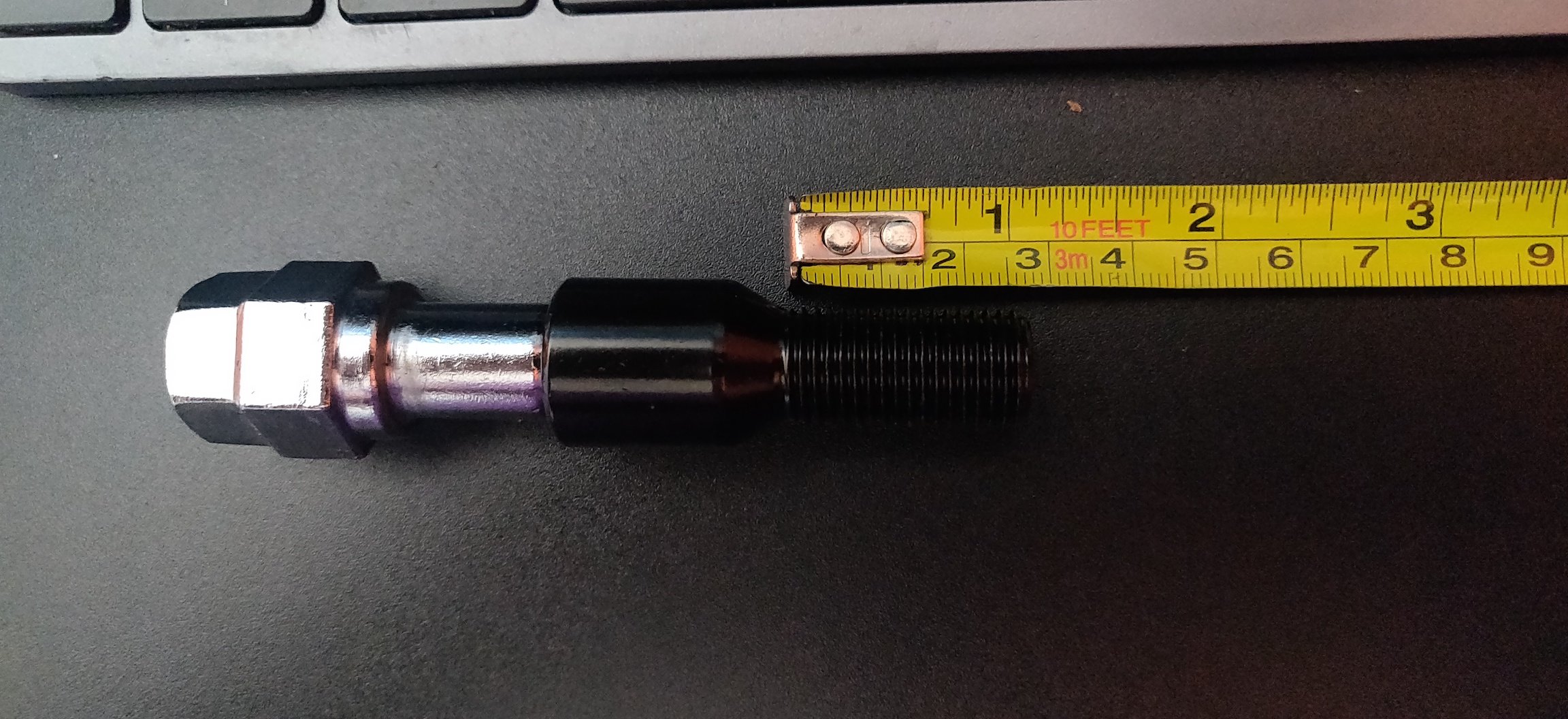

So some potential replacement wheel bolts for the fronts arrived this morning, but unfortunately:
They're only 28mm in length thread wise. The ones I got with the alloys are 30mm, so these were very much the wrong ones. A typo on their eBay ad unfortunately, so being sent back and another order made.

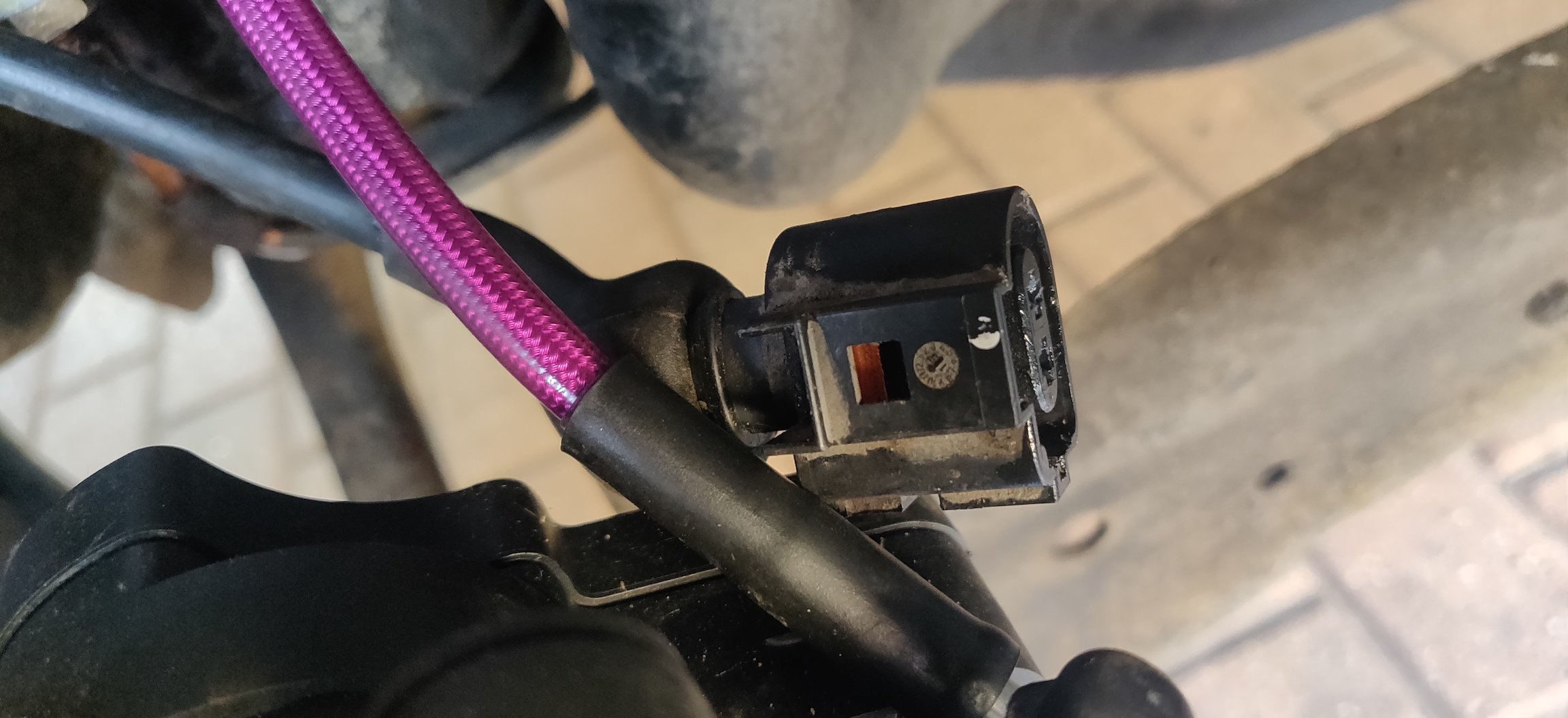

Only other thing left to do was the electronic parking brake connectors and replacing the damaged ones. So after some Googling eventually found https://www.youtube.com/watch?v=oDWKcAiLJ_Y which pretty much summed it up nicely.
So essentially, there's a locking tab, grey in colour:
Got a precision screwdriver with a flat head and just needs a small tug to get it accessible from the gap in the side:
Once free, the terminals are in a position to be removed. So went through the extractors to find a possible suitable one:
I actually found it just as effective to use two thin flat ones, which go into the "top" and "bottom" of the connectors per se:
With two flat ones across, it catches onto the tabs better, and once in, you just tug at the wires and it should come out of the connector.
Forgot to take pictures of the removed terminals, not that important!
So essentially a case of doing the same steps on the car:
This is the damaged driver side, needed to disconnect the ABS sensor to get enough leeway and space to get at it. Probably another case of being much easier without a caliper in the way!
This was a bit fiddly and dirty, so didn't take pictures along the way. First obstacle was to see if that rubber boot bit was going to be an obstacle. It was tight, but ultimately looks like the connector is just forced into the rubber boot. So once the locking tab was removed, the terminal extractors were used, and one at a time, some wiggling of the connector then frees one terminal, and then do the other:
Then with the new connector, placed it in line with the terminals, and pushed it into the connector simultaneously, waiting for a click for both:
That's pretty much it. Almost forgot to insert the locking tab:
Put a dab of silicone grease, reconnect to the electronic hand brake, and then repeat for the other side.
So the remains of the old ones:
The passenger side was mangled with my pry bar as part of removing it, so both were in need of replacing. You can see the dirt in the connectors, and I presume that's a factor making disconnecting difficult, in addition to just years of exposure making the plastic more brittle. I'd probably factor coil pack connectors as part of service items.
Don't think there's much to remediate it, and I guess in the grand scheme of things, disconnecting the parking brake isn't something that happens often enough to make an effort to sort out.

So they luckily arrived next day:
Some longer tuner bolts, 40mm these ones. I guess technically, the ones I got with the allows were 30mm, so 36mm would have been the exact correct ones. I think I saw 35mm being the closest, but only 40mm ones were in black.
Wanted the black ones so as to not stand out against the black alloys. These were £37.99 from eBay.
No more pics, because removing a wheel bolt and replacing it with these ones isn't really worth it. Torqued up all the wheel bolts to 140Nm and gave it a short test drive.
