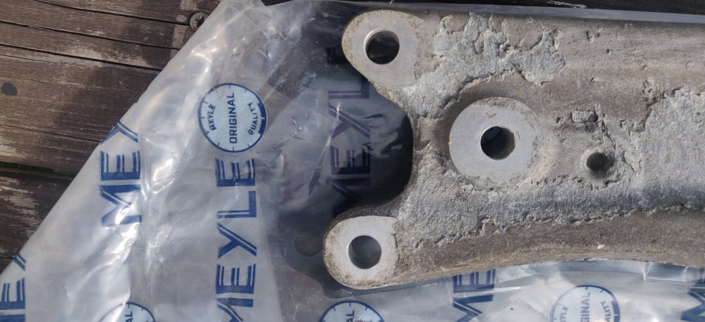

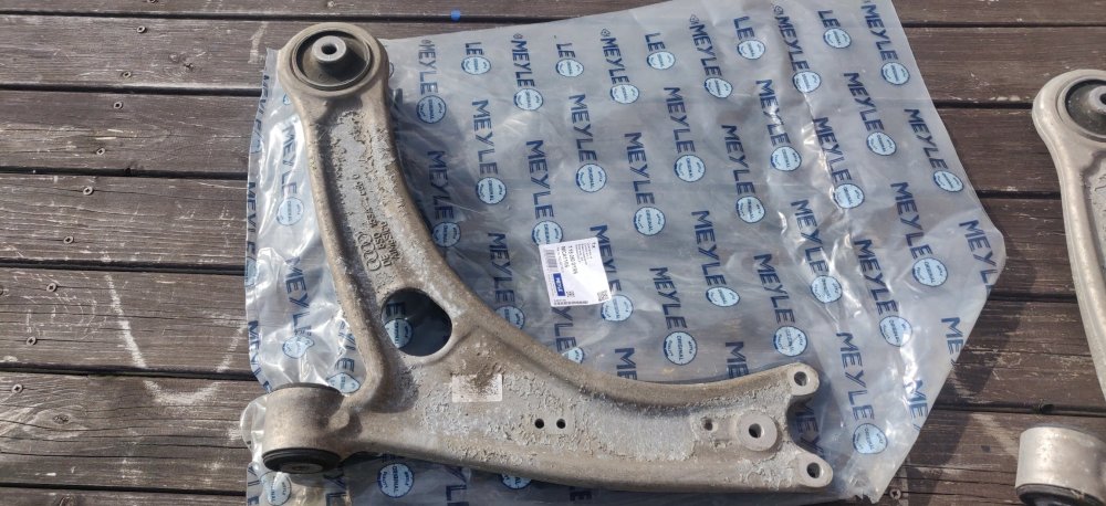

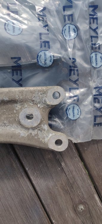

Reason I've been reluctant with aluminium lower arms:
Above is a pic of the aluminium arms that came with the subframe, and some Meyle replacement arms:
They essentially look about a centimetre short? Hence not wanting to bother, as almost all aluminium arms of some sort are for the S3 or Golf and such, so probably a narrower track? Happy to be corrected if Passat/Arteon/Superb variants exist.
Regardless, the Meyle arms were from eBay, bought about a year ago for £69.54.

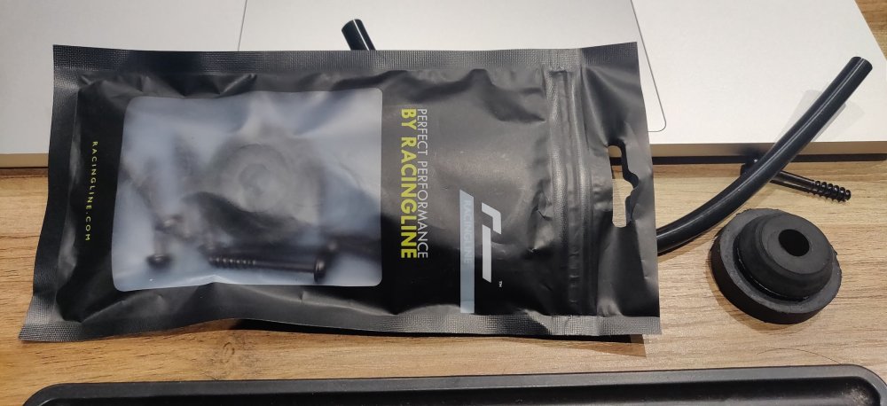

Now for something different. From the R600 install, went online to look for replacement missing bits, and found them:
The part number turns out to be VWR120004, and was from Progressive Parts for £20.35 with delivery. If I knew the part number, could have probably shopped around I guess. However, this was ordered on Thursday evening, so for it to arrive Saturday morning isn't too bad to be honest!

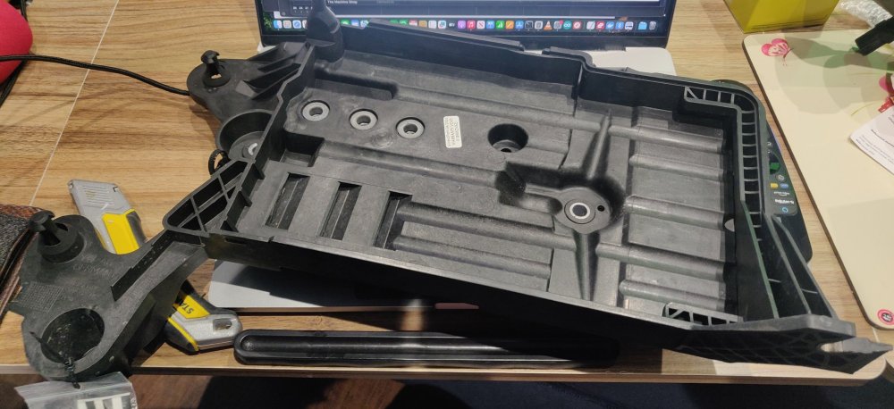

What was a real surprise was:
The battery tray! This was ordered from eBay in the same Thursday evening, with some shopping around and a discount coupon getting it to £16.96. Arrived around mid afternoon, very impressed all round!
Technically not the cheapest on eBay, but honestly, it looks brand new, or is certainly VERY clean!
Wife actually has the car for the weekend, so can't do anything until she's back. I suspect a fiddly job of disconnecting and wiggling wiring harnesses and whatnot to replace this tray and the subsequent fettling of the R600 bits to get the rubber grommets on and all sorted.

Then it was the battery tray. None of it turned out to be as much of a faff as I thought it would be. So negative then positive terminals off, then wiggled the cover off, and then the 13mm bolt for the strap keeping the battery down.
Then pull the battery to the front and hoist it off:
Then got a metal trim clip tool to pry the harness off of the tray, two bits along the front:
Then it's a 10mm nut at the rear:
Then three 10mm bolts, two in the tray, and one off to the front right, which needs a tiny bit more dexterity or longer extensions due to the wiring in the way:
Once all out, the old tray can be wiggled and eventually come free:
The nut on the rear has a weird rubber bit that sticks out, I guess some random additional vibration dampening, nothing more wiggling wouldn't sort out.
Took the opportunity to give the area a wipe and spray of XCP, whilst the area was easy to get to.
Then it's the reverse to wiggle the new tray in:
Had to use some force and wiggling to get the bolt holes to align up, but got there eventually. The three bolts and nuts were tightened to 9Nm as per the workshop manual.
Hoisted the battery in, pushed it back so it slides under a lip on the rear of the battery tray, before putting the bracket and bolt in, to 15Nm:
Slide the battery cover over and on, then greased the battery terminals, and tightened to 6Nm:
That's that, the whirring and buzzing of the car coming back to life should be audible. So now its the R600 intake again:
Like last time, some wiggling to get it into place, but this time, pushing it into the plastic bits on the replacement battery tray. Should go in without much bother and won't be going anywhere.
The filter is then on, clamp tightened up, and the new screws that came with the replacement grommets are used to tighten the top cover down:
Gave it a spritz of rubber and vinyl care and wiped down.
I'll probably do an oil change in the next couple of weeks, but that's not really post worthy. Fingers crossed, the front subframe is the next big job and that'll be nearer the end of summer.
LCA for Golf, A3,S3 etc etc r the wrong size for the Superb.
As u saw, it's short.
Unlike other suspension components - LCAs r not compatible with the mk3 Superb.
In the diagrams below, u can see L2 is considerably shorter for the Golf, compared to Superb.
The rest of the measurements r similar or the same.

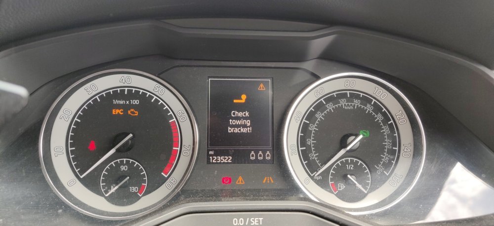

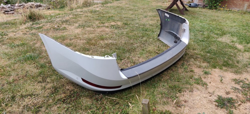

I did encounter a snag once I started test driving though:
Now, this car has one of those fancy towing hooks where you pull a lever type thing in the boot and I guess in real life it then can be pulled out. But it's always been stuck, and up until now, the light on that lever was always green when the lever was returned. This time it was flashing red.
Not sure why, maybe I bumped it loose in the gap in the bumper or something?
Given its a Sunday with nothing else particular planned, decided to just see if there was anything I can do:
So off with the bumper. It was only at this stage that I thought "oh probably should have took more pics", but hey ho!
There's some plastic covers that need a hook type tool to pull off to access some bolts for the rear lights. Those can then be undone and the rear lights removed. This reveals some plastic tabs that the bumper hooks onto. I'm wondering whether the rear lights probably need removing at all, as it only makes that step easier to undo those tabs.
The main screws are about 6 along the bottom of the bumper, and three in the wheel arch with two going through the rear mudflaps, and one above it.
There is also a screw on each side tucked behind the wheel arch at the top of the front of the rear bumper. This is one of those where maybe a Youtube video search would be easier than lots of pics.
Once disconnected the rear parking sensors:
I'm presented with the towing bar front and centre, in all its rusty glory. To be honest, not terrible compared to the other horrors seen over the years.
So essentially, I just improvised from this point. I pulled the lever in the boot a few times to gauge if anything with the cables were at fault, but everything seemed to be ok, based on feeling around the cables for movement.
So I went and took some plusgas and started spraying it at bits that look like moving parts. In the pic above, you can just about see in the centre the main gubbins, and that appears to have a rotating element.
Essentially, I then took a dead blow hammer and just started to whack the towing ball bit a few times, upwards and then downwards.
After then stopping for a drink and a break to let the plus gas soak in a bit more, a few more taps started to make the towing ball move ever so slightly.
So eventually, it started to not only move a few more millimetres, but I was able to then start wiggling. I think I managed to unseize it:
So a random unexpected victory, and the light on the lever goes green. I then proceed to use the lever and move in the closed and open position, and seeing where it was rotating.
Tried to wipe off as much of the plus gas as possible and just went to town with white lithium grease:
So this is what it look likes now, as I forgot to take closeups with the bumper off.
So yeah:
Reverse steps to get the bumper back on, and the towing gubbins are now available! I guess I'll give it a wiggle every now and then and spray some grease wherever I can.
I reckon in retrospect one could probably try this without removing the bumper, although it makes whacking the towing ball downwards a little difficult, which is what made the difference.

Another random thing whilst changing oil a week ago:
The stupid dipstick decided to have one of its prongs snap and fly away!
Not the end of the world really, but decided to source a replacement. Until it turns out there doesn't seem to be many online, and it looks to be £27 new. Maybe I should have driven to a scrapyard and gotten any which would have been sufficient, but decided:
To get one of those aftermarket dipstick handles, in this case, Bevinsee? It's the sort of tat I usually don't go for, but given it was £15.59, decided why not.
Amusingly, the only Youtube video I've seen about how to actually fit this involved someone using a vice to essentially crush the original plastic handle to get to the metallic dipstick underneath.
I don't have a vice, so went overboard:
So put the poor thing under the press, donned my safety glasses, and went to it:20260806 07 Squished.jpg
The handle literally flew off stage left, I don't know where it's gone. Leaving slightly bent metallic remains and the above plastic mess. Just got some pliers to bend it back slightly, and then its inserted into the new dipstick handle.
The world's smallest allen key and grub screws are used to tighten the dipstick to the handle, and some o-rings are put in place, and there we are:
Hopefully I don't jinx it by mentioning whether it'll come loose or whatever, but it'll do. Next time I order anything from lllparts or skoda-parts I'll consider a replacement dipstick.
