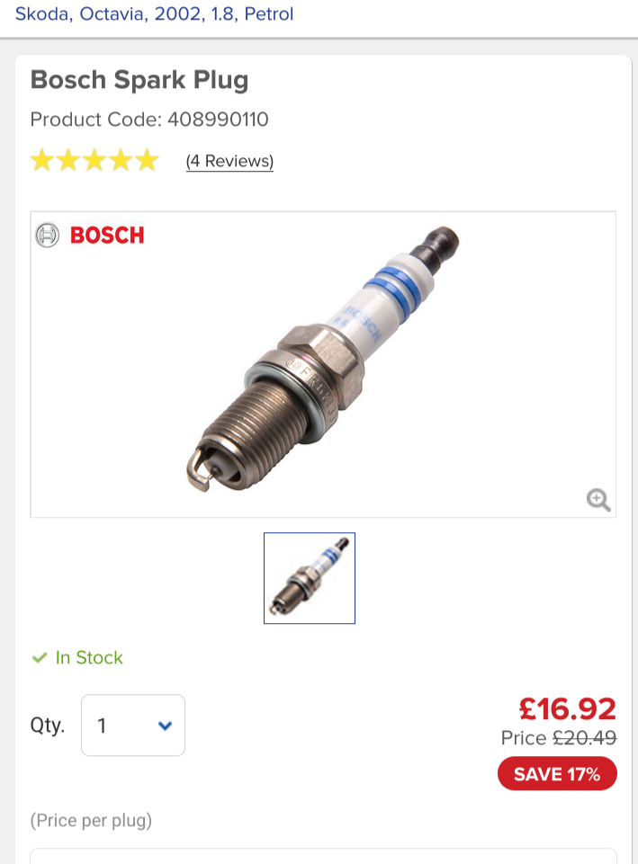

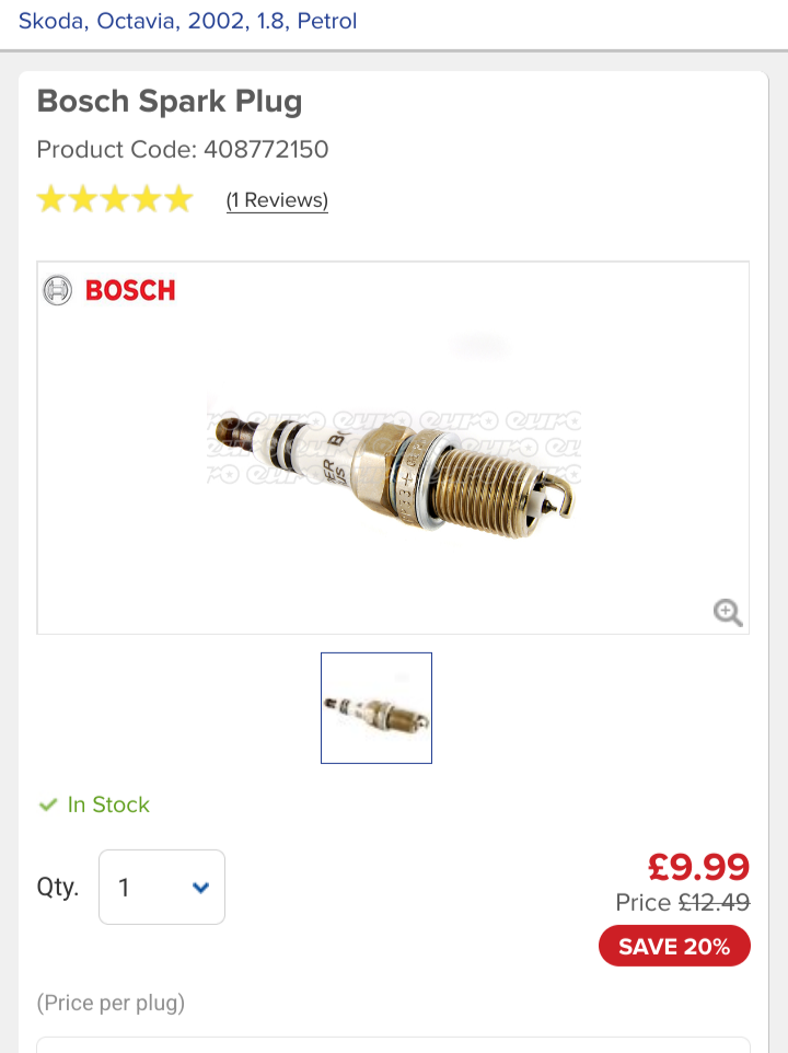

Hi all. Recently bought a vrs with 1.8t auq. I changed the spark plugs and engine oil and then the car seemed to drive as if it had a misfire. Plugged in with autel and nothing misfire related was read. I then changed plugs back to ones fitted and still the same. I then checked all wires and seem to be OK. Next step was to try coil pack. I done this and used a new coil pack and swapped around and still the same issue when driving. Researched the issue and see oil could have had an input, I then drained the oil form a recommended 10w40 to a recommended 5w40. Has anyone got any ideas? Pic below is most recent plug In.

what spark plugs did you use when replacing them? and what was in it?
may need to check the gaps as i seem to recall mapped 1.8Ts needing the gap adjusted, but that may be in specific setups, may be that your map needs it and it hasnt been done..
I used bosch ones that are recommended 0242236571. These were changed back to the original ones in. Bosch super 4s are currently in it fr78 ones.

gap check those plugs..
also i am 99% sure that mapped 1.8T need ngk plugs (with a corrected gap) search that in this sub forum for the exact spec
