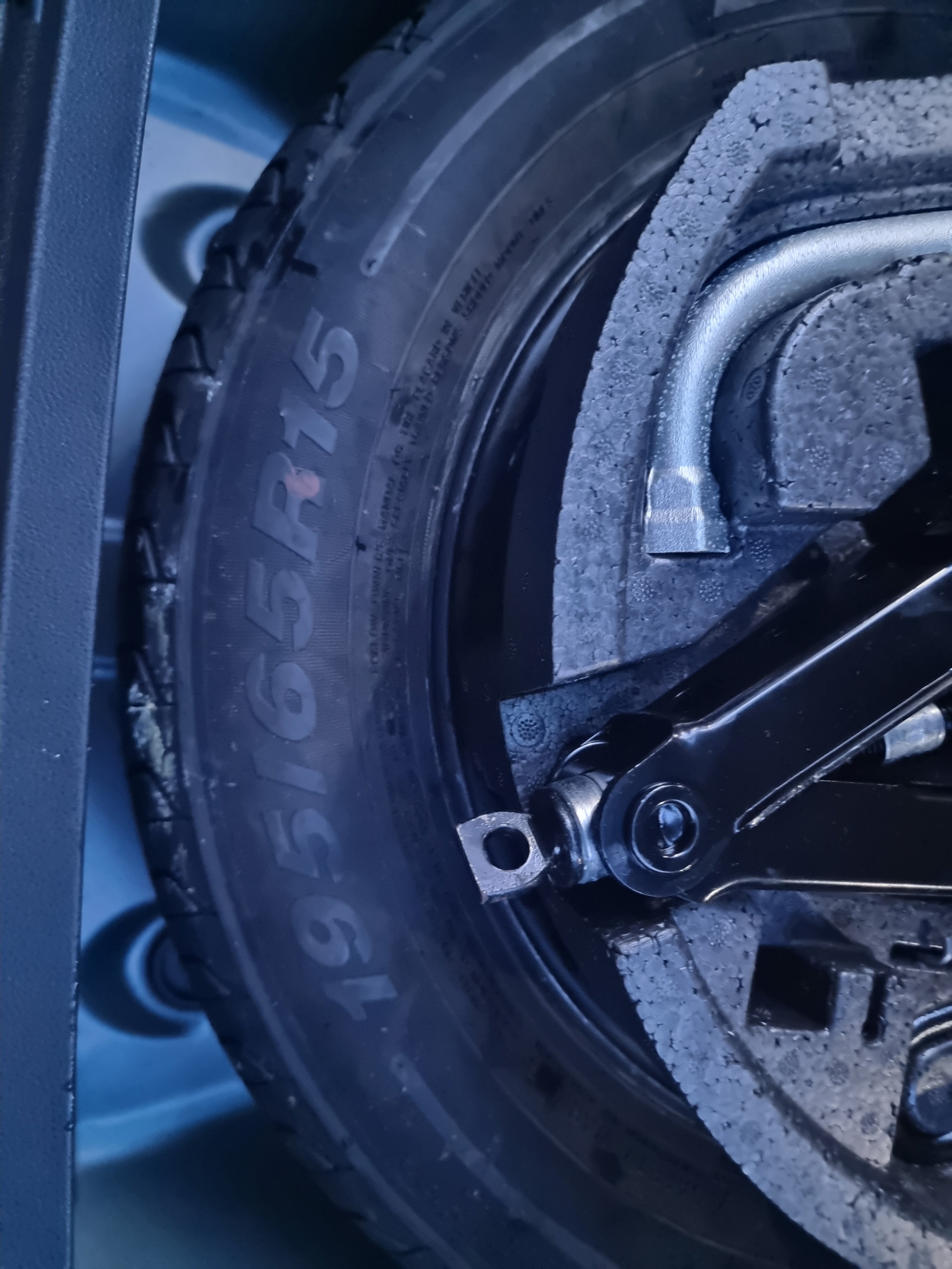

I may have found an 2016 Octavia steel wheel in our works car park. I may have tried it in the boot to see if it fits.... it does.
BUT, whilst the PCD and centre bore are OK and the tyre is about 5% different overall circumference will it work?.. my question is will a 15inch wheel fit over the discs etc?
Has anyone tried it?
Asking for a friend who didn't save it from the car park.20240223_174436.thumb.jpg.c3aa559066ad7a93e72be90e17e213b4.jpg

On the Superb MK3, a 15" rim won't clear the front or rear brake calipers. This is because the smallest brake discs that the Superb MK3 uses is 312x25mm front and 300x12mm rear.
Skoda do supply a 205/55R16 6.5Jx16 ET46 5/112 57.1 spare wheel from an Octavia MK3 for the Superb MK3. However, this is clearly an economy measure and not a very good choice for owners who are a little more discerning than Skoda.
Octavia MK3 205/55R16 6.5Jx16 ET46 5/112 57.1 spare wheel

As you can see in the chart below, the 205/55R16 is a whopping 4.9% smaller than 215/60R16.
Outside diameter of tyre
215/60R16 664.4mm
205/55R16 631.9mm (4.9% smaller outside diameter than 215/60R16)

So back to the car park with the wheel!!! Thank you @Carlston the knowledge I needed. My friend will look for an alternative.

i'm sceptical about 15" disc fitment even on rear axle,
as example, rear calipers of 310mm brake discs on 272/280 are bigger than front calipers of 310mm brake discs on all rest versions,
i haven't measured 298mm rear vs 310 front calipers

Yeah,  i'd read that.  I'm not unhappy fitting a space saver and that will definitely fit in the boot.
The question was whether the 15in would clear the discs.... didn't want to spend of I didn't have to,  that's all.
