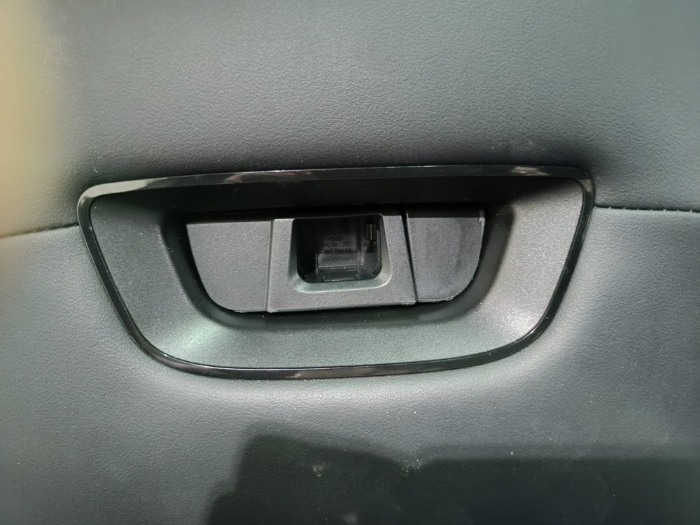

Just thought I’d take a picture of the actual seats to make life easier 🤣

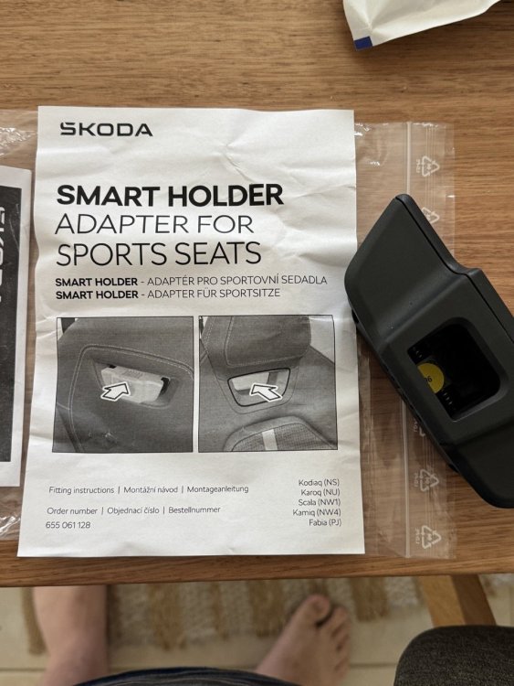

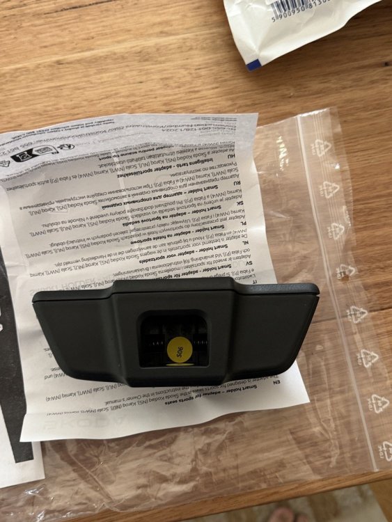

Mine arrived today... It does not fit.
The packaging says on it for Kamiq and Scala.
You can push it into the hole, but it's not deep enough to secure itself, so it will just fall out.
The other issue is that as mentioned in my previous post, is the smart holder slot is upside down.
In summary don't buy the one on the Kopacek store hoping it to fit an Octavia. There must be a seperate part for us, which Kopacek will probably stock when it becomes available.

@aaaaplay well I got the impatient and ended up ordering one. Only had chance to try it out tonight. You’re right it definitely doesn’t fit the Octavia VRS mk4 seats…..so back to the drawing board. So far I’ve tried 3 different devices. All with no luck.
1. Velcro straps (it did work but annoying having to put the tablet into a Velcro case everytime I wanted to use it)
2. A window sucker that went on the side window. Just fell off 😭.
3. The official Skoda Sports seat device which officially does not fit the sports seats 😂

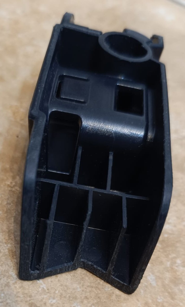

I thought I would share how I succeeded to transform easily the original smart holder adaptor 3V0061128 for Octavia RS sport seats so that smart holder can be used afterwards.
It is a pity that Skoda still did not release an original accessory for RS owners yet.
If you are in DIY mood, you can do it in 30 minutes, all you need is a saw to cut both ends shorter, a file and some sandpaper.
I advise to draw the cut lines at below dimensions and shape looking at the seat hole shape first and 2-3 mm longer before cut and then file it slowly to shape and dimension testing it periodically until fits perfectly. Finally use sandpaper to make it nice and smooth.

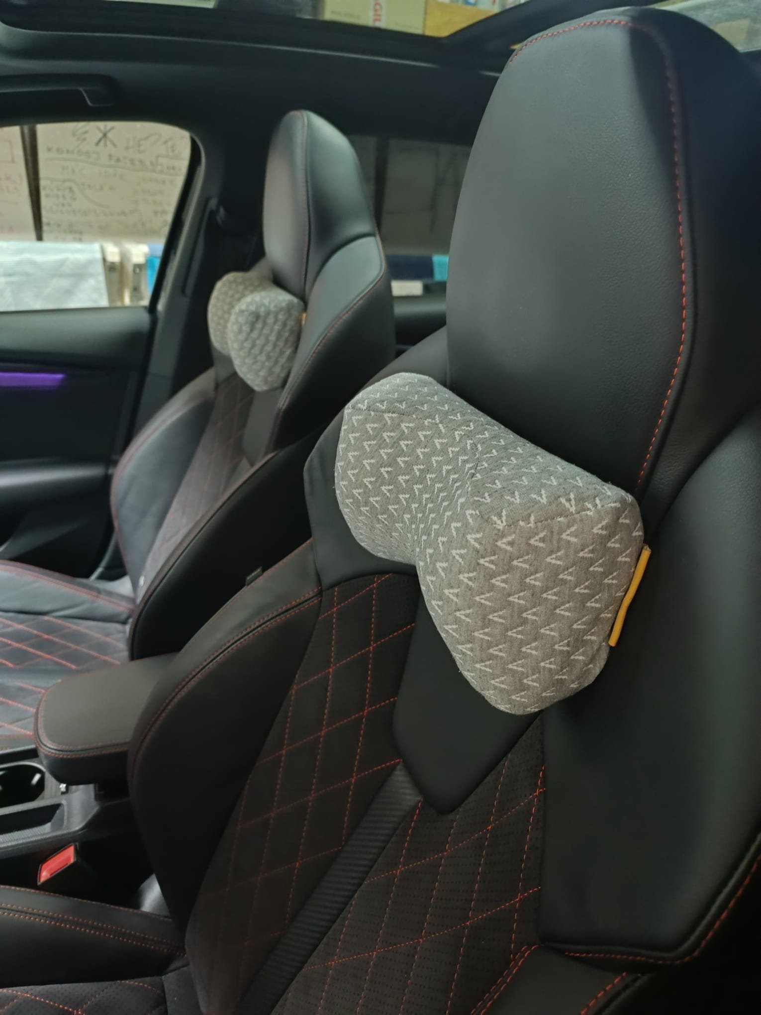

I used successfully before this solution different magnetic holders too, attached with double side adhesive tapes, but this solution has two faces for me because the other side of the adaptor can be used to attach a neck pillow with velcro solution. If someone had ever been looking for a neck pillow for sport seats, knows that is again a headache.
