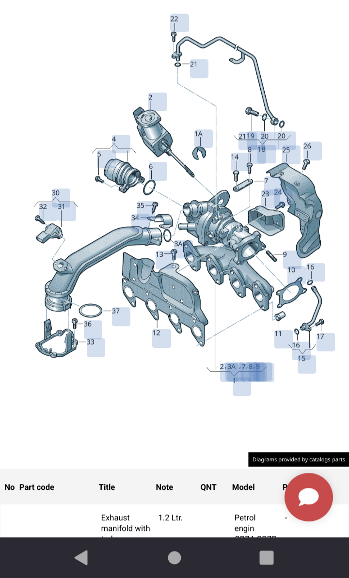

Hi, long time lurker here. Got the 1.2TSI 2011 Fabia Combi. Getting error code P334A and P334B which I've read a lot about in the forum regarding the wastegate actuator. The actuator isn't going back to its original position once it's opened, so I thought I'd get it of the car and replace or renovate it. I've removed the two bolts marked in red in the image, and detached the rod from the wastegate. But I can't move the actuator a single bit. Are the more bolts to be removed, or something else I'm missing? Or do I need to work on it with the hammer?
Any advice is much appreciated.
Looking on Ebay there do appear to be only 2 fasteners. Unsure if you mean nuts removed but the studs appear to have an option to screw them out of the actuator using an allen key which may allow some twisting to remove. The centre boss could be corroded into the mount so some lubricant may assist. The example below is not specifically for your car, just a general review.

Thanks Keith, yes I was referring to the nuts being removed. Haven't tried removing the studs, might give that a go as well. They look pretty beat up, not sure if the allen will fit anymore (also looks like torx on mine instead of allen). Will let it soak in some oil overnight and give it a go tomorrow.
I think you just need to tap it back, probably stuck fast on the turbo bracket.

Thanks xman, that explains a lot!

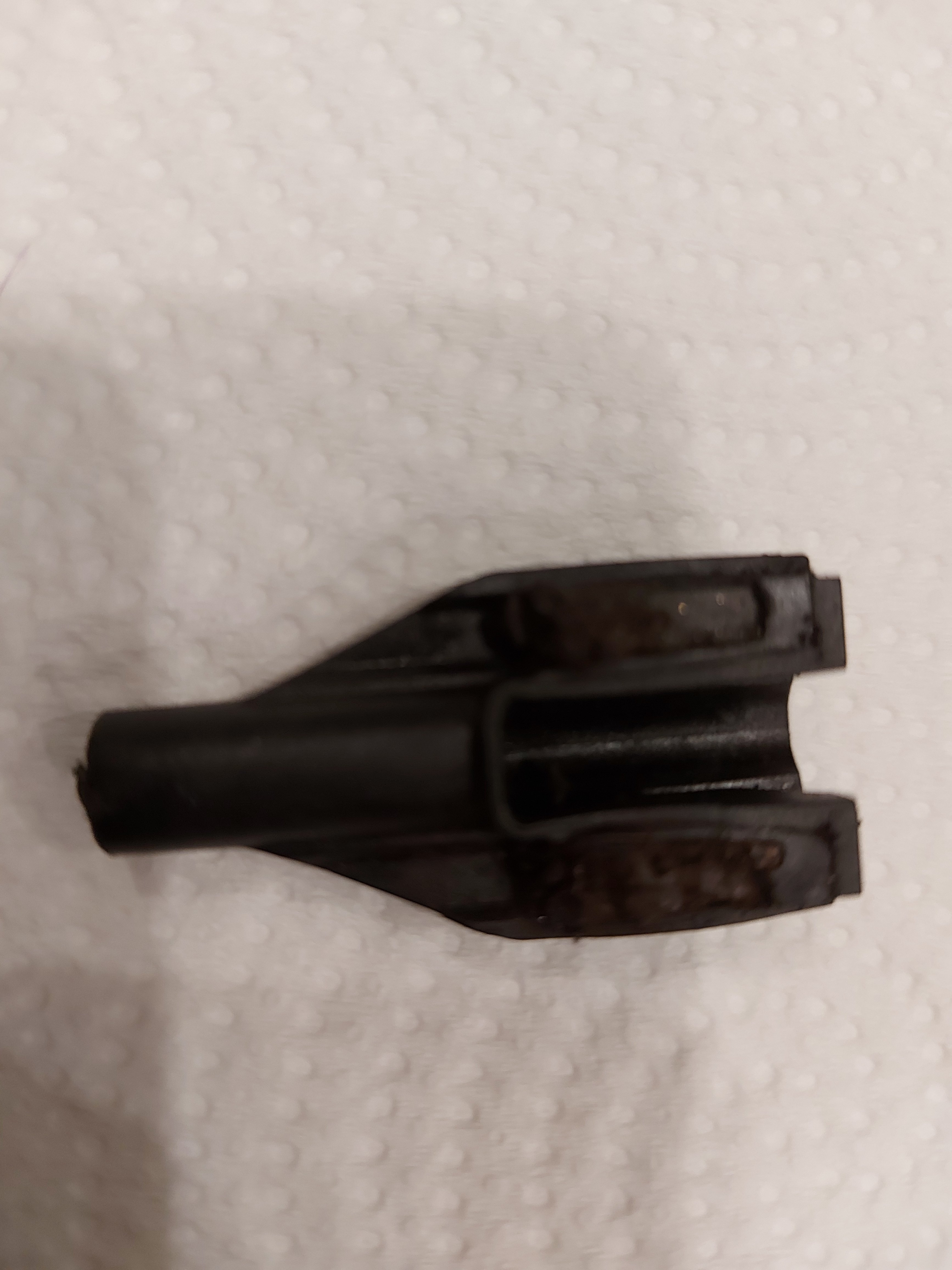

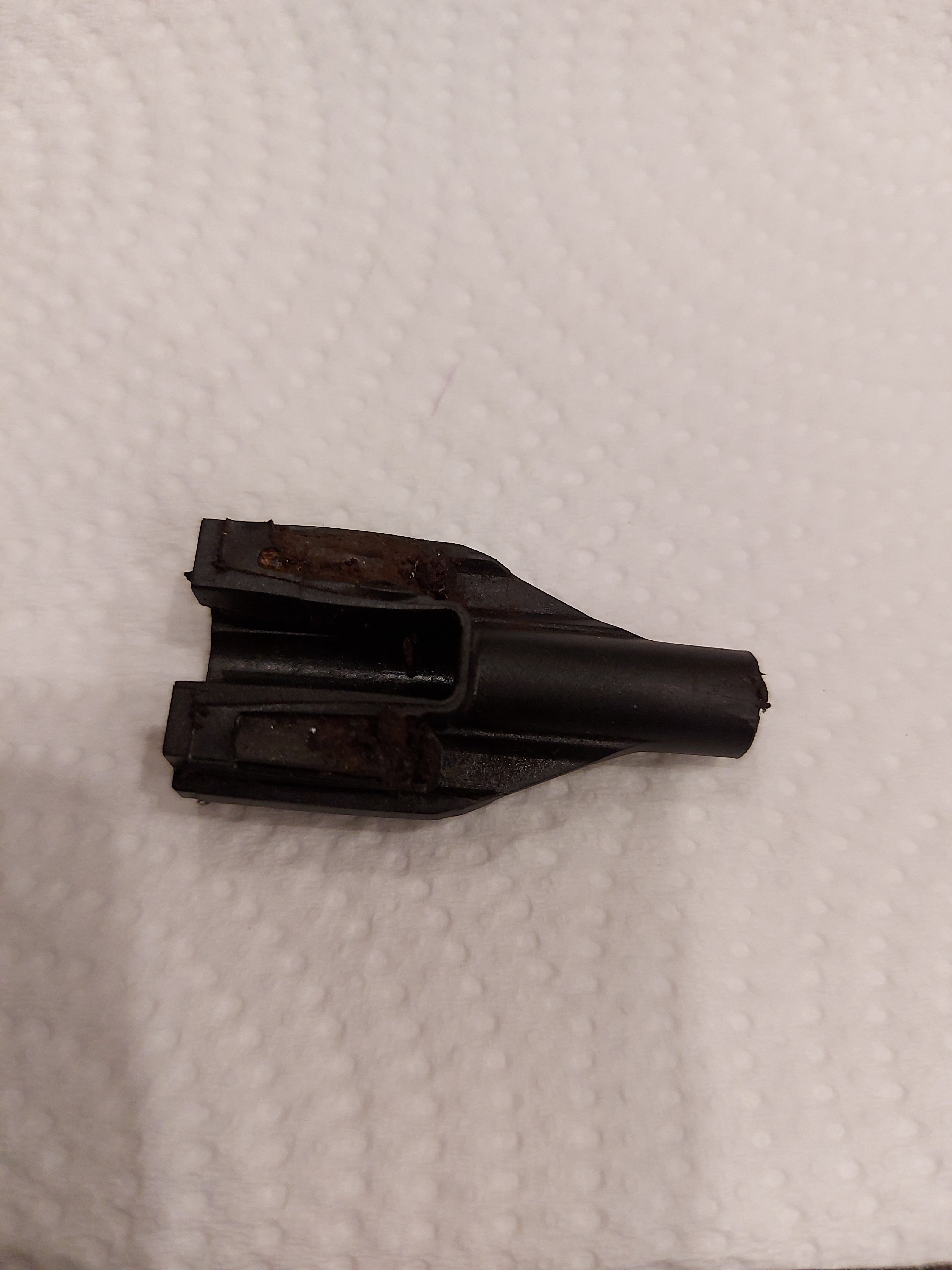

Update: the part finally came loose today, it was really stuck to the turbo. Couldn't remove it without it turning into pieces and using a lot of lubricant.
The help received here was much appreciated. :)
I had to break mine into pieces and found that this part which was meant to move back and forth with a spring had rusted.
