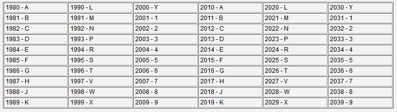

On 11/03/2024 at 22:32, WaveyDavey said:
Well it would seem that the spec looks to have pretty much stayed the same throughout then.... :)
The only change I've come across myself is the change to the virtual cockpit screen which was changed on the MY23 cars?
Can i clarify when you refer to MY23 batch, does it refer to Year of Manufacture 2023 as well or its usually 1 year earlier?
39 minutes ago, EldridChapman said:
MY23 batch
MY23 refers to cars made from approximately July 2022 (usually after a summer shutdown but not always) with a VIN year digit that indicates 23 as the model year.
MY23 (Manufacture Year 2023) so vehicles that are produced from the summer of 2022 and were usually delivered to customers from the autumn of 2022.
