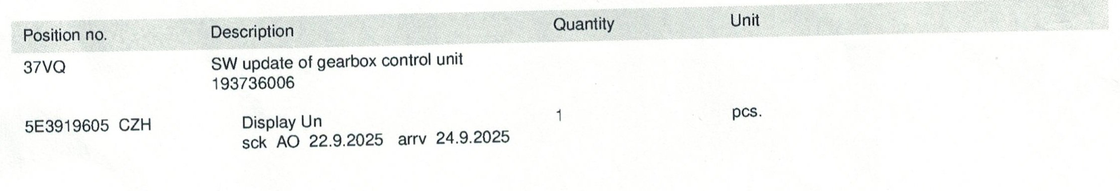

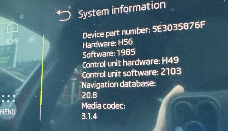

  1. Hello, I got my car back from the workshop today. Can confirm that only the display unit (5E3919605) got replaced under warranty. The previous display unit was hardware H47, now the new one is H49. They also did some software update to my DSG gearbox which was a separate matter.

  7. Hi all, Just sent in my pre-FL mk4 for year1 servicing and requested agent to update my firmware. They updated to the below details. Will try it out to see if any difference versus old firmware. Old firmware never had any stability issues, only a brief period of lag when trying to adjust aircon or select drive mode immediately after starting the car. New firmware: Hardware: H56 Software: 1985 Display unit/control panel hardware: H47 Display unit/control panel software: 2103 Navigation database: 20.8 Media Codec: 3.1.4 Old firmware: Hardware: H56 Software: 1889 Display unit/control panel hardware: H47 Display unit/control panel software: 2103 Navigation database: 20.8 Media Codec: 3.1.4

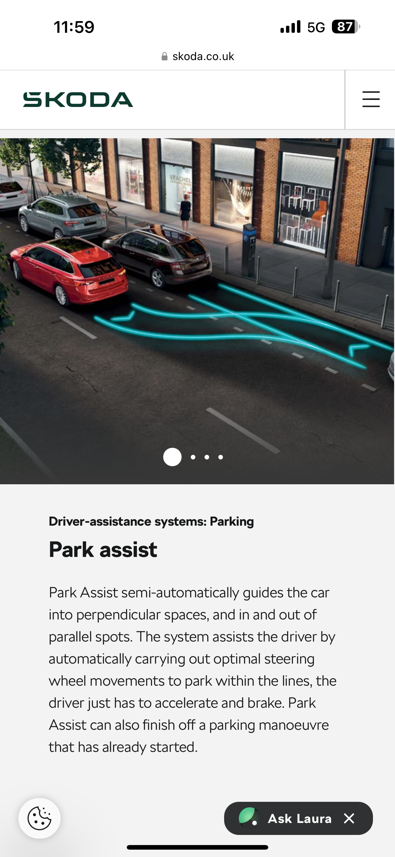

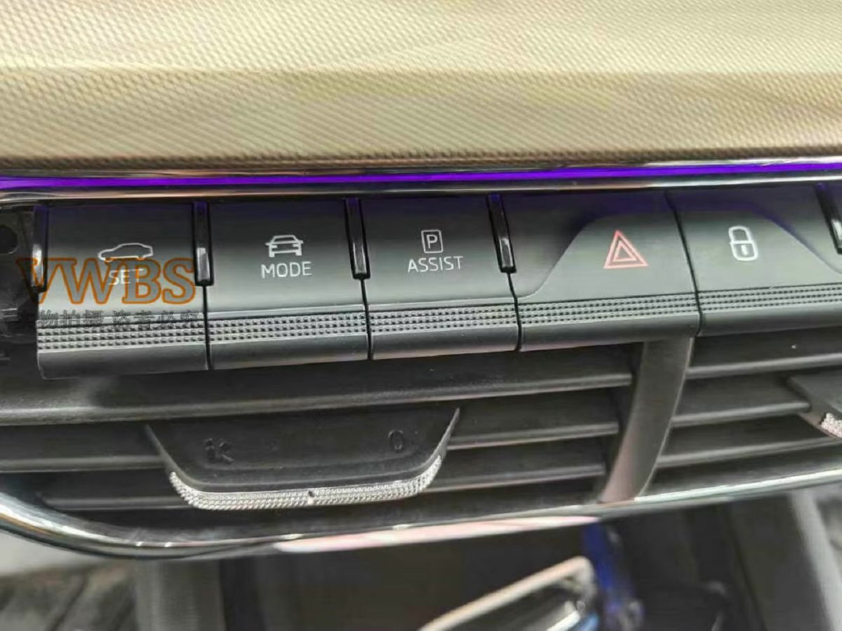

  9. If park assist is referring to this function below, then I need to issue a correction as my RS does not come with it. I also do not have the "P+Steering wheel" icon next to the reverse camera feed. The dealer only advertised Park Distance Control for my RS. However, I do have the park assist button which brings up the reverse camera and activates front/rear sensors when below 15km/h. The presence of the button caused the confusion to arise at my end.
  10. My RS with production date May 2022 also has park assist included.

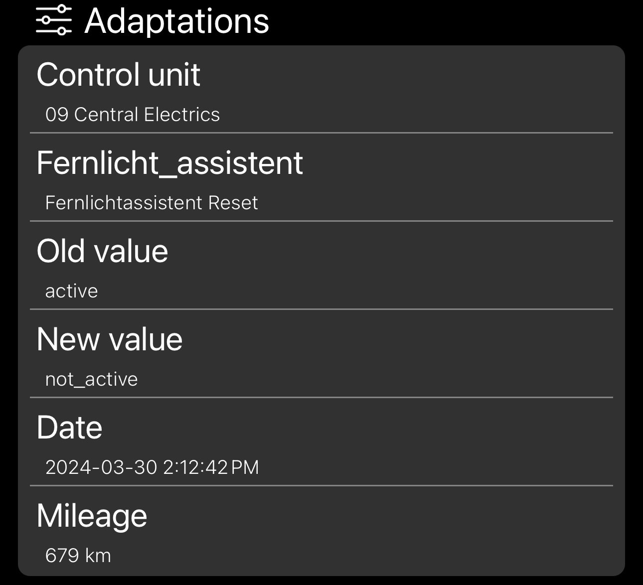

  11. Pls see the screenshot of the long coding I did for high beam memory below
