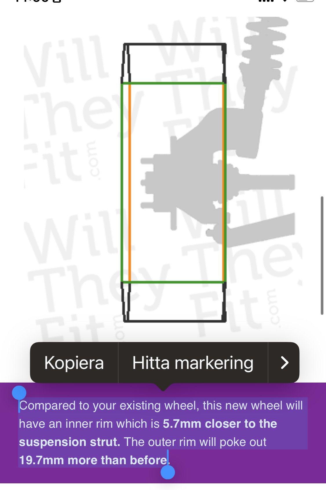

@TDIMachoMan Read again. @Carlstonis talking about 235/40 not 235/45.
The superb wheels should fit just fine. They will stick out a bit more and actually be further from the suspension so no issues mechanically.
You might be able to use oversize 225/45R18 tyres that the Octavia MK4 uses, perhaps fitted to 7Jx18 ET45 5/112 57.1 rims from the Karoq. After all, the Octavia MK3 Scout uses 225/50R17 fitted to 7Jx17 ET45 5/112 57.1 alloy rims. However, as with all big changes in tyre size you would have to check that there isn't any rubbing...so purchasing one wheel and checking in all four positions on the car rather than purchasing all four wheels at once would reduce the financial lose if rubbing did occur.

I don’t consider 18” big since Skoda sells xtreme 19”. The wheel arches are big and I currently have 17” and it feels like I could go 1 inch up just to get that sporty look on the outside. The thing was I don’t really like the vRS ones, but love the Superb 18” they are classy and sporty at the same time.
I will check how much clearance I have when I put the summer 17” then decide if I will get a set of 18” and refurbish them. Thanks again for giving me advice
