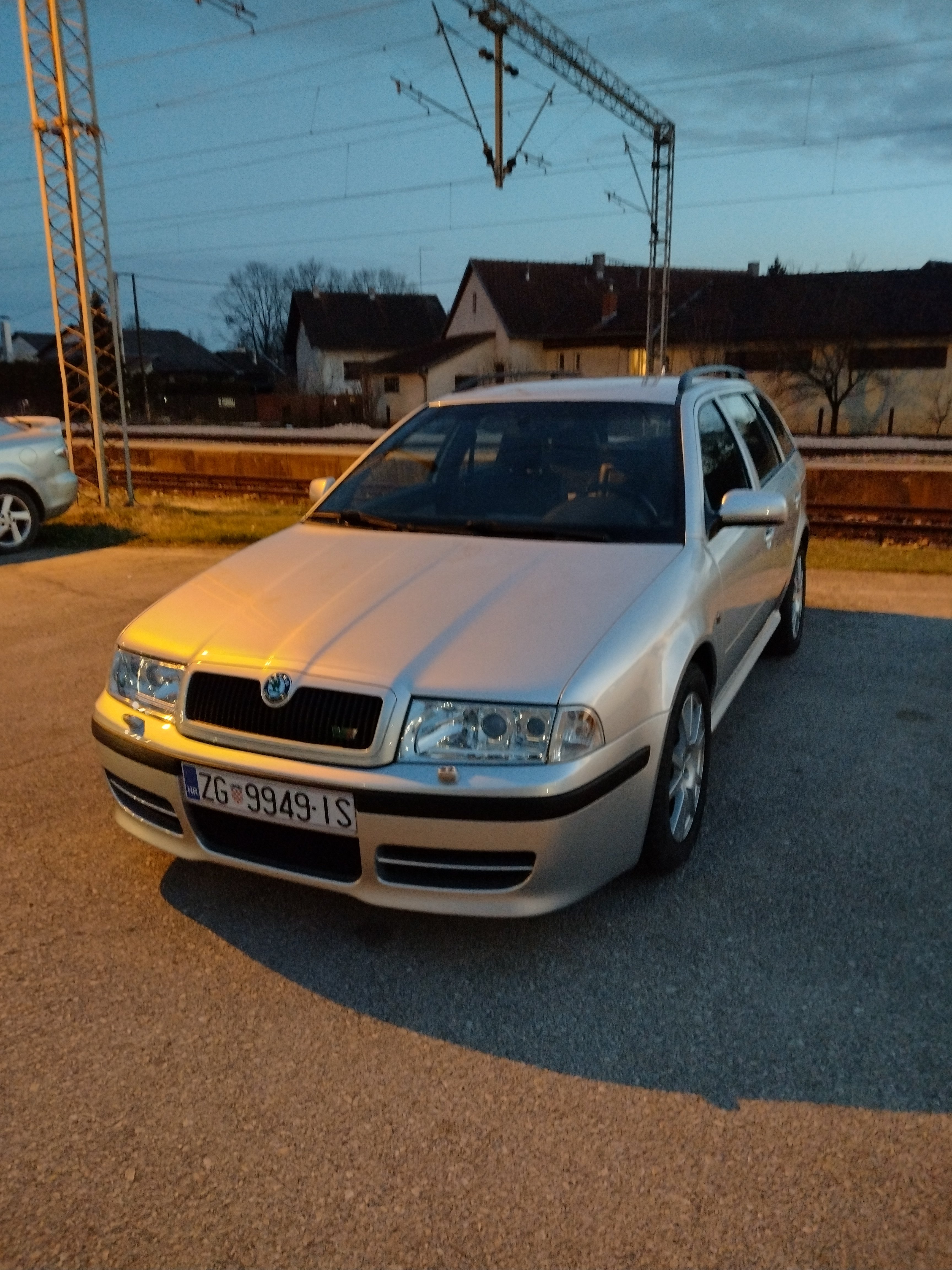

Overall great and well looked after car!IMG_20240307_181411568_HDR.thumb.jpg.47d28342e28668e83a4f73f22697f2bd.jpg

Incidentally, from the photo you don't live in the UK? Knowing which country you lived in would have let us give data better personalised to your circumstances, like distances in kilometres rather than miles.
No I don't I am from Croatia,
There are only a dozen mk1 vRS Octavias in my country. I heard only 5 wagons, and all I seen have not been properly cared for and thrashed mostly.
