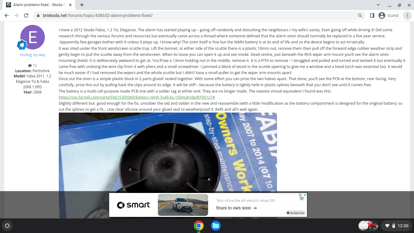

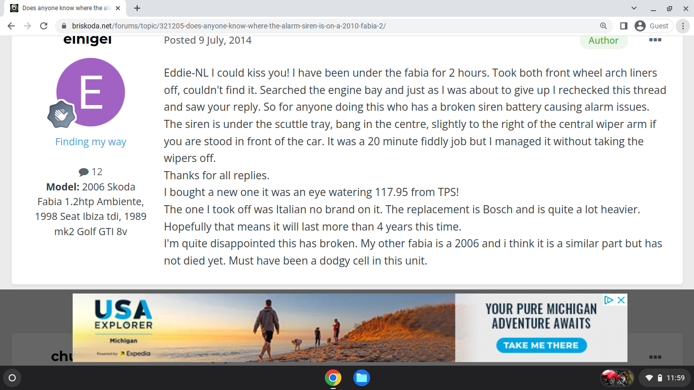

Did they move it's location then? I replaced mine a few years back and it was at the base of the windscreen beneath the wiper arms and scuttle panel.
^^^ Exactly.

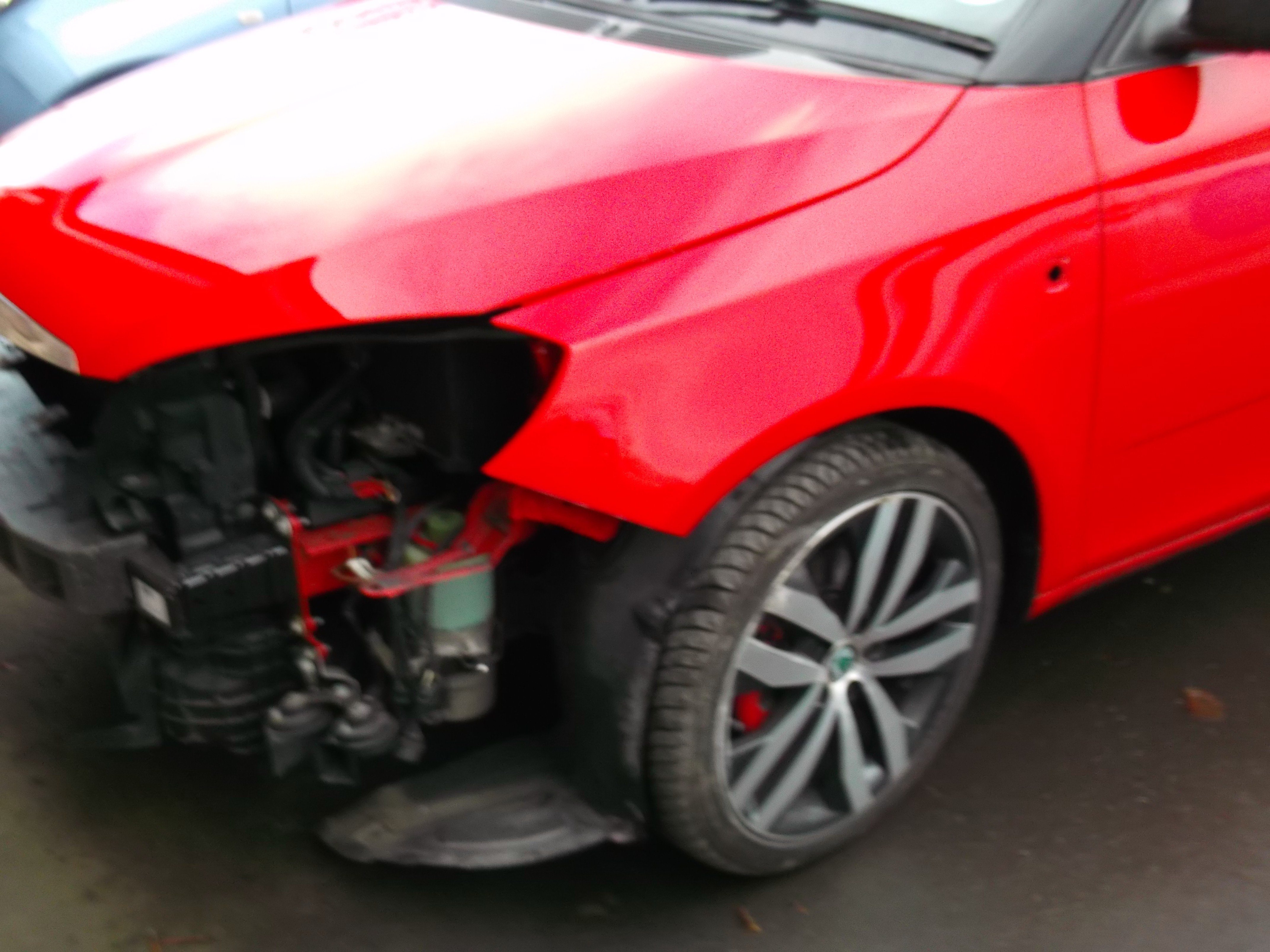

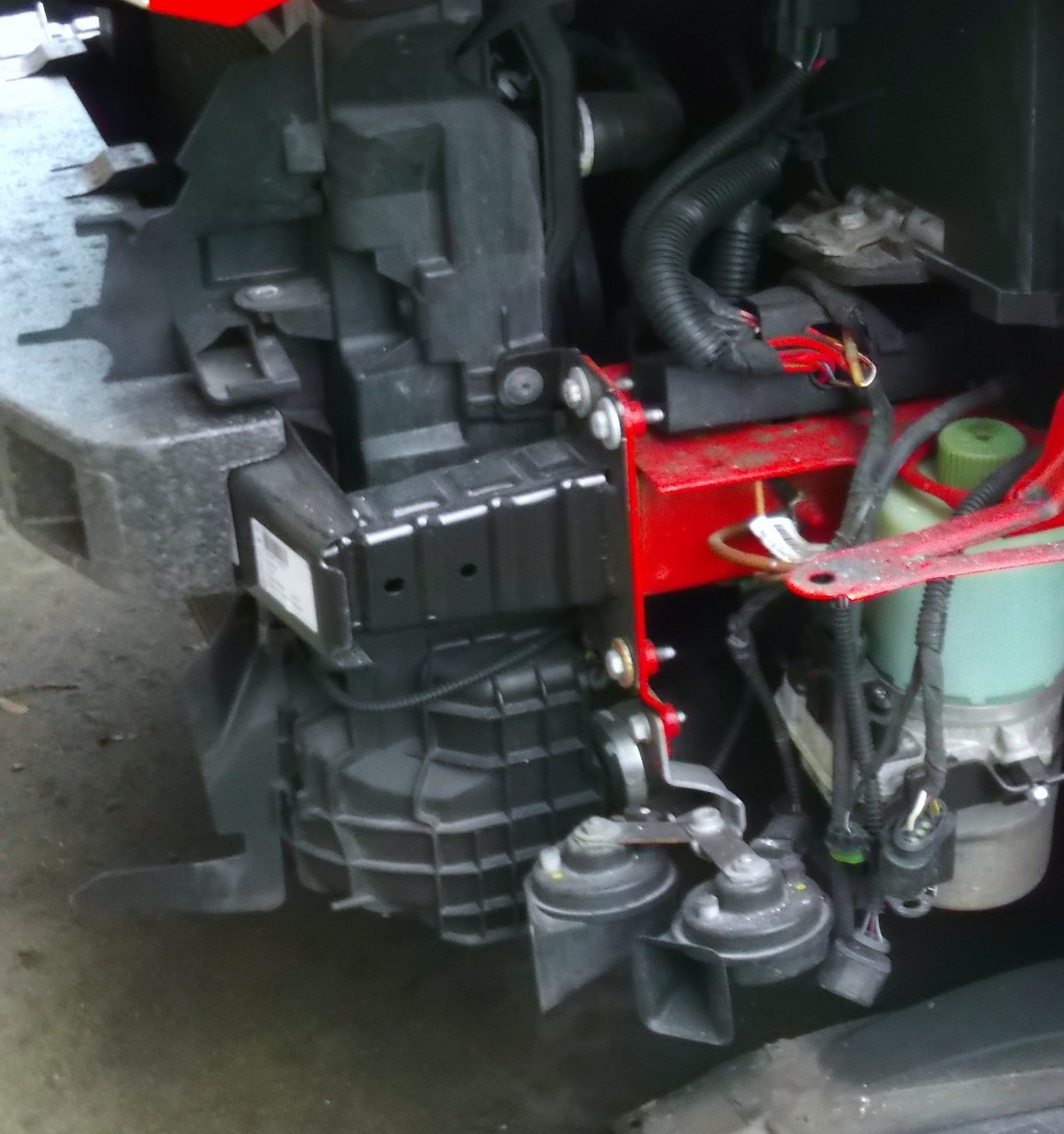

Horns down the front not the alarm siren that show as Service Replacement item at 5 years / 50,000 miles in the Service book.
Plenty still on the go with the original 14 years on.
My crashed / repaired vRS.
