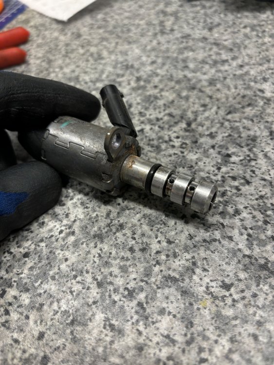

So, car in the air, under tray off, belt off, 3x13mm headed setscrews, compressor supported with cable ties and you have access to the valve now.
20 minutes later…. T30 out, valve still stuck in engine. The valve will rotate but it seems to be stuck on what can only be the O ring.
Good information - Try some grips on it like mole grips or plumbing type grips - 👍
Brute force, ignorance, and a set of Knipex Cobras and she’s out.  They must install it with the ‘O’ ring dry so it’s a pig to get out

I think the issue is that the valve ported end spins freely from the solenoid coil end, so I thought because you could turn it in the hole it was breaking the O ring free in the bore but it wasn’t, just the coil end moves and you have no option but to just pull it out with a wiggling motion with some grips which is easier said than done.
Hope that makes sense
The new one has a 25 Ohm coil, old one is 1200-1500 so a conclusive issue
