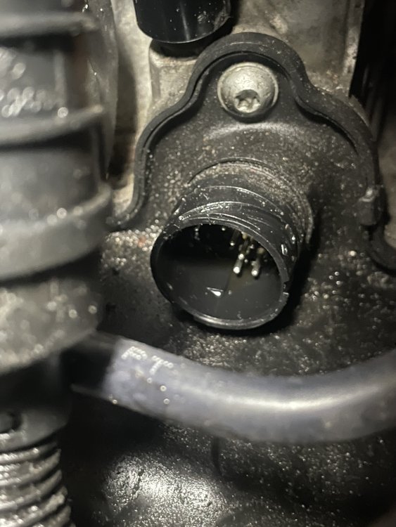

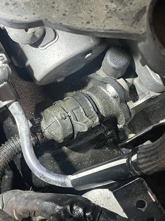

DSG Leaking help
Engine: CRMB 150hp 2.0 TDI
6-speed DSG
No codes, no issues while driving/shifting
Regularly serviced; 1st oil and filter change at 59000km 2nd oil and filter change at 114000km
Currently at 118000km
Help?
Not a good sign and as much as i dont like to condemn big expensive parts as a whole.
I dont think ive seen any repair companies offer a repair specifically for the mechatronics plug - that being said, it may be possible! But i thought it was fitted with a potting compound that it 'meant' to be leak free.
If no repair option is about, then a new mechatronic unit is required sadly.

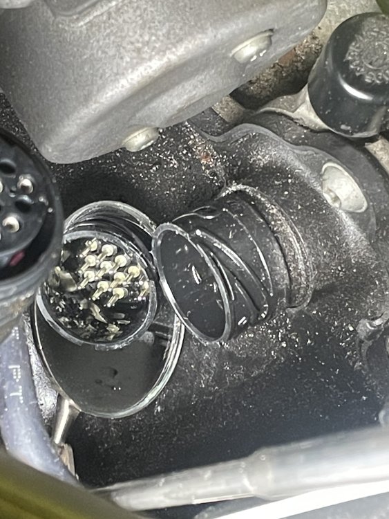

btw the contractor should be completely dry and oil free, or it is a normal thing to find tiny amount of oil inside the connector?
I visited few shops and one of them told me that it may be just pushed the overfill thru some valve above the connector and the oil find its way into connector. I didn’t know there was a valve above the connector for extra oil to escape?

the 2.0tsi had issues with coolant being pushed up the wiring looms
tourags had issues with oil being pushed up wires
vauxhalls had issues with oil pressure switches failing and pushing oil into the ECUs
Its not an unheard of thing so dont ignore it.
It should be bone dry and have no oil or fluids of any kind in it.
Above the connector is a breather, but there is no valve or anything to allow oil to escape, and if the DSG was that overfilled to allow this, then it will need draining and measuring to confirm if this was the case.
Seen as all filling is done from the bottom and the filter is on the rear side, there is no reason for oil to be spilt anywhere near the connector.
