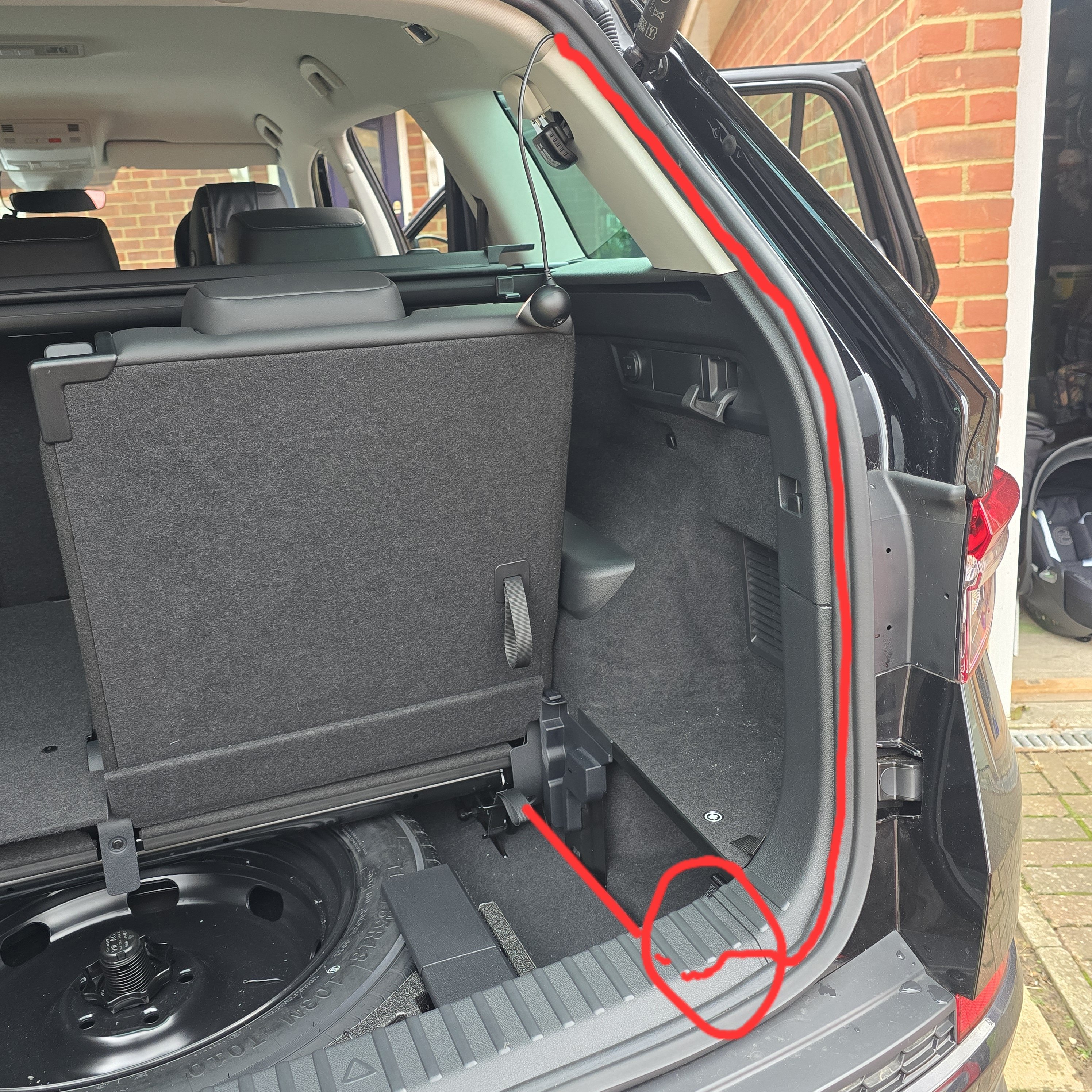

I've installed the wiring for the factory rearview camera.  Just pull off the plastic surround on the hatch, feed wires thru sleeve in to body of the car ( which is the trickiest part of the operation). With the factory rearview camera, the instructions were such I routed the cabling it as if it were installed in the factory, but if it's just a 6m cable for a 3rd party rear dashcam, if it were me I'd Just pull the trim off, feed the wire down the C pillar, go down to the boot and tuck it under the carpet along to the A pillar and then do what you have to do to hook it up to your front camera.
I certrainly wouldn't be going anywhere near a main dealer as it's labour intensive, the whole operation took me a day,  I'd have thought any reputable camera installation supplier would be able to do that much quicker. After all the Kodiaq is no different from any other VW product - I'd be asking if they've ever installed a rear camera into a VW or Audi? It's not as if they're rare ! :D
It's all straightforward, just need some decent trim removal tools and plenty of patience.

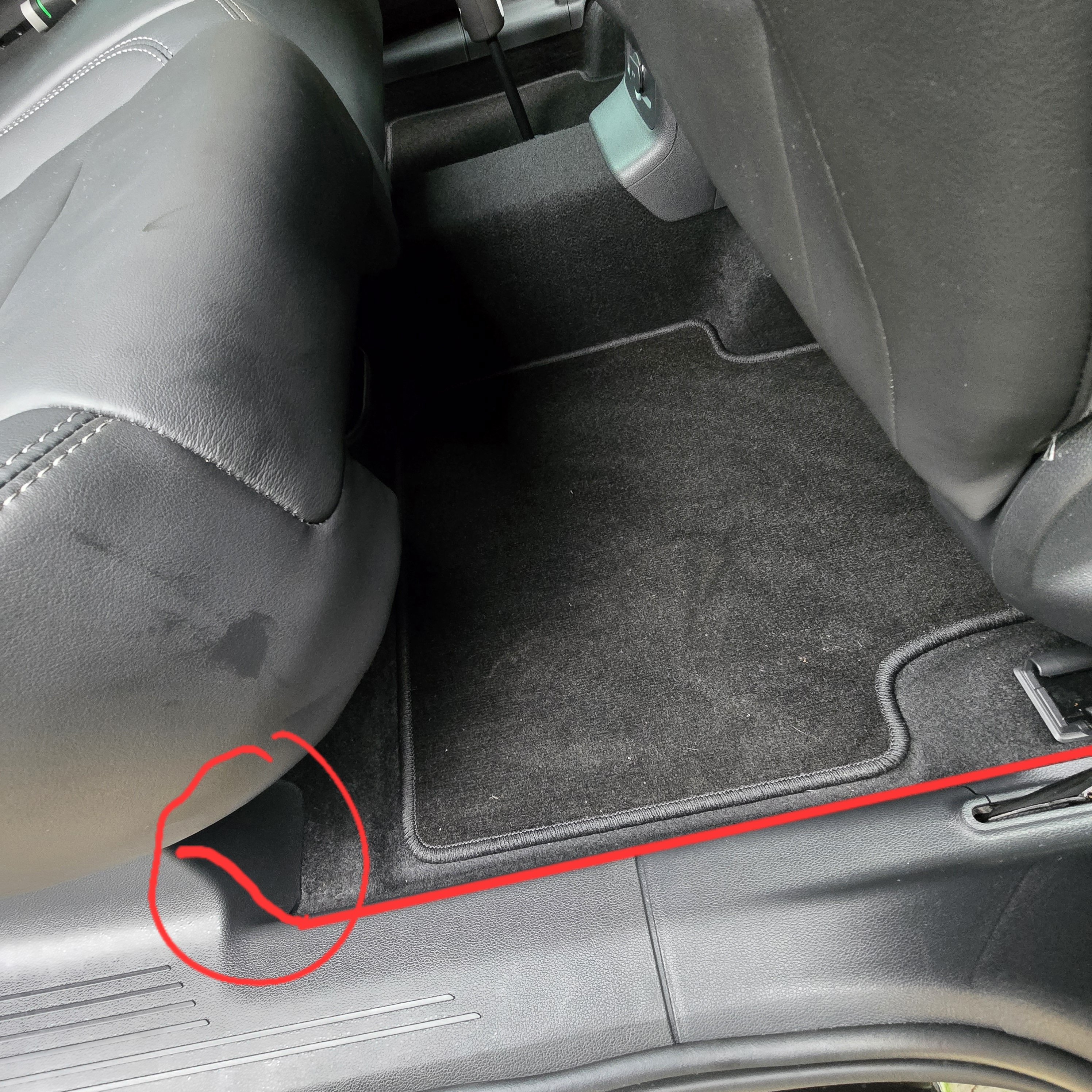

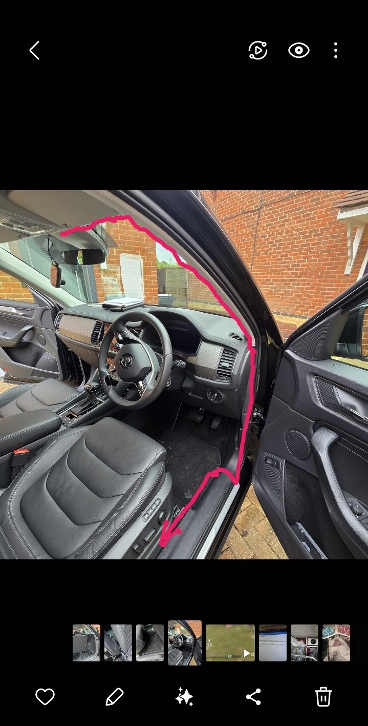

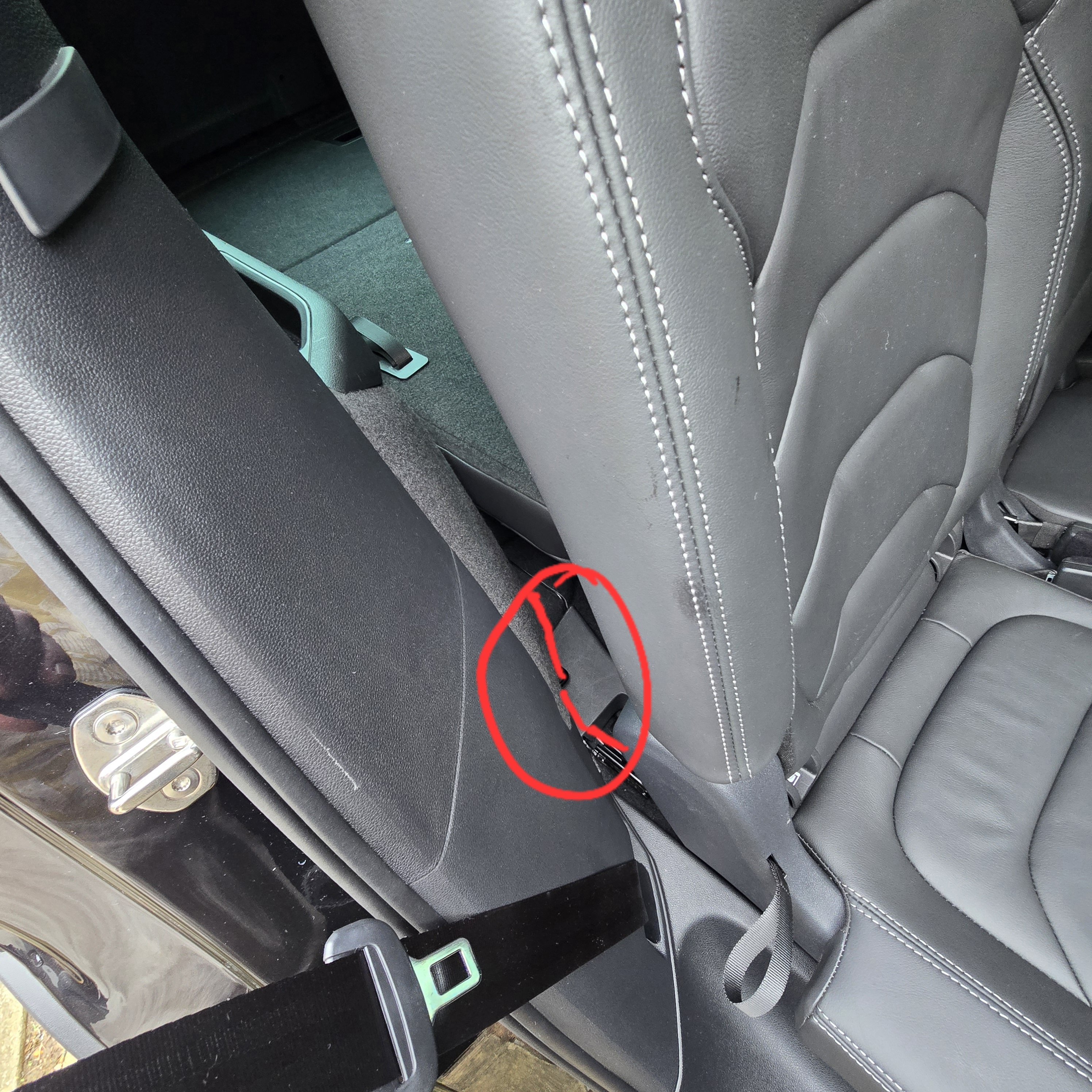

Hi,
The sills I assumed they could remove and hide cable are the ones that run along the doors (front to back) which cover the ends of the carpet. These are the one the garage are saying can't be
removed - the mainline dealers did not say yes/no to this but said they would drop the headlining.

I think people talking about dropping the headlining and removing sill covers are talking rubbish - the cables are generally that thin that those items don' need to be removed and they can usually simply be tucked under them neatly without interfering with anything else.
I've just done added a rear light under the roller blind for the boot in our Kodiaq and had no issues feeding the wires through and under various trim to get to where I needed to be.  Granted that's not to the front of the car but I've done that before to and from various points including the dashboard / centre console to the boot area on other vehicles and not had an issue.

Yes, I have done this (though not on a Kodiaq). My advice is to route your cables low, and then you won't have to worry about the dashcam cable fouling the side curtain airbags which fire down from the headlining over the windows.

Would you just try to tuck under carpets etc, rather than trying to lift the cills?

I can't speak for anyone elses Kodiaq but the build quality on mine is such you need some force to edge the trim away from the carpet which means that even if you could get a cable under it ( it would have to be bell wire size )  there's a good chance of it being pinched. Besides, if it's a half decent camera, the cabling will be shielded so can't see it being thin.  ( it would need to be shielded if it's running alongside existing car wiring ).

OMG.  If it is the door sill trims they're talking about then they're either complete idiots or what's  more likely, they're fobbing you off. Of course they can be removed, it'd be a pretty stupid design if they couldn't !  Take a look at your seat belt. If there was an issue with your seatblet, how could the mechanics  access it without removing that plastic trim ?  🤪    It just pops out. in fact it's easier to remove the trim than what skomaz suggested by tucking a cable under it.
Most VW products are pretty much the same:
Mk7 Golf sill trim removal
Edit:   Many folk complain about VW products but this is one area where you can see where the money goes. You can normally remove this trim panels many times without any sign of wear and tear. I installed a dashcam on a Toyota we bought last year and whereas they have a reputation for reliability, you ain't going to remove those panels many times - the plastics they use are cheap and nasty. Yes, it's very, very easy to tuck cabling under trim on a Toyota. FFS, some of the panels are held in place with plastic nut and bolts !   Remove the panels and you can see why Japanese cars are generally more reliable in the way the car is constructed, but the plastic trim itself 😲  Give me a VW product anyday.
I tucked it under the plastic trim that covers the edge of the carpets. Can't say it was a great job, but as it was formerly in the headlining, I was just happy to get it well away from the curtain airbags.
My Skoda main dealer retrofitted the reversing camera, and they lifted the plastic sill covers with ease. They’re largely held in place by the rubber door seals, I’m not sure what all the fuss is about…
