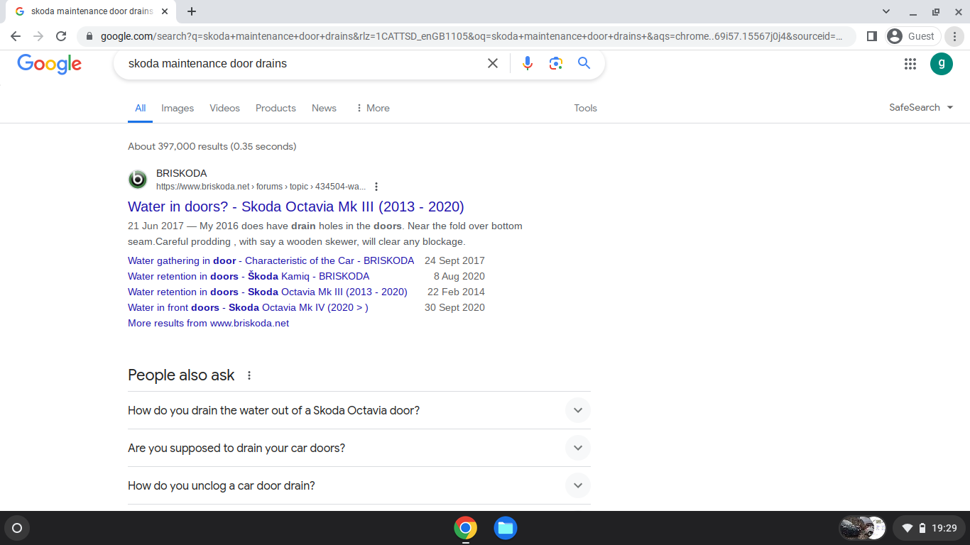

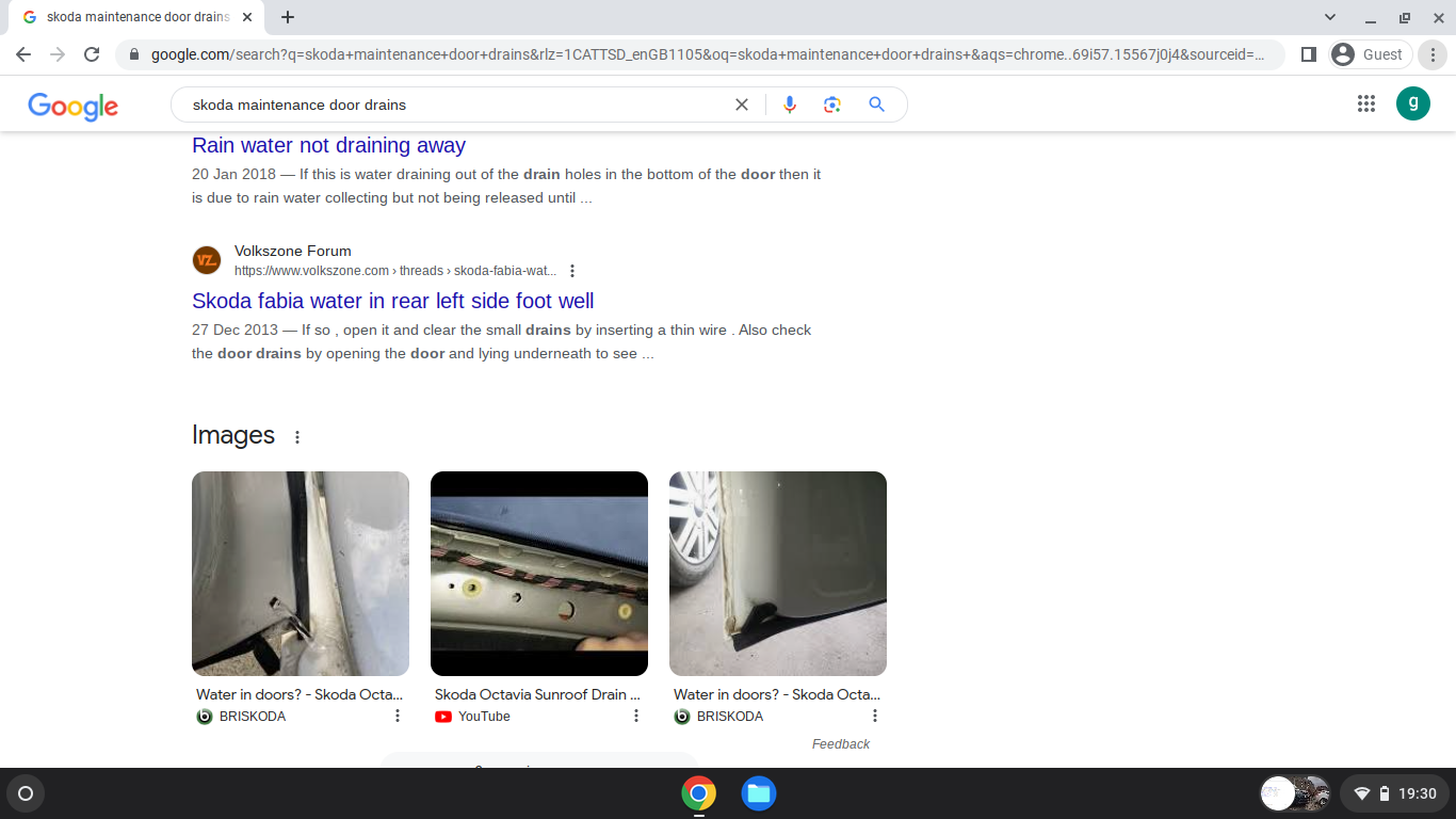

@Rooted you mention some maintenance guides on drain hole clearance. Do you know where I might find them? On this site?
Not right now.
But in the many threads there is plenty advice on how to deal with the seals, unblock the drain holes.
