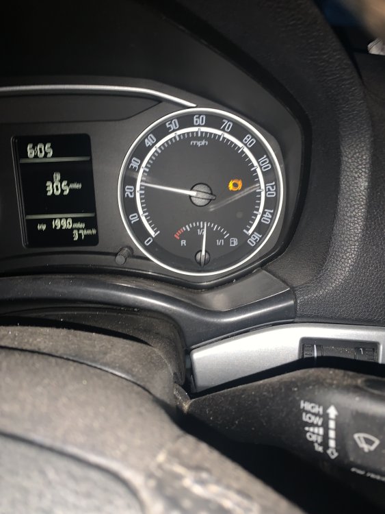

IMG_5586.thumb.jpeg.e5ff8ba0bdc428b1d16939dbabce9d88.jpegmorning peeps,,
had this dash light come on and stay on but if I turn ignition off after a min it stays off,, seems to do it intermittently as for the past few days it’s off,, first thought was brakes ?? Which was why I checked me fluid and found it black 🤣,, so flushed and changed but this light makes an odd appearance still every now and then
should I panic or just add it to my too do list of repairs 🤣🤣(ie egr cooler, inlet, turbo actuator, nail in tyre, service, cam belt ) not necessarily in that order ,, 2010 2.0l Tdi vrs CEGA engine 6 speed manual silver 🤣

Pad wear indication, I think.
yup. if its intermittent though, get the wheels off and check the connectors of the wear sensors.
Is it not the same warning icon for low brake fluid reservoir level?
I don't know because I have only ever seen it once.
Given the bleeding work the OP has done a problem with the level sensor is logical.

It's red in that situation I think, J.R.
Cheers gents
this did come on before I did the fluid change,, as I said it’s what made me check the level and found out the fluid was black 🤣,, it was a tad low but assumed that was just general pad wear,, but she is now at the right level so maybe the pads could be in need of a overhaul so I’ll change everything all round more than likely,,
