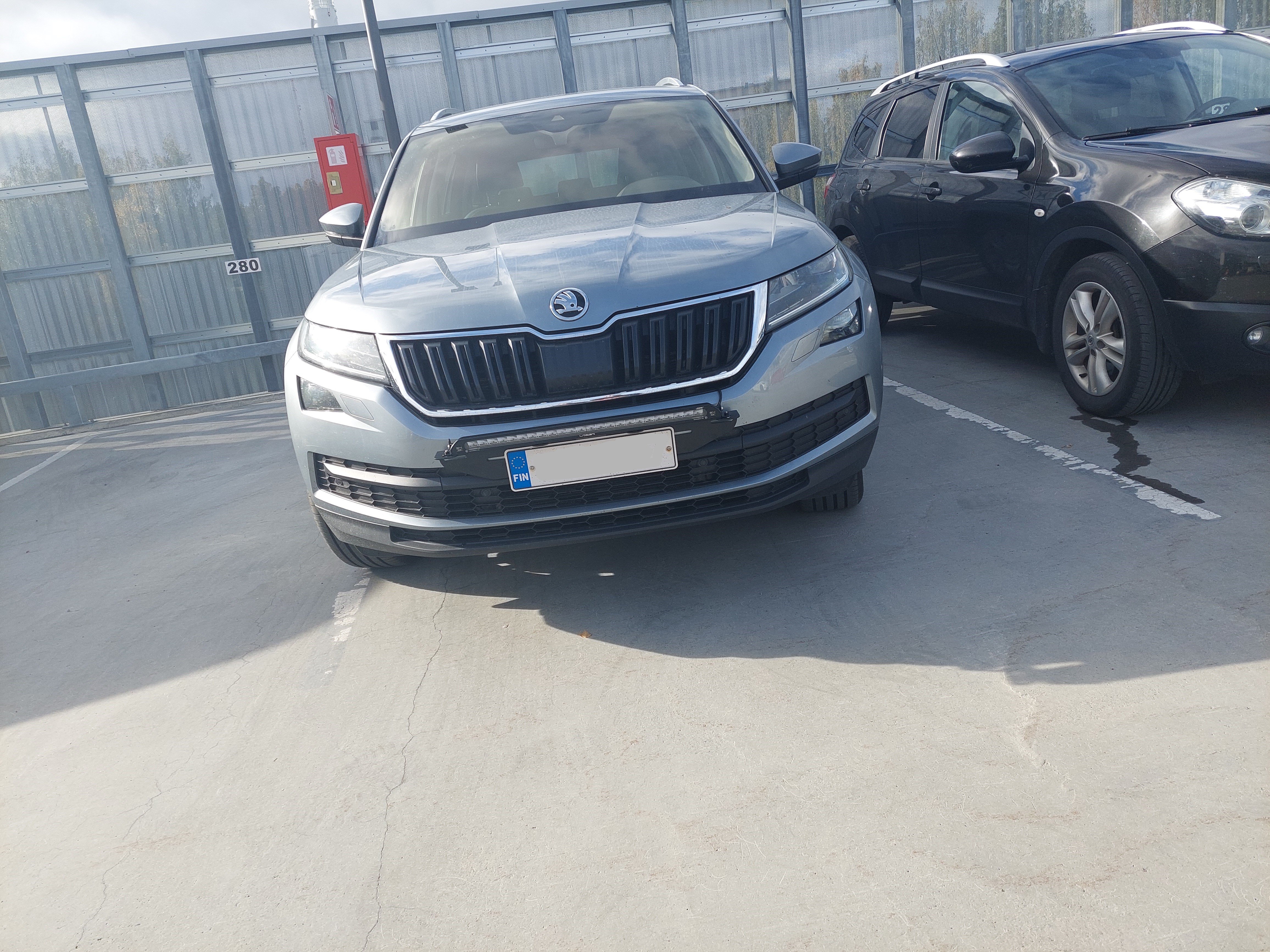

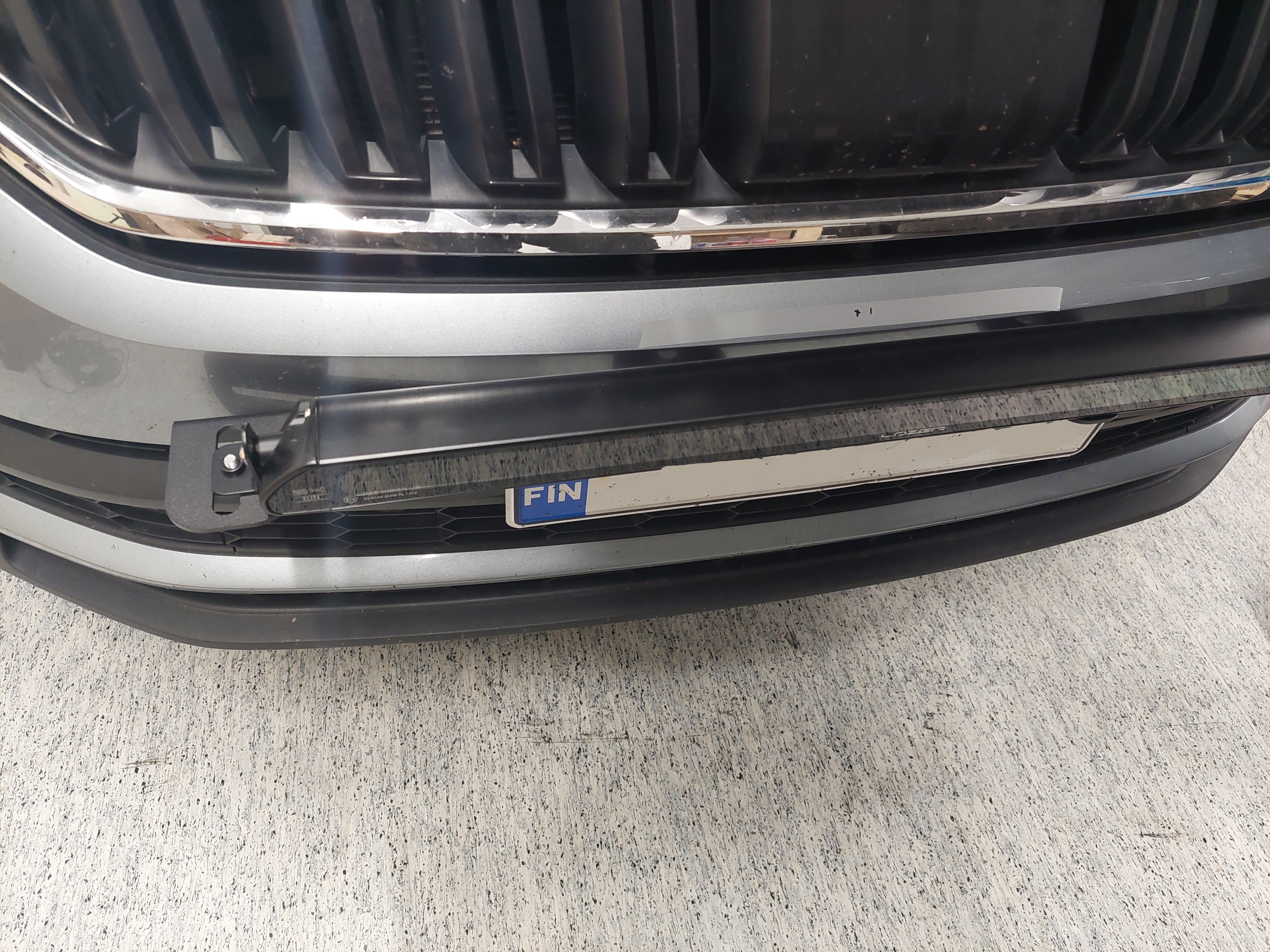

Front lamp is also mounted. looks better than I thought it might, and with 4 screws in it's surprisingly stable. Plate has moved down some, but it seems readable by carparks, which is important here.
Activation will probably be via the CanM8 Connect I have; seems that on the BCM, T73a pin 14 is switched live, 16 is CAN H and 17 is CAN L. Will try to find these and then connect the CanM8 up.
changed up some parts and added a couple of stays. Still need to swap a couple of screws for A2 / A4 Stainless ones with some correct washers, but I am happy with how this sits for the moment.

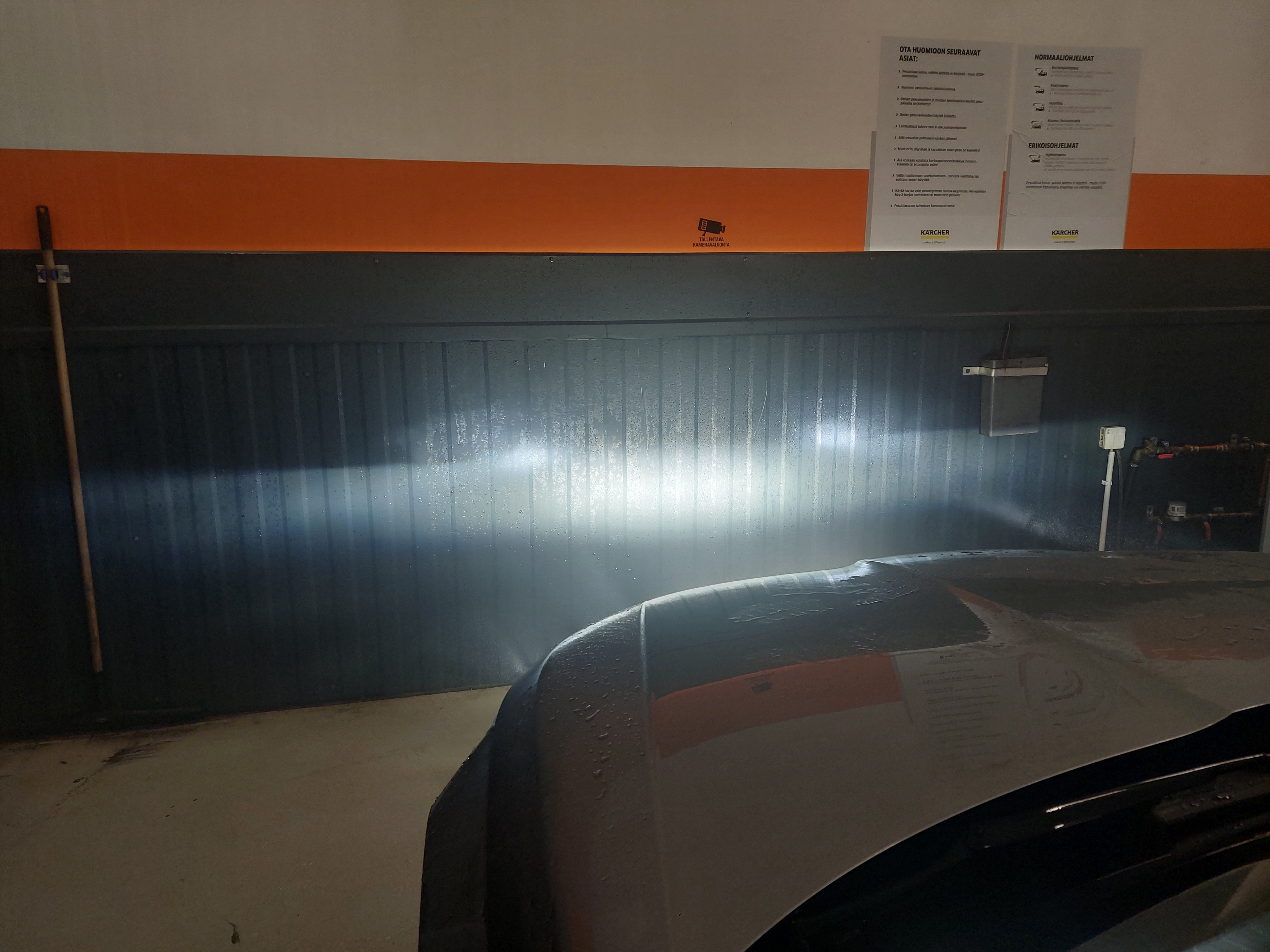

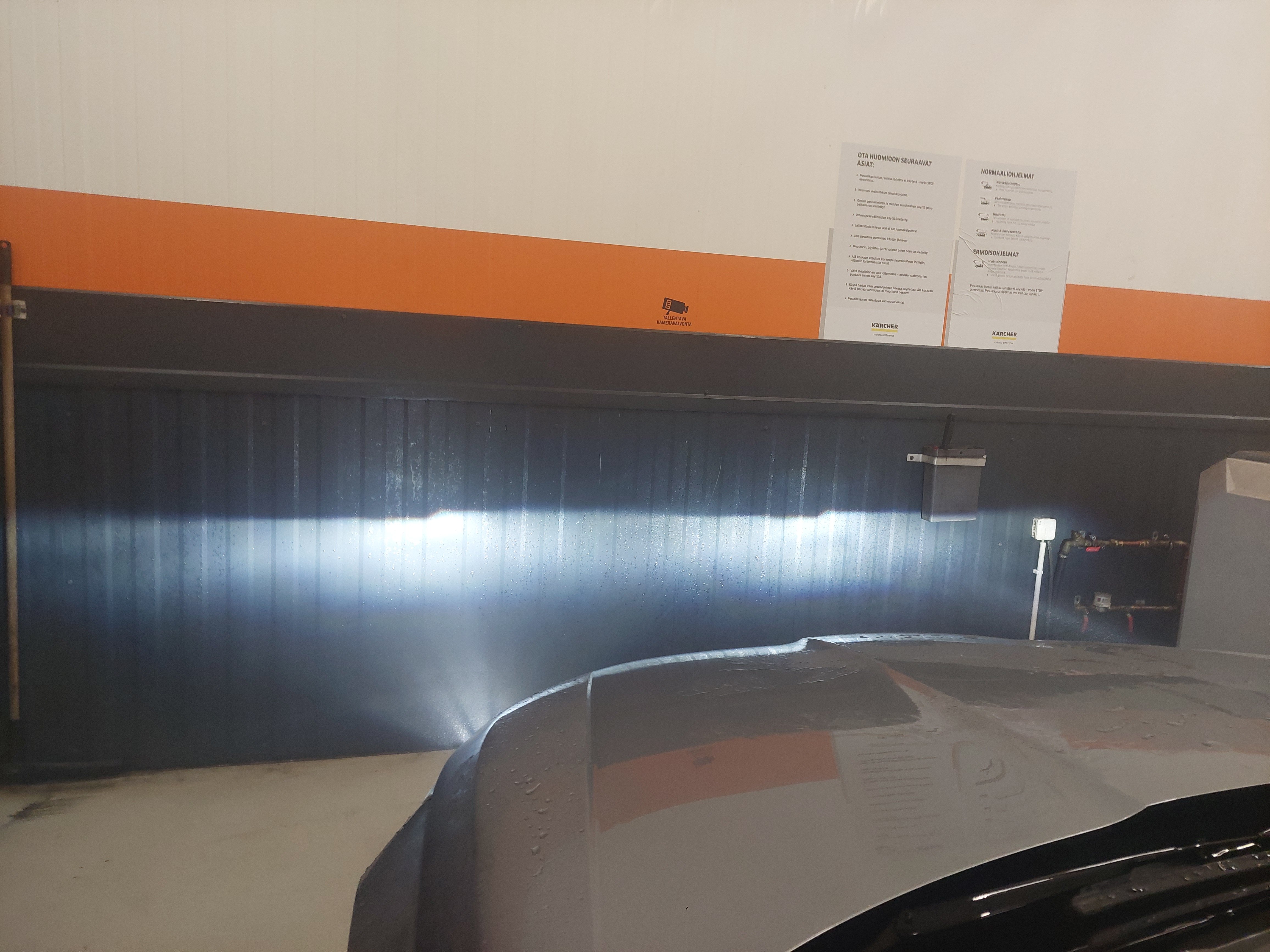

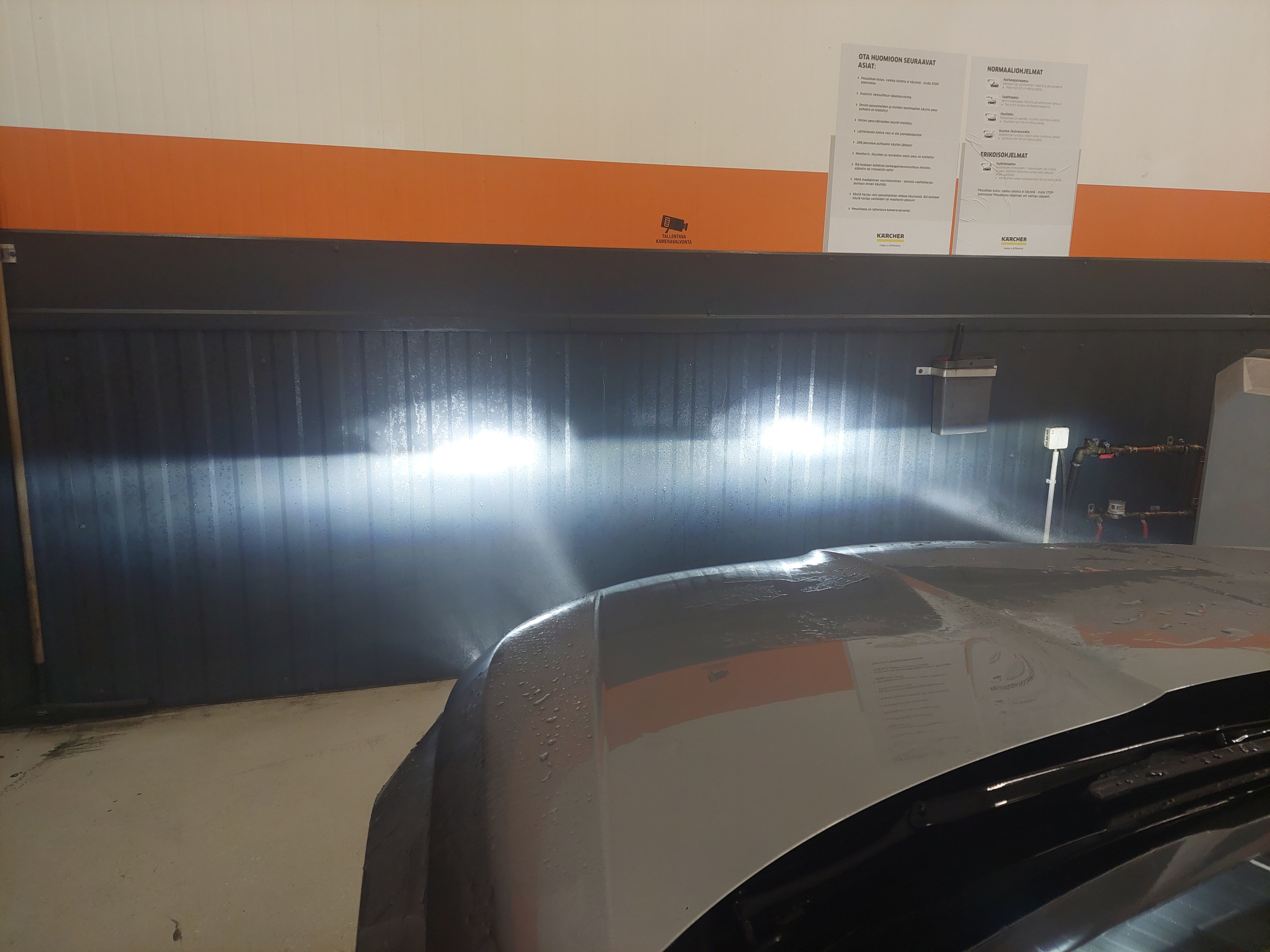

Couple of photos from the other day as I washed the car. Shows dip beam and with the new light.

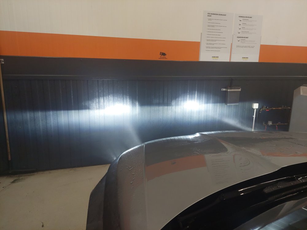

..and with the original high beams.
Phone  cam is not consistent with lighting compensation... the big light is way brighter than the oem. The beam pattern differences are also pretty obvious too.
it's hard to describe the differences of running with this vs the standard high beams. We have a couple of other cars, and they both run Phillips 7001 bars, which are ref 30+30. This is the same, conceptually, but.. no, it's not.  The Philips bars are good budget bars; relatively small and giving out quite a lot of light in a reasonable pattern.
The Lazer 24 light is way more yellow and complements the "pinspots" of the standard OEM LEDs nicely. Those pin spots aren't bad per se, but they're not particularly good either. Nice long throw but very little spill.
The bar adds way more spill, and a chunk of throw at the same time. Difficult to tell how much, as there's been too much traffic around to stop, but I will hopefully be out on a lake in a few weeks, so will try to get some numbers at that point. I am assuming reflections from around 2km without too much difficulty and an obvious 500m+ light pool. Safe to say when you flash this at someone, they notice. I can now see the edge of the road at 2-300m on both sides, and a good 15m each way (remember a 2 lane A Road is generally 10m wide) - it's probably more but to check that I'm going to need a drone and a very long tape measure.
Switch is next to the light switch, so I can turn the excess off at will. That's an important part of the legality here. Mount also seems good with no vibrations; it's just a full mount and into the bumper.
Wiring is from Lazer using a CANM8 - that seeems to have worked very nicely, thanks. Cable for hifi amps was put through at the same time, behind the battery (without removing it!). Helped that a bunch of covers are currently off for the hifi install... took them an hour or so, just over €100. CanM8 was 80, mount around 75, the light itself close to €750 IIRC. Stabilizers were another 20 or so - they are just screwed in to the uprights of the grill. Satisfied with this.

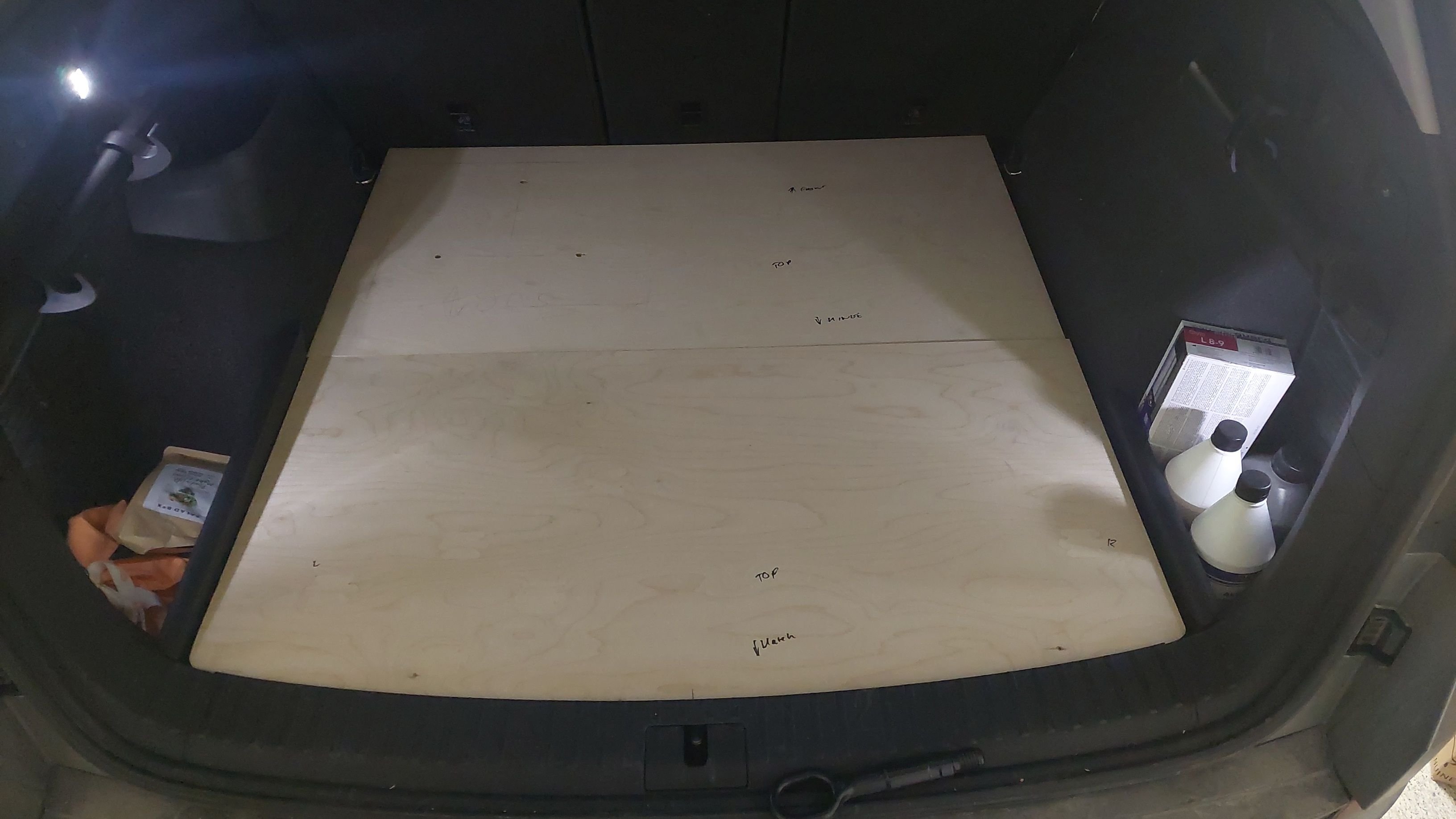

Lots done in the boot. The false floor is now flat again, and the lip to the boot is minimal but there. Which is what I want.
I'm working with 12mm, I think, and 75mm in the middle. Sub should bolt in nicely and just needs and eye on the left side to hook it into the car. Will maybe add a block to really pull it down.
Pics to follow.

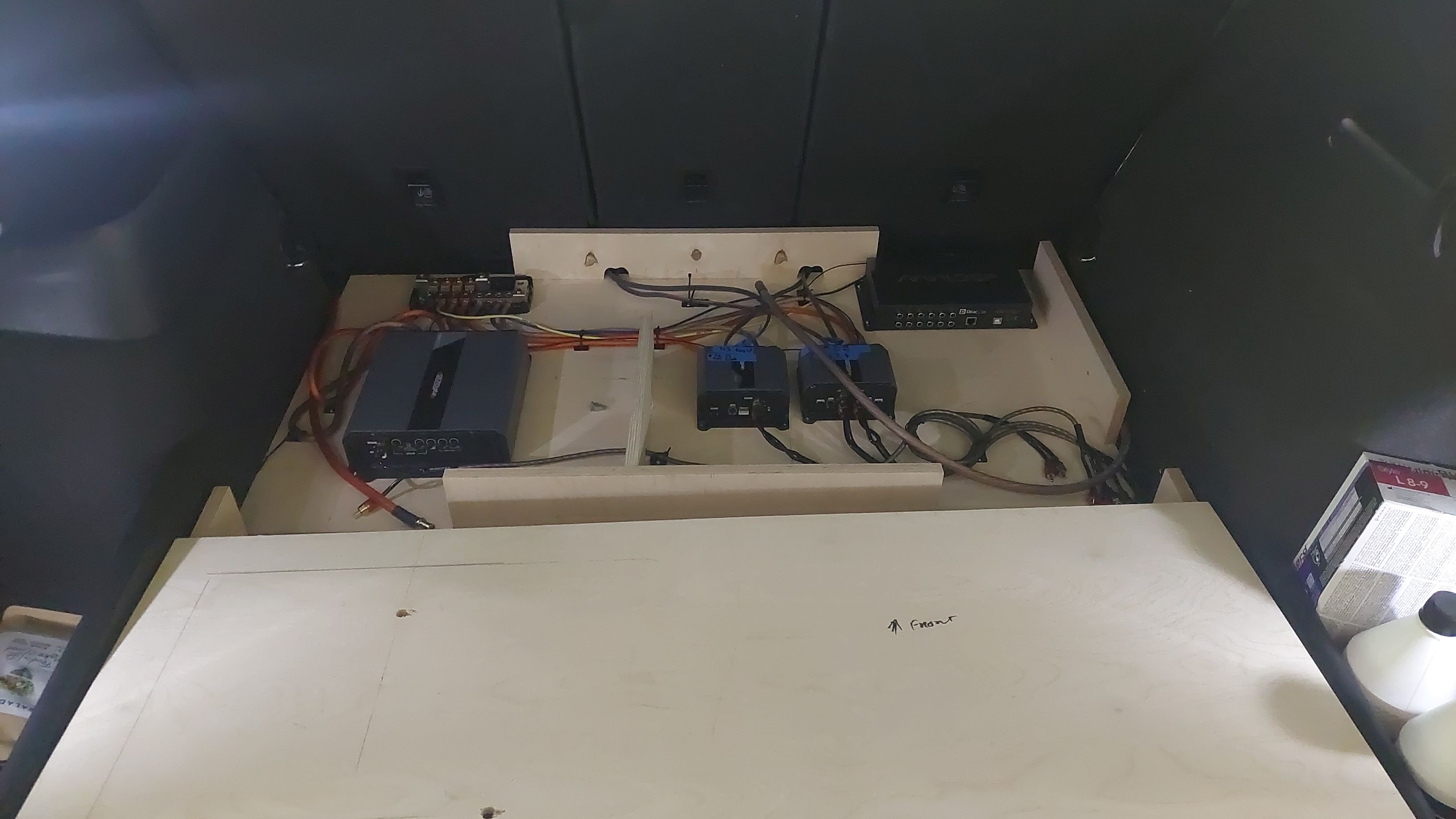

Also swapped to the 8x12 dsp. Can now do 3 way front plus 2 way rear plus sub without issues 😁
This is the amp layout at the moment; only 7 channels. Will add at least a 4 channel to replace the 2, maybe I do go 3 way up front, maybe not. Then the support in the middle needs to move and I need another distro block, but that's future music ATM

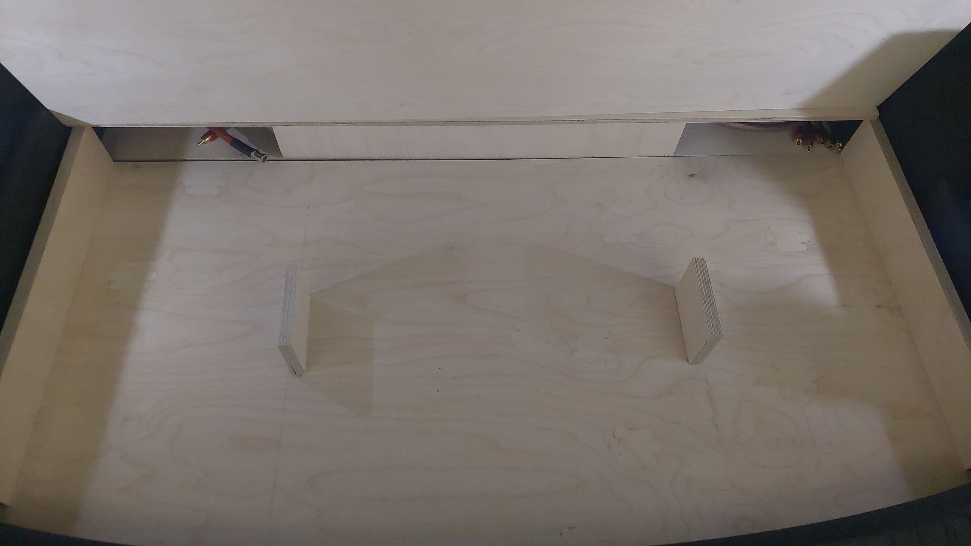

This is with everything down. Need to add some hinges.
Underneath the rear section. Random pieces to support. no specific reason, I have to work out what else needs to go under there.
