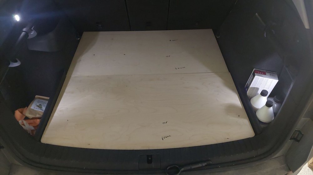

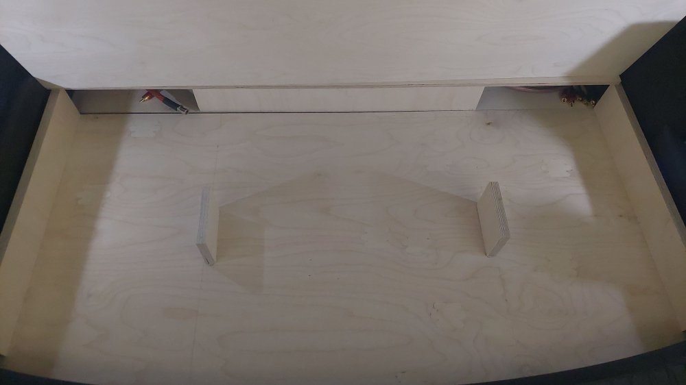

 - parts for the spare subfloor (990x510+520 x 2, 75mm x 520 x6) have been bought. That's 990mm wide, total of 1030mm depth. Should be enough and I have a jigsaw and a circular with a guide... both top and bottom are 9mm, so I can screw the amps into place and the top shouldn't bend too much. Support with the 75mm pieces (the big amp is >50mm tall). So I will "lose" 75+18 --> 93mm - apparently the standard height difference is 100mm. And i have the reversible mat, so it should be good.
 - need to plan the layout itself, but that's something I will do in real and then drill everything, paint, carpet the outside and maybe add a drawer? not sure, have to think about how to use the remaining space best. Got to allow for some air movement somehow, too.
- lamp-wise, I currently have the Phillips 5103L on both the A2 and the SX4. The SX4 mount moves *way* too much, i will have to reinforce that - but I don't particularly like the spread. Too concentrated in front of the car... I will have to see what happens with the specific positions when the lamp holder is flush all the way against the bumper, but right now it's OK and a decent improvement (on the already *very* good LED high beams of the SX4) ... needs some optimization.
 - will try to test the BCM method of main beam activation over the next day or so to see if I really do need to drop €80 on a canM8 or if I can do it with €10 and some programming...
will probably also be adding some LEDs with diffusion film over them in *lots* of places now I've seen how good the stuff is through work.
Plywood purchased, I'm going to have to make some more 75mm wide strips to support the floor (or strengthen it in other ways). 990mm wide (it's actually about 998 but this slides in and out nicely) and then 510+520mm depth. So there's a split and I'll use the front for the hifi and the back as a large drawer (another reason for the strengthening).

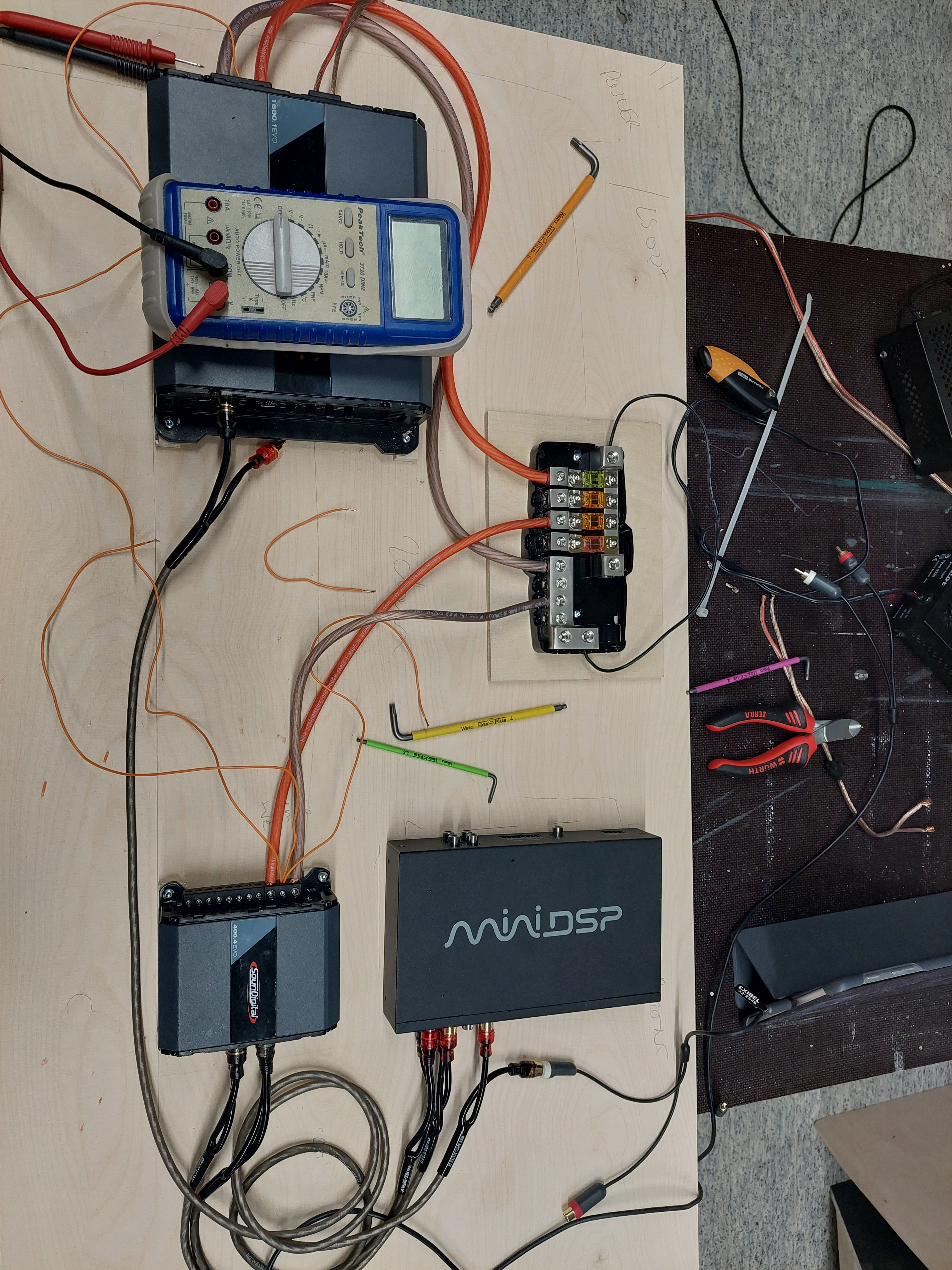

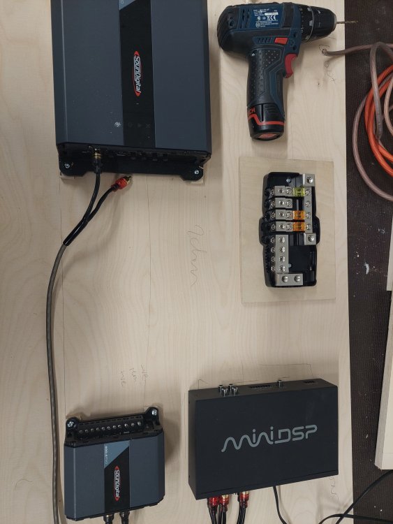

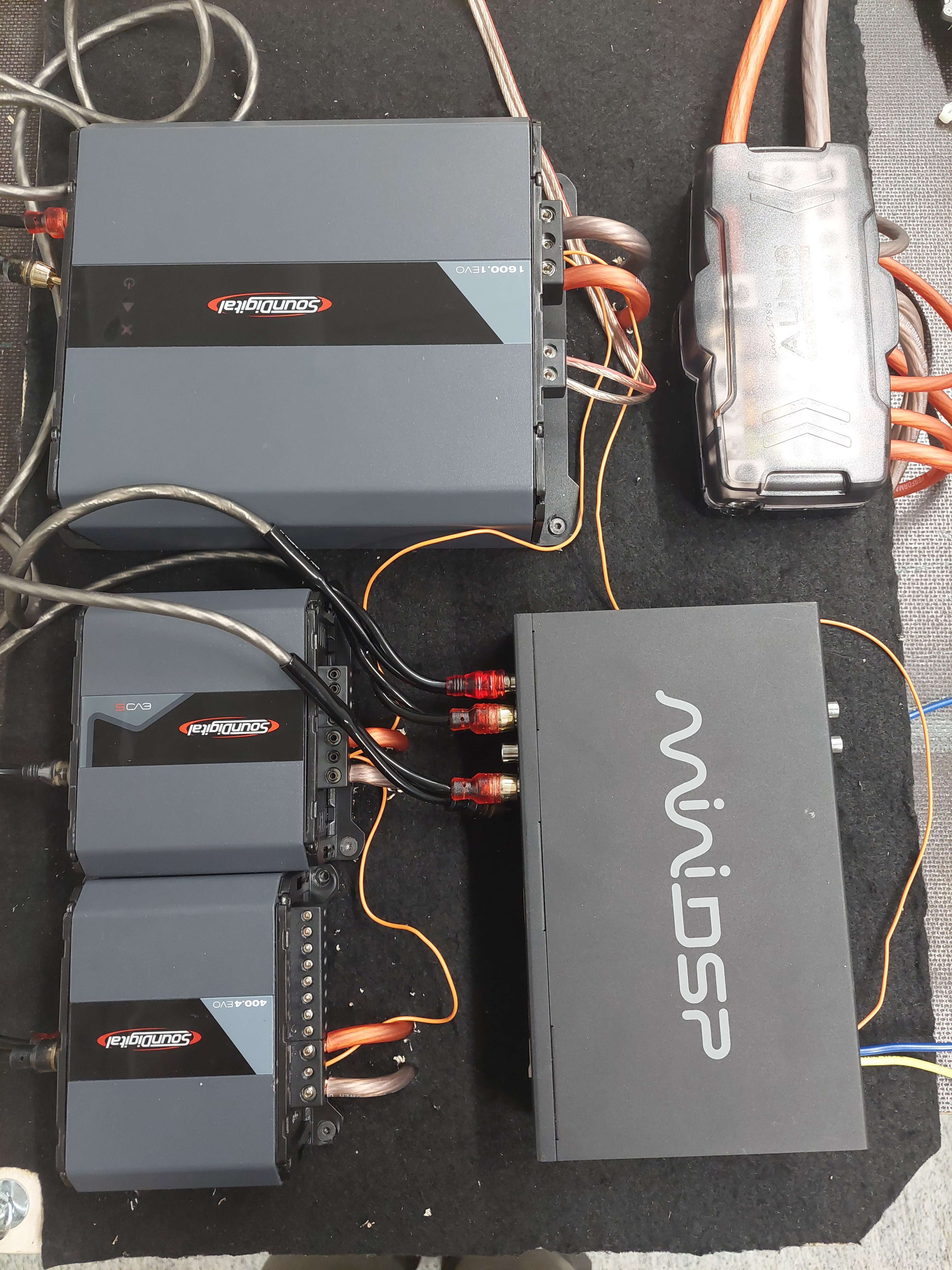

Layout is sorted pretty much for the amps: 1 x35mm2 from the front, then a distro with the 1600.1 on the left, 400.2 in the middle and 400.4 on the right. DSP top right. Probably painted black / dark grey and then the top will be finished in something nice. Alcantara, maybe? have to see what I can find.
Will try to make it clean and good looking, might well light it on the sides with some LED strips. And then light the drawer, too. More to follow as I do some work with this this weekend.
package 1 arrived with some cables.
Initial layout:
More to come.... cabled up for testing with a 60w psu. Enough to prove stuff :)

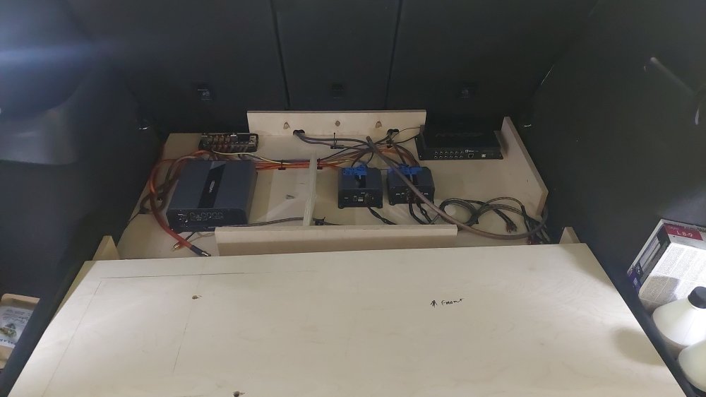

Mild change of plan. Different board used, as this already has space for the sub to bolt into.
Mostly done on this side now, waiting on connectors and a cable.
MOST T is here, last cinch too. DSP connectors are through customs, should be delivered this week still. So I will try to get something running tonight or tomorrow with an SPDIF output from a Pi to the DSP, so I can test everything.
