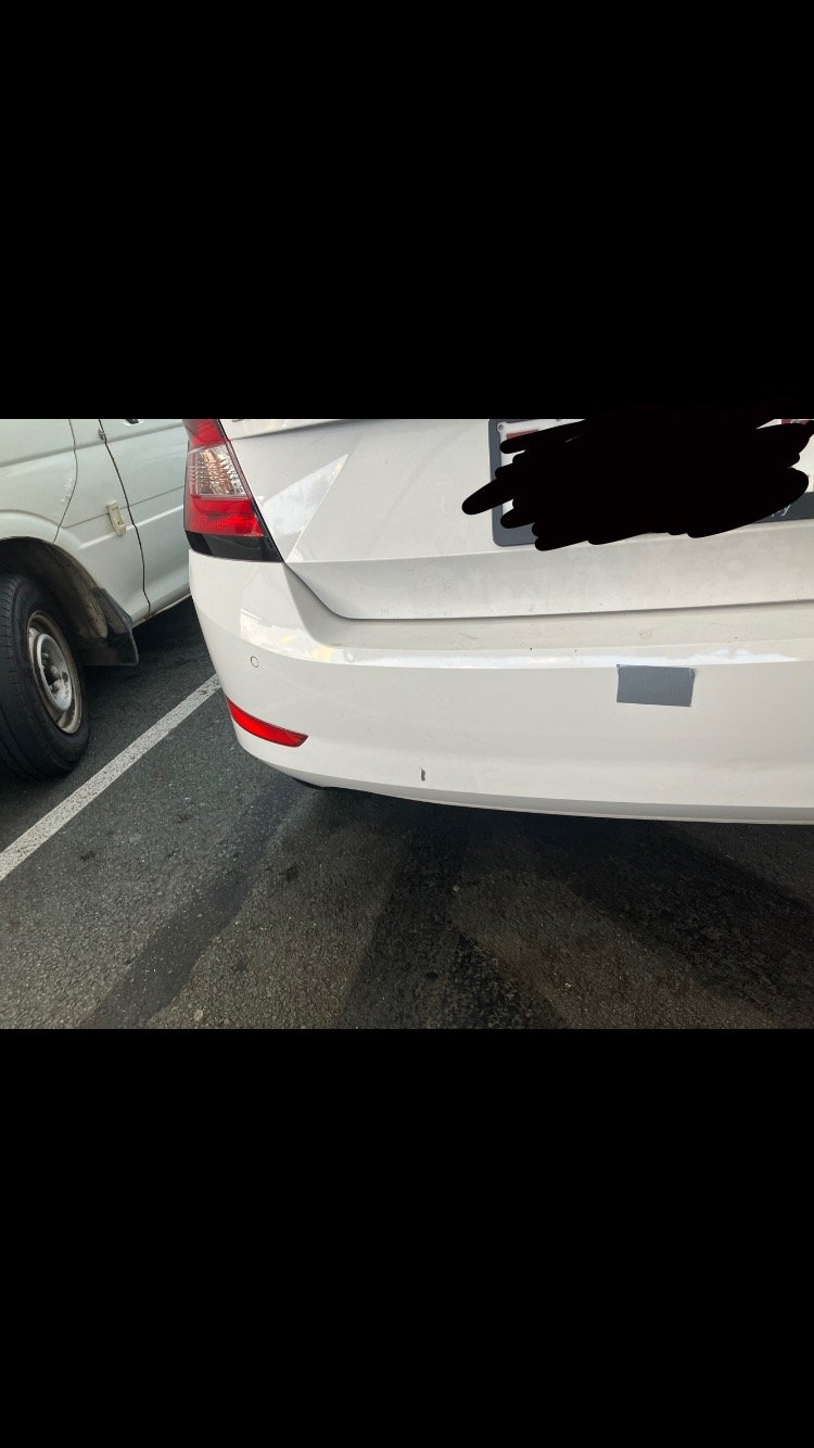

My parking sensor on my soda fabia mk3 has come loose. I don’t have much experience fixing cars but I think this could be a cheap DIY fix, except I can’t find any guides online about how to go about doing this. I found a video on YouTube where a guy shows how to take the rear bumper off but his model doesn’t seem to have the same sensor. The sensor is now lodged somewhere in the bumper and keeps going off every time I put it in reverse. I’ve put some tape on it to stop water getting in. Can anyone help guide me?
It might be that your parking sensors are just stuck to the inner surface of the rear bumper cover using strong sticky pads - and that is what has failed.
Audi, at least, used to have plastic welded mounting brackets for its factory fitted parking sensors to clip/snap into, when I retrofitted front parking sensor to my Audi, I just used some very strong "structural" Araldite as I didn't want/need to get that front bumper cover off again just for that sort of job.
So, yes, unless you can reach up with thin strong hands and arms, to get the old sticky tape off and fit new stuff, I'd think that you will find that you have to remove the bumper cover.
I'd think that in your local ambient temperatures, that substituting double sided sticky pads for a good strong adhesive could be a good idea - and check the other sensors while the bumper cover is off so that you will not need to get back under there again some time later.
Having that sensor hole "open" will not cause any risk from water as the bumper cover is a sort of plastic and the parking sensor is sealed.
Ok thanks. I’ll be following a tutorial to get the rear bumper off and then we’ll go from there cus I’m not sure if I can even do that since I’ve never tried
