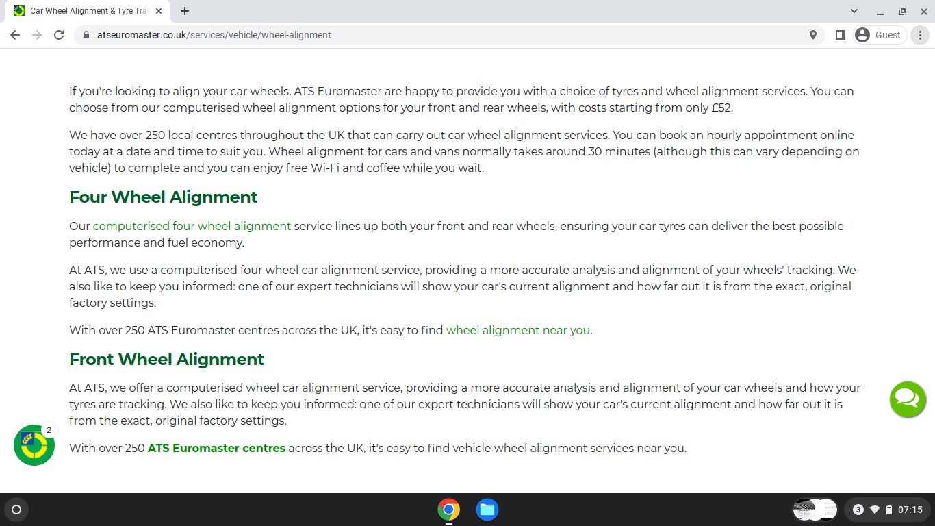

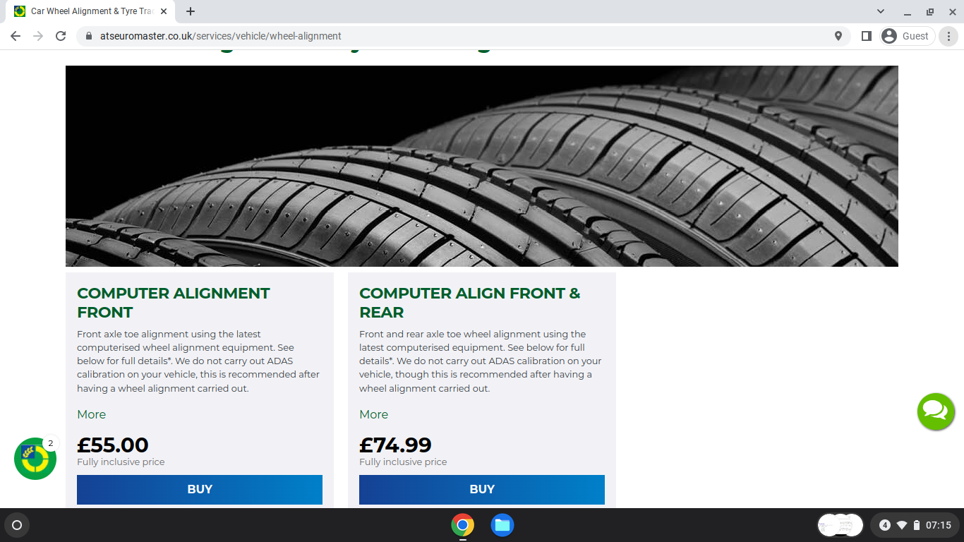

As to ATS Euromaster, First you best check their equipment is actually working. Then the trained staff member is available, then that they can actually make the required adjustment.
& you need a new tyre or 2 or 4 most likely.
