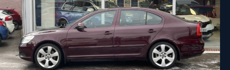

Hi, new to this, I recently purchased a mk 2 Octavia 2.0 TDI cr SE, it has got 18 inch wheels on it with 225/40/18 tyres, is this ok as I thought it was 15 inch wheels as standard on this model? Thanks

They might be L&K wheels or sport wheels as opposed to SE. 16” the best compromise for comfort and cost. I have a set of pre-FL vega wheels on the forum classifieds if interested

Hi Gav, have found out they are of a superb, will have a look at yours, thanks 👍

They are called Luna alloy rims from the Superb MK2 with OEM part number 3T0601025K as shown below.
The standard offset for the 18" Octavia MK2 rims is ET51, whereas the 18" Superb MK2 rims use 5mm less offset, ie. ET46...so the centre of each wheel moves out by 5mm each side in the wheelarches.
3T0601025K 7ZS (chrome coloured metallic)
7.5Jx18 ET46 5/112 57.1

Ok, so are they ok on the Octavia? Thanks
