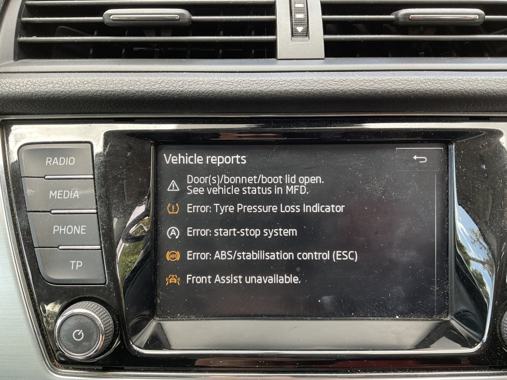

HI everyone - just had ABS/Stabilisation ,Front Assist unavailable, errors - which could be a wheel speed sensor.

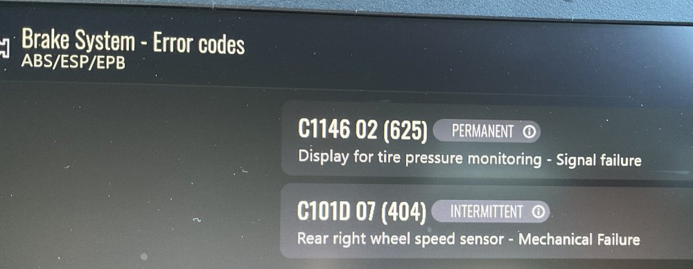

I have a MAxiECU scanner with the Skoda module, and when I interrogate 11 modules I get the following report:
Can anyone help me decode the numbers.
System: Brake System
ECU Name: Bosch 9 ESP (UDS)
000271 Permanent Unknown fault code
000224 Intermittent Unknown fault code
000194 Intermittent Unknown fault code
ECU Name: ABS/ESP (UDS)
0x000271 Permanent Unknown fault code
0x000224 Intermittent Unknown fault code
C10B422 Intermittent Vehicle deceleration; upper threshold exceeded

I scanned all the modules and the errors above were reported - but these numbers need to be decoded into an OBD code or some other plain language.
I put these numbers in google with no luck hence I posted here.

Solved -  by updating to the latest software for my scanner - cost another 65USD. There were some fairly large database files and a firmware upgrade for the bluetooth dongle.
This time The DTC,s were correctly decoded and suggested the right rear wheel speed sensor.
This was confirmed by graphing each wheel speed sensor output via the new software - finding a dealer with the part in stock was the hard bit.
20minutes to change it and all back to normal.
