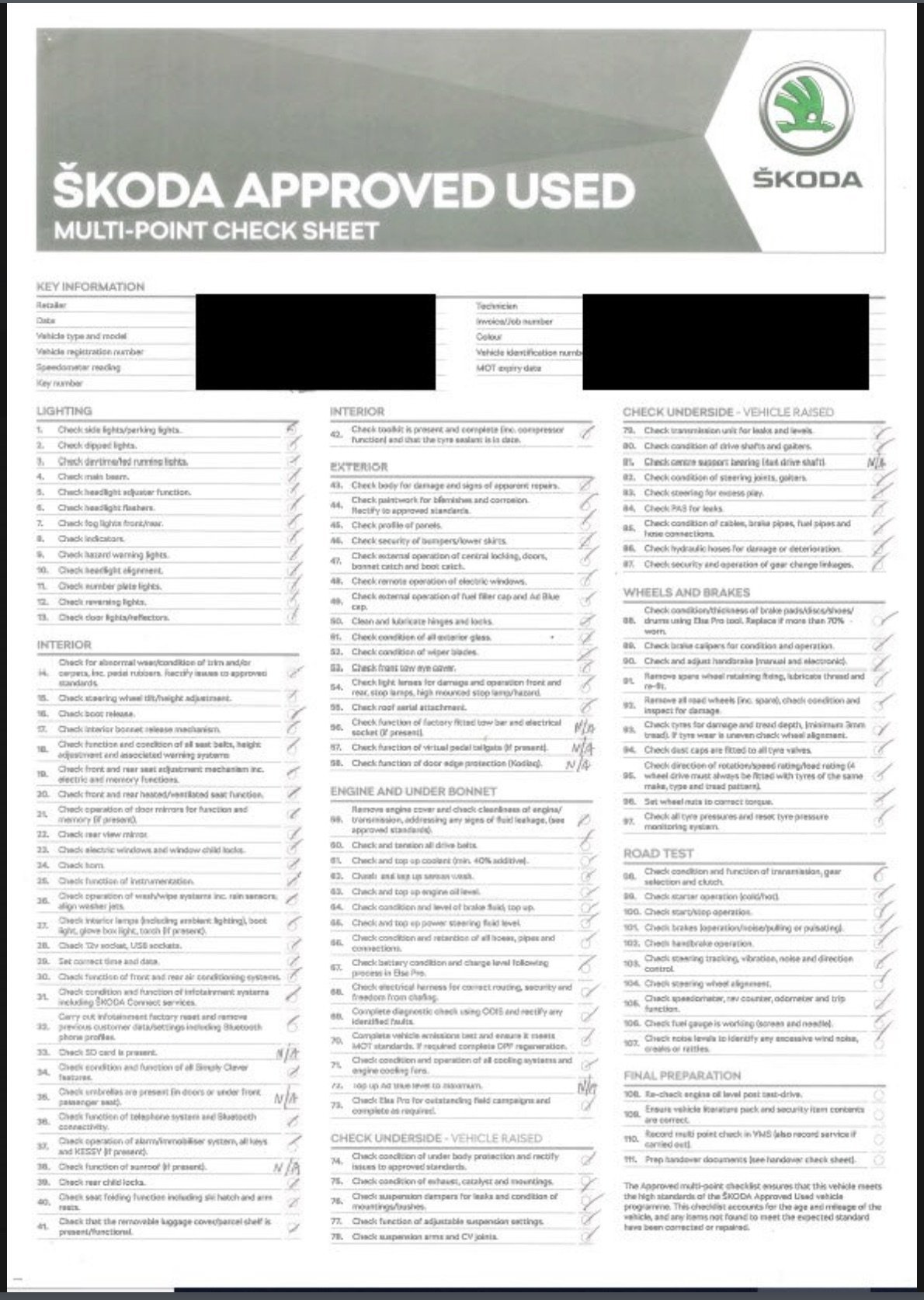

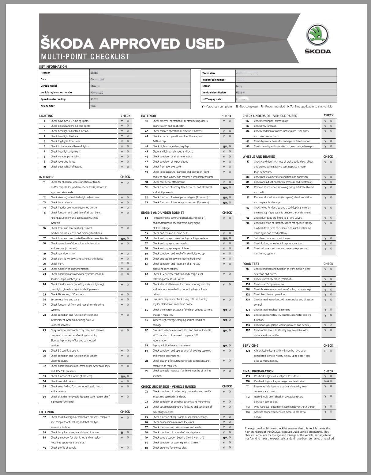

@Gaz posted this earlier in the About to buy a Skoda section.
Very handy to have.
Be sure they are doing as they should.  Not just expecting where it came from to have done.
