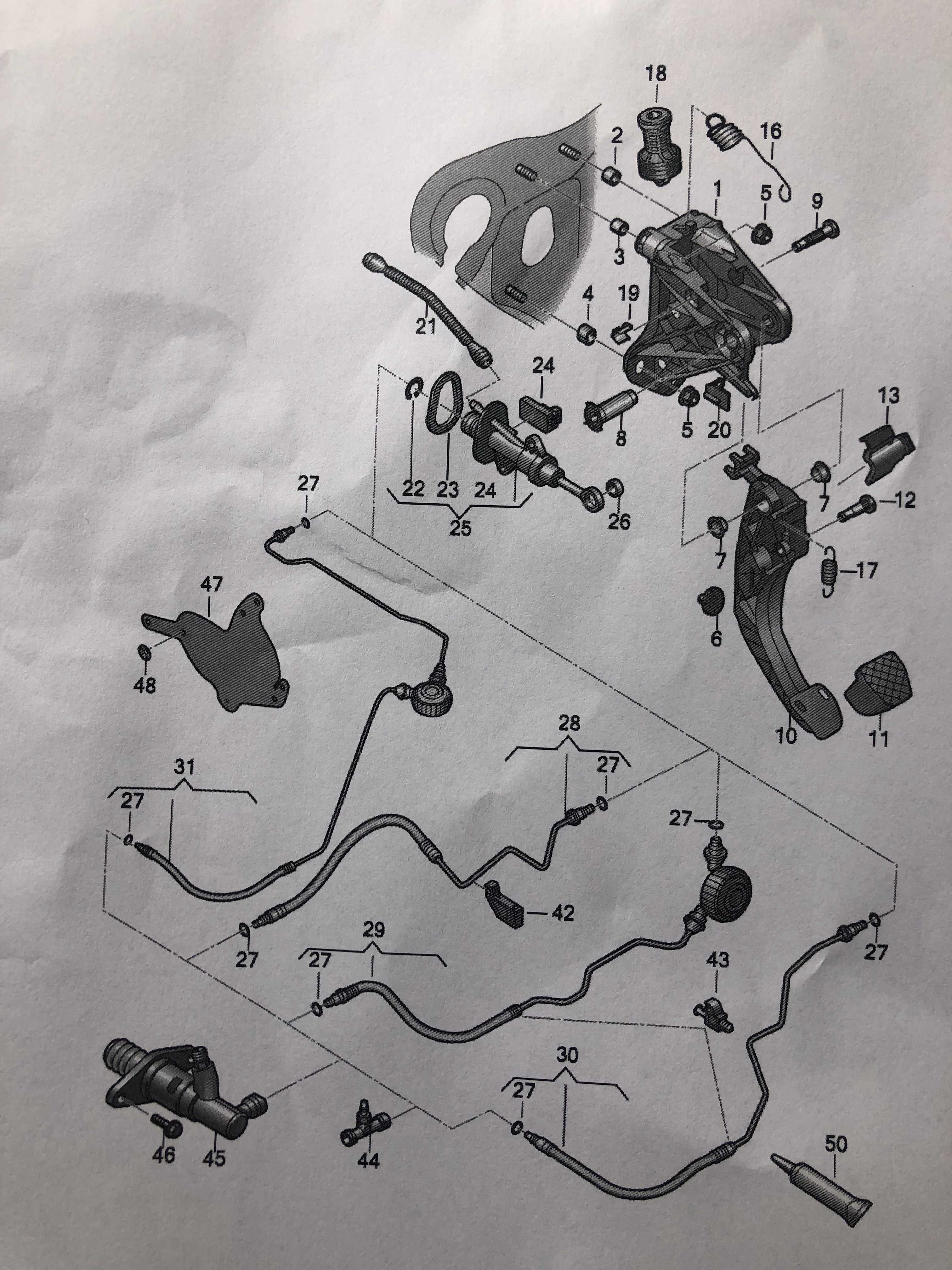

I assume the concentric cylinder is the one inside the housing? I got the attached from Skoda parts yesterday with the parts man confirming the slave is external.
So, is it still quite likely my slave cylinder might be allowing a bit air in?
the mechanic seemed to think the whole master cylinder might’ve been plastic and was causing a bit trouble but maybe indeed he’s wrong. It looks like the body of them is metal.
