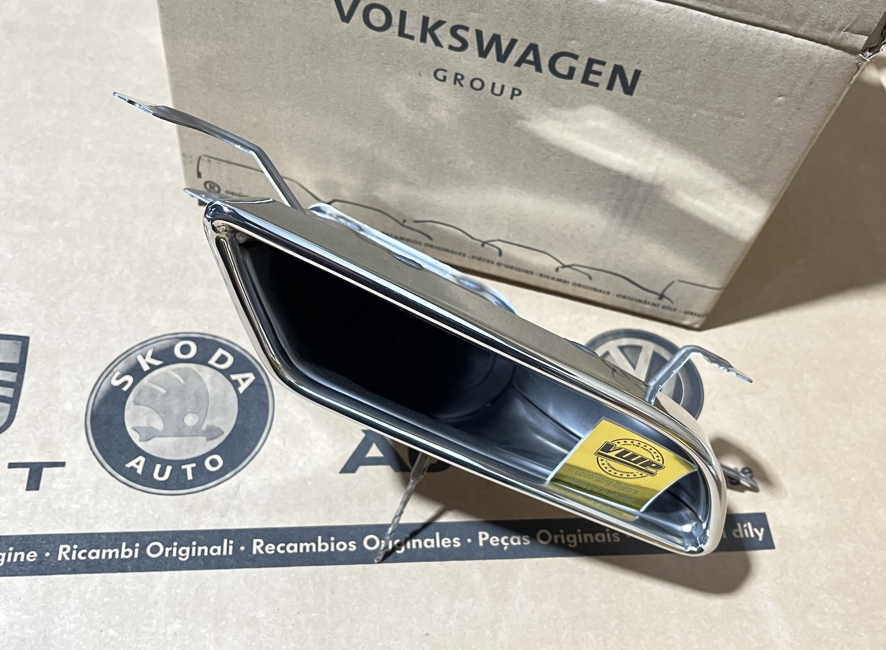

New to Octavia and was wondering how to remove the exhaust tips that are in the rear bumper, I know they are not part of the exhauat on one side just a fake tip. I want to remove them and spray them black to blend in a bit more.
Any info would be helpful
This is the part I am on about.
It's fairly easy, 4 x T25 screws (or T30, it was a while ago) holding each side in.
I ended up taking out all that size screw holding the lower section of the rear bumper out - just to make more room to wiggle the tips out.
Reason for taking them out was to get them powder coated black.

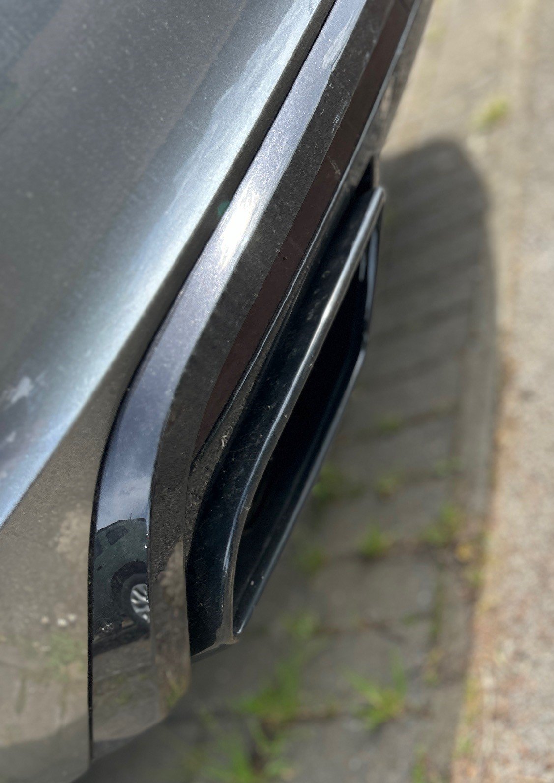

I took mine off and had them powder coated by my local wheel refurber, £30 each. Personally I think they look better. Taking them off was fiddly but just two torx screws on each side, you need to take the rest of the torx screws across the back off too to get access, you'll see what I mean when you look under. If you can jack up the rear slightly that really helps. In the picture above, the top 2 brackets push into slots  in the exhaust surround and the bottom 2 have the screws. From memory it took about 30 mins to take both off.
I'm not sure how well this shows the black. I also tinted the reflector strip (please don't tell me about legalities, I'll live with them if there are any)
