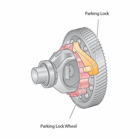

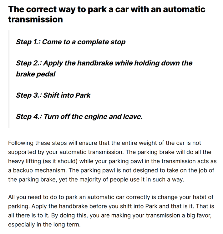

@Winston_Woof Is that it parked and parking brake on, do you not select P?  Trusting to the Parking Brake.
That has been the issue posted about on here before,  brakes cooling and cars running away.  But then that can be a manual or a DSG.
They can start in P or N.  Below -8*oC you can not start them in N.
And after putting it in neutral it goes into P lol
Why is it in N or do you mean it goes through N and R to P.?
Or are you in N, then engine off and to P.    Each to their on.
I mostly reverse park so once into the space it is shifter to P with foot on brake, and e-brake on or Parking / Hand brake.

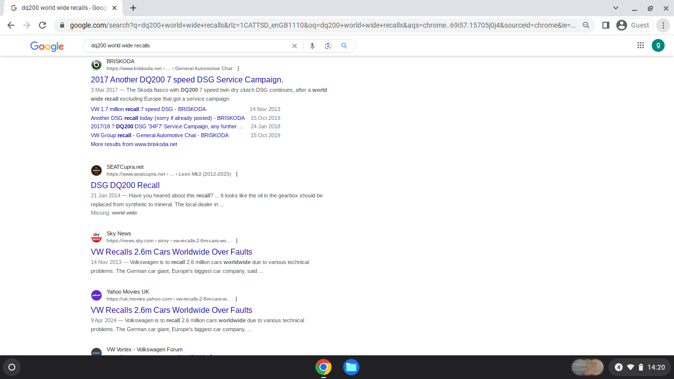

The DSG and DCT semi autonomous gearboxes get most of their bad press from Americans. A country that has used automatics by default for a long time, using a stick shift is unusual.
They are used to Torque converter automatics and expected to treat this modern tech the same way.  For the most part you can but there are times when circumstance demands driver interaction.
The DSG get the bad press for those that know about the bad press, as the press were to light on VW over the Global Recall of DQ200 DSG,s in 2012.
That was World wide / Global excluding Europe because VW tell Germany to tell the EU what is an issue.
So the Synthetic Oil had to be changed for Mineral. In New Zealand just a Service Campaign but each car got a new MCU.
In China and elsewhere in Asia they got a 10 year / 100,000 warranty extension.
In Europe it was 2014 before a Service Campaign was started.  In Australia the recall from 2012 has been repeated 3 times now.
So that was first 2009-2012 DQ200,s.
Then the Service Campaign 2017 on 2013-2015 ones. Software Update.  & the TPI,s Clutch and Software Updates. Right up to 2018.
Then still some issues since.

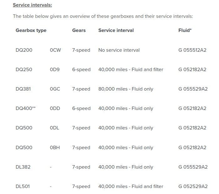

Does my Fabia 2022 plate have a DQ200 DSG? Is this the newer type?
You have a DQ200 7 speed Twin Dry Clutch DSG and by 2022 Skoda should have them as good as they can be.
It is Skoda that have been building them in Europe for the VW Group since 2015.
(They were building some for some of the 48 applications before then.)
No servicing of it required.  Not at 4 years or 40,000 miles if someone at a dealership says they need that.
