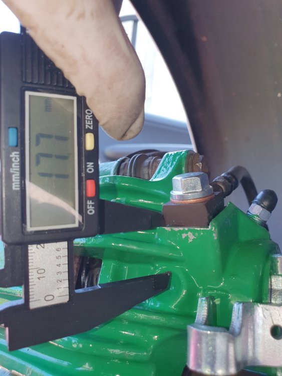

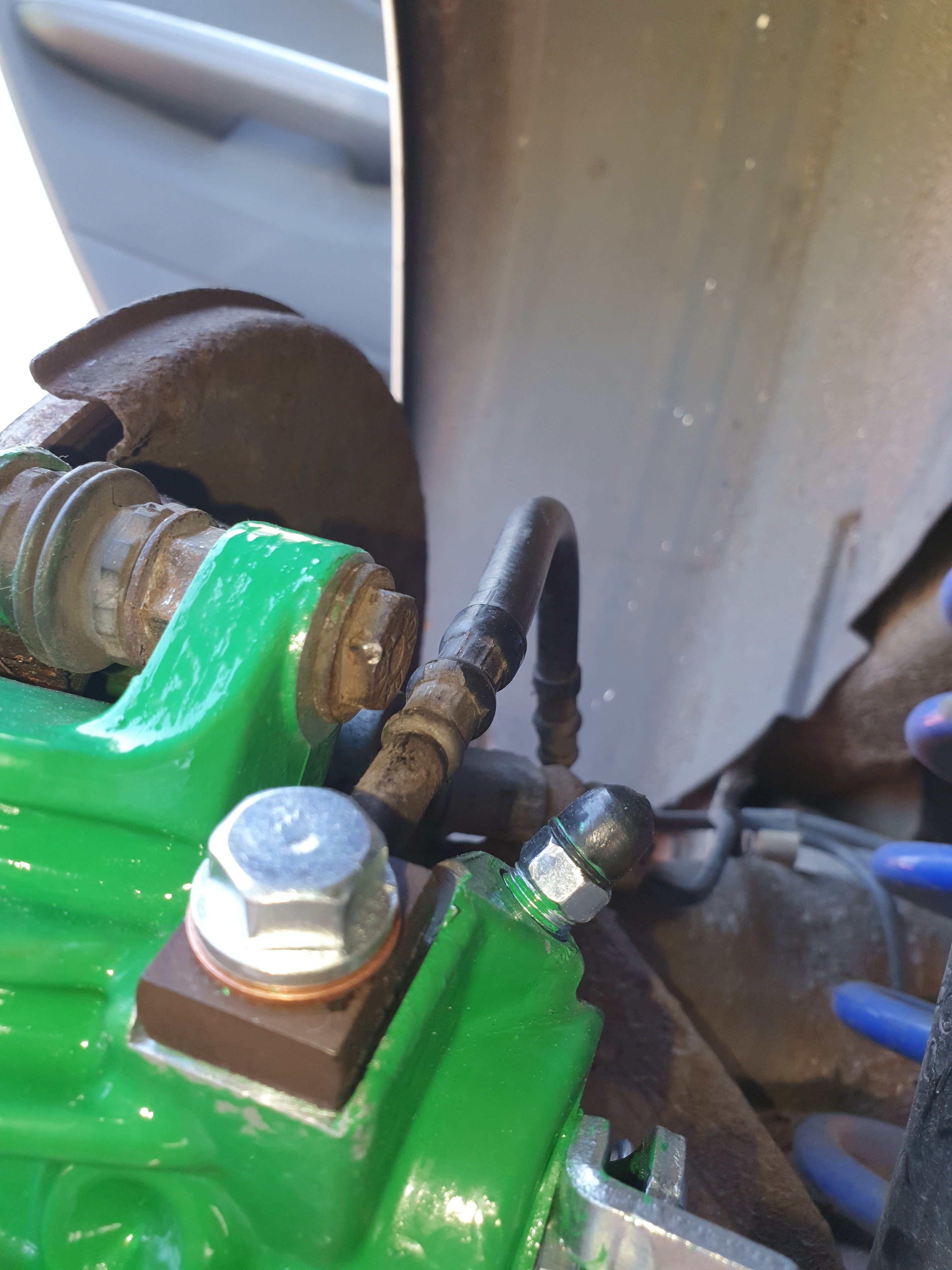

Hi Folks, I have a bit if an odd issue with a  replacement NSR caliper fitted to my 55 reg Fab Vrs. (Purchased from a renowned ebay seller)
The caliper fits perfectly and works as it should but the issue is that the angle of the brake hose prevents the top caliper mounting bolt from coming out due to the hose fouling the loosened bolt. There is no other position for this hose to be, where it bolts to the casting.
The first pic is the new caliper showing the fouling hose and the 2nd picture is the OSR caliper showing plenty of clearance.
The seller insists this caliper is correct and he has sold over 200 units with no issues.
Has anyone come across this problem before? Any thoughts appreciated.
That's a weird one, it looks like the flexi's wrong for the caliper if anything. There's no chance the flexi's upside down is there? I'm wondering if the banjo's thicker on one side than the other.

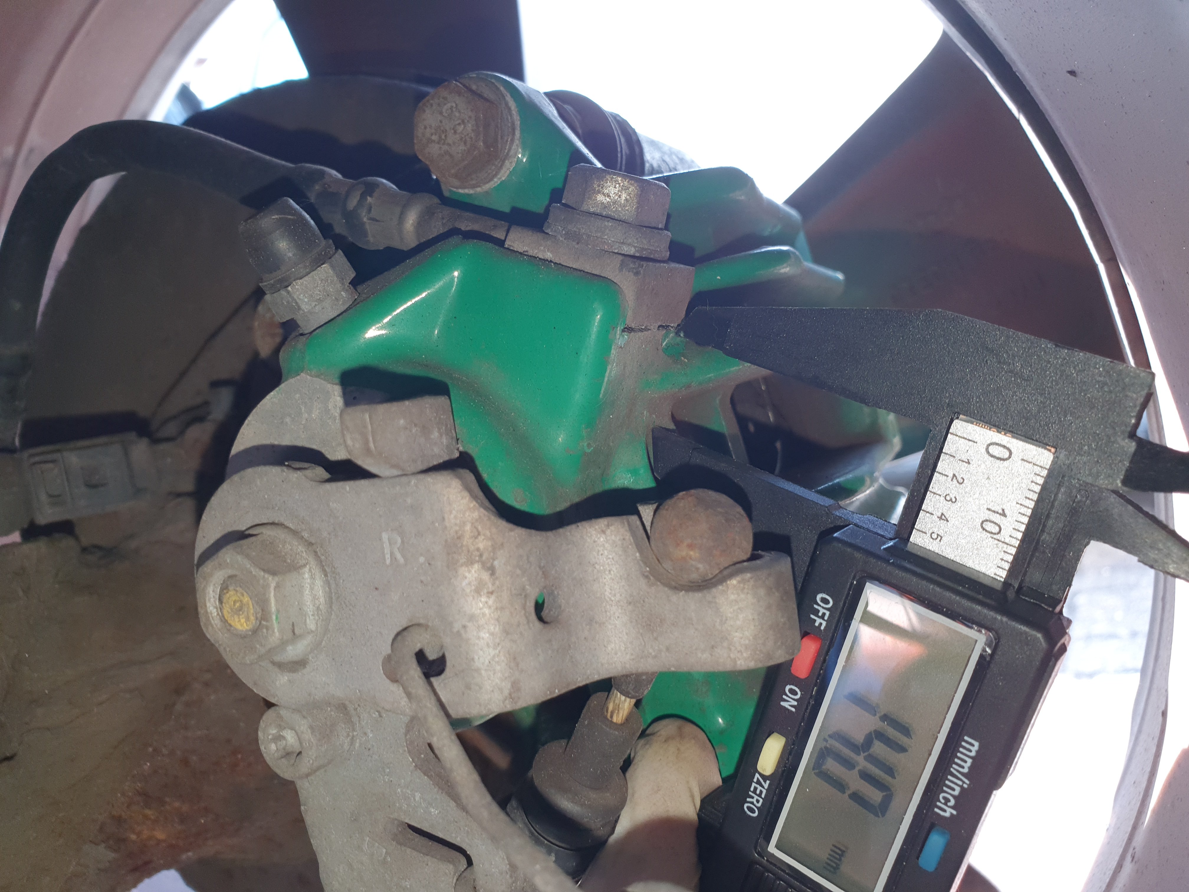

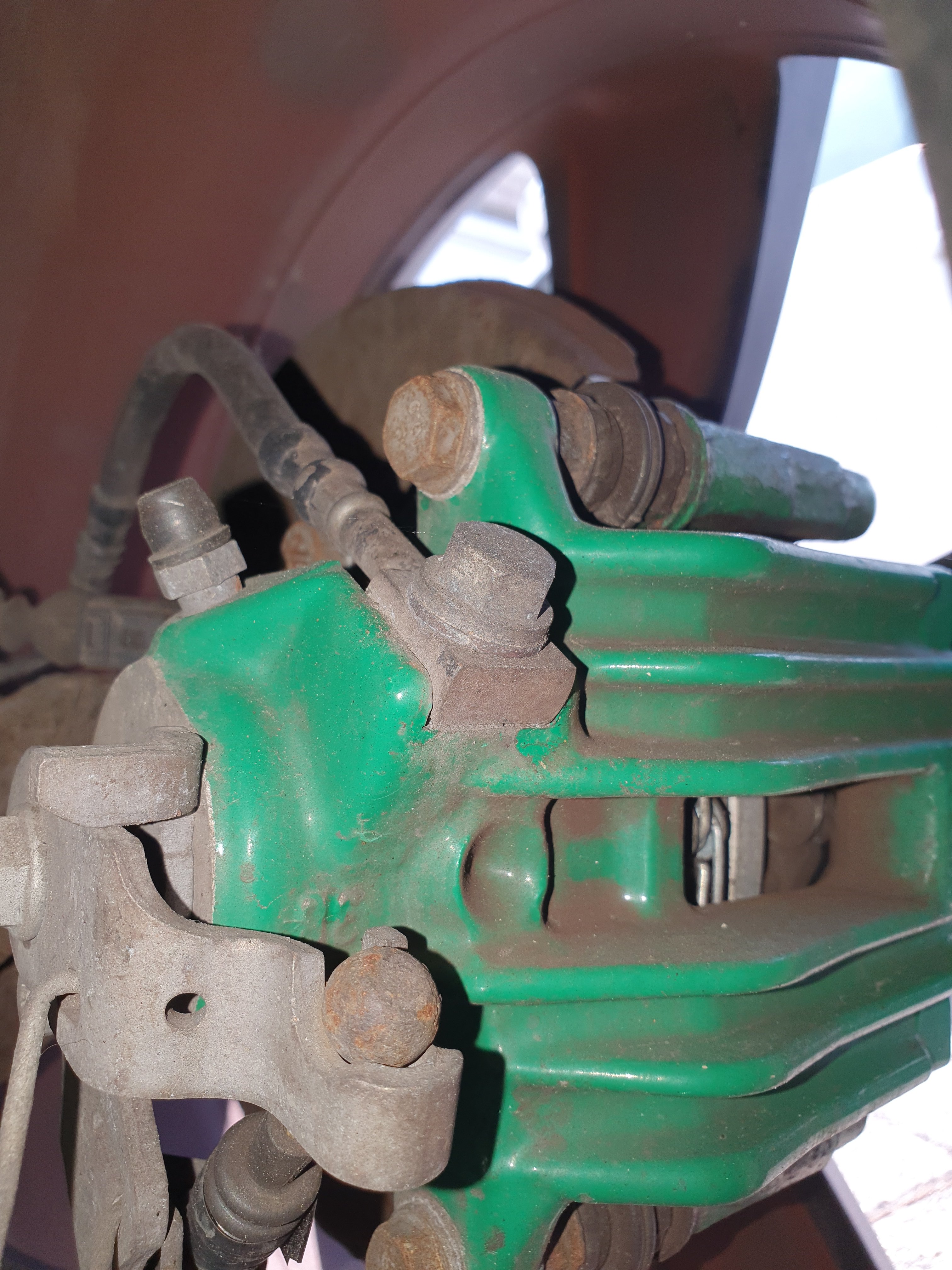

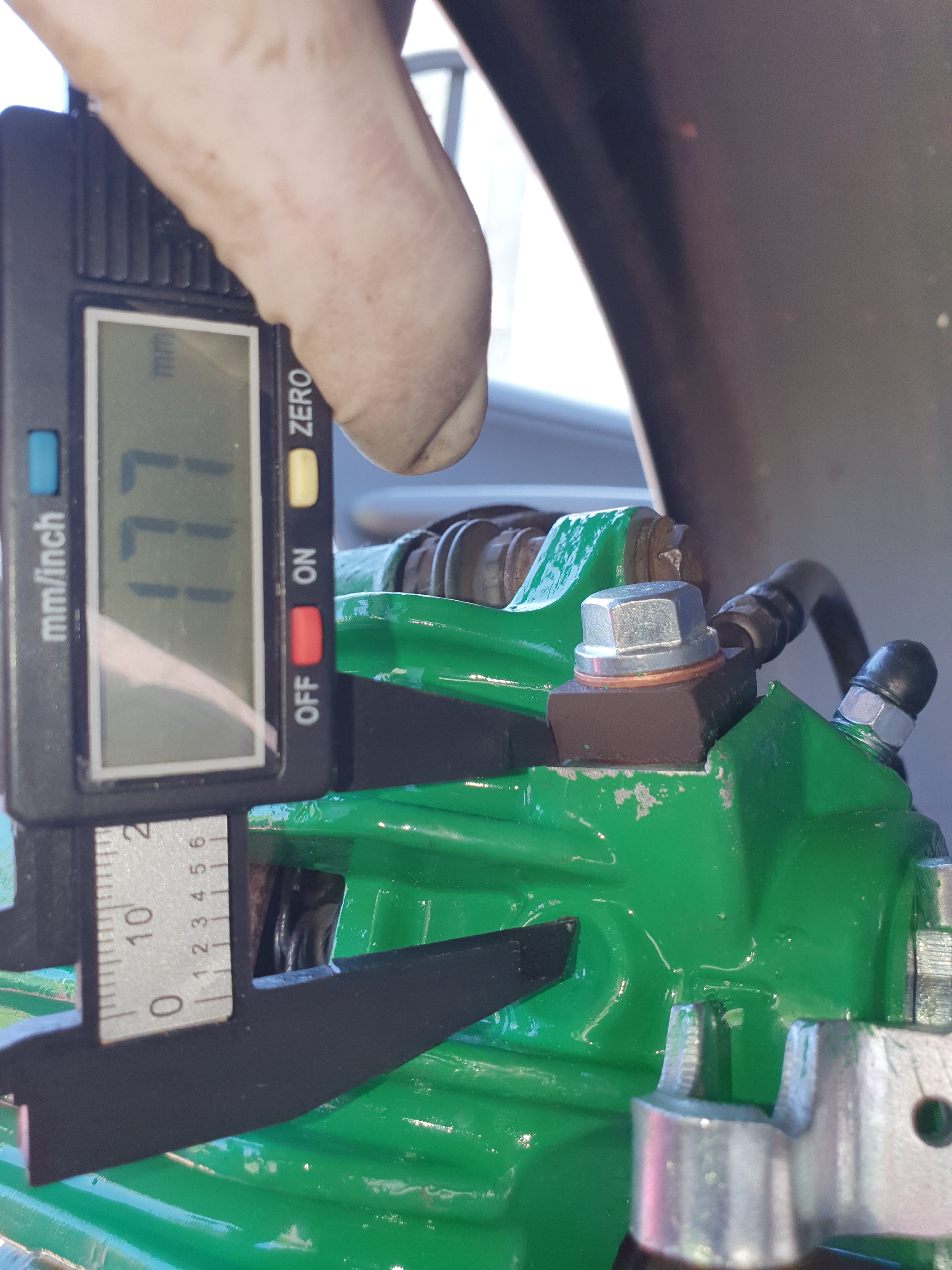

Hi Steve. The hose is in exactly the same position as it was on the original caliper and this was fine. I've taken a couple of measurements since posting and it appears the casting that the hose attached to is slightly taller. Very strange as everything else is perfect. I just wondered if anyone has encountered this before? Pics attached are new NSR caliper vs existing OSR.

Send the seller those pics and say you'd like one with the right measurements, please.

I was going to suggest that the copper sealing washers on the banjo bolt look to be too thick, but seeing the difference in the same measurement side to side in the pictures, what I was considering to be thicker washers, just pales into insignificance.
So far the worst thing that I have had when buying a re-manufactured rear Lucas calliper was what looked like a "garden shed" job of repairing a stripped bleed valve hole - I just handed that otherwise okay calliper back.
Edit:- this makes me think that I should take a look at the one I fitted a couple of months ago, seeing as the  fluid line was the bit I did last - I had filled up the calliper with fresh fluid before putting the fluid line back on - just to displace as much air as possible, as I just bleed it using a Mityvac hand pump after removing my sealed cap from the reservoir.
Maybe it has a different size of piston, ie meant for another car, if so another reason to return it. I think that there were 34mm and 38mm versions of that model, and just maybe 41mm pistons. The pistons on my wife's 2015 VW Polo 1.2TSI were 38mm, I wasn't that trusting, I measured both piston sizes of the original calliper and the re-manufactured one. Plus I went over the new calliper with a digi calliper to check what I considered to be all relevant measurements.

I have done that today and they have agreed to refund me. I am looking to leave the caliper on now though, as it appears okay. It's just a pain when wanted to replace the pads etc.
