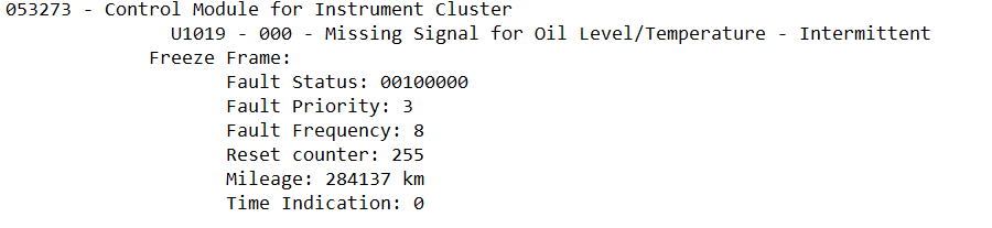

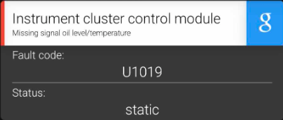

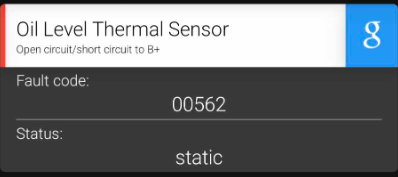

Update is i have this error:
Is this enough for the engine to not fire?
No way
11 minutes ago, Breezy_Pete said:
No way

I might be tempted to see what else is fed by the fuse that powers the oil level/temperature sensors.

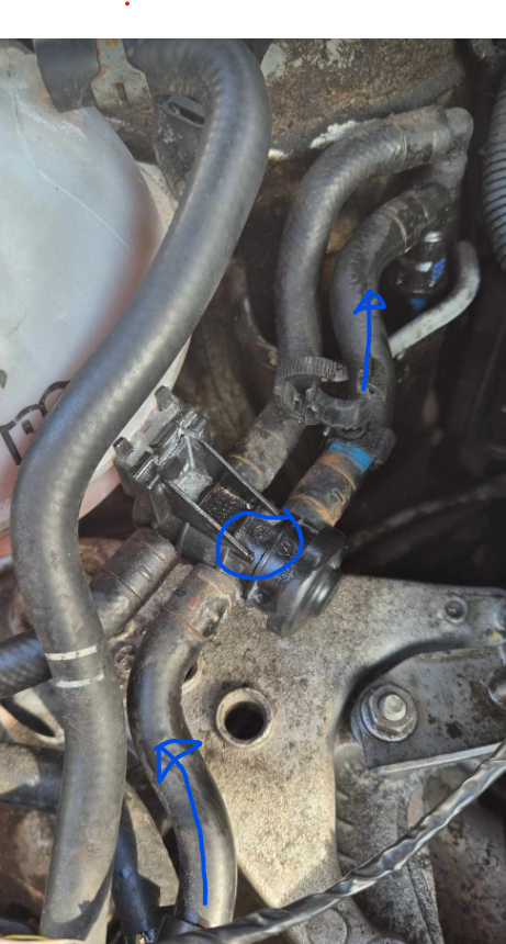

Not sure if a stuck closed anti-shudder valve might be consistent with the observed behaviour?

I will check the anti-shudder valve - if i can find it.. xD

Regarding oil level, this car does not have such sensor. I found a thread where other people had similar issue due to software updates. I dont know if this is the same issue here, the fault has always been there.
I checked the Oil pressure sensor and the connector and sensor works fine, further no error in dashboard.

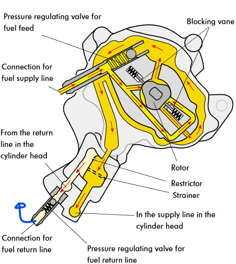

I tried to bleed the entire fuel line and found that there is some resistance in the return line, is this normal or should it flow with no restrictions?
image.png.e32518de1bd2d9726a0d48f6e05d566e.pngimage.png.9ac4930511bfbb20726686fee65aa19b.png
So after quite some time trying I finally managed to get the car started and running.
So after some time thinking, the only thing that did not make sense was that the glow plugs was always dry when taking them out of the engine.
so the problem must be the fuel system. Everything worked fine from tank to tandem pump, as that was easily checked. my last unknown was injectors and tandem pump.
so I did a google marathon in BMS (motor code) tandem pump and found this link from an Audi forum: how-to-prime-my-1-4-tdi-after-remaking-t
I tried to bleed the pump the exact same way as the guy in the forum suggested but without any luck. A few hours later and a Tandem pump in a lot of pieces I managed to conclude that the procedure was a waste off time.
I ended up having the feed pump running for 2-3 min while trying to drag fuel with the vacuum tool out of the fuel return line on the tandem pump, connected the fuel lines a again and then the engine started.
