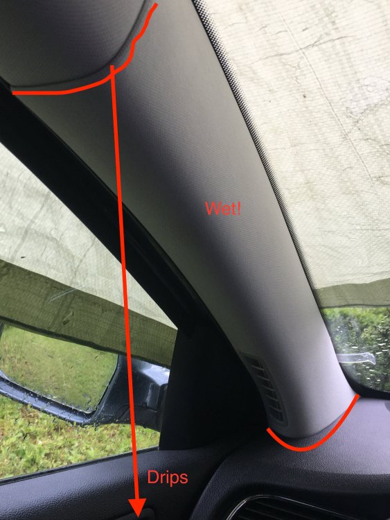

Starting this winter (no accidents or repairs), and only when it rains very hard, I have been noticing that the driver side (in my case left hand drive) A pillar trim was getting very wet to the touch, the outer fabric dripping with water. Now car starting to smell like mold.
Sometimes a couple drops of water will be located on driver seat which would indicate that some water is getting under the headliner. Strangely the headliner is never wet to the touch. I do not know where to start since removing the A pillar trim is quite difficult without specialised tools, and I do not want to damage the airbag.

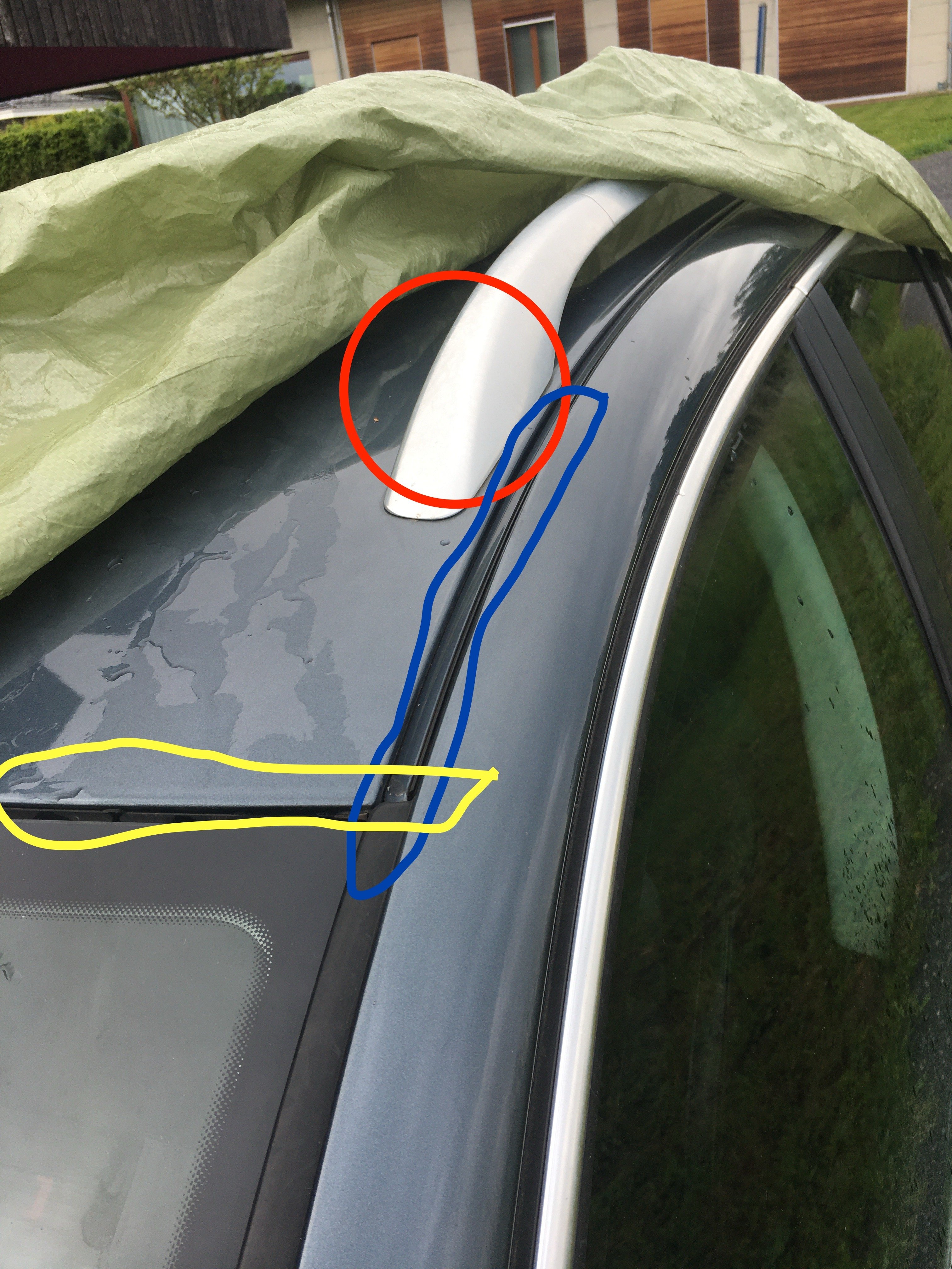

I can see only 3 possible sources of water (see attached pictures):
1. Roof bars bolt holes: I have used a box with heavy loads in the past, can the bolts or seals be loose? Feels sold to the touch (red on pic)
2. Windshield seal issue (yellow on pic)
3. rubber seals between side and roof panel (blue on pic)

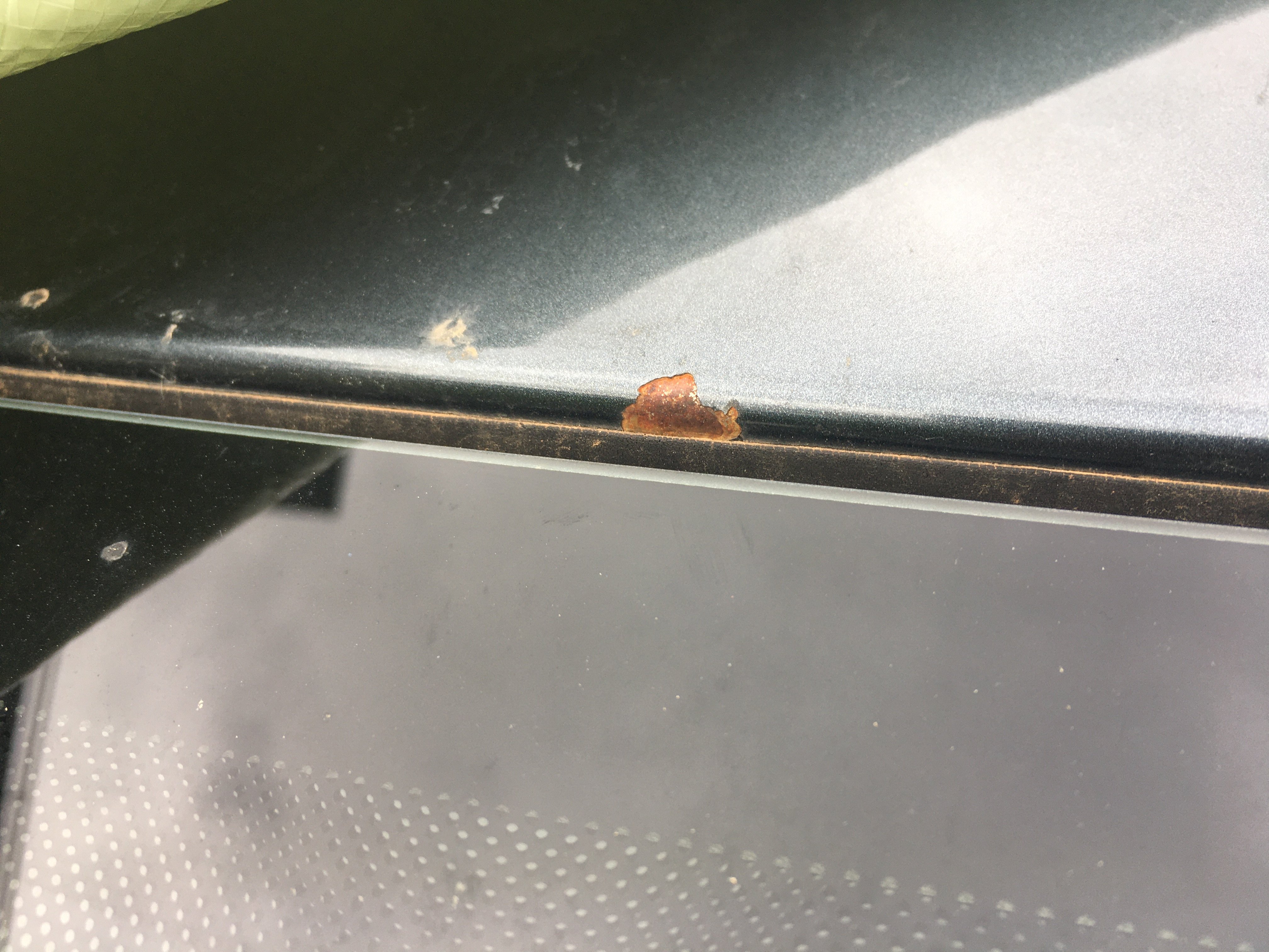

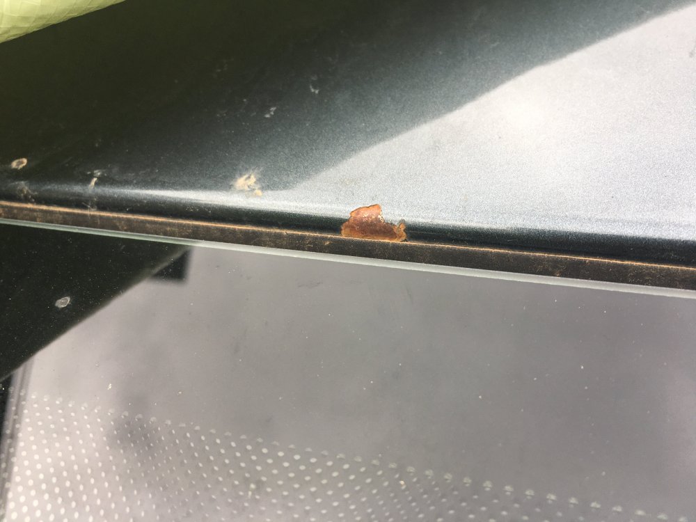

I added a picture of a rust spot that I just located at the top of windshield/roof, but this is about 40cm from the corner of the windshield so i think it is unlikely that this is the cause. Maybe I can rule that one out by putting a bit of silicone on it as a temp fix!

I'd be pretty certain that will be the windscreen seal that has started to harden and unstuck somewhere.  We had similar on our Fabia estate and Octavia 4x4.
You can check by sticking electrical insulation tape around the top and sides of the screen between the screen and bodywork to see if the water ingress stops.  If it does just seal the windscreen to the body again using polysulphide sealant over the top of the original.

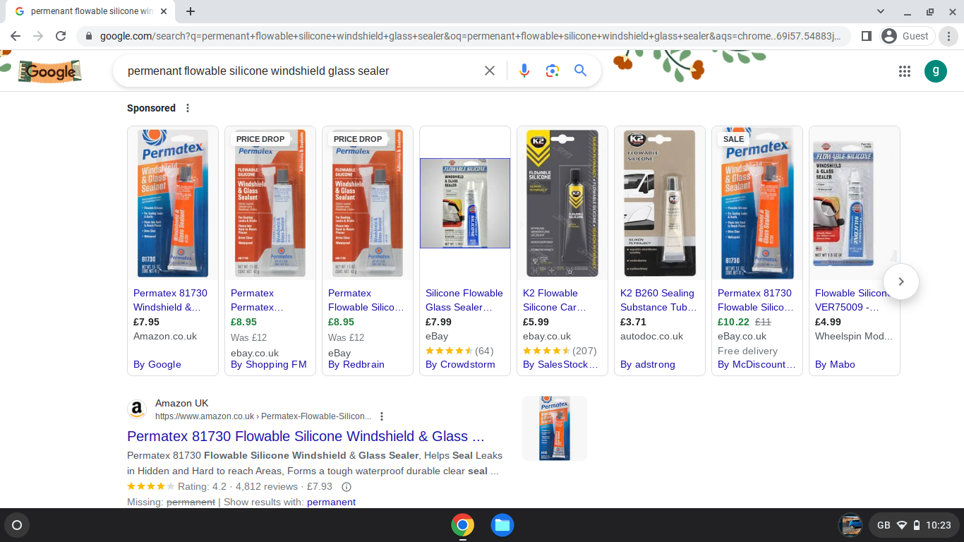

Thanks Skomaz. Can you point me to an example of appropriate sealant? Seems like some people are recommending this product, but seems only sold in north America:
https://www.permatex.com/products/adhesives-and-sealants/adhesives-sealant/permatex-flowable-silicone-windshield-glass-sealer-1-5-oz/
Thx.
C.
I doubt that is a polysulphide screen bonding compound, flowable sealants have their uses on older traditional wrap round windscreen sealing rubbers that seal against the glass on on part of the cross section and the bodywork flange on the other but I doubt will be effective with a broken down bonded screen joint, that said the correct compound should be used after removing the screen, removing all traces of the old sealant from the screen and bodywork, cleaning and preparing the joint, putting it around the existing leaking compound is like using a band aid but it does stick like **** to a blanket if the area is properly prepared.
A flowable sealant if they even do what is said on the tin will be trying to seal a capilliary gap full of road dirt and damp.
