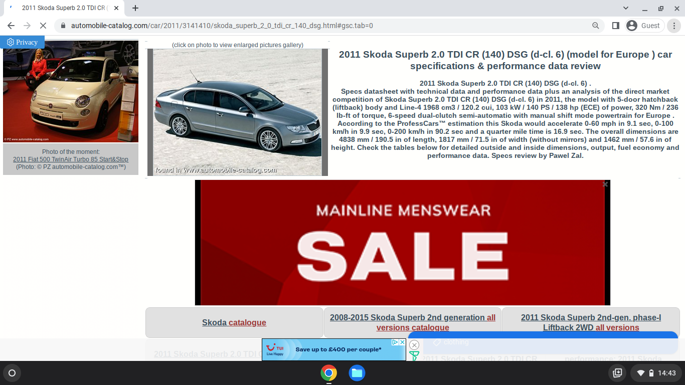

doesn't the 2.0TDi 140bhp model have a dry clutch as well with the 2.0TDi 170BHP model having a wet clutch?
Edited by Winston_Woof
DQ200 7 Speed Twin Dry Clutch DSG are only used with engines with a maximum of 250 Nm.
Thanks all. They have now confirmed it is a 6 speed wet clutch and will service it as part of the sale.
