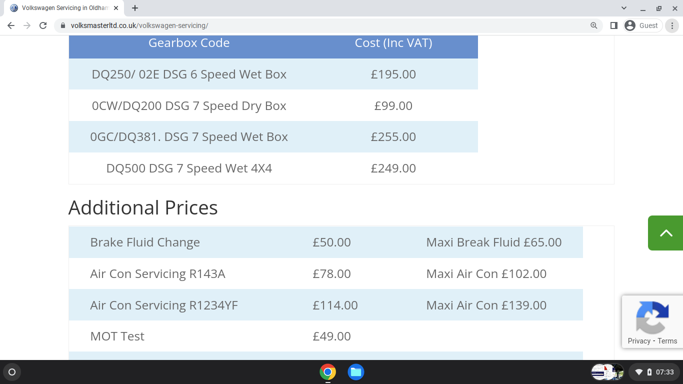

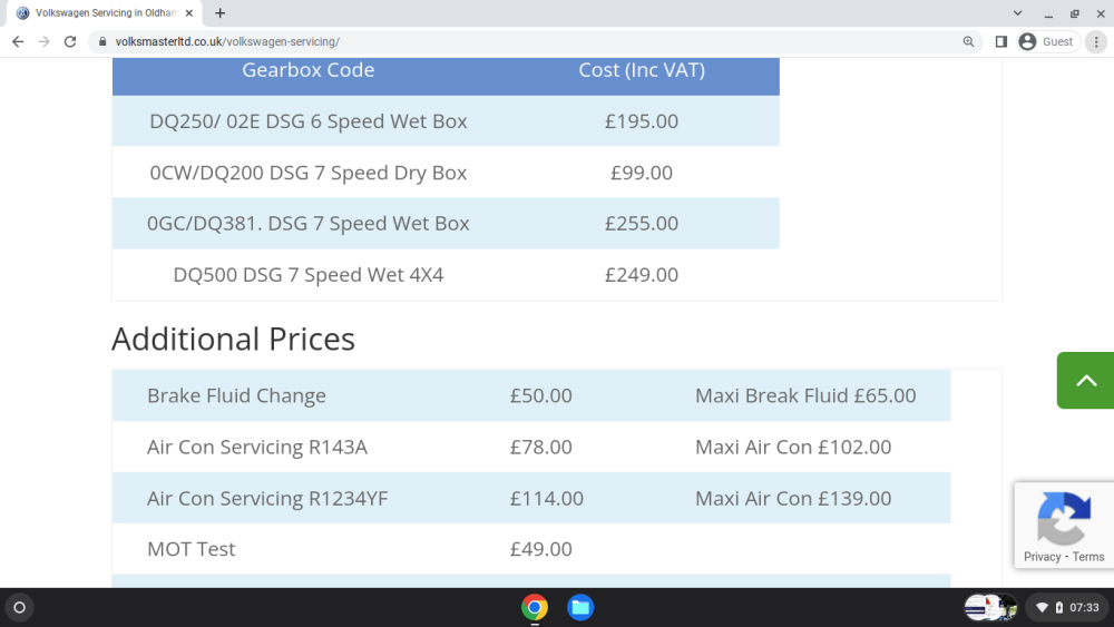

@tfsparkthat looks promising, fingers crossed it’s the solution. Roughly how much was the service kit?  I know I mentioned circa £200 previously which @Ootoherequeried, it was based on what I had paid the local VW dealer (parts and labour) for each of the three services on the DQ250 in my Touran. I’m thinking that I will have the DQ381 in Karoq serviced around the 30k miles.
The service kit I used was from Ebay and it cost £86.95.
It consisted of 6L of Millers DSG oil, a Febi Bilstein oil filter with seal and two sump plugs with washers.
I'm probably going to get shot down in flames for not using genuine VAG components but it's a chance I've taken.
As it is the VW Group / Skoda buy in the consumables, they do not manufacture / produce them.
DQ250 servicing is not quite as involved as doing the DQ381.
