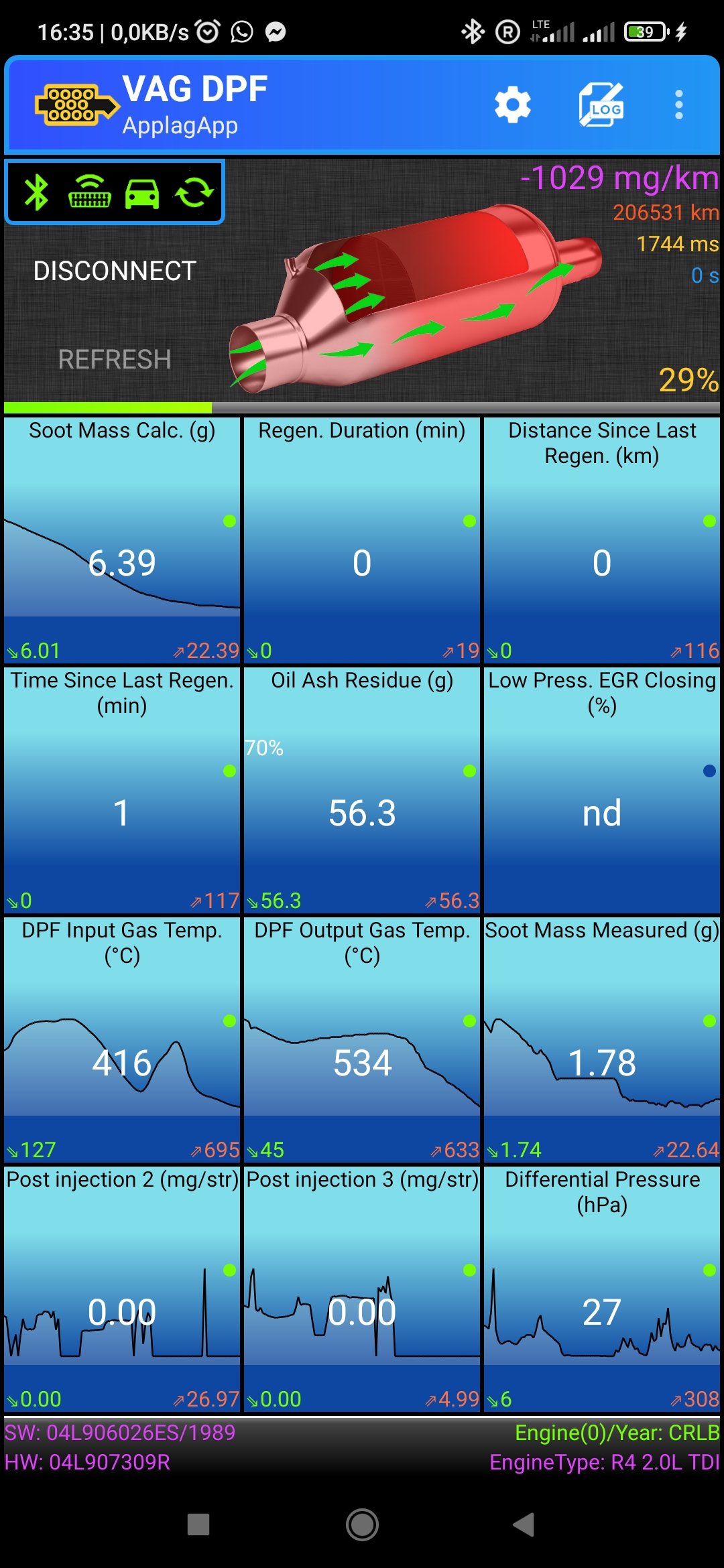

Just observed on Vag DPF, Soot mass measured going up very quick. Trough regens all going fine, i mean decent temperature and whole process going correct.

Here's mine for comparison:
Yes, CRLB code, correct engine for me.
