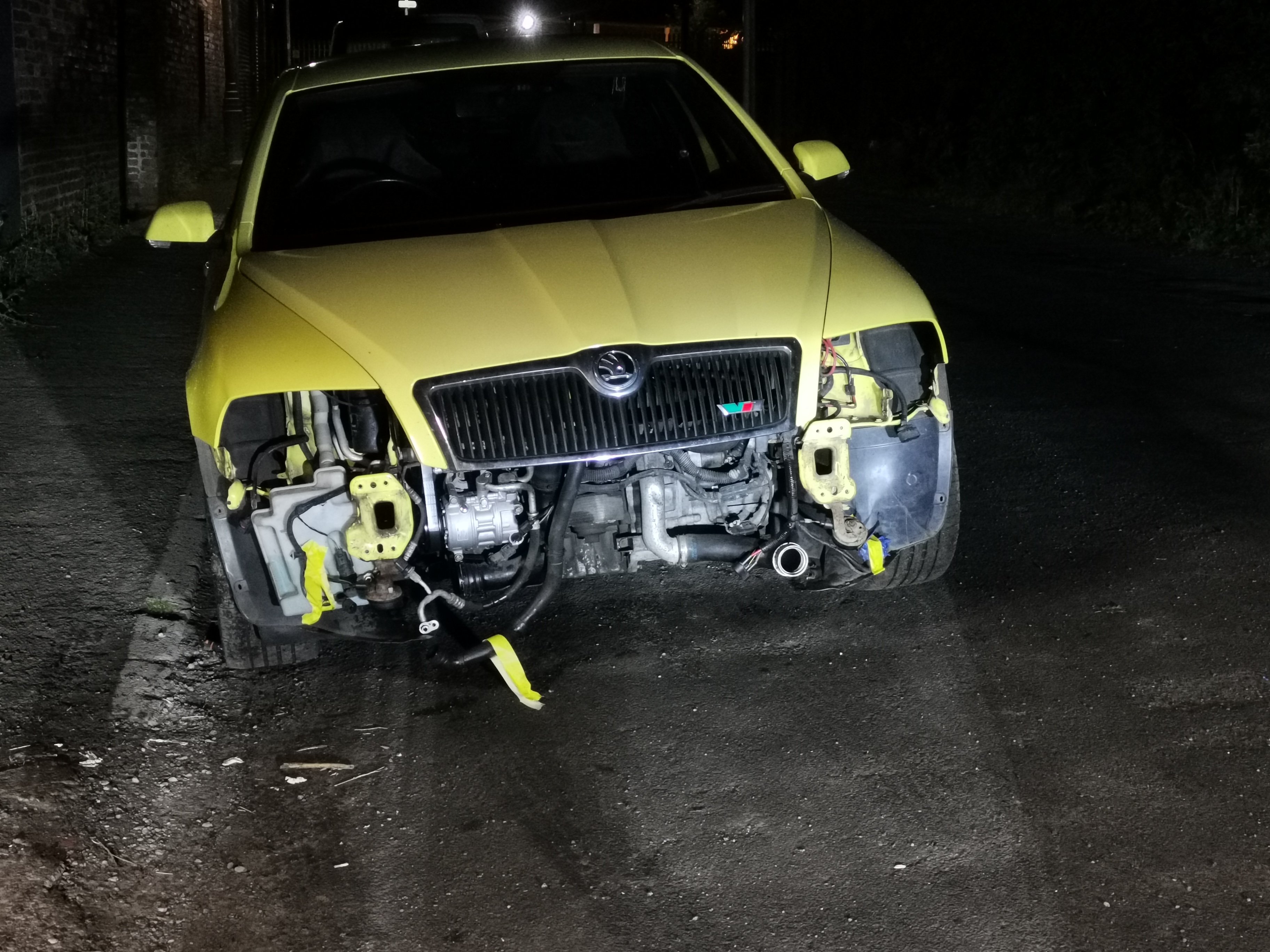

Car is a 2008 vrs BMN. Could someone please explain to me like I'm a dummy, why oh why will air conditioning not engage after I have replaced my compressor, condenser and  o rings? Car has had a regas and the outer temperature sensor had a snapped wire - must have been damaged when removing bumper to gain access to the radiators but I had forgot about it. Anyway, soldered the wire and temperature readings are OK, but air con still won't kick in! I dont even see  an increaso0e in revs when I turn the temperature down to the lowest setting.
Mechanic said it took all the gas, no leaks, and saw no issues other than the temperature sensor. What would cause it not to engage 🤷🏻‍♀️?
