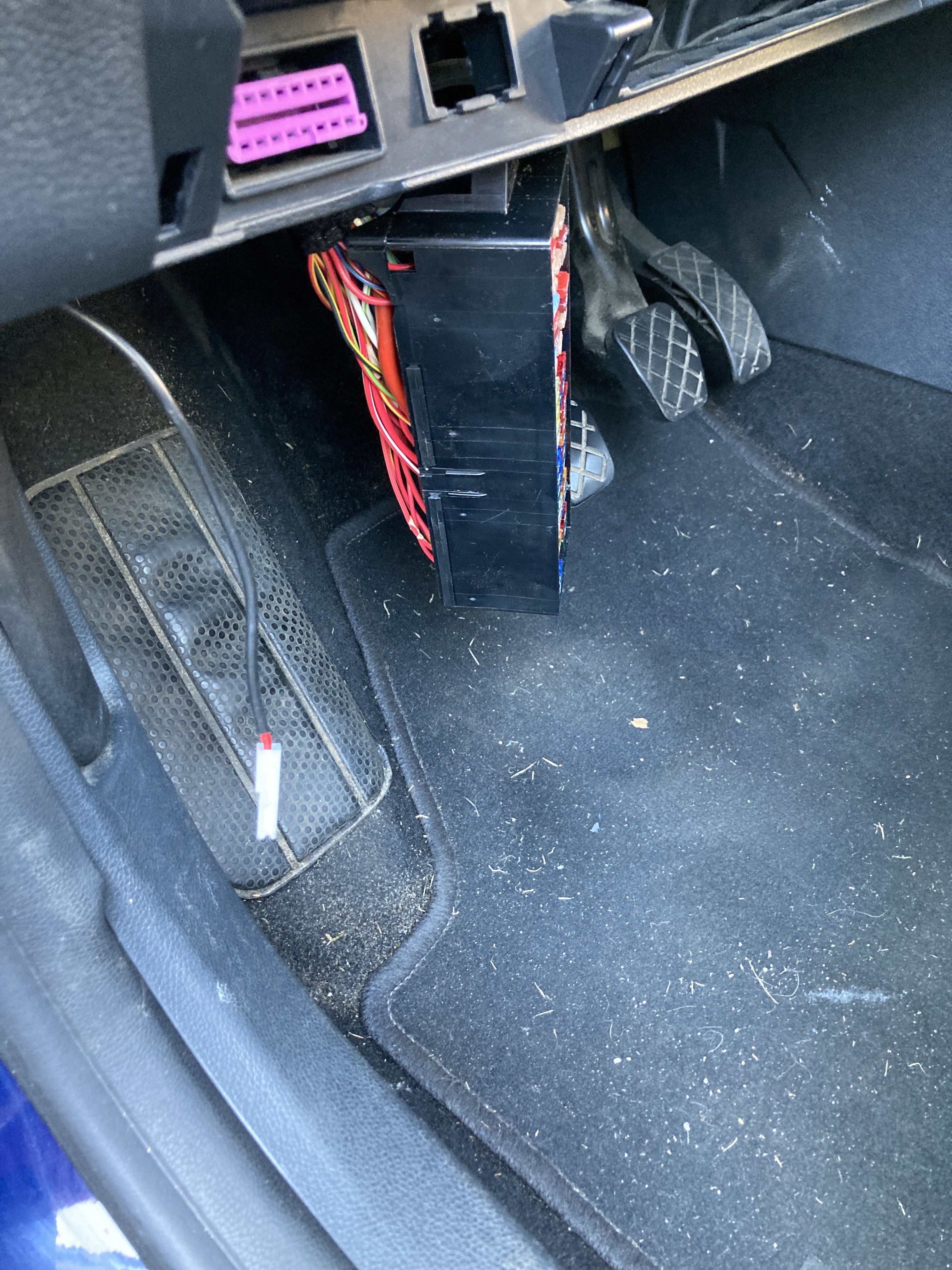

I’m installing a tow bar, well actually the mechanic part is done. And now I need a 12v wire. After many hours of blood, sweat and tears I got the wire to the front.
But now what?
I read things like wire it to the fuse box, but how does that work?
Or run it to the battery, but I can’t find a hole and I cannot remove the windshield wiper it’s stuck.
What’s the easiest way for me to it myself as semi noob but persistent and a bit technical.
And according to this schematic I could use the tow bar, number 12 slot. There is no fuse but there is already a black/red wire connected to it.
