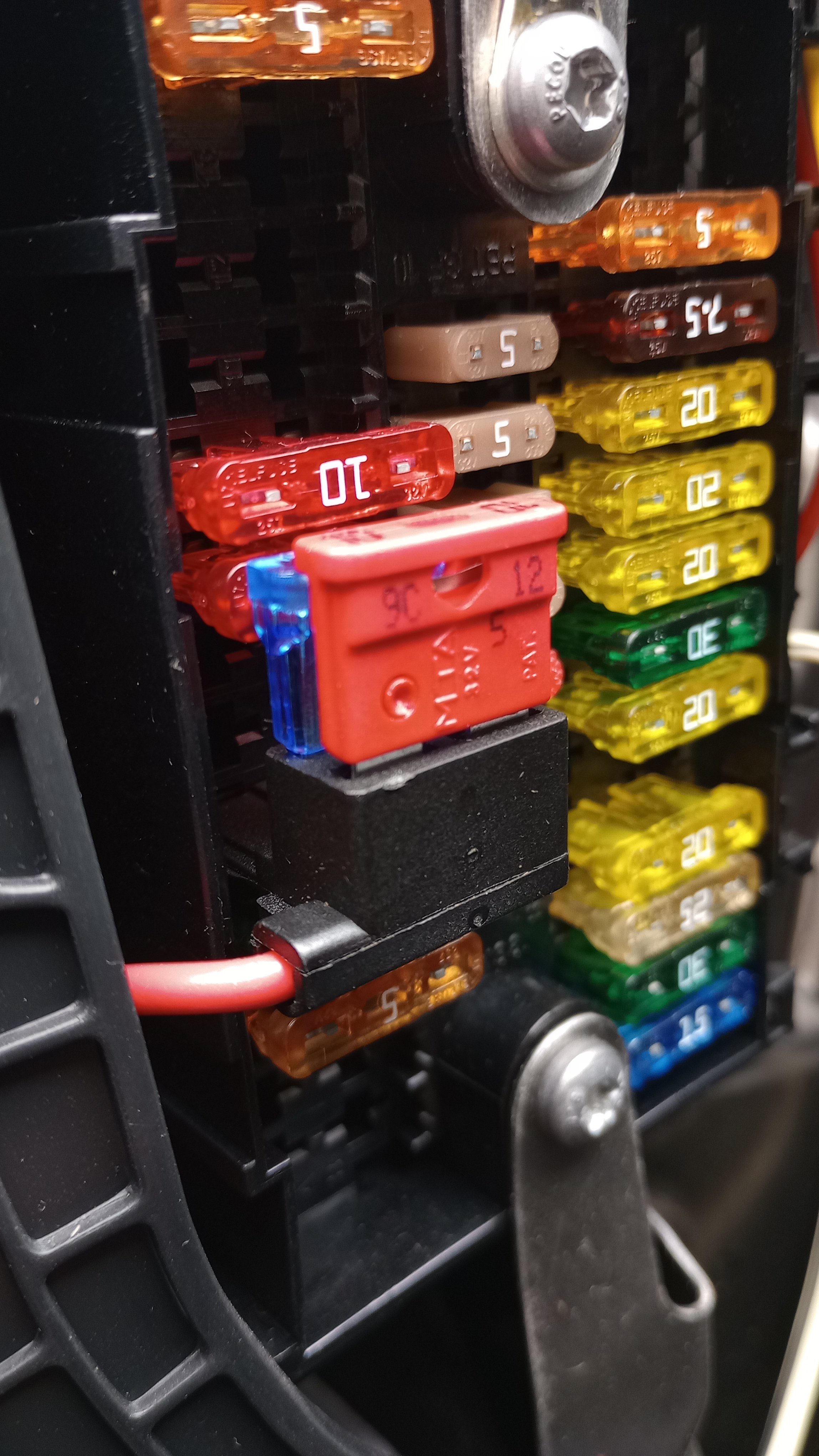

This might give you some idea
Don't forget to check the voltage of the camera.

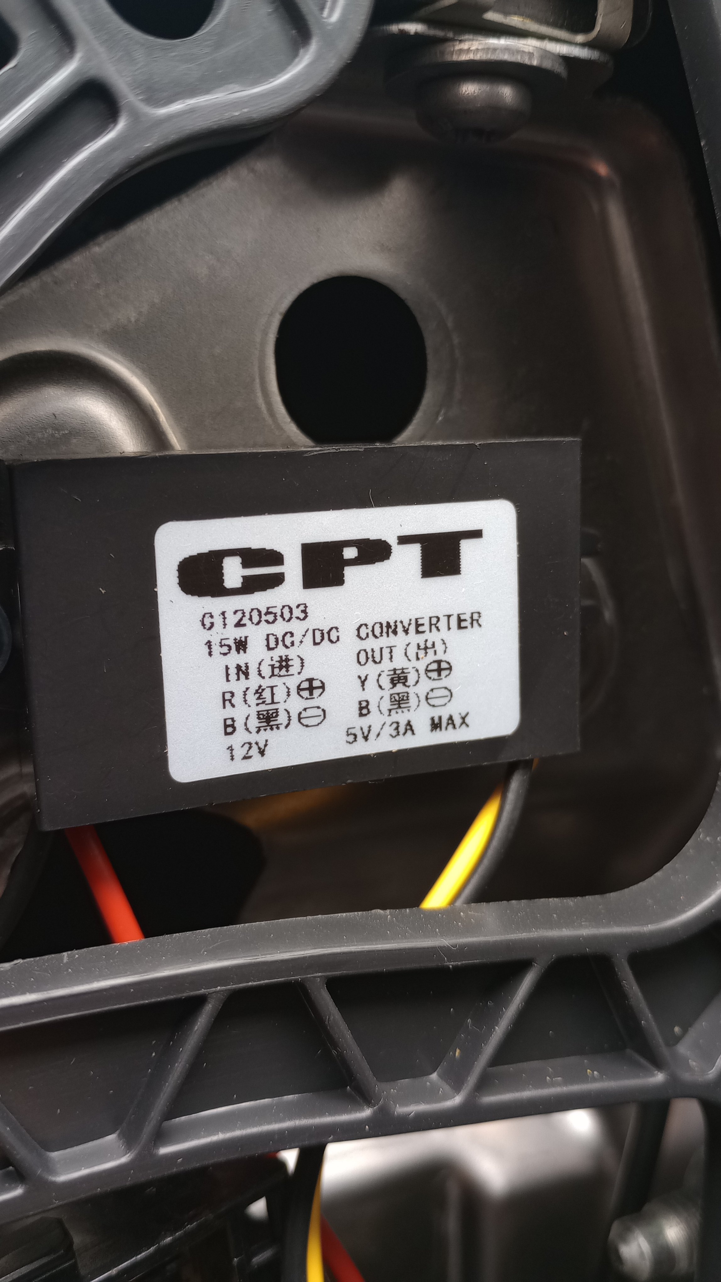

You may need one of these.. CPT voltage converter

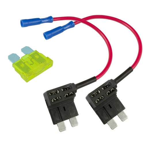

Plus a piggy back fuse.
All fit neatly in the fuse box area.
2 x Add A Circuit Piggy Back Fuse Tap Standard Blade Fuse Holder ATO 12VeBay item number:262247697355image.thumb.jpeg.d6bd15dbfcd8e021f7138237b084808e.jpeg And one for the rear window.

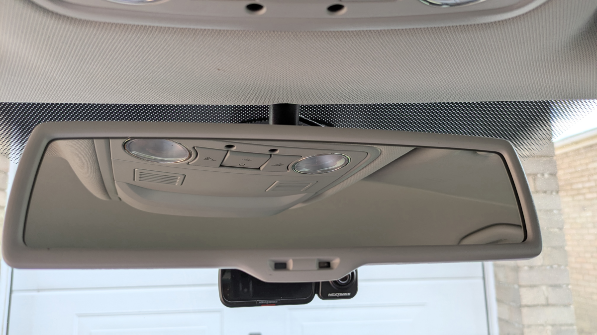

If you want it hassle free, buy a Black Vue model with the switched cable that plugs into the diagnostics port.
I got a factory reconditioned set off eBay with 2 cameras and a years warranty and fitted to my Audi.
No hard wiring required but acts exactly like it is. Big thumbs up.

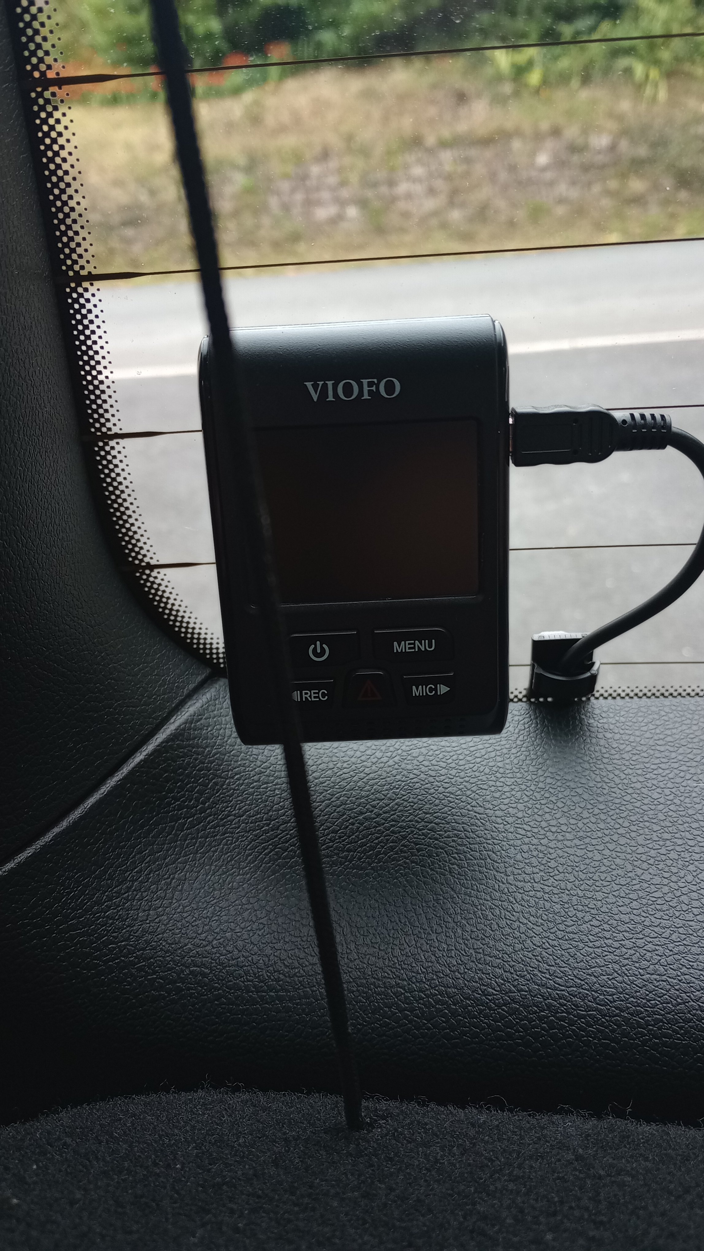

Incidentally, I have a Viofo A129 Pro which started playing up after about 18 months.
I contacted Viofo customer and between us, we traced the problem to the GPS unit, which they sent a new one out to me for the cost of postage (around £6), I plugged it in and all is now well.
I was quite impressed with their customer support, but not impressed that the unit started playing up after 18 months.

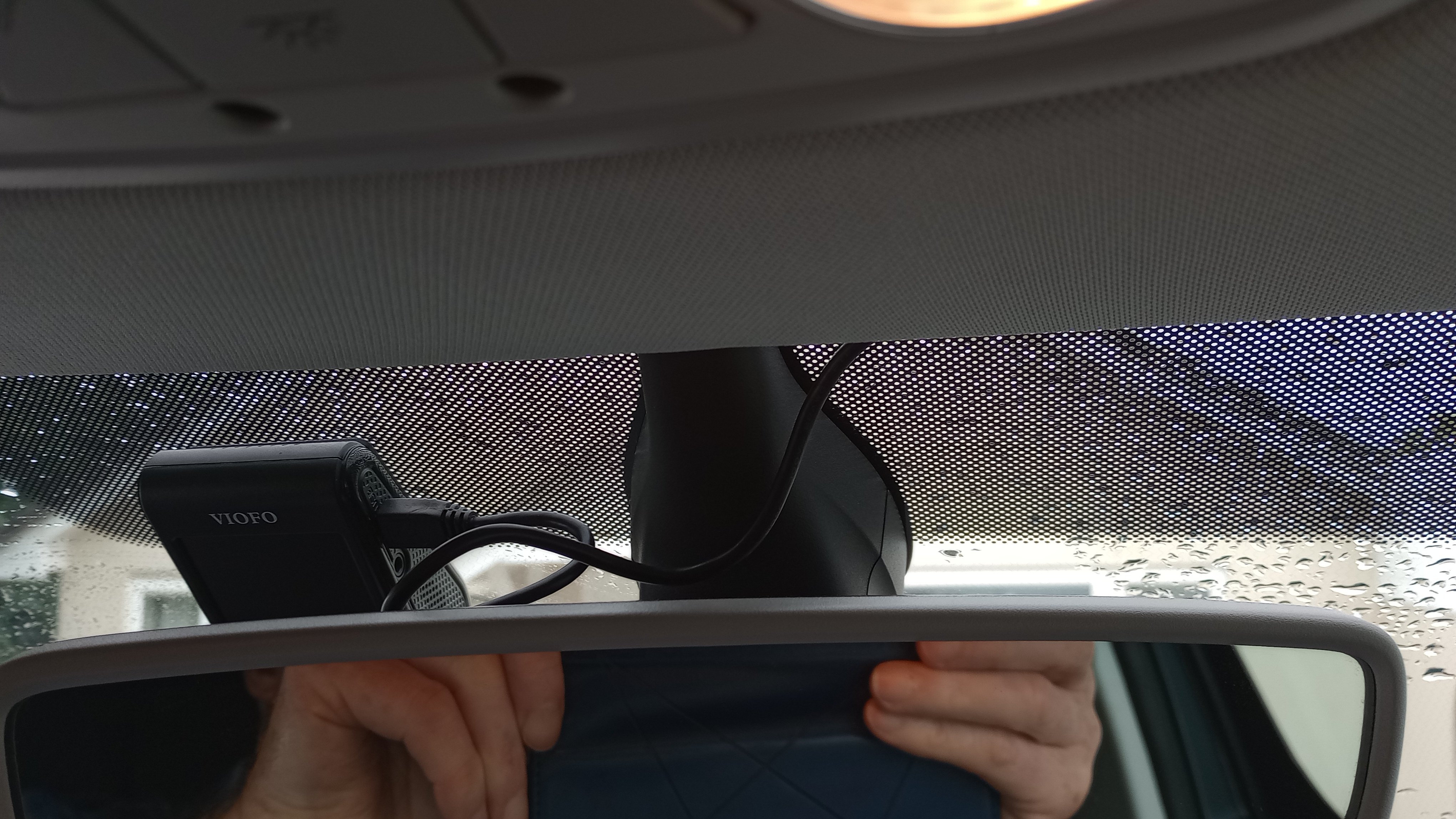

Get a 12v to 5v converter hardwire kit and piggyback into a live or switched live (whatever it needs) in the fusebox by the drivers door.
Easy then to remove drivers A pillar trim by lifting as you pull it inwards at the top so you don't damage roof trim then feed it under the headlining by the windscreen to the rear view mirror.

I'd recommend you remove the Passenger side A Pillar Trim and run the cable that side. It's easy to feed the wire behind, through the dash to the fuses.  Reason being you can't get a wire across the mirror mounting. So by coming up the passenger side then you don't need to cross over the mirror.
What's the need to cross the mirror mount?

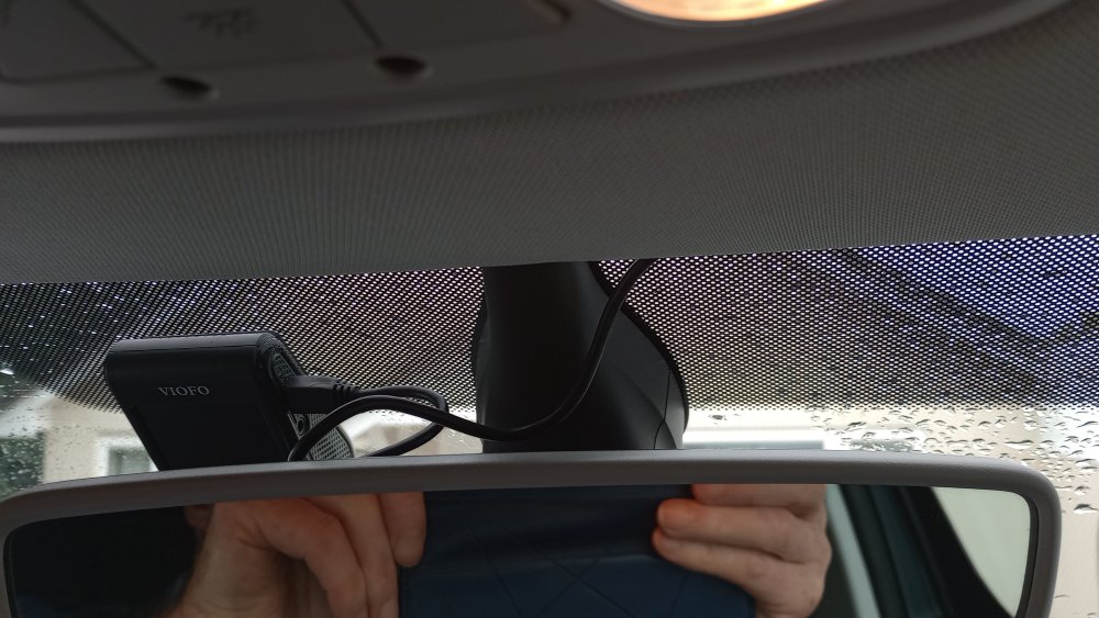

Just bring it down beside it, cannot get neater than that and much easier as no need to fish cable across under the dash, straight up from fuse box to the drivers "A" pillar and tuck under headlining.
The cable is barely visible.
Edited by Urrell
Depends where you mount the dashcam I guess. Mine is more to the passenger side.
Installers choice I guess, it was just a heads up if you assumed the mirror makes no difference.
More to the left as I like to see the dashcams screen to confirm all's good with it, put it into WiFi file transmit mode etc.
