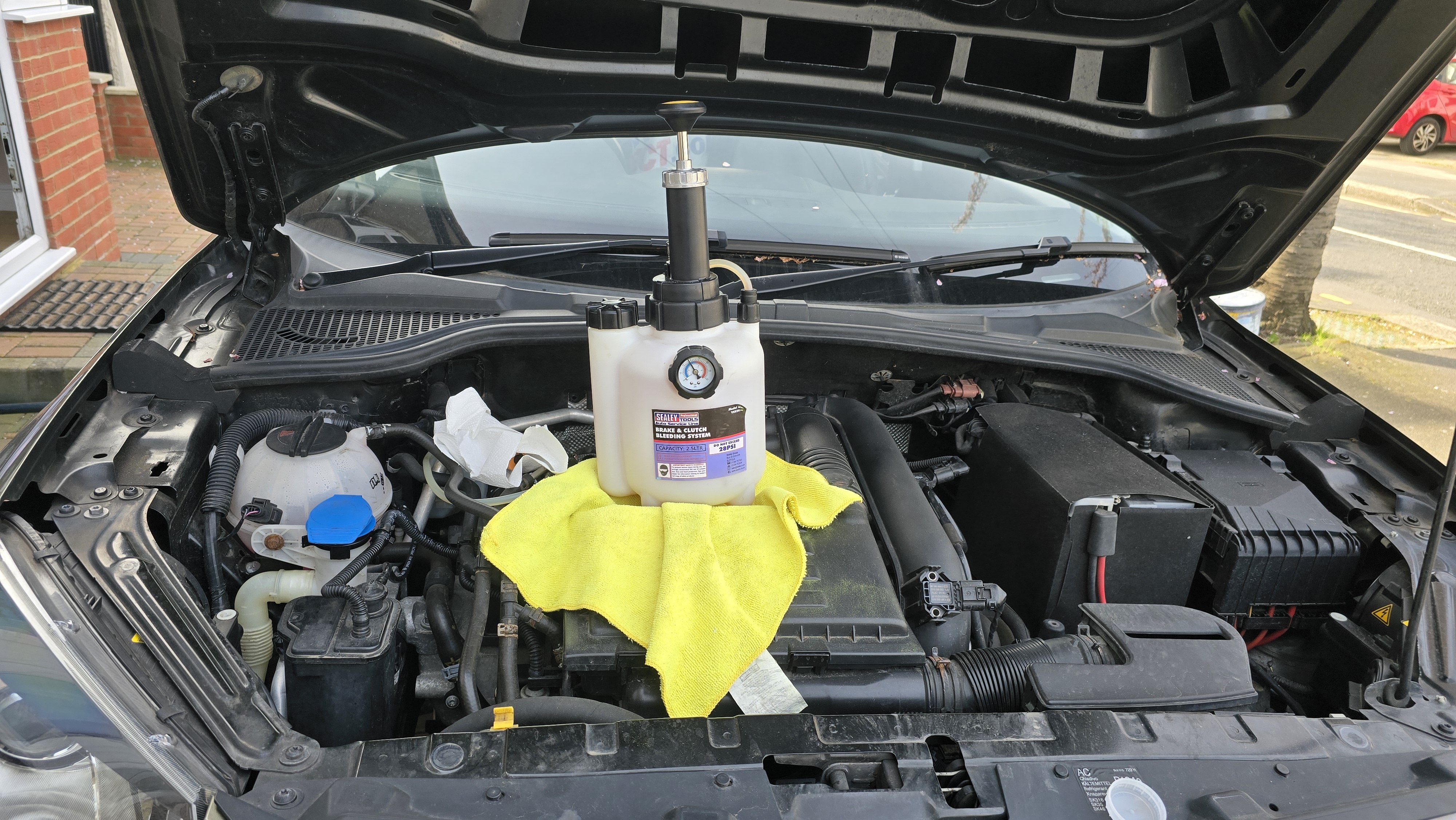

On my Yeti I did that procedure by getting all bleed nipples accessable, plug on a pressure bleeder and do the process. In retrospect I only needed both fronts accessable but an earlier Skoda Roomster needed all 4, so I was prepared for whatever the PC requested.
You need a few litres of fluid but it's a straight forward process and immediately returns a hard pedal.

VCDS on the PC leads you through the process. I just did as it requested until it said Complete. The process seems to be a repeating loop of about 10 cycles until a final Complete message. I kept glancing at the pressure bleeder to ensure pressure maintained and plenty of remaining fluid. I think I used a good 2L during the process, but put 4L in before so I knew I'd have plenty.
