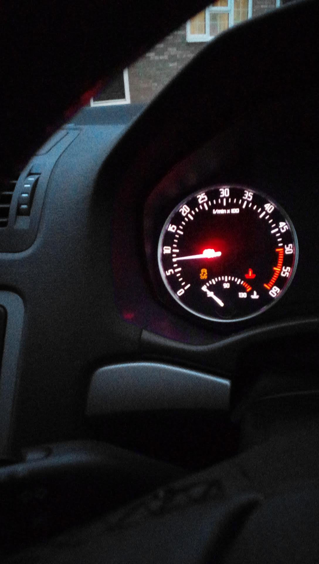

Please help as these lights flash when i indicate. Red foot on pedal and green cruise control maybe when right indicating and red foot and green lights on when i indicate left please see video thanks.

I vaguely remember someone on here ( @langers2k ??) once saying that Mk2 Octy ( or something of similar vintage) has a plug-in daughter board on the instrument cluster, and that the connection between the two sometimes causes trouble.
Symptoms don't suggest any obvious cause to me, sorry.

The separate daughter board is only for earlier pre-FL clusters afaik...
As that's a FL cluster, it'll probably be the normal LED failure/dry solder joint which messes up the entire LED multiplex system used to power them.
I think you probably need a good local electronics repair shop and to check out the guide in this thread:
As I found out, this problem happens if there has been condensation in the car.
If you have climatronics then make sure it is set to auto so it can control the humidity. If you don't have it, then open the windows on a warm dry day to dry it out.
Ah right thank you, so will the issue disappear by doing that or is the damage already done? Thanks
It will go back to normal when dry.
They extra lit icons on the dash varied, depending on the indicator stalk and other controls.

photo added
Very interesting maybe a dehumidifier for a few hrs then.
Removal of cluster and hair dryer maybe?
