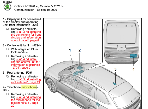

Cannot help with diagrams but I think you will find the Mic in console near where the front courtesy lights are

That's where I thought it would be but ive had a look at used parts on eBay and I can't see it in there. Only 3 alarm sensors? I also can't see it on a parts diagram for the map light console, unless I'm being a muppet

Cheers mate - so I was being a muppet :). Wouldn't happen to have the part number of the mic by any chance?

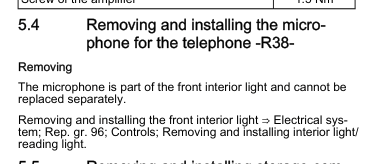

image.png.7737dc37bad5b2729bec611f20cf22a7.pngI don't believe it has a separate part number. Your only option seems to be replacing the whole thing.

Hah, that explains why I can't find a part number for it. I reckon it's the same 3b0035711B used in millions of the other VAG range but for some odd reason they've put it in there permanently. Thanks a lot for the info 🙂
