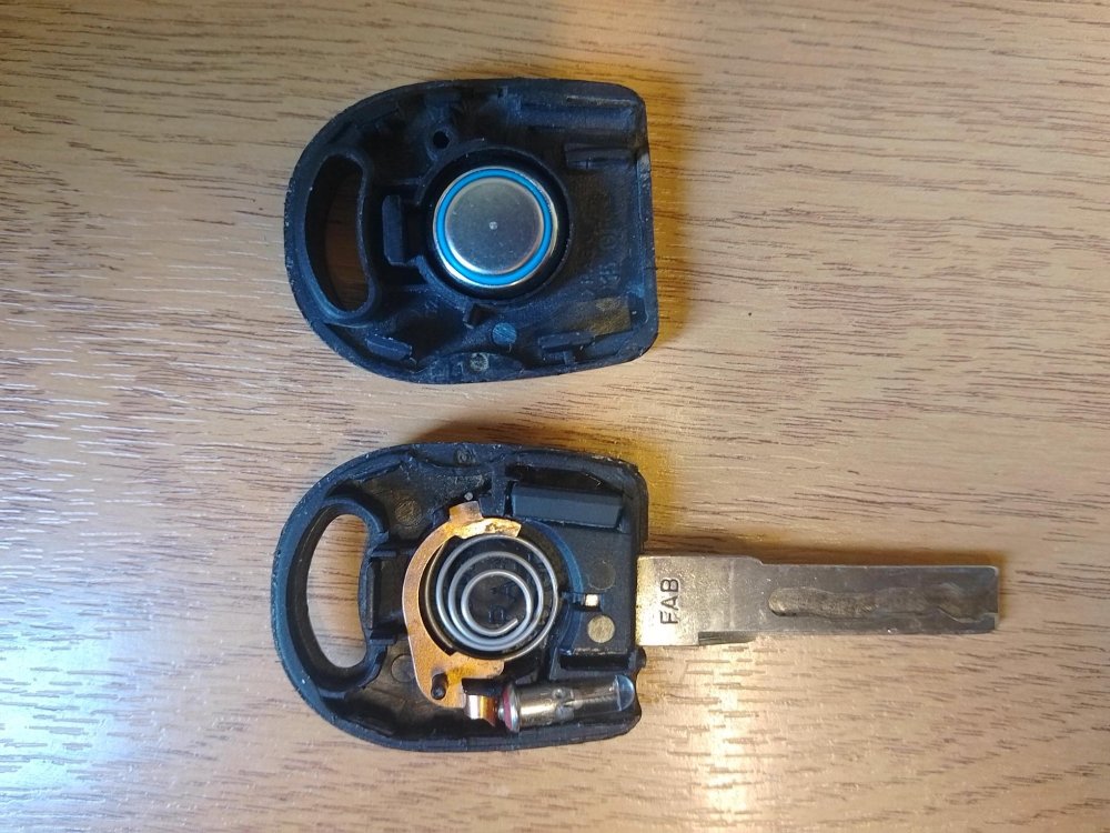

I was wondering if there is a simple troubleshoot for attempting to figure out why the central locking doesn't work. I have one of these keys and I replaced the battery to see if that was an easy fix but no joy. The bulb doesn't light up.

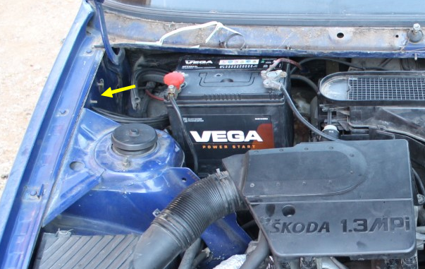

Quite often, the rubber band fell apart and fob got lost... But it's possible that you don't have remote lock system at all - it was available only with alarm system, you can check front A-pillars if there are ultrasound sensors and alarm unit in the engine bay, near the firewall (unit on the picture is pre-facelift, later models were different, but similar placement)

Ah that is so useful. I was very confused as to how that key could operate for remote central locking. On the one hand, it has a button you can press and the previous owner mentioned remote central locking, but when I opened it up, I couldn't see a circuit board!
What is the purpose of the bulb?
I will check for the alarm and sensors tonight but I suspect that it just never had remote central locking.
Thank you for the advice on cleaning up the locks. It is the front passenger side. Can the motor movement be improved with a clean and lube or is it usually replacement required?
Looking at the key you pictured, I'd say the press-button is to simply shine a light for locating the keyhole in the dark.
I am going to have to find a new bulb and get it working now!
It may not have remote central locking but it does have a little bulb to help you find the keyhole 😆

The factory keys from mine don't have button for lock-unlock, only a button which works as a switch for the light (very thin).

Might only be the contact points, try giving them a clean up first.
You can test the bulb by contacting it straight to the little battery using a bit of spare wire aswell.

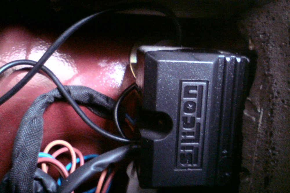

I have seen a unit fixed in one of these threads.

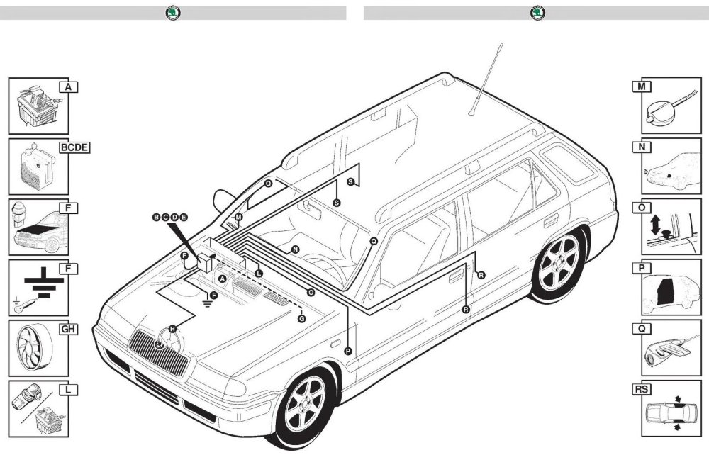

Factory position of Skoda Felicia alarm (Laserline):

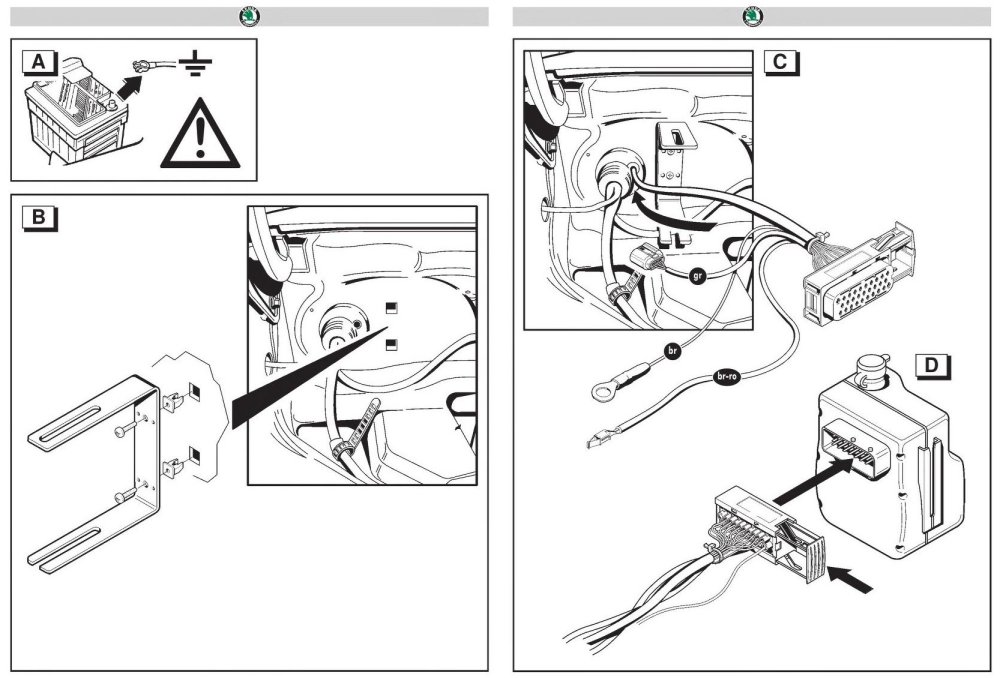

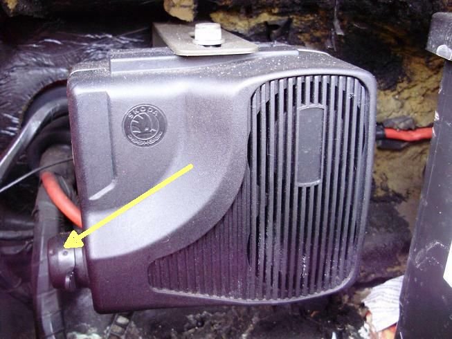

Another 2 relative photos:
The arrow shows the position of the key to cancel the alarm device (e.g. due to a repair)
The reason that i post these photos is to find an idea to relocate mine,due to noise insulation that area is covered and it would be difficult to find it.
