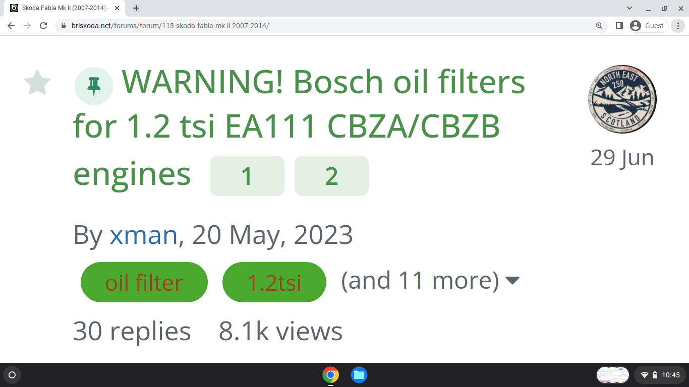

There is a pinned thread at the top of the Fabia Mk2 section on Oil Filters for 1.2 TSI,s of the wrong dimensions, names the Manufacturers name on the filter.
There is also threads on the common issue.

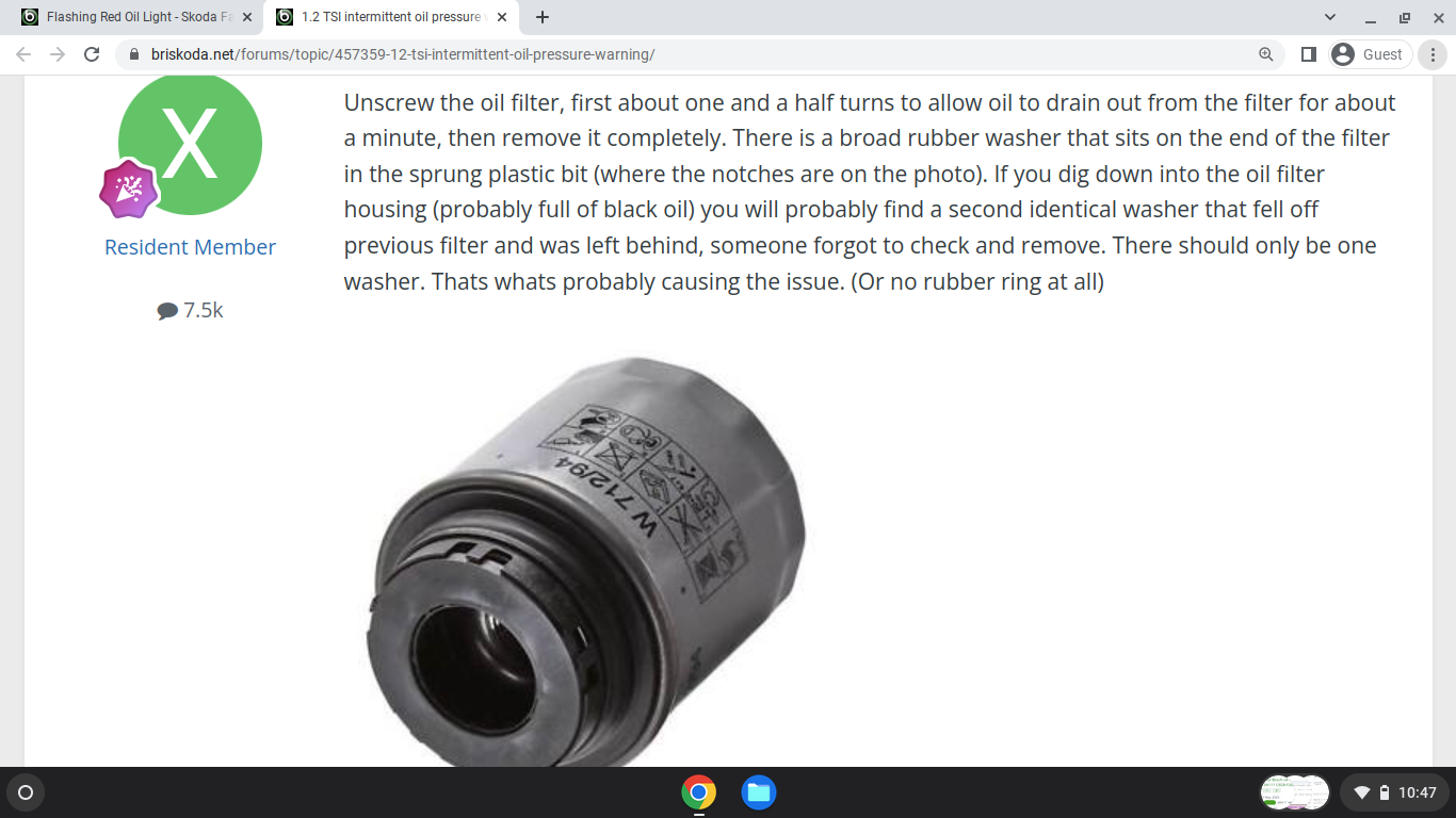

The Tech / Fitter / DIY,er forgetting to remove the oil rubber seal.  Also over tightening the oil filter.
