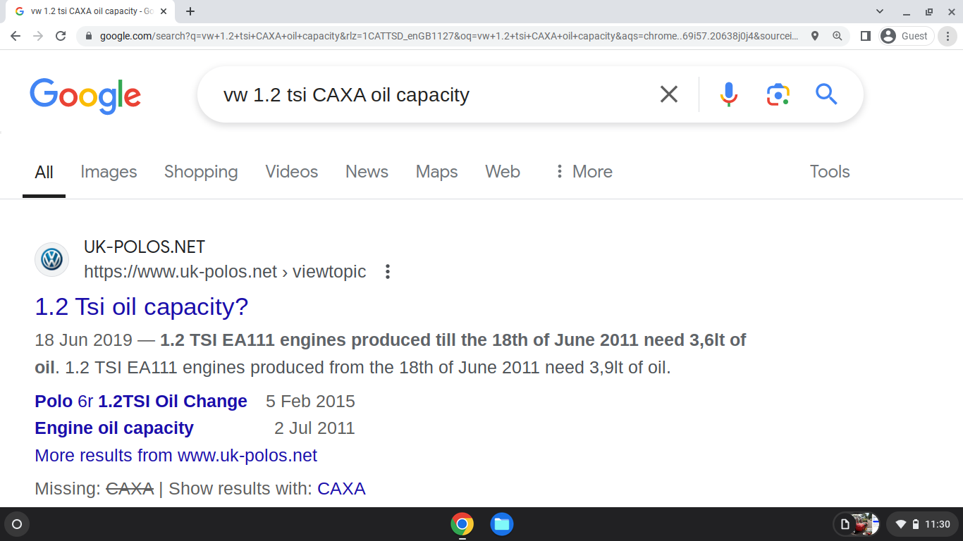

@somean49  Where did you find what the oil capacity is from an oil and filter change?
3.5 or the 3.6 litres, just the difference of Ooo or Ahhh.
But just needs checking once the change done, oil up to normal operating temp and not above area A of the dipstick.
(We always have to assume the correct dipstick for the engine is still being used.)
Edited by Ootohere
A quick Google search gives a Golf and capacity as 3.6 litres but no more info than that number which, if correct, only gives you an approximation, presumably (always dangerous) you take off about 0.5l for filter so starting to fill with 2l seems a good choice.  If doing the work yourself and you're not a Billy-big-bo**ocks (large-testicles braggard) there's no need to rush the refill and it can be done in various stages adding a little at a time and checking, no need to work down to low professional standards.  I never fully top up until the next day after the car has parked overnight first and then been driven.  Depending on the car/engine I sometimes never fully top up (unless the car is going to get driven hard) and leave it at a level that it normally likes.
