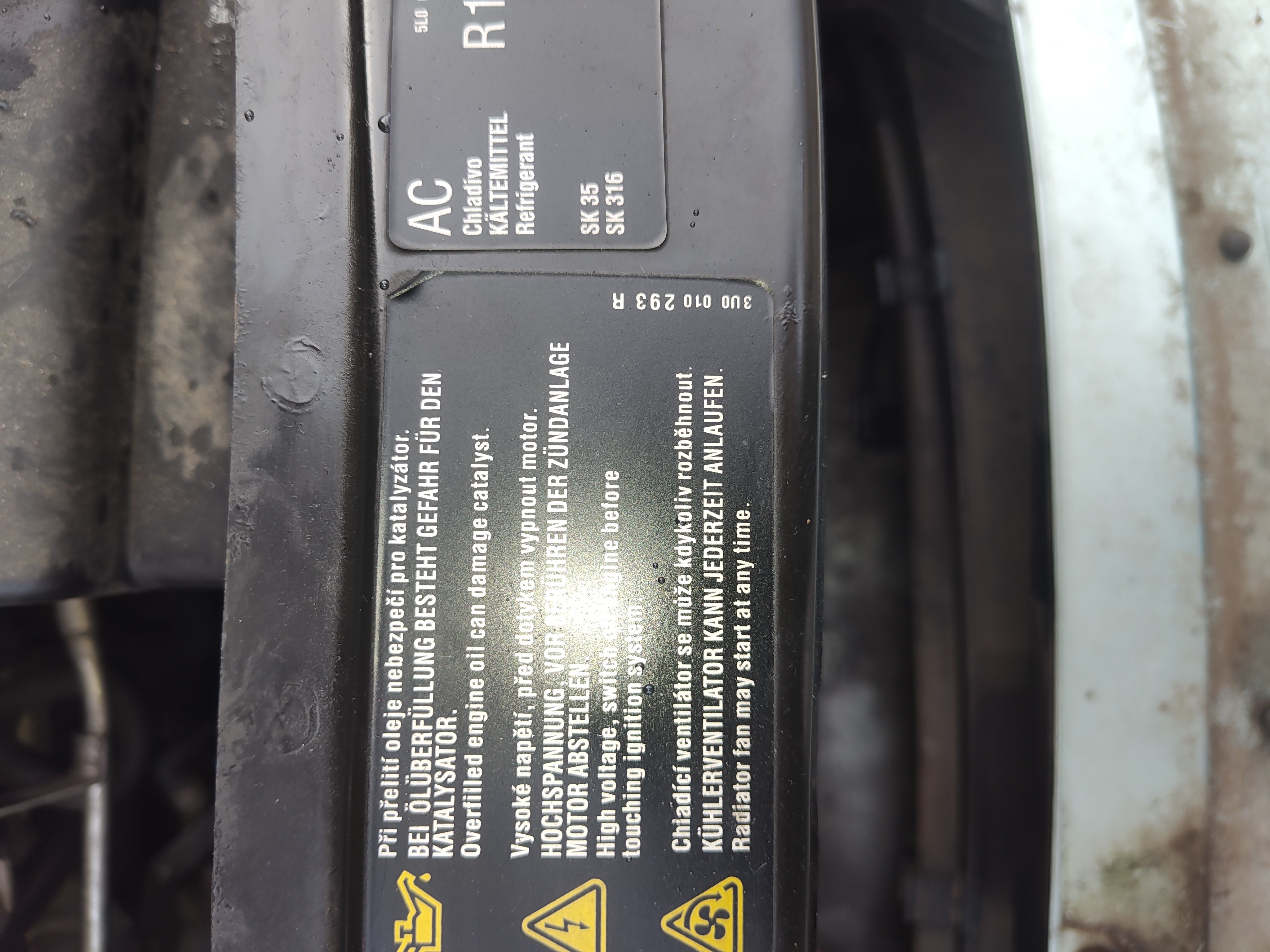

Which tool I luckily have from my earlier incarnation as an inveterate fiddler.
While searching without success for the VIN (online as well as in an extremely disorganised 'Steptoe & Son' heap of documents) I found this plate under the bonnet to add to my worries:IMG_20240927_155834573.thumb.jpg.1d1eb5060065babf93c8b50072f74a83.jpg

VIN can be discovered by entering your reg number at chipex.co.uk and reading from the resulting URL at the top of the page (may need to scroll across the length of it).
Also visible through windscreen from outside, just below passenger side wiper,  generally.
Yeah but you hardly drove it like that.  Another reason, among many, as soon as possible, to take the car for a good extended blow-out run and get the engine fully warmed up and give the car's mechanical systems good stretching exercises, blow out from intake, through engine and out the back get rid of the cobwebs and anything else.

And thanks to Breezy Pete. It's extraordinary what one forgets. There was the VIN staring at me. Perhaps I should clean the car more often.
