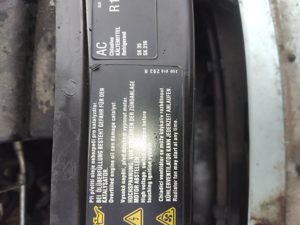

  1. That's a lot. There's a real possibility of oil aeration, affected directly by engine speed.

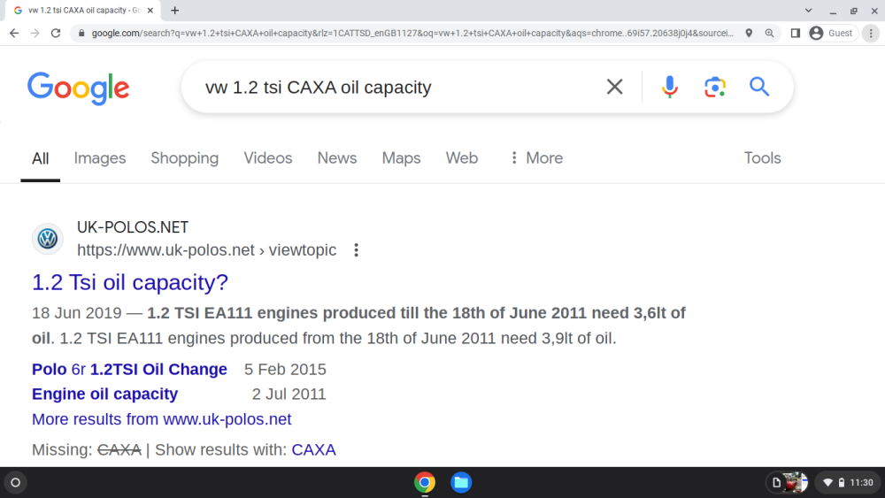

3. Knowing the oil capacity to be 3.5 litres I introduced about 3 litres of fresh oil of the correct grade.

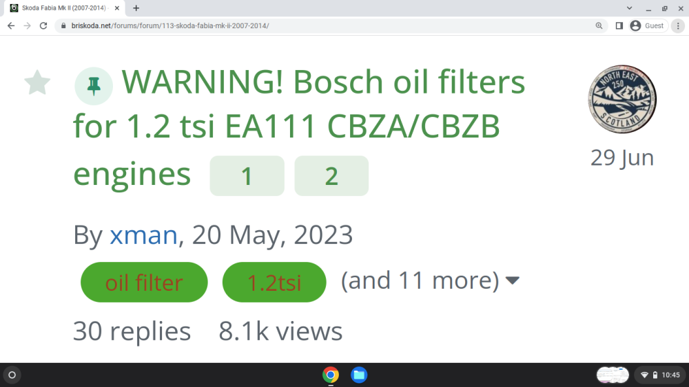

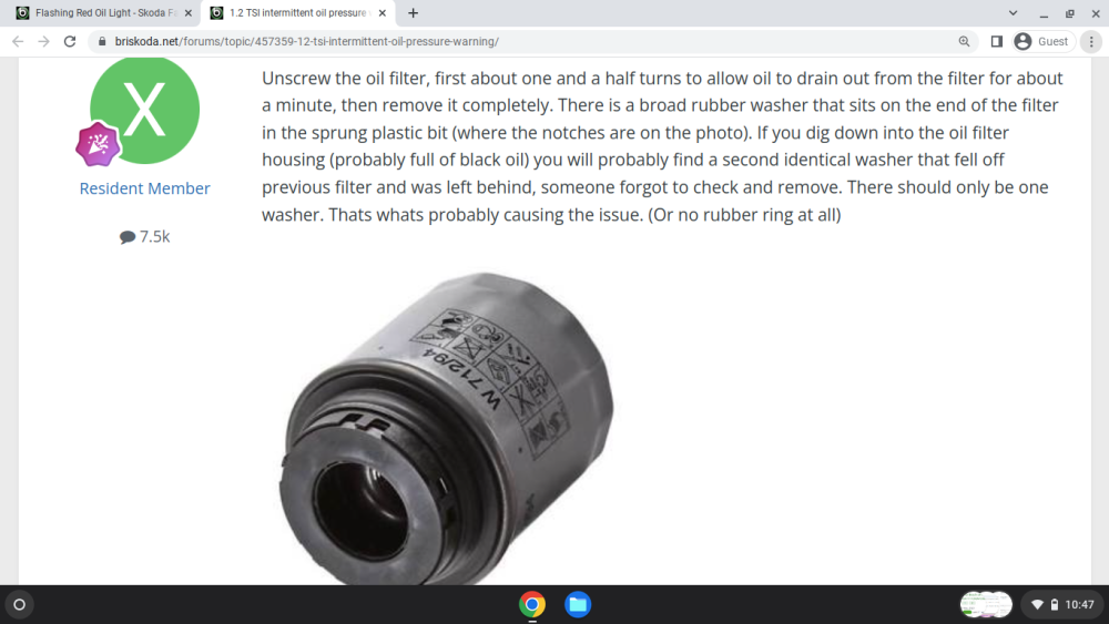

What is the missing component?
