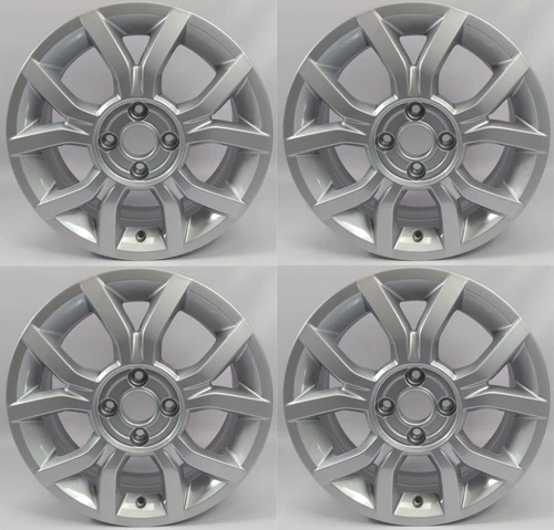

15" alloy rim and matching hub cap for Up!
1 1S0601025R Aluminium rim 'WAFFLE'
5.5Jx15 ET41 4/100 57.1
  1S0601025R 8Z8 Diamond silver
2 1S0601149D Hub cap
  1S0601149D CIX silver/white
https://www.lllparts.co.uk/catalogs/vw/RDW/UP/723/6/601/601050
5.5Jx15 ET41 4/100 57.1 alloy rims WAFFLE (for VW UP!) (£349.99 for a set of four)
