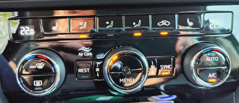

I would like to set the air to blow up at the windscreen and footweld as well.
In auto air blowes out in middel airvents, not in the top and bottom.
Can this setting be done by vcds or on the  Climatronic control it self ?
This is how it sets when I start in the morning

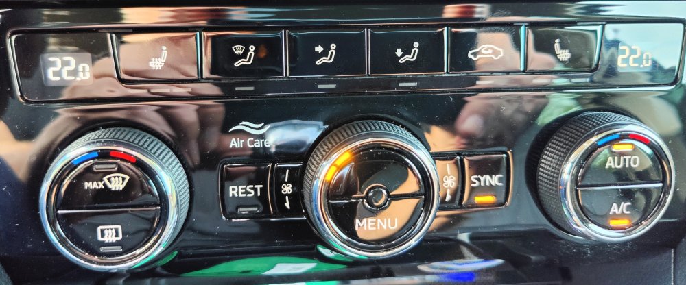

I would like to start as this

I figured it out my self. set the settings want and press the butten REST. the control will remeber this setting in feutur.
REST is for "continuing" the air mode after you turned off and locked the car for a period of time. On your second attached image you have it set correctly bar the 3rd on the right illuminated button. That's for recirculating air. Window above the knees and arrow to the toes is the correct setting for what you asked. If it's blowing somewhere else too it means you've stuck vents.
if the "auto" led is not on, you are in manual mode cancelling out all the benefits of automatic climate control.
not sure why you would like to do it like this (long term), as defsix said, if in auto it is not working well, you might have problem with servos or something.
during normal operation AUTO is on and you should control it only via temperature.
