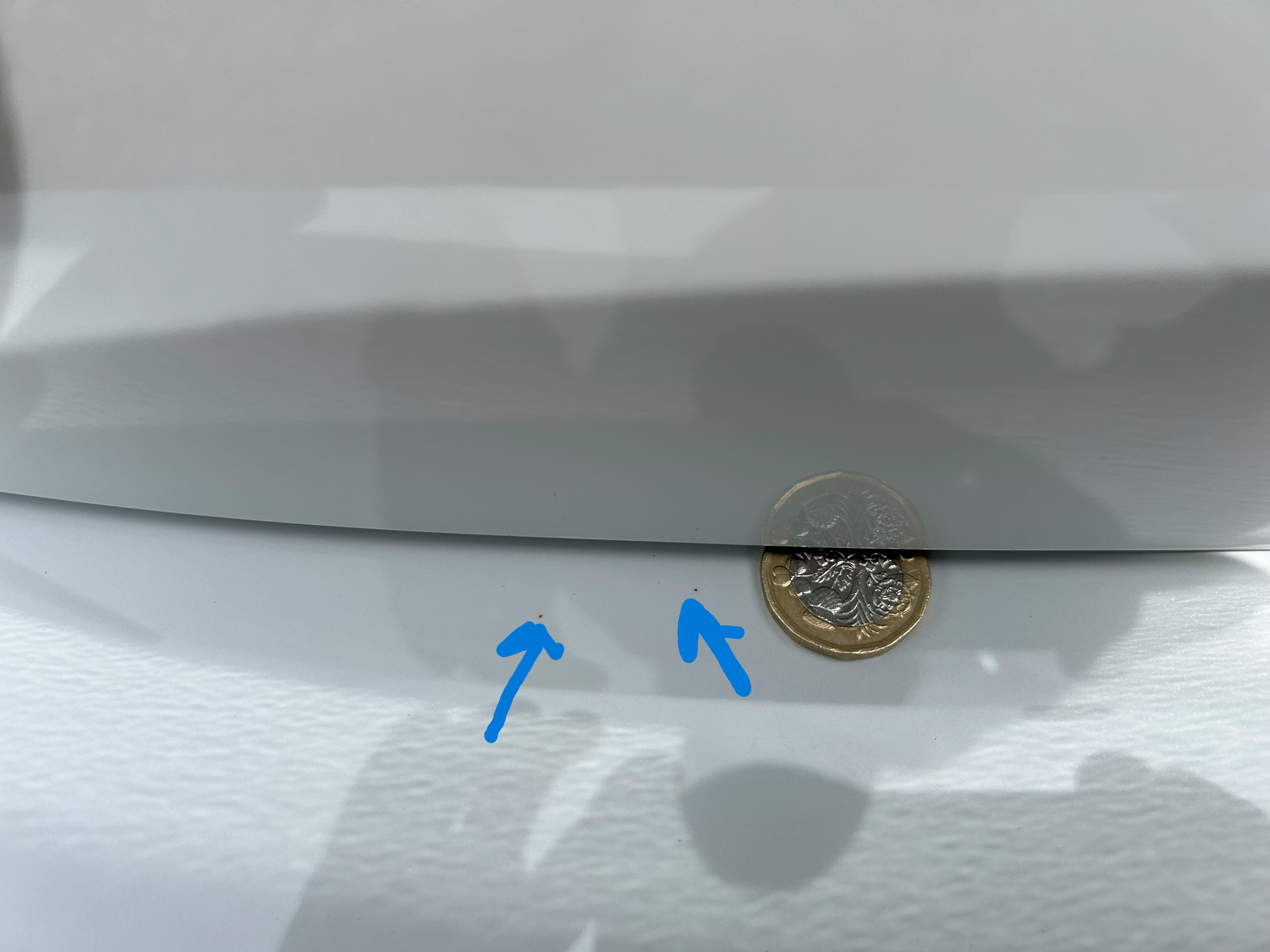

@Rory Thanks for the reply .My Karoq was a DG 23 registration .Yes I did see and drive the car before purchase. The blemishes in the paint are very difficult to spot, see photo below. For various reasons I didn't get round to doing my usual overkill clean and polish until 3 months after getting the car. After a good wash I clay bar the paintwork, apply a coat of Super Resin polish and then a coat of High definition wax polish, I spotted the two marks on the rear bumper as they wouldn't polish out I thought it was a paint defect, they are all over the horizontal surfaces of the paintwork.
How did the bodyshop manage to turn those marks , even if all over the car, into a 30 page report?
To be honest ours is petrol blue and if it had those marks I don't think I'd be able to see them.

The 30 page report  included diagrams for each side, top, front and back, showing paint thickness on every panel, to prove that it was per factory spec depth. Then photographs of every location where there was a blemish with a rule to show scale.
I don't think I'd have noticed the marks if it was any other colour.
