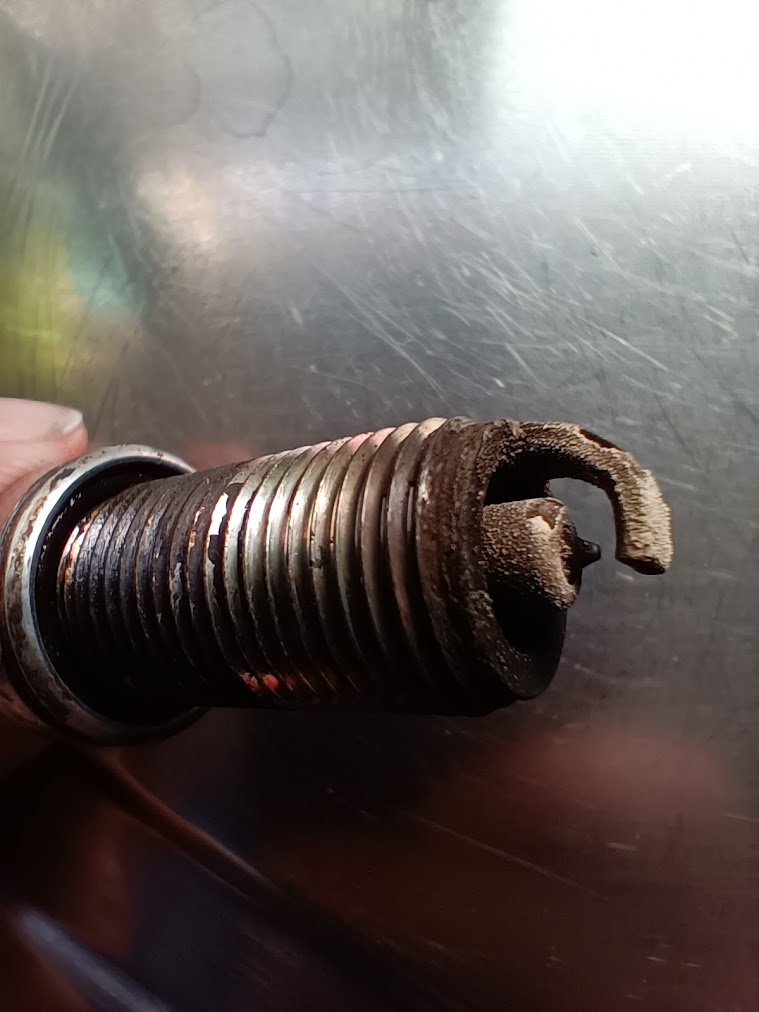

The plugs were pulled in October and I am a bit worried about this one:
The car is booked in tomorrow at a garage to have the plugs pulled and a borescope inspection to see if any oil residue is present on the top of the pistons.
The garage (who supplied the vehicle) have just contacted me saying that all EA888 Gen 3 engines use this amount of oil, however I am not convinced.
